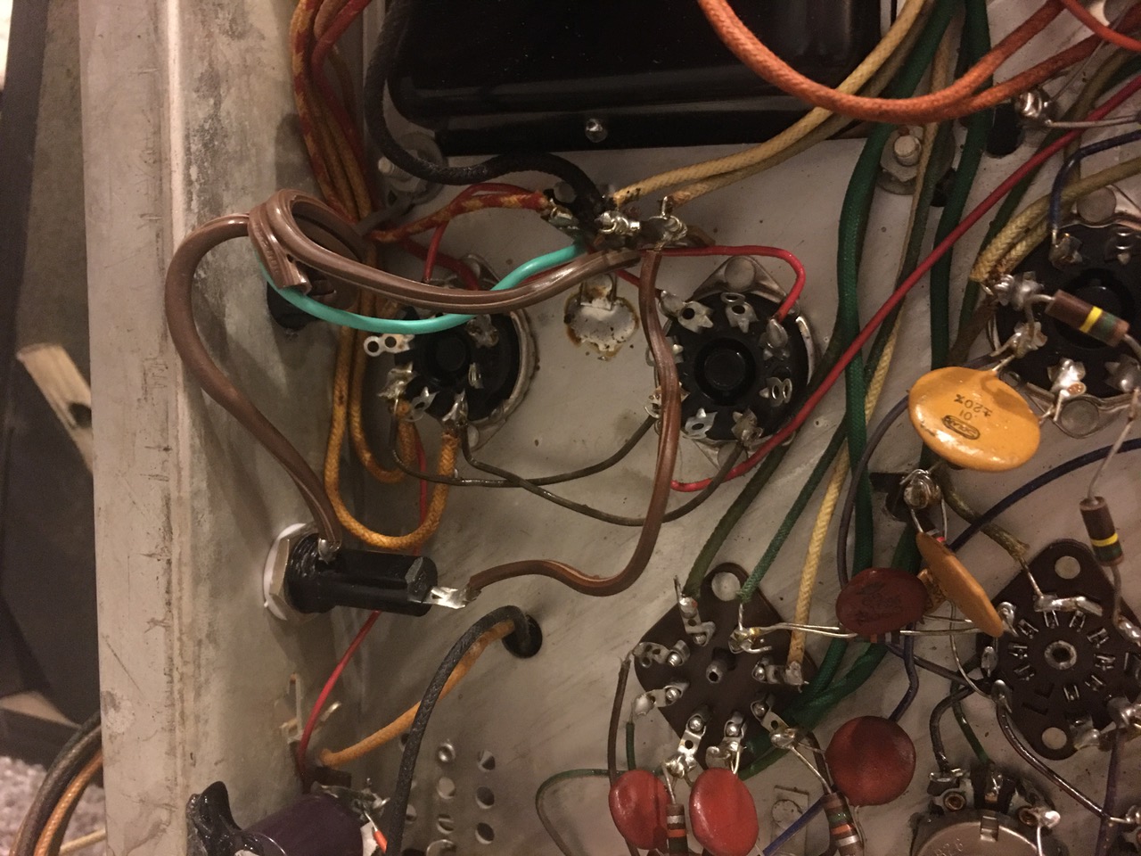

Hello Guys. I want to someday get to the point where I can get around a amplifier chassis or possibly align a preamp/tuner . But for the first couple of the consoles I had Sam at Sound audio repair install a fuse holder and isolate the chassis. Not sure exactly what it does because I see the the line is grounded along with the green ground lead?

Hello, Forgot to post the photo of the inline fuse that sam installs. Hydro

Hydro! What size fuse was installed with the rebuild? Was it a slow blow? The formula for calculating amps is (watts divided by volts). Both numbers should be on the back of your stereo. For safety, you can take it back to Sam, or, this might be the perfect time for you to roll up your sleeves and dig in. If I can do it, so can you. And remember there is all of us to give you a helping hand. My guess, and I'm probably wrong because I usually am, the fuse blew because of the cold.
