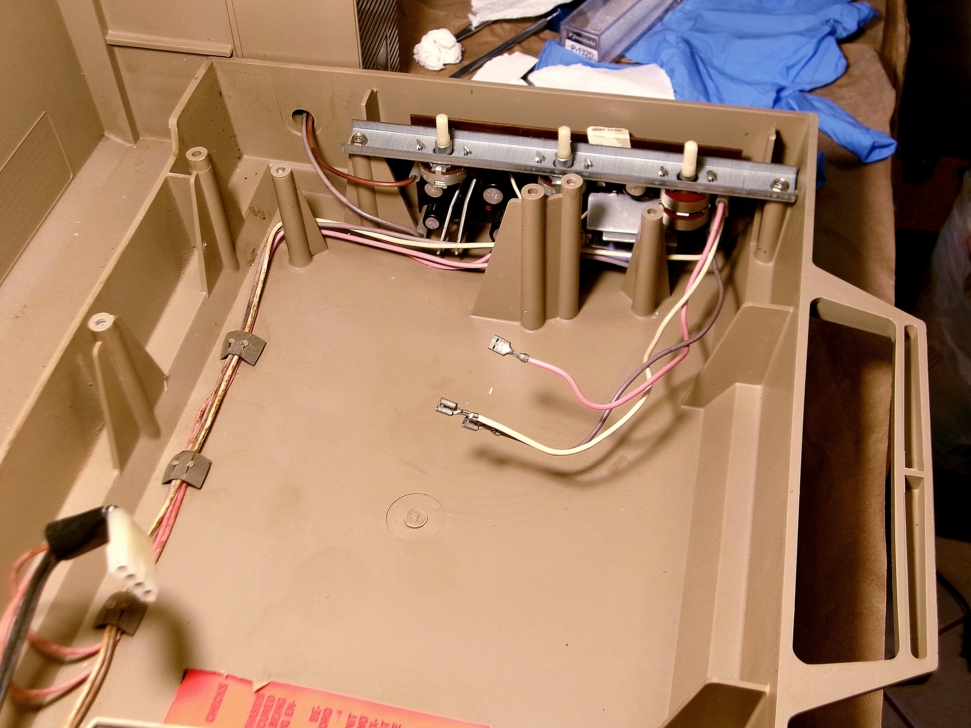

The case was evenly covered with some kind of
nicotine looking stuff.
It did not have cigarette smell, than goodness,
and cleaned up fine.

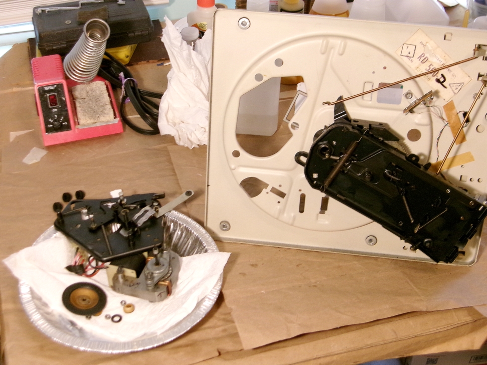

The RD-500 changer sub-plate actually requires
some special G.E. service tools to get it apart.
I use long cotton tip swabs to clean all
the internals, which are very open in design,
so dis-assembly is not required.
The original idler is good, new motor mounts installed,
and a new stereo cartridge as the old Astatic 142
had a bad L channel.
There are separate R/L volume controls and
a ganged tone control.
