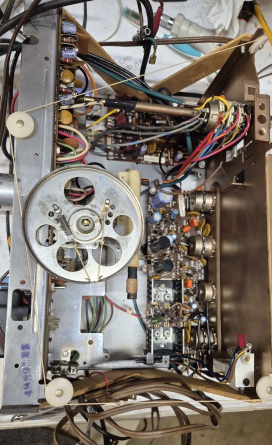

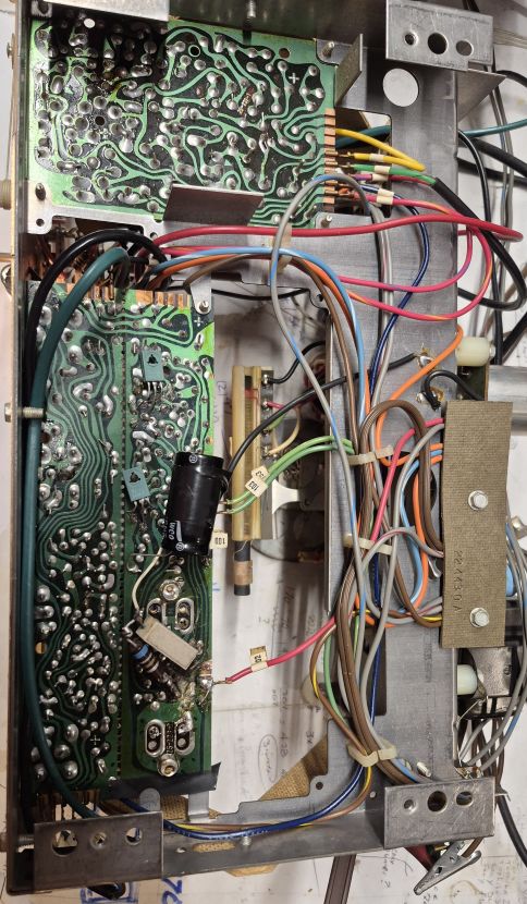

The pictures are of the typical Silvertone chassis. PC boards are decent quality and so are most of the parts. The transistors are all silicon, a major plus!!! Lighter than a comparable Zenith or Magnavox, it is also easier to change any required part. Notice the slide-onto-PCB connectors in Warwick equipment - they also made organs, etc.
The caps all tested OK for ESR all but one filter cap added below chassis, yet a clue told why the left channel was weak: two burned resistors and one output transistor were laying in the cabinet, likely from a field-performed repair. Always check prior repair work! Two 2-watt 2.7 ohm resistors had been replaced with 2-watt 270 ohm resistors. That is quite a mistake, yet it still made some good sound until you turned it up.
I had a bunch of PNP Si drivers so, I replaced both that drive the phase split transformers feeding the output transistors. Traditionally, this driver is run pretty hard and causes distortion when it gets hot, especially in earlier Astrosonics.

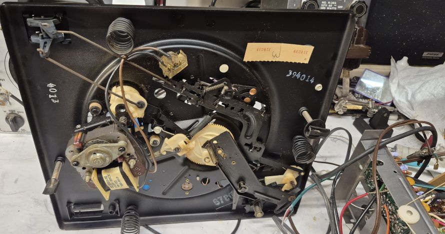

The Crescent changer needs only a tiny stylus and a good leaning. Speed seems OK on 45 and 78 and a bit slow on 33.
These were never perfect changers yet seem to respond well to minor cleaning.

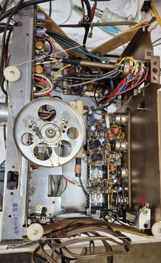

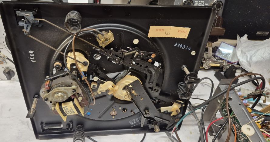

My first view of a Crescent changers bottom side. Looks simple enough and like you said, Dave, fairly easy to service.
