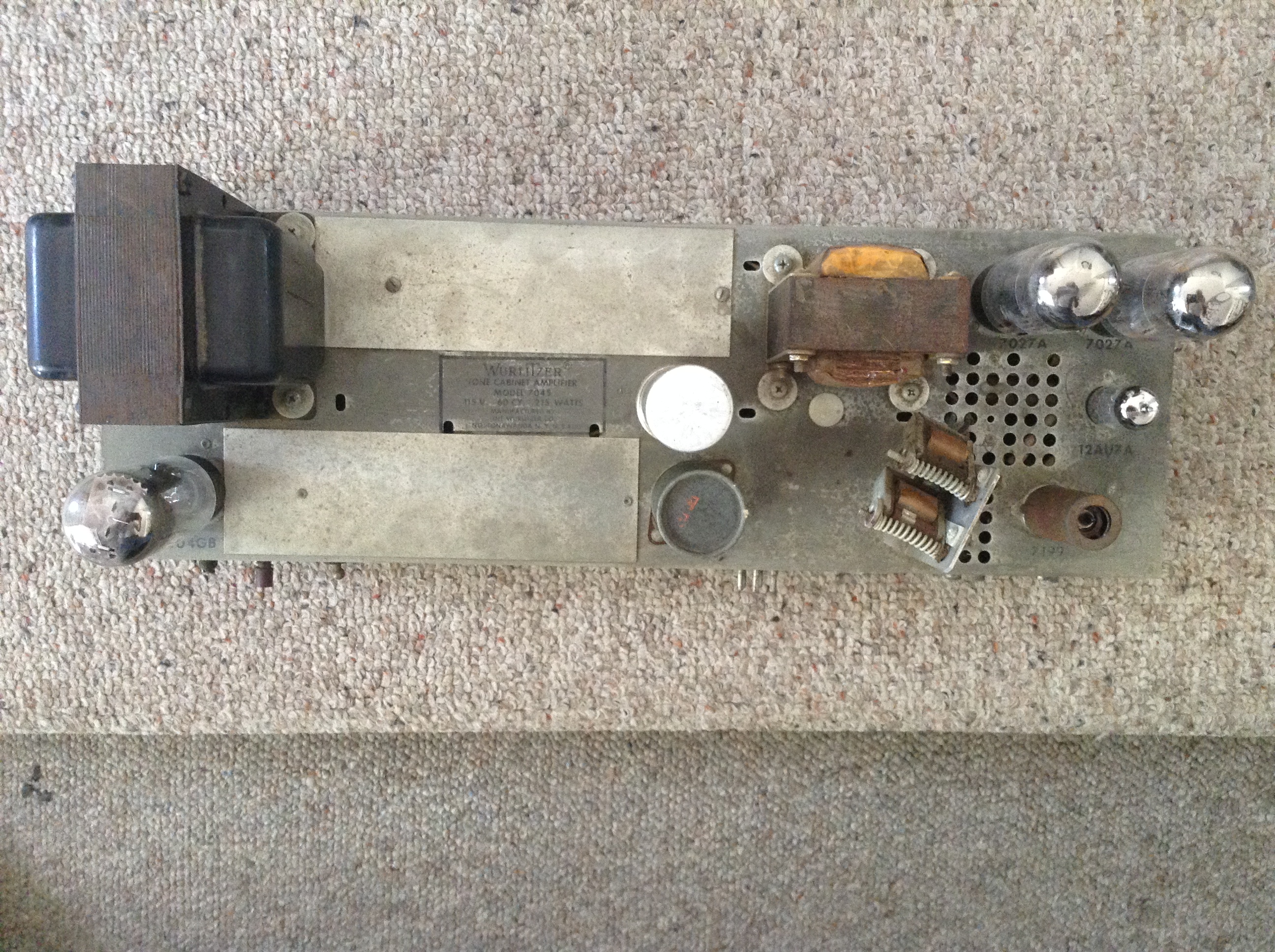

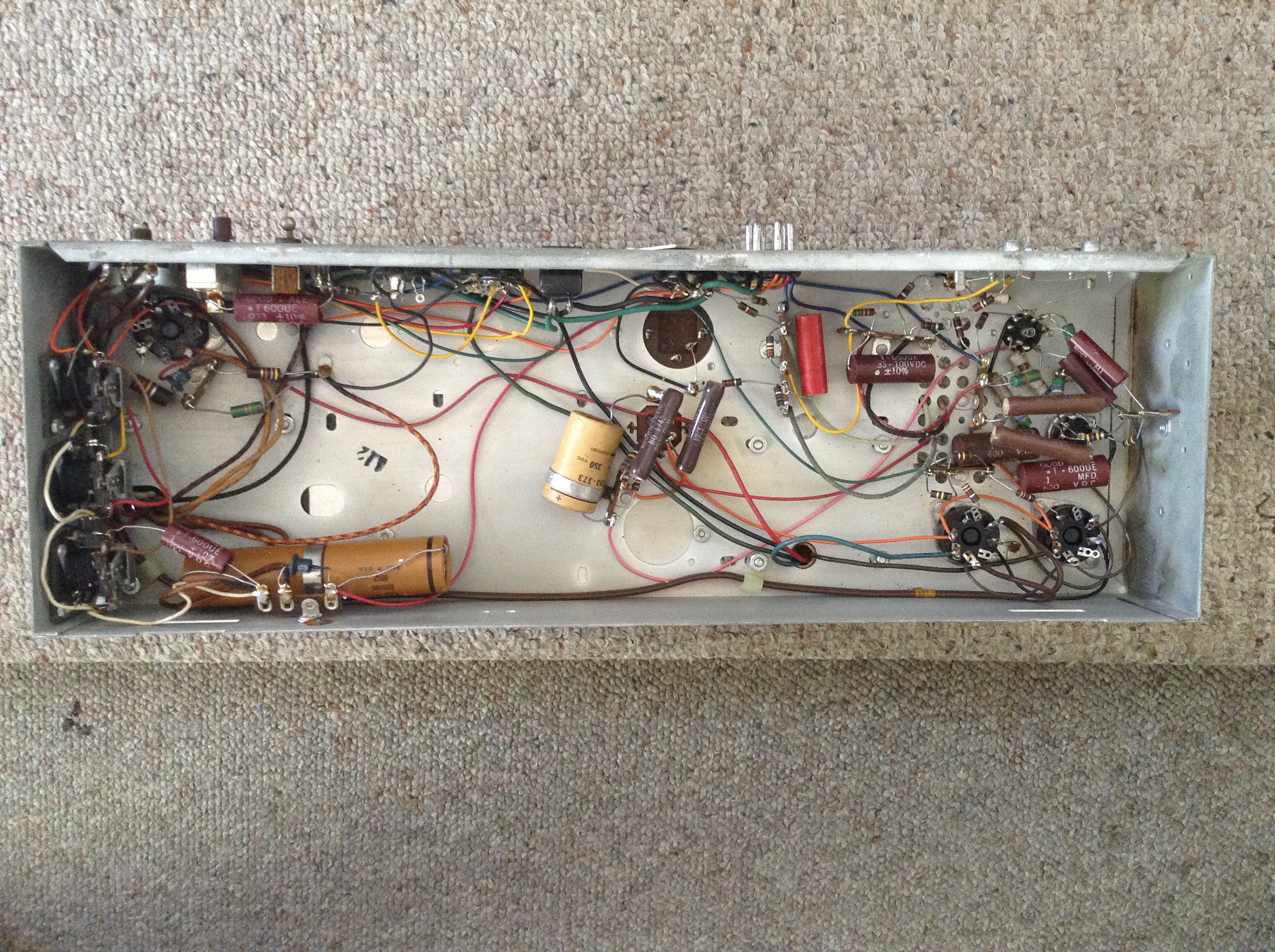

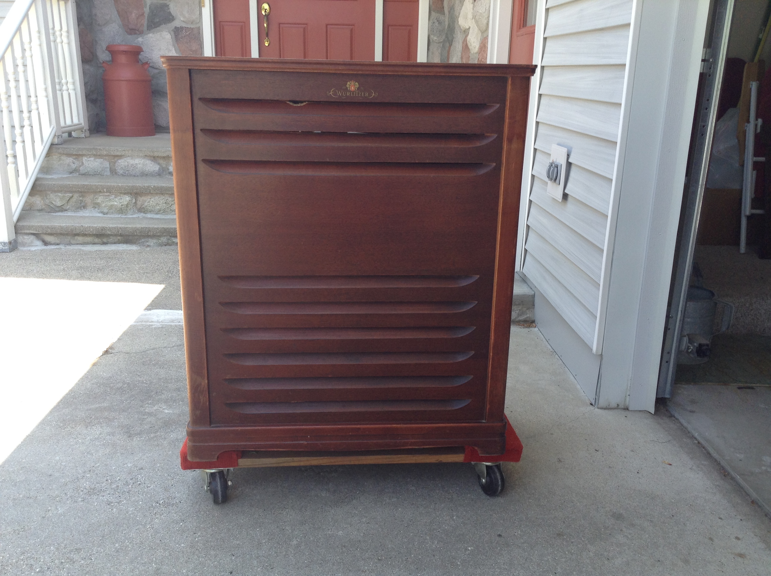

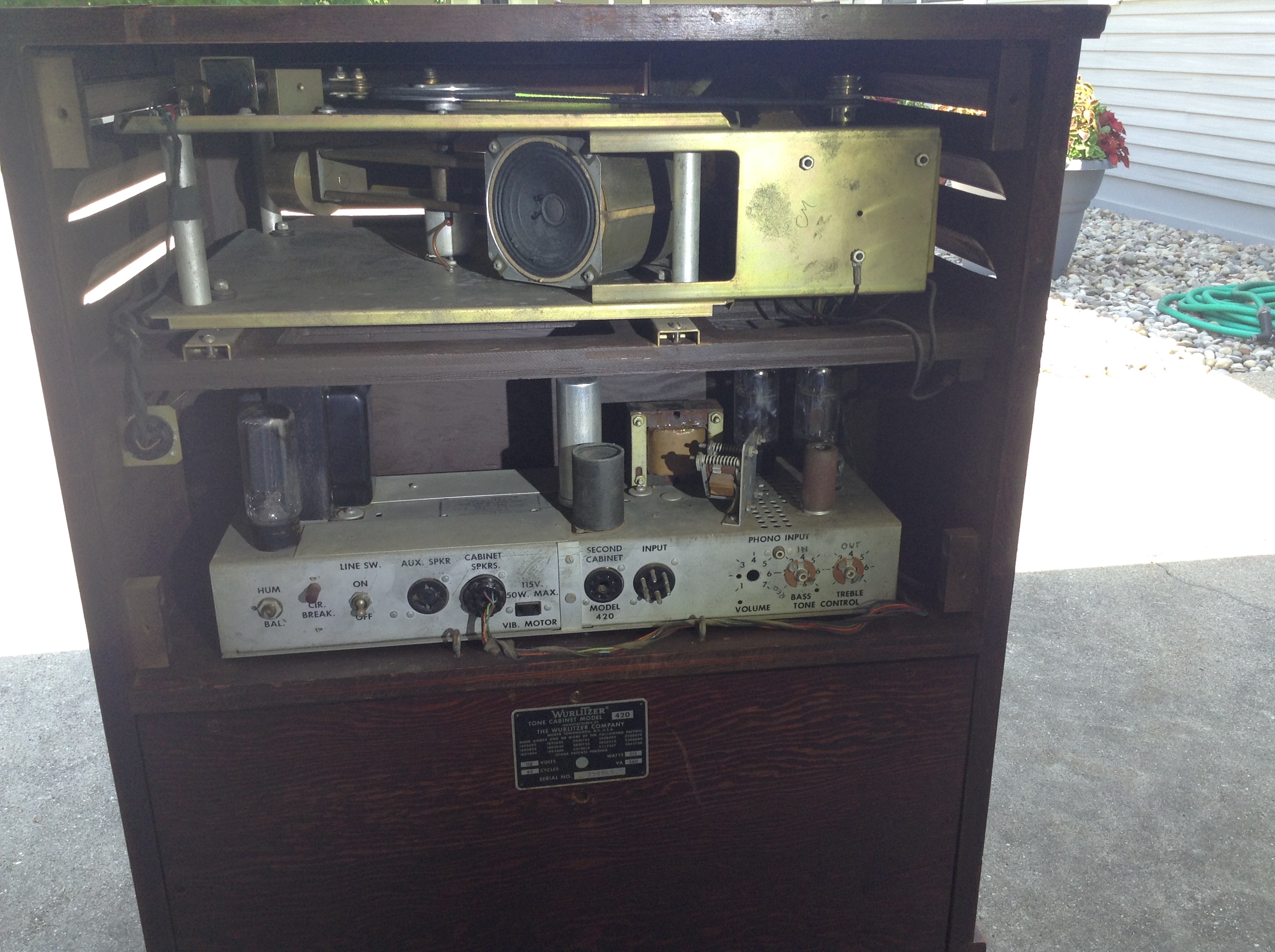

Yesterday, I got a call from a friend, kind of a hoarder of electronic anything, telling me he was cleaning house and the Wurlitzer speaker was going by the road along with other things. All I knew about the organ speaker was it was a Wurlitzer, up to this point I had not seen it. He told me they were going away but the speaker was outside the garage and if it was still there when they got back, they would know I did not want it. Pulling into the driveway I saw it sitting there and thought this is a Leslie speaker not a Wurlitzer, the cabinet looked the same as a Leslie. Nope, it was a Wurlitzer Spectra-tone organ speaker with amp. Wurlitzer Spectra-tone organ speakers was Wurlitzer's version of a Leslie speaker. The Wurlitzer model number is 420, and the amp number is 7045. 5U4GB rectifier, PP 7027A's, 12AU7A, and 7199. The 5U4, and 7099 are labeled Wurlitzer by RCA. The 12AU7 and 7027's are branded GE. Here's a few photos of what it looks like:

You know more about those than I certainly do, but my observation is that there are lots of spendy parts in that speaker. Well worth curb picking for that fact alone....

Super nice catch Bill.
I also thought it was a Leslie design.

That's a nice mono amp, make a good center channel amp. 7027a tubes themselves are pretty desirable.
Wonder what went into the spaces where the blanking panels are?

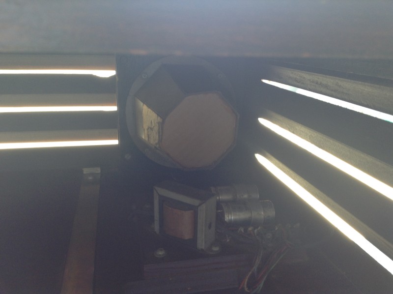

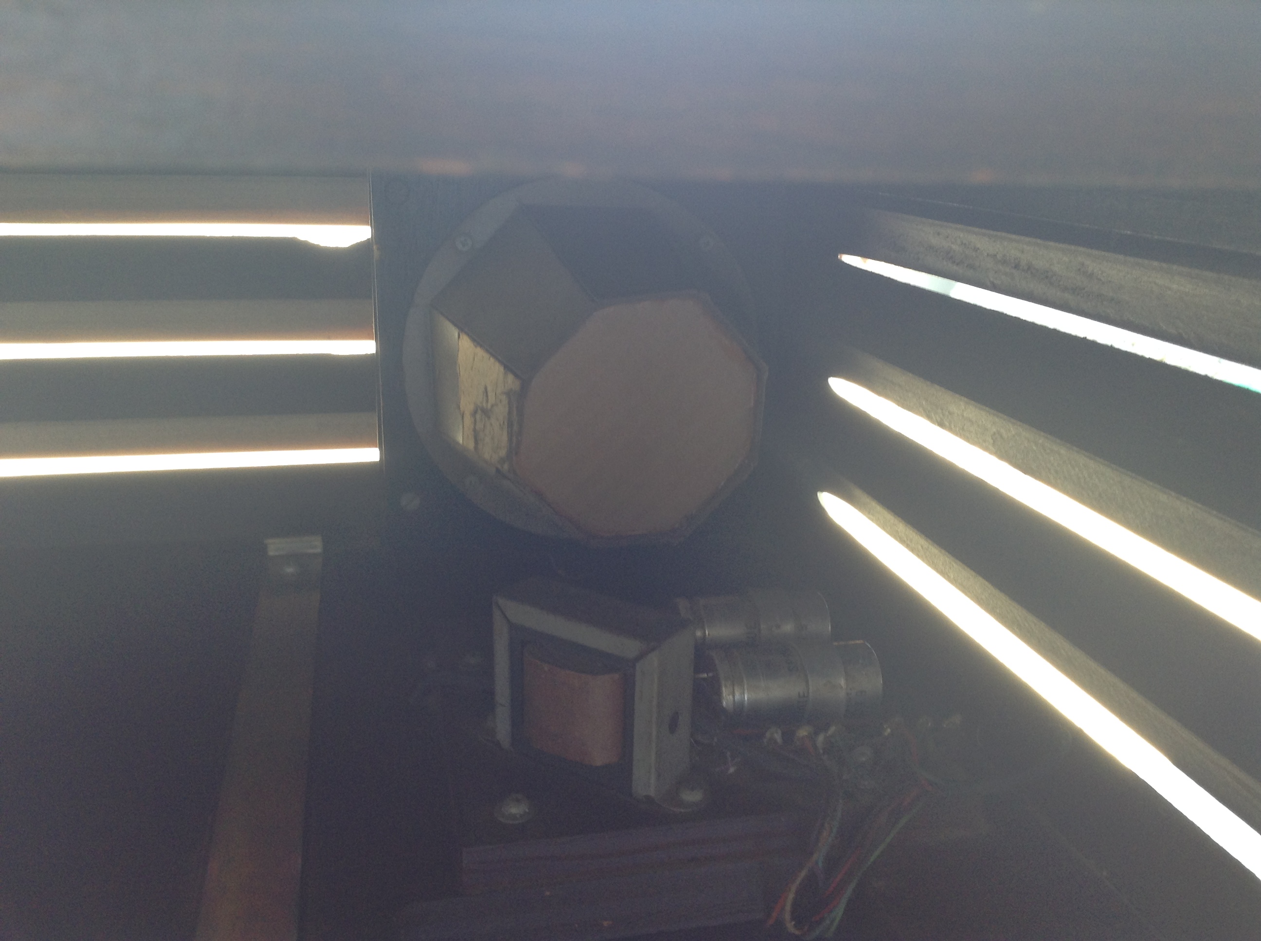

I'd not seen a speaker configured like that one. Does the speaker revolve, as opposed to the rotating baffle of the Leslie? Our high school stage organ had it's front and rear panels removed so one could see it's Leslie in action.

Rex, there is a double (back-to-back) set of speakers mounted to the upper rotating thing. They are only 4" with a counterweight at the other end. The bass speakers is in the bottom chamber under the amp and its stationary.
