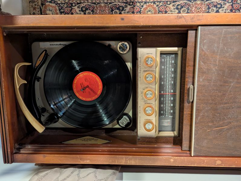

I have a Magnavox model 2ST643 with the 8803-00 Amp. I just had the turntable serviced and it's functioning wonderfully, but I am getting a distorted sound coming out of the speakers whether it's on the radio or phono etc. Sure would like to get it fixed up and sounding good.
