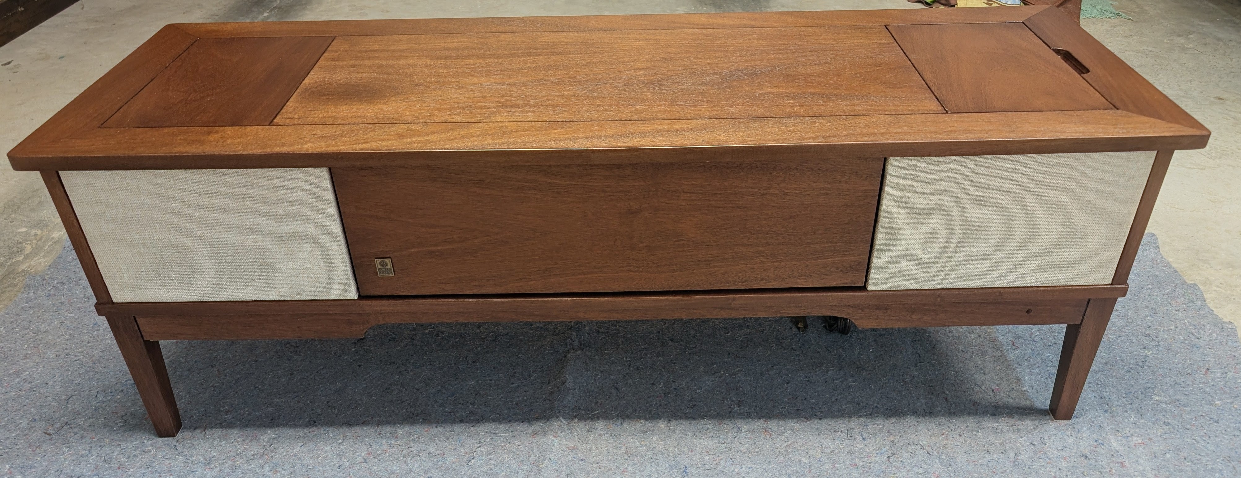

GE Wellington coffee table, model RC 4842-A

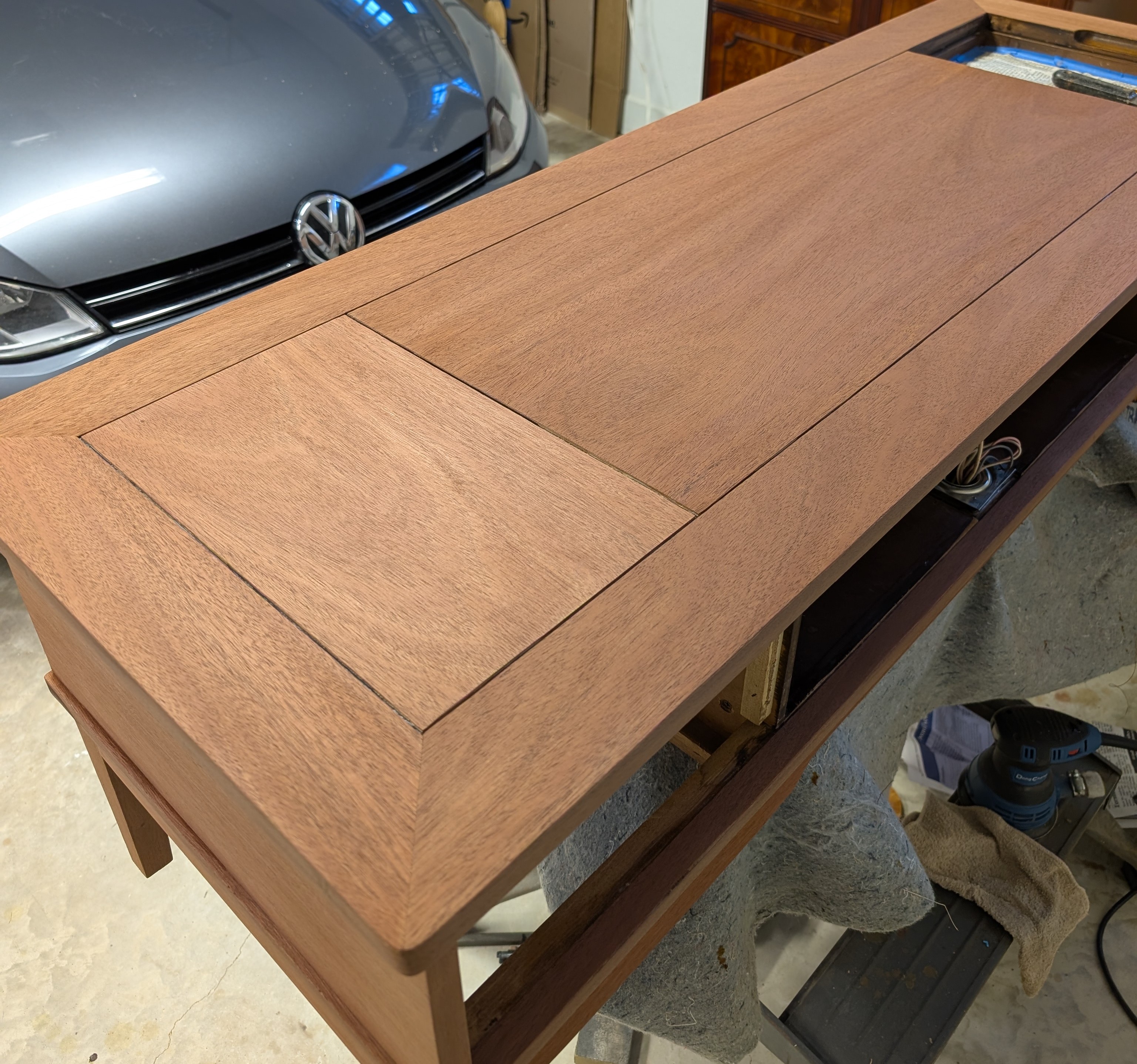

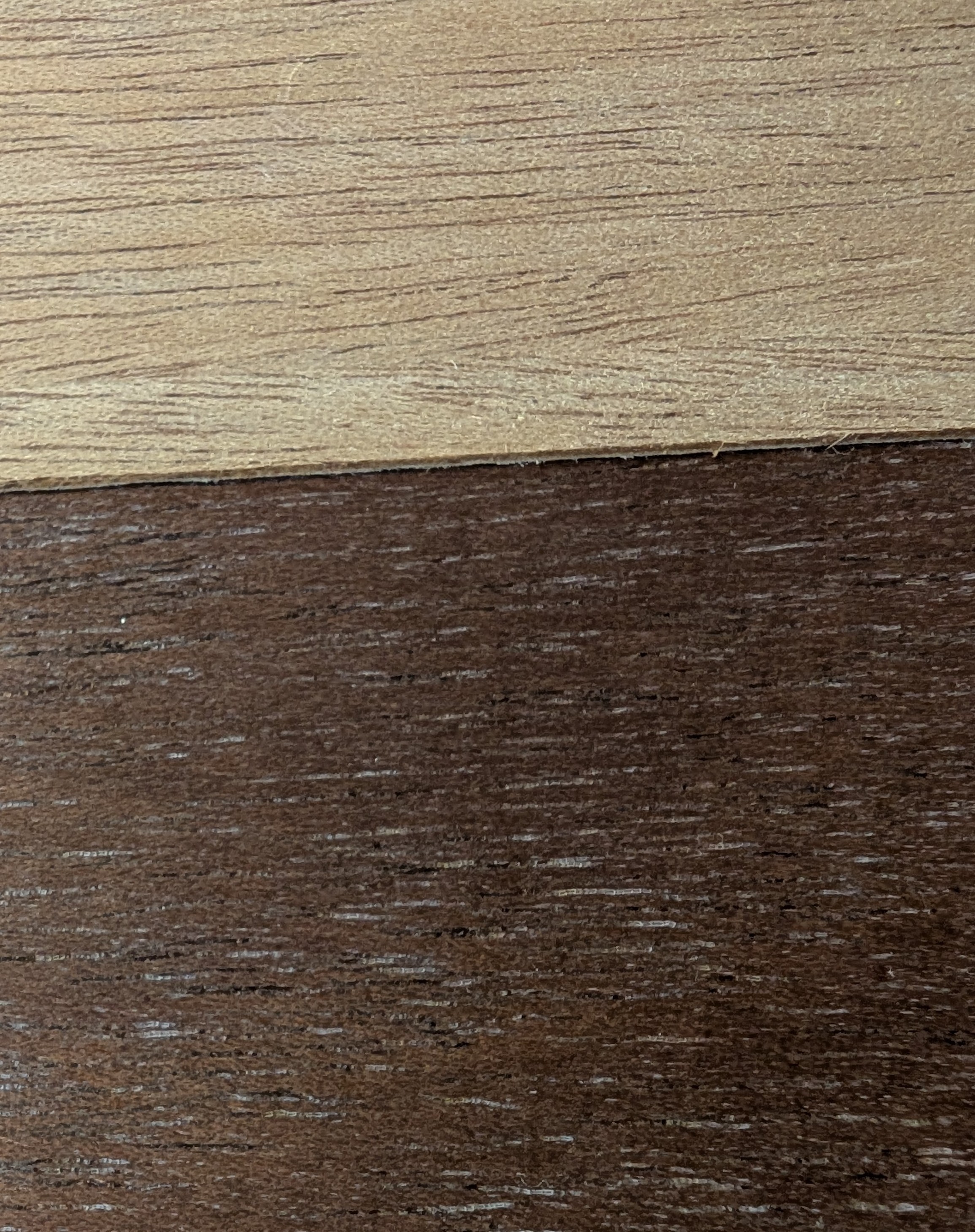

Well, after weeks of not posting about this project, here's an update. After prepping the veneer surface, and using the chemical stain, it looked great, but the mahogany veneer grain was pretty deep.
So maybe a grain filler is in order. I've never used filler before, but in searching the net I found a number of references to a water-based, clear filler called Aqua Coat. Most people said it was easy to apply and gave good results, so I ordered some and followed the instructions closely. But, after three applications on the top surface of the cabinet, I was bummed to see that the grain actually ended up with a white filling to it! Well, I thought perhaps if I applied additional walnut oil-based stain over it, it would tint the white portions and everything would be okay. But, that was not to be the case.You can see the difference in the grain in the photo below with a piece of scrap mahogany veneer. The grain detail was also significantly muted.
It seemed the only way to correct this issue was to sand everything off and start over on the finish. But, I was afraid that if I did that, I would end up sanding through the veneer that I had applied. So, I resolved to roughen up the surface and apply new veneer over it and start over. I was happy to see however, that as I sanded the surface down to prepare for another layer of veneer, it started looking really good! The sanding with 120 grit took off all of the old finish and the nasty looking white deposits in the grain. After that, I sanded with 320 grit and applied the chemical stain again. After that dried, I applied the walnut stain to the top. Now it's looking great and I will apply a washcoat of dewaxed shellac and then poly on top of that.

Filler-stains are available from marine suppliers. Try Defender Marine, West Marine, or Hamilton Marine. They're made by Pettit and Interlux. Long ago I had bought a can of grain filler at a surplus store. I finally used it on a Phillipine mahogany door--same experience: white tone in the grain. I lived with it since the door was fairly light and unstained anyway. But the marine versions work very well.
I had also used the aqua coat on the front of the newly veneered rotating changer enclosure, but only one coat, and it looks great so it didn't require sanding down. The manufacturer should warn the user about this issue....

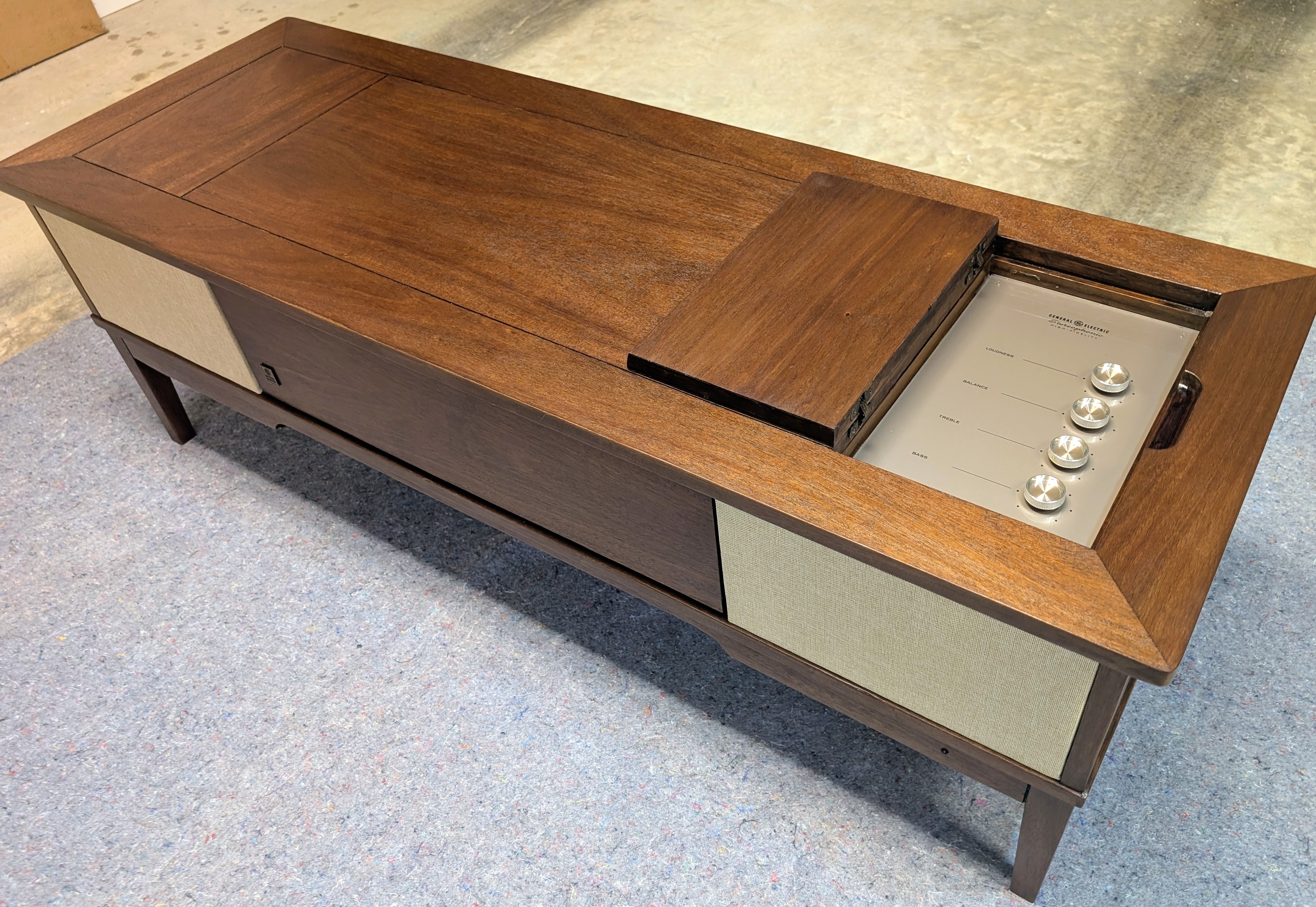

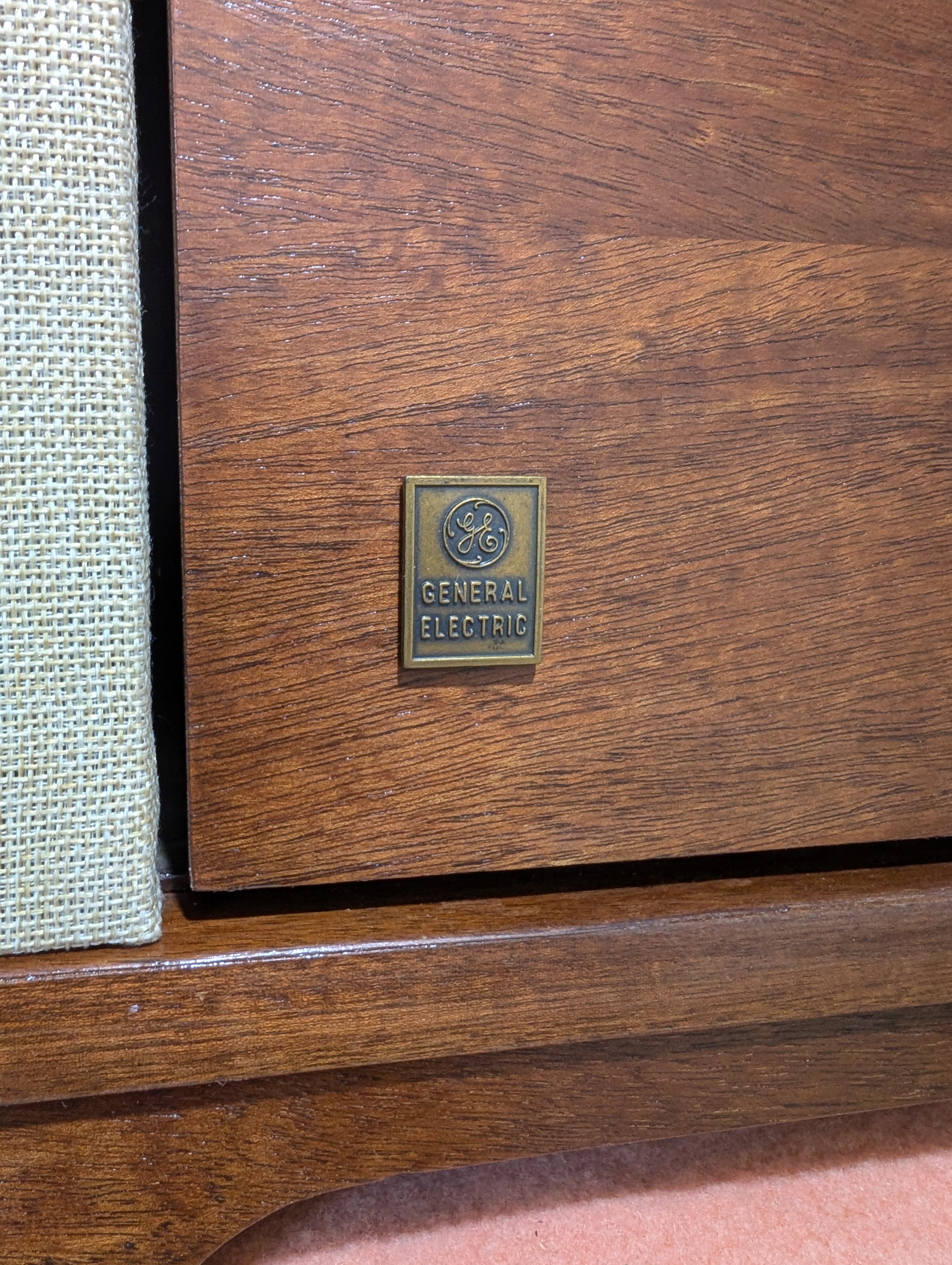

Finished, ready to move into the living room!

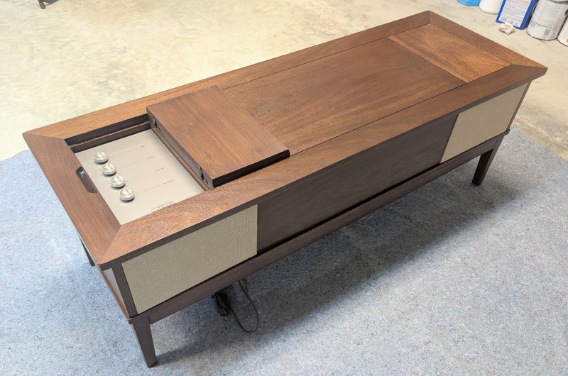

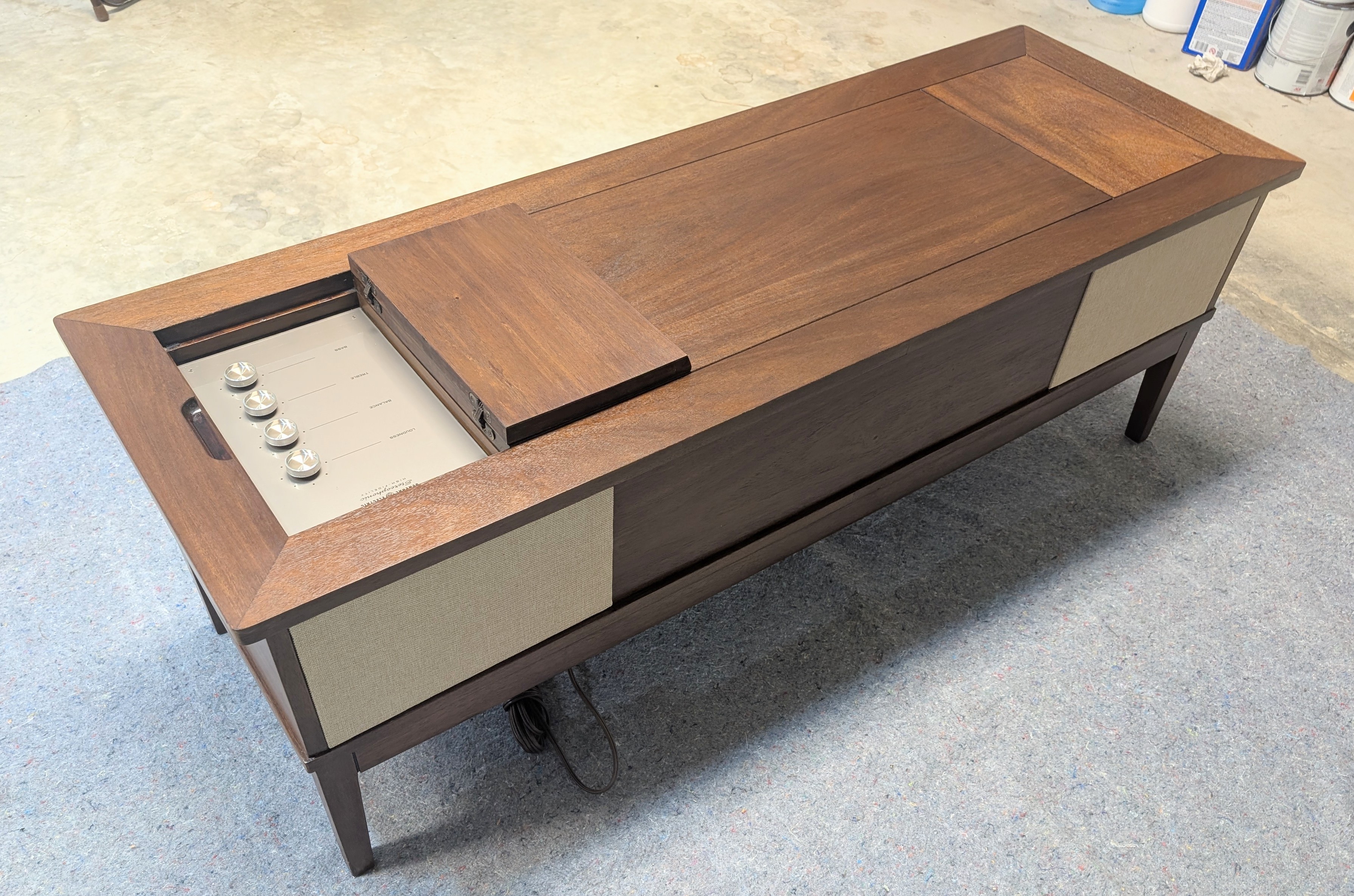

Finally. The wife loves it, so we'll replace our existing coffee table with this one! Here's several shots of the completed project, no more early American look. I took these pics in the garage (wife's car in the shop), but the lighting is poor. Interesting how the grain direction and lighting influences the look of the top panels--they are uniform when viewing straight down.

- Posts: 8980
Very nice!
It looks fantastic!
It looks fantastic!
- Posts: 3733
Wow, a completely successful makeover! Your work was rewarded with a really handsome device.
- Posts: 5422
Beautiful, and the color walnut I love. How does it sound?
- Posts: 8980
I think it would be fair to say that this is THE nicest GE cabinet on the face of the planet.
Thank you, guys, for your kind words. I learned a lot about veneering since every visible piece of wood is veneered!
It sounds pretty good, not like my Moto SK-111 of course. I've also added Bluetooth via a selector switch, I'll post some additional pics on that soon.

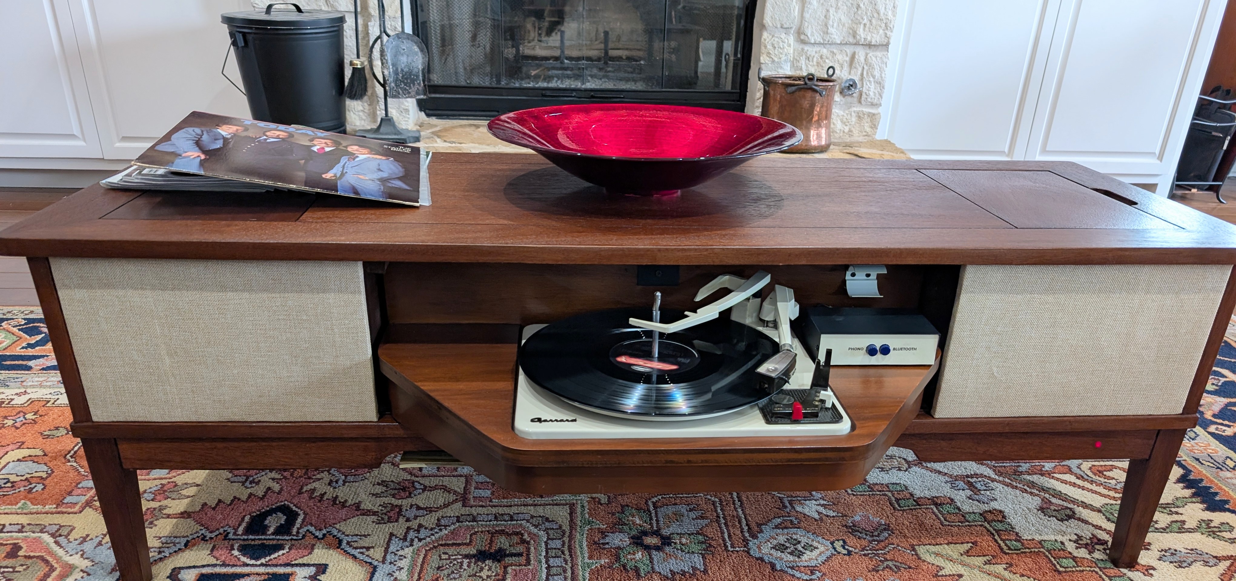

Installed and working! It looks great, but I'm not entirely satisfied with the sound, seems a little "boomy" so I might look into that later with a signal generator to see what's going on, maybe fiddle with the crossover caps.
The box next to the changer is the selector for phono or Bluetooth, I put the series caps for the Bluetooth (discussed earlier) inside it, the Bluetooth receiver is mounted under the changer panel, its power adapter is under the control escutcheon where the am/fm receiver would be "if so equipped". One problem is the power cord routing. To eliminate a trip hazard, I cut a small slit in the rug and cut a gap in the pad underneath to run the zip cord out to the edge of the rug, then a 90 along and under the rug edge to an outlet under a couch which is to the left of the photo.

It looks beautiful, nice job and well worth all of the work. Having a coffee table stereo is a problem when it comes to where to plug it in. Most homes do not have an outlet in the middle of there living room floors.
