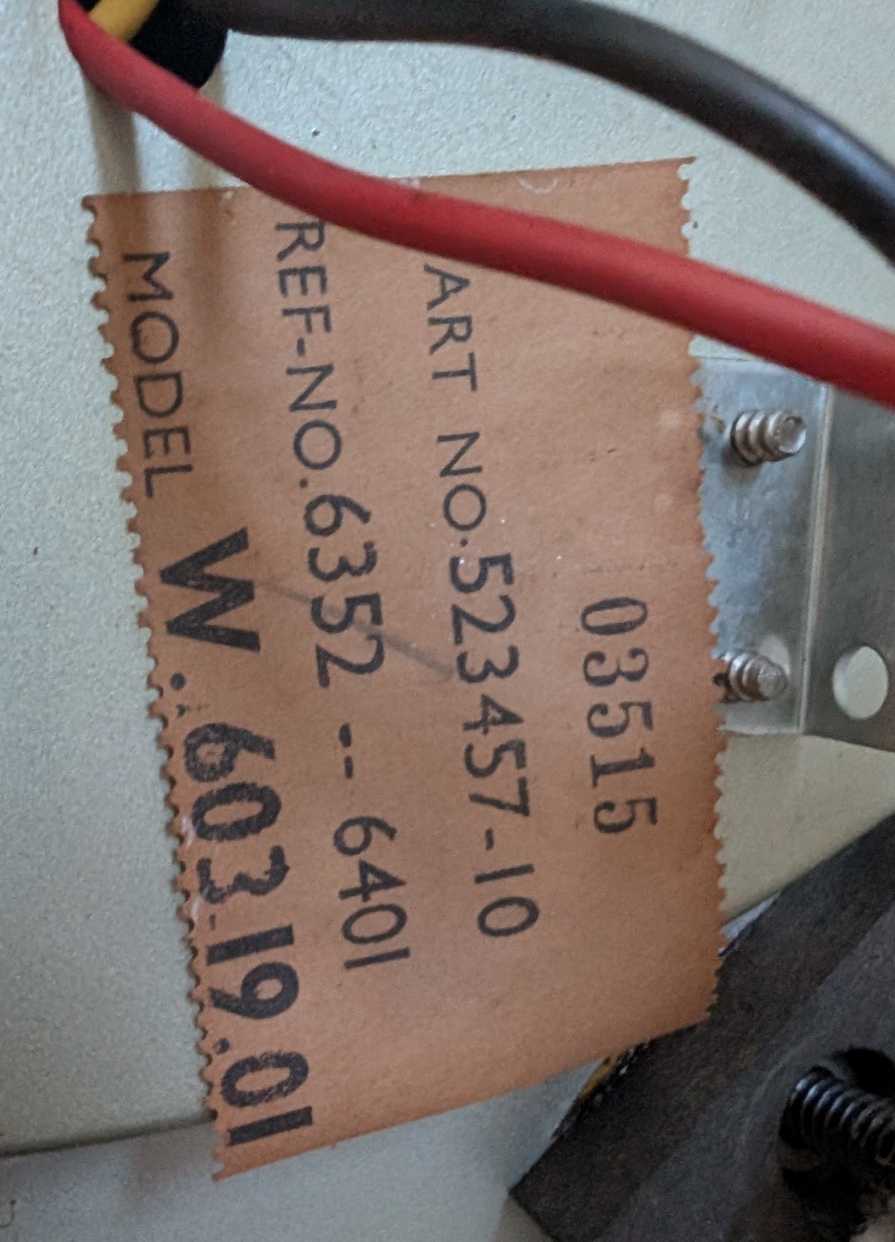

Just as an aside, I was under the impression that Collaro changers started using 11" platters in early 1964. The 9" like you have is typically 1963 and older. Would you have date codes on that changer you could share? It would be interesting to know if they used the 9" platters later than I am aware of.

I read that as last week of 63, first week of 64, but that's just my uninformed guess. The service manual for this model has a couple of pages of configuration options, some with 9" and some with 12" platters, various color and mute switch variants, etc. Probably a 9" platter since the unit is a lower end product.

I'd say you were right on the dates. That would make that changer one that was produced when they were making the change from 9" to 11" platters. Magnavox used their older stuff until it was gone, many times selling it right along with the new stuff. I have a 1963 Magnavox tube stereo that shared a cabinet with a new solid state model. And, it has an 11" platter. I thought it might have the wrong changer, but now I see they could be either way during the transition...

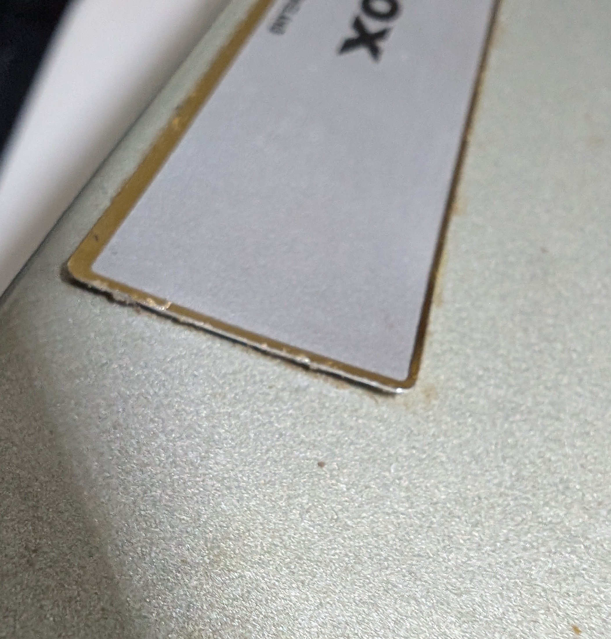

Since I've gotten the amp and speakers working on this portable, I'm cleaning up the changer some more, hopefully that will fix the tracking problem with the original caramic cart (as I mentioned in
https://www.classichificare.com/viewtop ... 2&start=20)
The stick-on label is curled up at one end, I've tried clamping it down overnight, hoping that would make it stick, but no dice. Any suggestions on how to making it stick?
Posts: 9072
Re: Micromatic W603 (1964-5) questions
Post: # 28908Post electra225 »
I would suggest you gingerly remove the label. I don't know what kind of glue they used at the factory, but it the label comes loose, it will never likely stick down again. After you get the label up and off the changer, see if there is residue left from the glue. Again, gingerly, remove the residue with a single-edged razor blade. Then I would use Elmer's construction glue or similar to stick it back on. Contact cement would work if you had some. Be careful not to wrinkle the label as it's almost impossible to straighten back out. Good luck.
Post: # 28911Post TC Chris »
This past fall I replaced the foam surrounds on a pair of Larger Advent speakers. The kit came with white glue. I had no idea that it was effective on steel (the woofer basket) but that's what they provided. On your label, my inclination might have been to use contact cement, but white or yellow glues are certainly more forgiving when placing, and easier to clean up.

Thanks for the advice on the label, I'll try removing and glueing.
