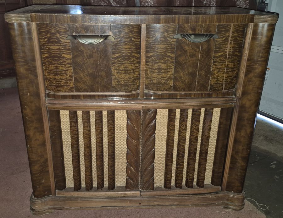

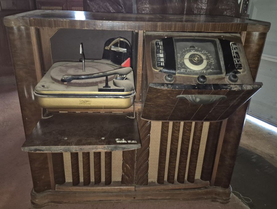

Out of the 15 post-war radio-phono consoles I own is this which I consider the heavyweight.
I do not consider Magnavox in this category.
Even my 1947 Berkeley will top the Zenith based on the pp 6L6 amplifier and 2x12" speakers alone.
The AM and SW sections on these are easy to restore and perform exceptionally well.
The FM discriminator is less advanced than later models, as it includes both old FM (42-50MC) and new FM bands.
The only drawback with most of the changers, they play only 78 rpm records.
I was getting bargains (free to $20) on these as they show up, I have the following:

The radio snoots turn their noses up at the horizontal consoles. I like them myself. They were early versions of console stereos. If you could find a later stereo VM changer with the snake head on it that Zenith used in their stereos, that would make a good sub for the 78-only changer in there now.
