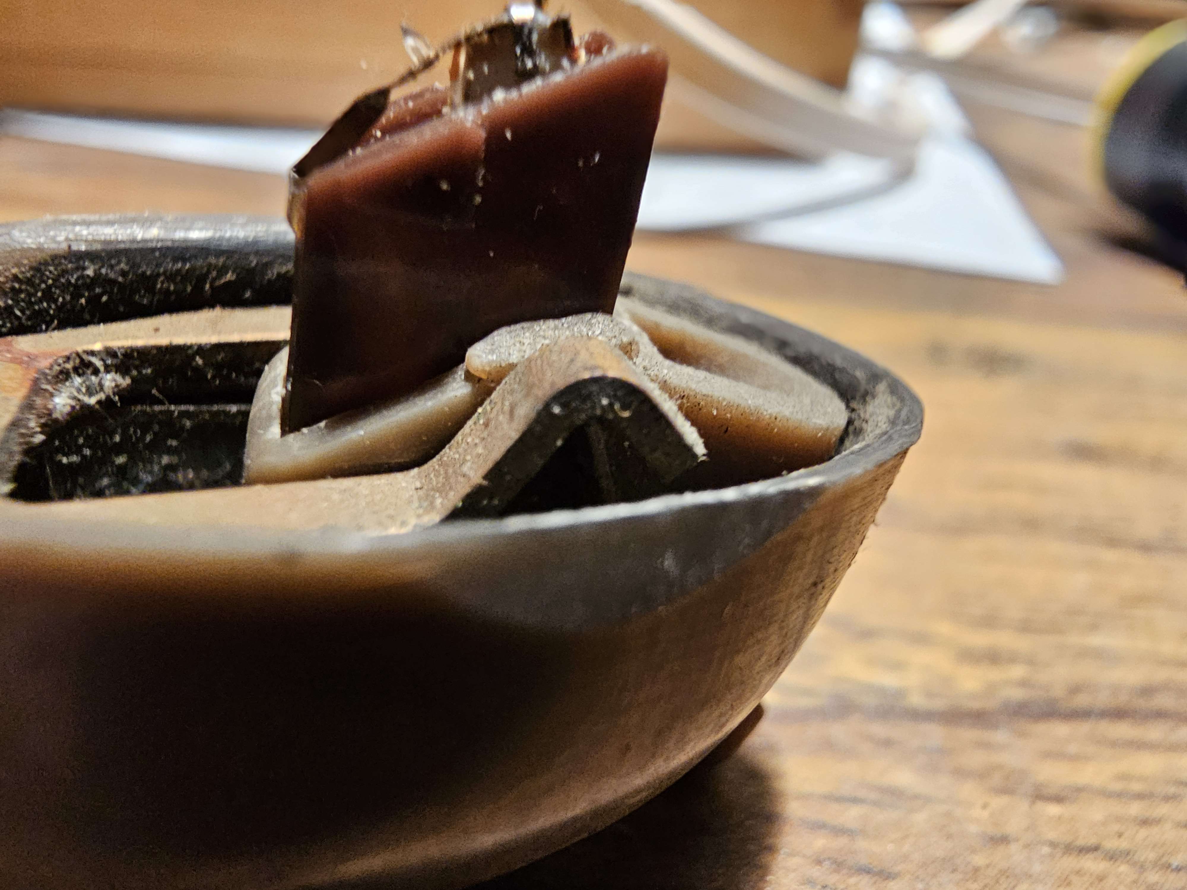

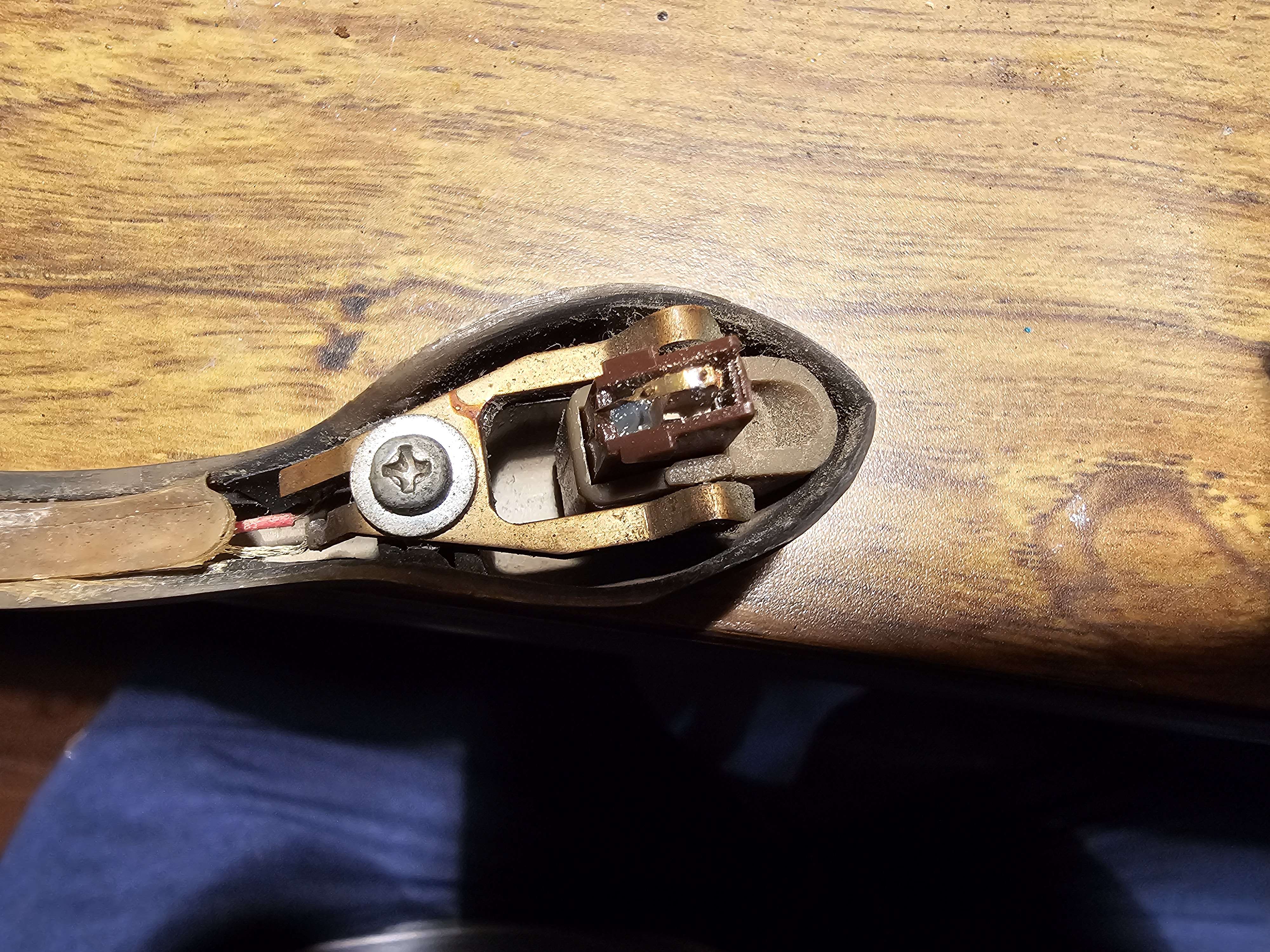

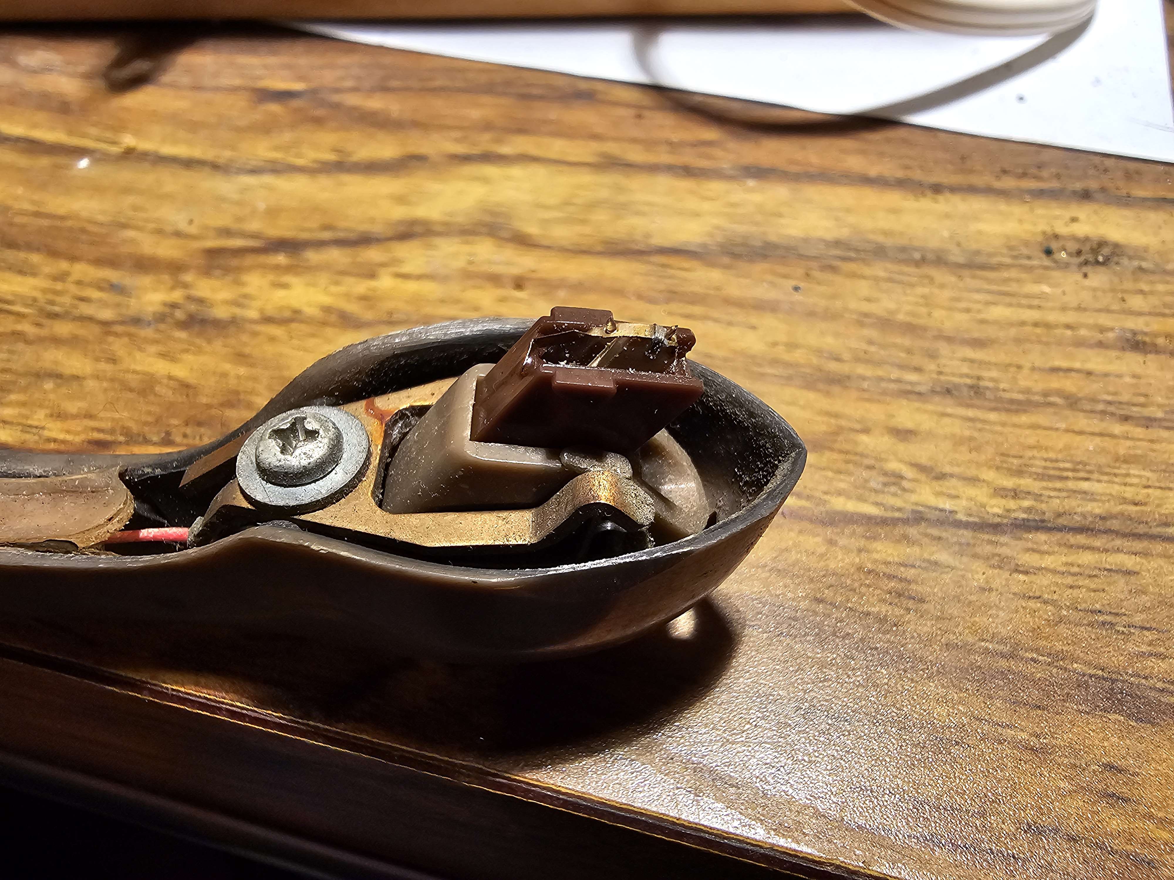

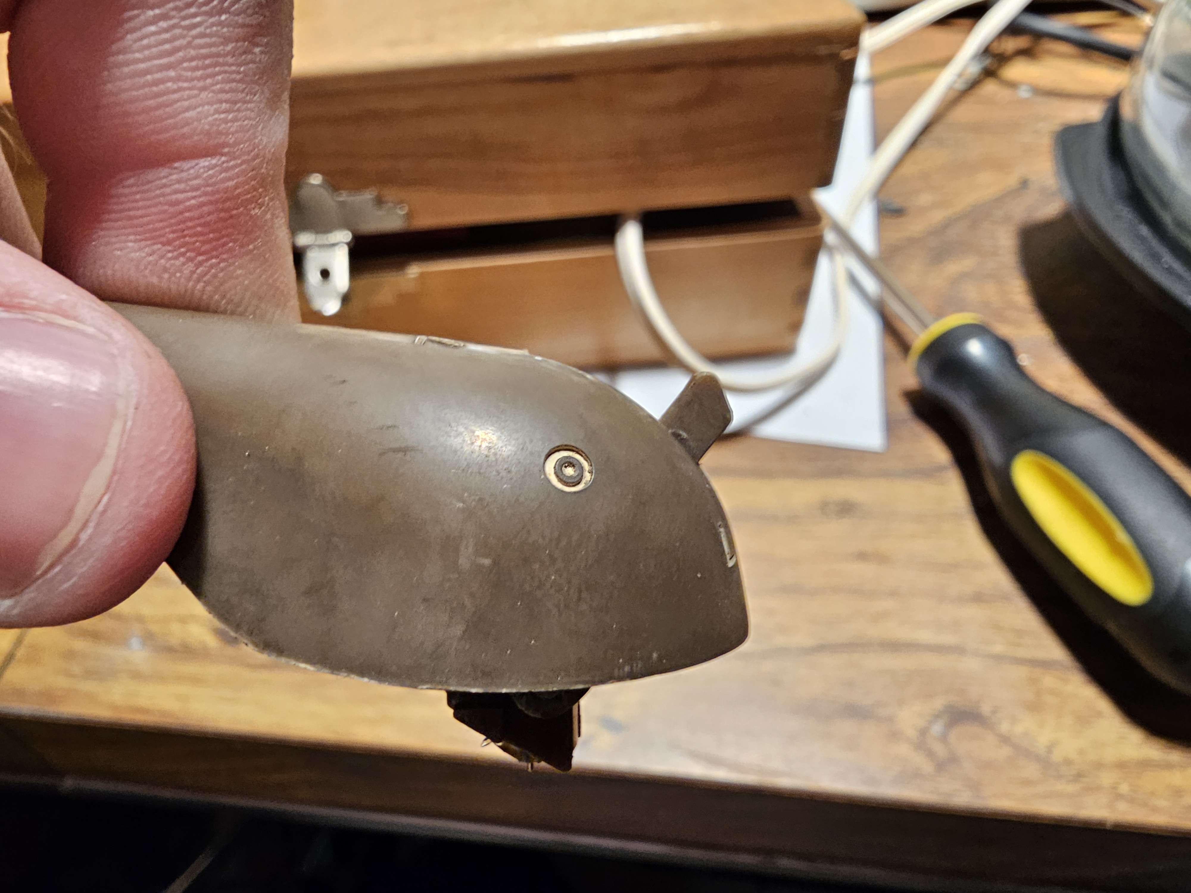

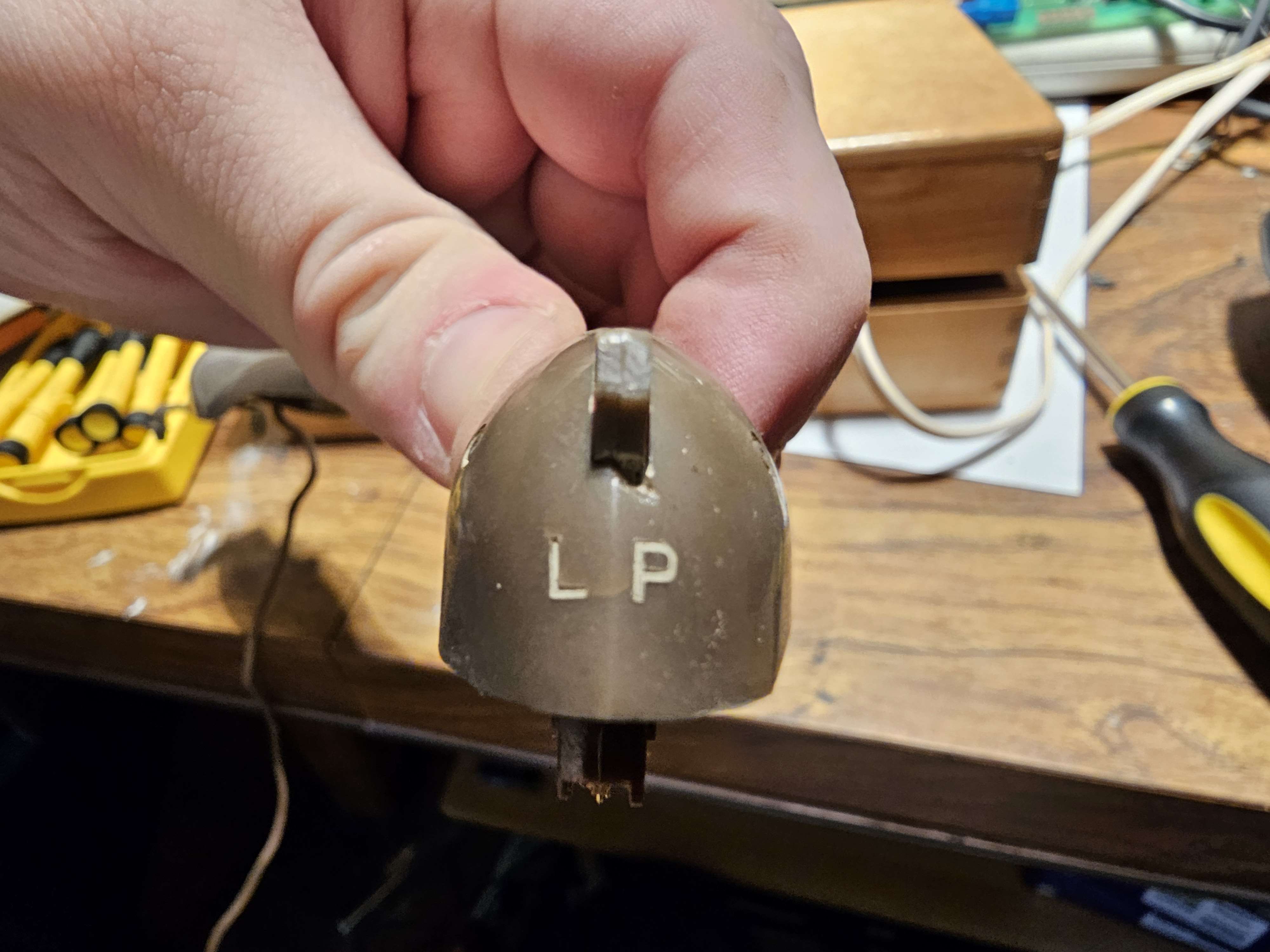

One last post just to close the loop on this. I'm putting it here since I had mentioned adding it in the past and don't want anyone who finds this thread in the future to come away empty handed.
I'm attaching a few photos of the tonearm mechanism. I'm glad I didn't have to recreate it. From what I can tell, the switch and cartridge socket are one piece of plastic. The socket has two metal strips inside that make contact with the cartridge and are connected to the tonearm wires, and there is some sort of metal prong attached to the cartridge on either side. Those metal prongs press against a curved metal arm that's screwed onto the bottom of the tonearm and allow it to slide back and forth for the different positions. It's a unique design. I'm not sure I've seen any other turntable use it.
Anyway, I'm going to eventually get this tone arm cleaned up and swap it onto my player. If anyone needs references in the future, I should still have mine available.

Re: 1956 Zenith Cobra-Matic Stroboscope Changer Transition
Thanks, Josh, and just for a refresher, what does the little knob/switch do on top of the snake head?
- Posts: 3776
That sure does look like a Radionic cartridge. I assume it tilts back & forth to accommodate stylii for 8 microgroove?
Bill - it's a switch between the two different needle types. Most cobra arms only accepted one needle at a time, but this variant is unusual in that it has a provision for a dual needle cartridge. The rarity is why I'm returning mine to its original setup.
Chris - I'm almost certain they intentionally designed these cartridges to look the same. It probably saved on development costs for new mounting hardware. It's definitely ceramic, though. The amplifier is missing the oscillator tube for the radionic setup. You're correct about the tilting mechanism.
