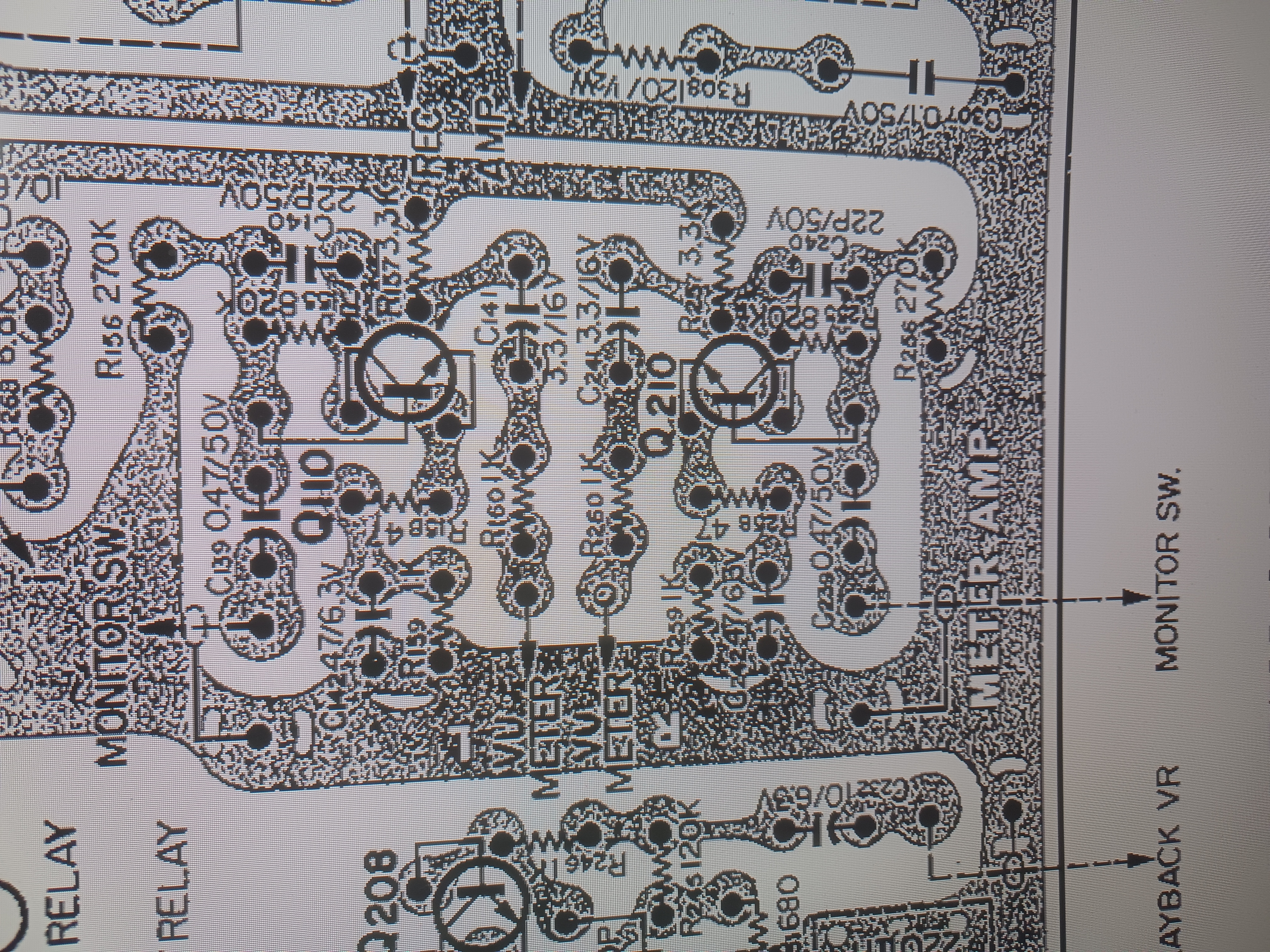

well the good news is the head is not open , I actually jumped the speaker to one of the preamp stages and I hear sound ,whew.... I found a manual for my serial # and it is great quality , but still a tad too small for me... so to enlarge the print... all these PDF sites want you to pay for that service...being the cheapskate I am , my workaround is enlarge the screen as much as possible, then take a picture of it then send it to the printer ...(see pic) I have found a few caps open , and now I am concentrating on the meter section as that is the final stage before the line output yet both meters are dead ... except on record , then they will swing ... nothing on the line out
