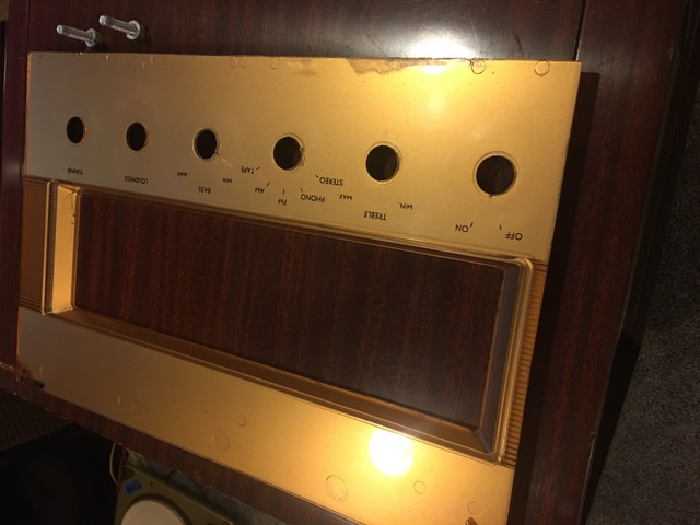

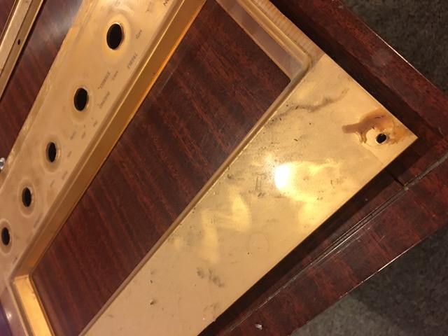

Hello Guys, Don't mean to bore you with just ordinary restoration stuff, Today is the day the Stereorama is getting worked on!

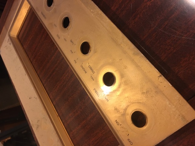

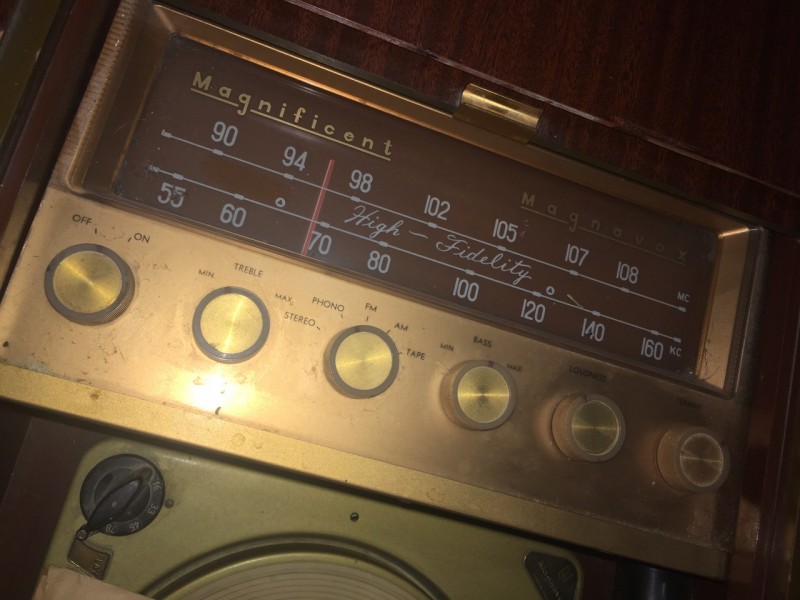

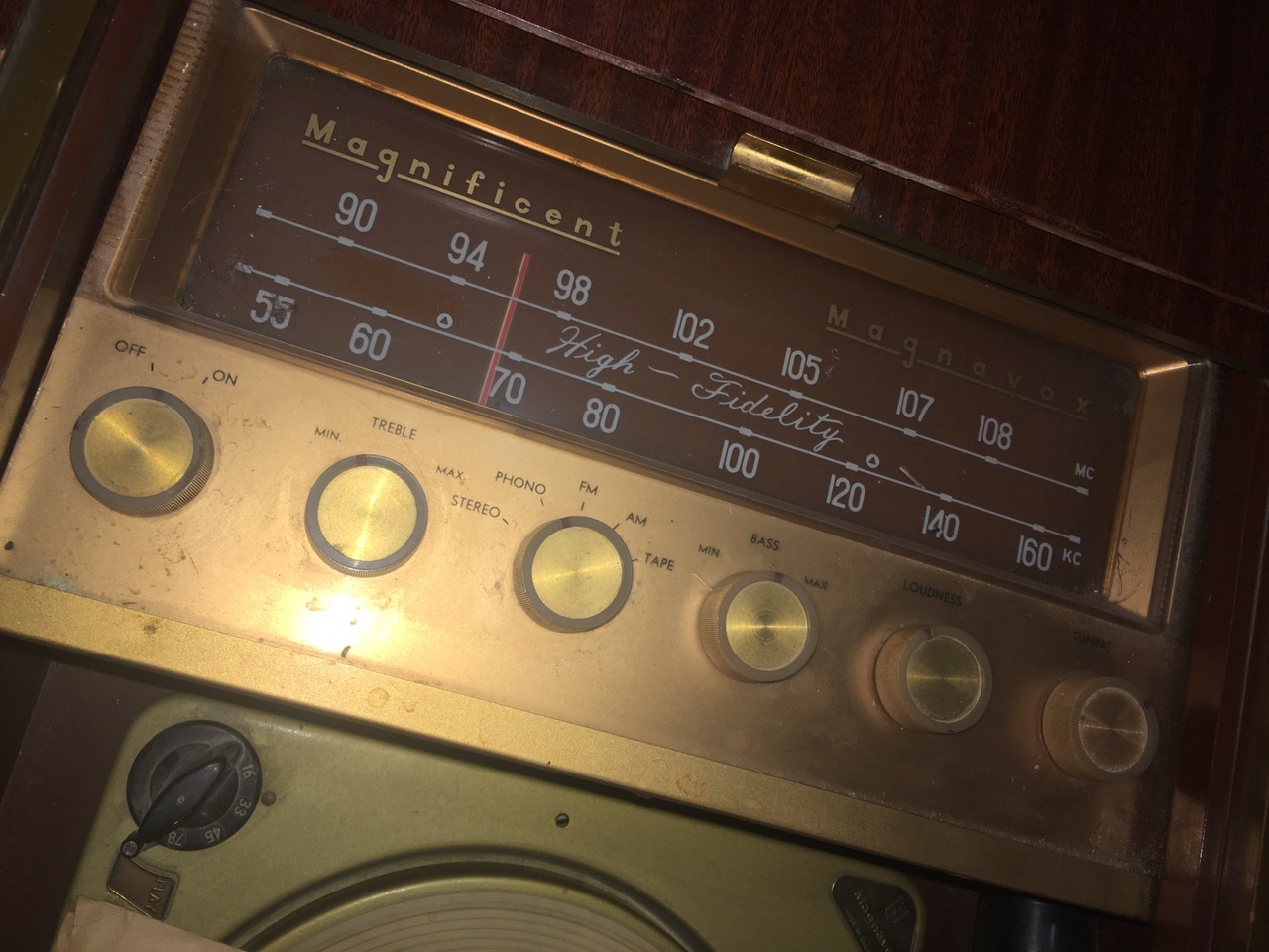

Last week i picked it up from Sound audio repair in Olympia. If i haven't complained yet, Olympia is 60 miles from Seattle and to drive there and back on a weekday afternoon is a chore. Two rush hours both ways. I left work early (at 1:00) and was back home at 6:30. 5.5 hours in the car! Anyways i have the Stereorama components. Started cleaning them up last night. This one doesn't have the nicotine coating it seems all the other ones have but it does smell damp and old. I found on the Continental that getting all of the dust out of the inside and using a brush with a vacuum in all of the seams did a lot to get the funk out of it. So today i think i will get the amp and preamp in. Hydro
- Facia dirt
- IMG_7426.jpeg (74.89 KiB) Viewed 4090 times
- Facia dirt 2
- IMG_7425.jpeg (70.6 KiB) Viewed 4090 times

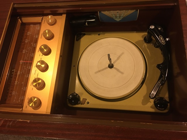

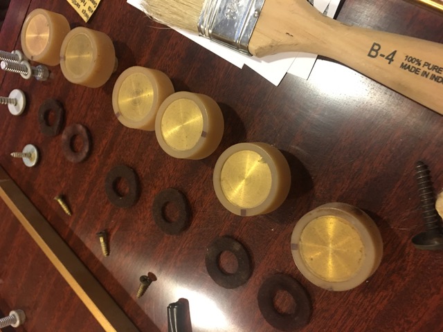

Re: 1958 Magnavox Stereorama (rebuild)
More photo's . Starting the cleaning process.
- IMG_7430.jpeg (61.33 KiB) Viewed 4090 times
- IMG_7428.jpeg (81.49 KiB) Viewed 4090 times
- Posts: 9074
We use industrial glass cleaner called Glance. It's made by the industrial division of Johnson Wax, Johnson/Diversey. It has alcohol in it, you can't make it streak and works well on grunge commonly found on old electronics. They recommend you don't use it on finished wood surfaces, but I have wiped finished wood with no issue. I wouldn't spray it on finished wood. It makes Windex look like mother's milk in comparison. Put some PB Blaster on a rag and wipe it on Magnavox cad-plated chassis. It will keep the white bloom down to a minimum and will make the chassis look sparkly for a long time. Good luck with your re-assembly.

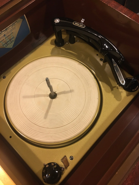

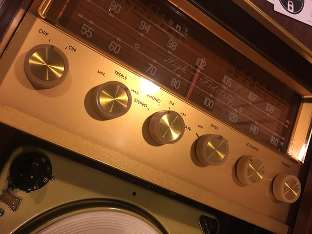

Hello Guys. Spent the whole day on the stereorama! was super disappointed when it fired up just a little bit of crackling from the speakers at first then started to get the volume and some full range after a bunch of minutes i ran it for about 3 hours while i cleaned the record changer. after a few hrs it was sounding really nice. Just from what i know about where it came from. I am guessing its been 30 years since it was last running.
Once i got it running in the stereo position it really began to rock! I tried to clean everything and even did the record changer. Using the 3m finess polishing compound even the plastic was shiny ! The new inline fuse blew and it quit i had to pull one out of another chassis. The sound is odd on this one when i unplug the base speaker with a mid range and a single tweeter on one side and two tweeters on the other. Also the odd bass speaker arrangement with fwd facing on the left and side firing on the right.
