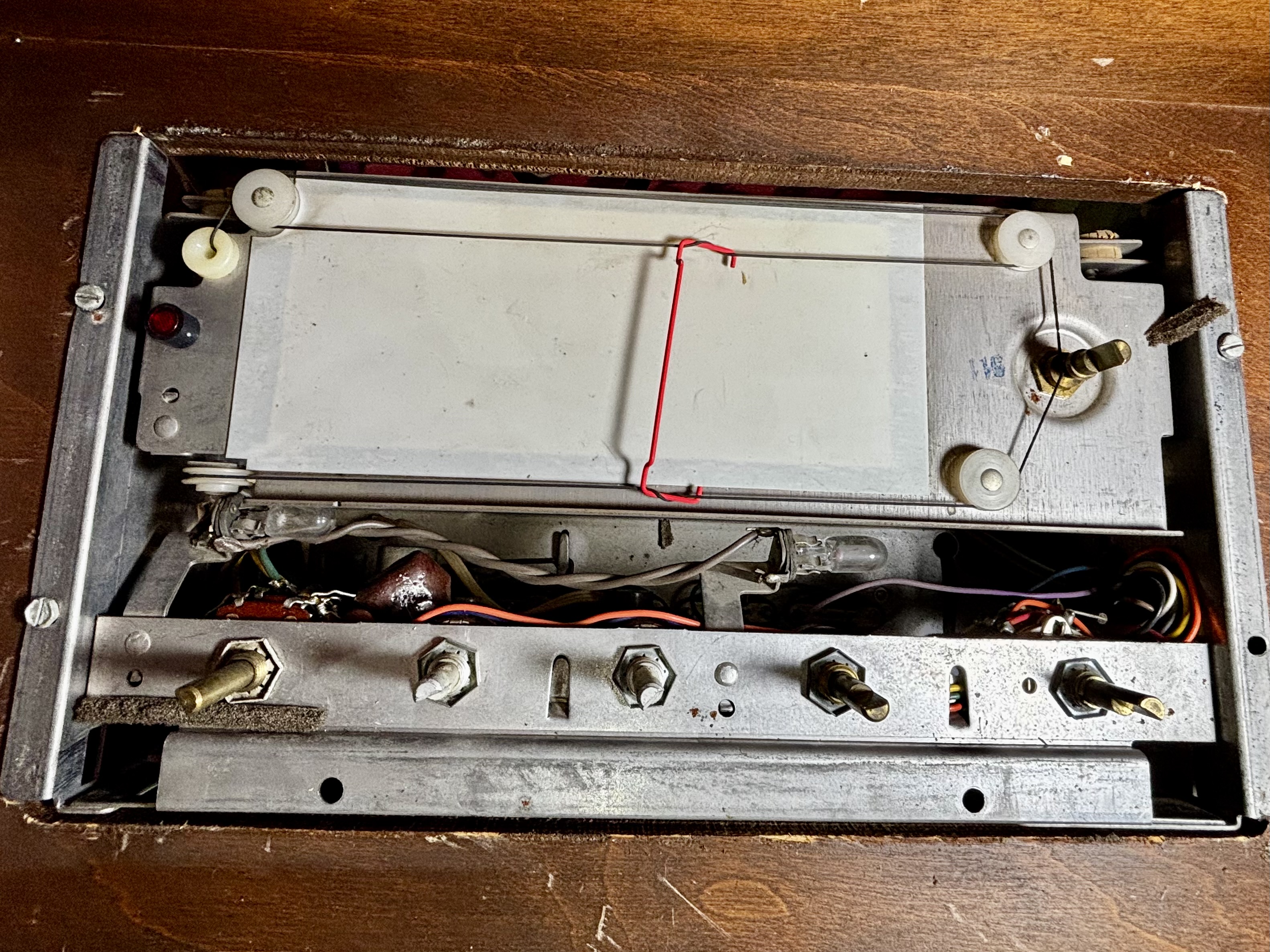

Cancel that call. Faceplate is off! This is fun.
W/ the faceplate off ✅

You may be able to spray those controls if you have a straw on your can of contact cleaner. See if you can see a slot on the round body of the controls. That slot will have a phenolic block with wires connected to it. That is where you want to squirt your cleaner, in that slot. Manipulate the control as you squirt the cleaner into the control. This will help clean it. It might be a good idea to stuff some paper towels in the area under the controls so the cleaner won't run down on the chassis. Be careful doing that. Common sense should keep you out of trouble doing this.

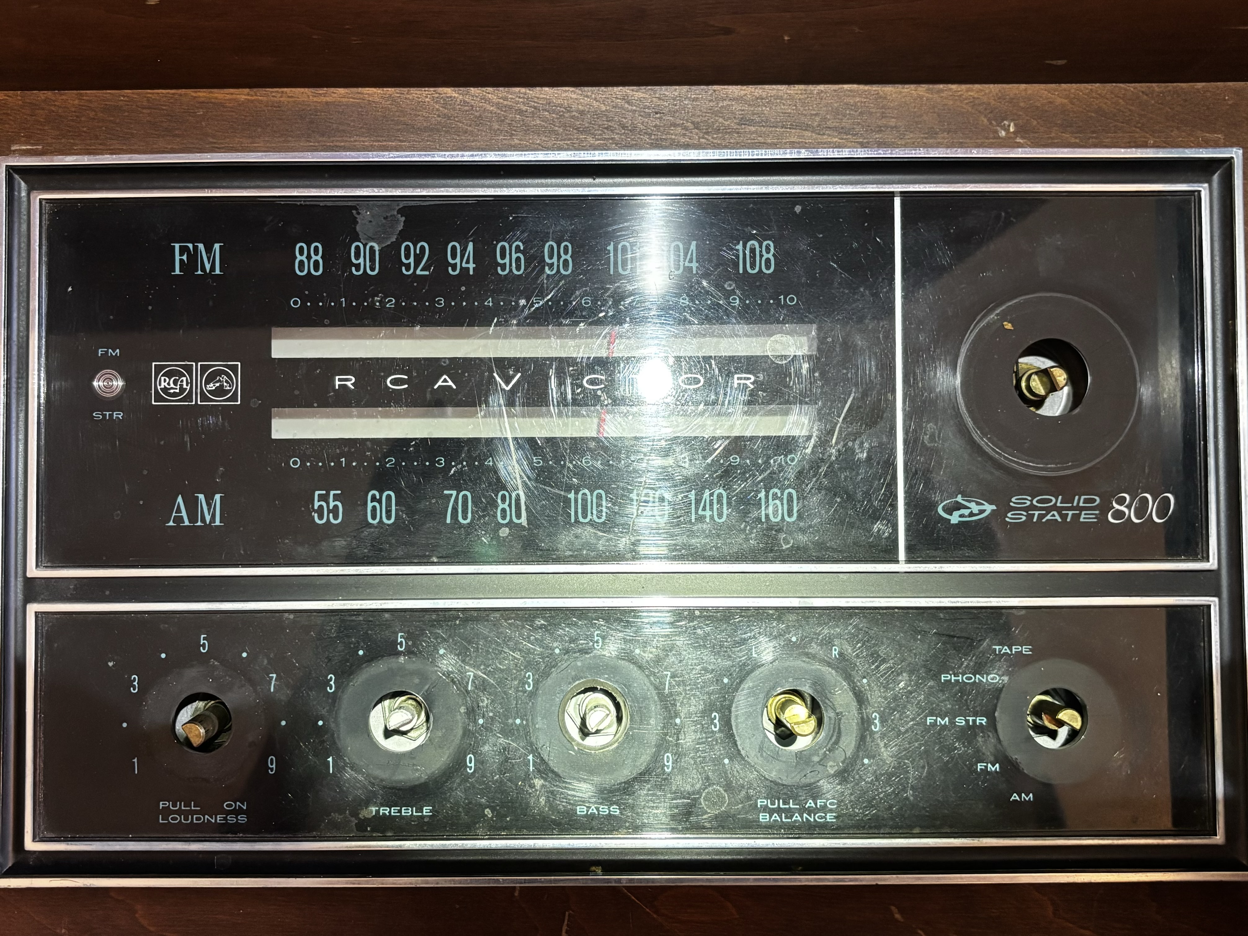

Yeah, I have Deoxit D5 with the little red straw, I backed things up with paper towels, and just sprayed each of these knobs although none of them had a slot, just hoping the cleaner got down between the cylinder and whatever casing it is in,? And I turned each knob like 100 times and then added a little more to the sticky ones, the volume and the one that chooses between the functions, and then turned them a bunch more. I don’t think I’ve ruined anything yet ✅
Here is a little better picture to show those control knobs to you guys. From right to left is the pull on and volume button, then treble, then base, then balance, with pull up on that AFC, and lastly, the action selection knob from stereo to phono, or a.m. etc.

Actually right to left in the pic ↩️

If your RCA is like most of this era, Electra's suggestion of removing the knobs is correct and the dial bezel should lift off. If I am right, it is held down with clips that are attached to the dial bezel and if can hook your finger nails under the bezel you should be able to lift it off. If not something thin that won't damage the wood can be used too. Your cleaning looks good so are are already doing the first step. Until your next post, hang in there.

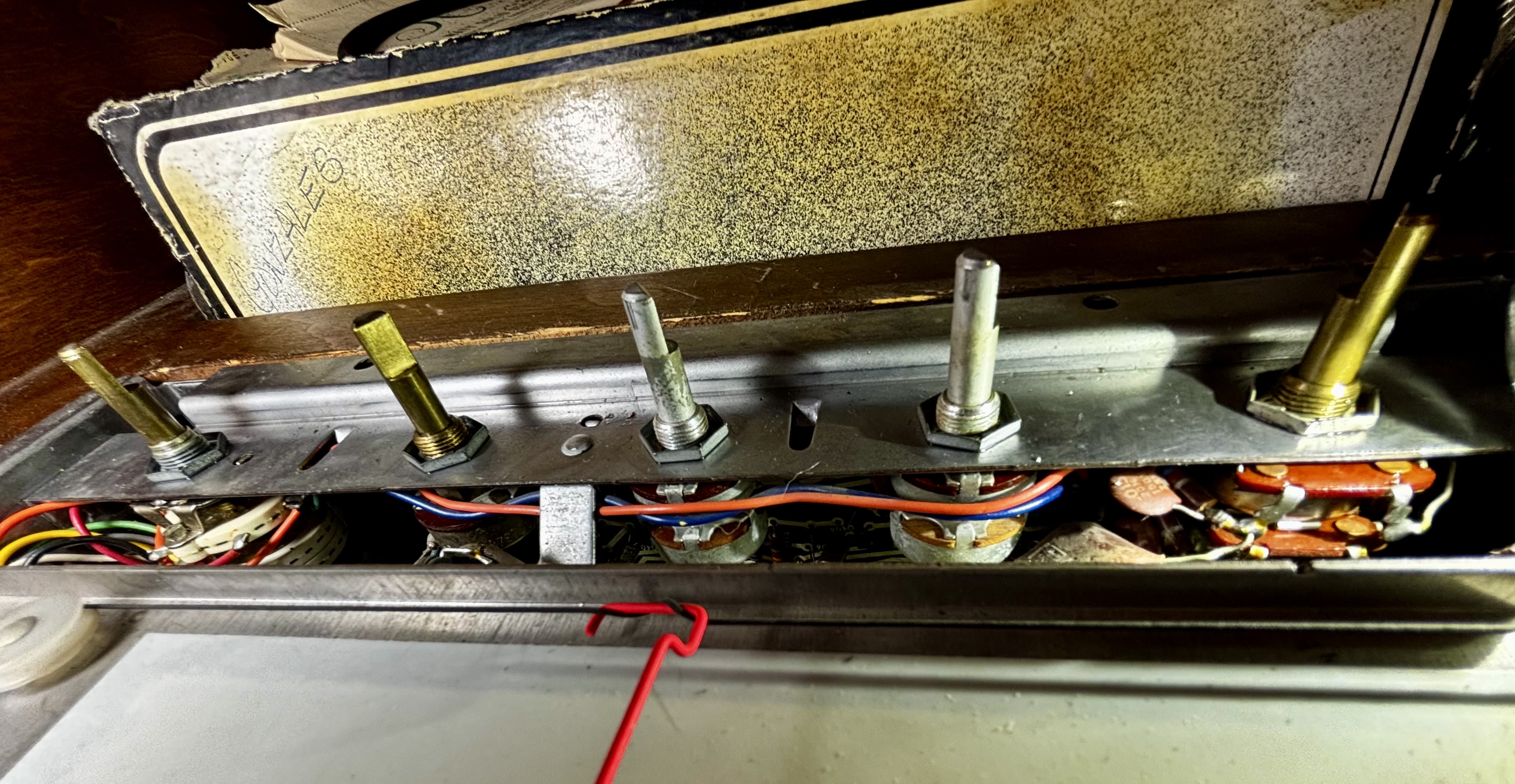

The knobs you see are on shafts that turn the actual innards of the control. Those are usually visible inside the chassis. They look like miniature tunafish cans. Inside those cans are circular resistance elements, which is where you want to get the control cleaner. How to get it inside? Look for the lugs exiting the covers--usually 3 of them, with either wires attached or soldered to printed circuit board traces, That's where there's an opening to squirt some stuff in.
The circular resistance element inside has a wiper, driven by the shaft, that rotates over it. The length of resistance element that the wiper engages controls the total resistance in the circuit to affect volume or tone levels.
There will also be a rotating switch to select among phone, AM radio, FM radio, etc. There are often rotating devices. You can see how a rotating tab engaged various contacts. This is where I try to use an artist's brush to apply the cleaner sparingly.
For each device that you're cleaning, apply the miracle stuff ad then rotate the control back & forth to make it work.

A couple of things, to the right of the receiver is the speaker selector switch. That needs to be cleaned too, if dirty it could cause some of your weak right channel. I would also suggest that you pull the receiver and see if you can get a better angle at the openings that Electra talked about. The openings are where the side wires hook to the controls.

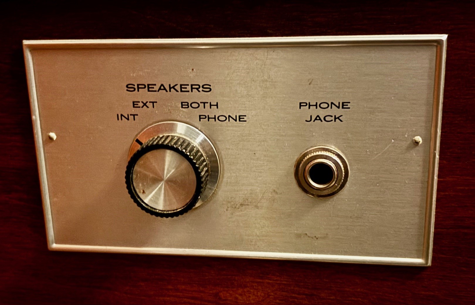

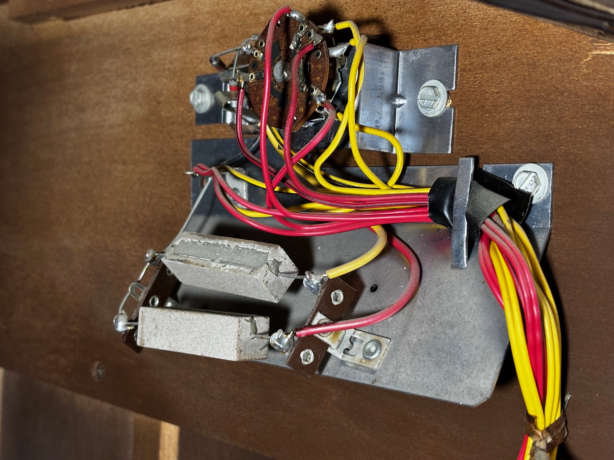

-I have NOT cleaned any cleaned any "external speaker switch". I assume that is the thing in these two attached pictures? User side & back side? I can do that if that's what should be done?

Technically, it's the chassis you should remove--the metal structure holding the electronic parts. That may involve pulling the knobs. You may also have disconnect some wires, although you may be able to get away with just pulling the chassis out and keeping it near enough that you don't need to disconnect things. Then you will have access to the back of the controls.

Does anybody know what those two sand resistors under the external speaker switch are for? I'm guessing something to do with the earphone jack, maybe?
Posts: 5466
Re: New Vista RCA VGT 90 W K
Post: # 24999Post William »
Yes, that is the speaker switch we are referring to that needs cleaning. Also, if you refer back to the photo that shows the bare chassis, no knobs, no bezel just shafts sticking up and the tuner dial needle, you will see three screws. If you remove those screws you should be able to pull the chassis straight up and like Chris mentioned, maybe up enough to have better access to the controls. If not, then you will need to carefully remove wires making sure you know where each goes. Again, not hard to do but it will take a little time.

Post: # 25000Post William »
I am not sure what they are for, but my RCA Home Theater has them too along with other components attached to them. Head phones would make sense.
