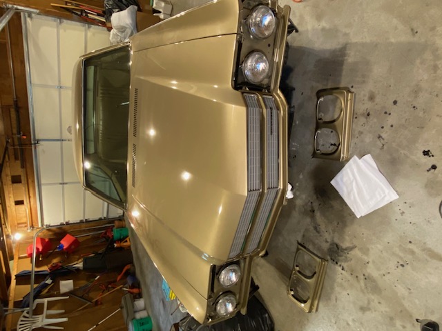

This is for my 1970 Malibu. My Dad ordered this car new from the dealership. It has been in the family since new. It has under 94,000 miles on it. I've been doing restoration work (with major stuff farmed out) for 25+ years....on and off thanks to some personal stuff to deal with in between.
I'm not going to wreck a numbers matching engine with a Chinese made camshaft ordered from JEGS that wasn't conditioned properly at the factory. I hope that makes sense.

- 1970_front_end.jpg (111.42 KiB) Viewed 16672 times

I think we all get it, and all prefer to do things in the same manner that you are planning. By the way, Joe, nice looking Malibu and for it to be a family heirloom is even better.
