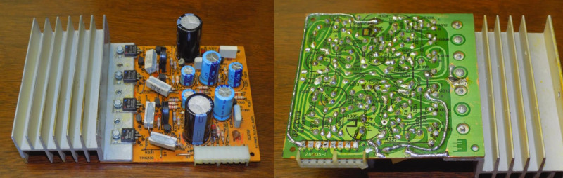

The power amplifier portion was all on one modular plug-in card and heatsink, shown below. From my research into the literature, it appears to be about 12W per channel, using push-pull totem-pole TO-220 package NPN transistors on a 45V supply. Typical of a low-medium power amplifier, perfect for a single room or light listening (and about the same output as my Magnavox 9300 tube amp, and the germanium A531 amp). The bias adjustment trimmers were large black units next to the ceramic emitter resistors. The original output capacitors were an anemic 1000uF at 25V, I assume primarily limited by space on this small board. I upgraded to the dark blue 4700uF at 35V, and I can now hear a much better bass response at the lowest frequencies, with more punch, especially into my 4 Ohm speakers. You have to be careful going too big here too- This design does not have output relays, so I do get a bigger whump in the speakers when I power it on and off now. I considered putting some smaller value poly caps parallel the output electrolytics for higher frequencies, but I doubt my ears would hear any difference. I did reinforce some very long thin traces for a speaker output, supply, and ground on the amp board, and it made a placebo improvement in my mind at least.

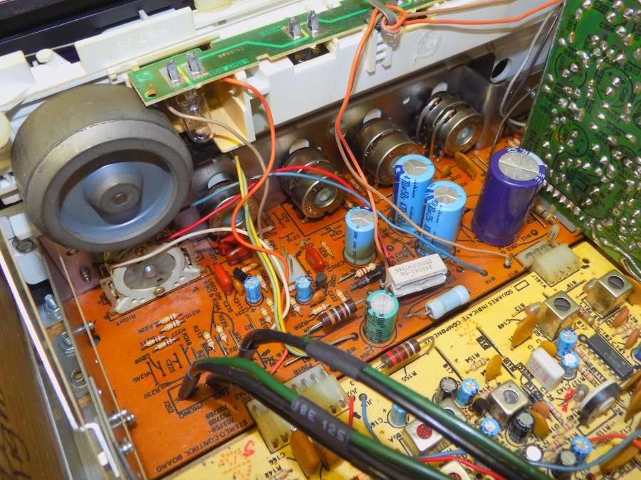

After the output cap upgrades, I pulled every electrolytic capacitor one by one and checked it. I was at first inclined to change them all, but honestly it was not worth the expense to buy all new, and my junk stash had many older capacitors that weren't necessarily guaranteed to live any longer than those already there. These original caps were all Nichicon, so I only replaced the ones that were actually going bad. My LCR meter does not measure ESR, but it does measure capacity and leakage current. I found no cap had leaked or bulged, and all were within spec and had very low electrical leakage (Go Nichicon!) In the end I found only one bad cap, the only green one right next to the hot power resistor as you would expect. It had been replaced before some time in the past, with little wonder.

This design powers everything from one single-ended winding 45V supply, with a string of hot dropping resistors to generate a slightly lower bias supply, the 22V for the radio, and several others. Cheap and simple if you don't mind the heat, effective until it's not. Dial lamps come from a separate 6V winding. The primary filter capacitor was originally a tall aluminum can of 2000uF. It was still good, but I replaced that with the modern 4700uF of higher voltage that you see there in dark blue. I could have used a much larger value, but with diminishing returns- Even with the 2000uF there was no audible hum at maximum volume with this unregulated supply, and I really did not want to overtax the small poorly ventilated transformer with increased RMS heating from higher rectifier current peaks for little return. 4700uF should give additional dynamic response to the bass with little downside, so was a good balance.

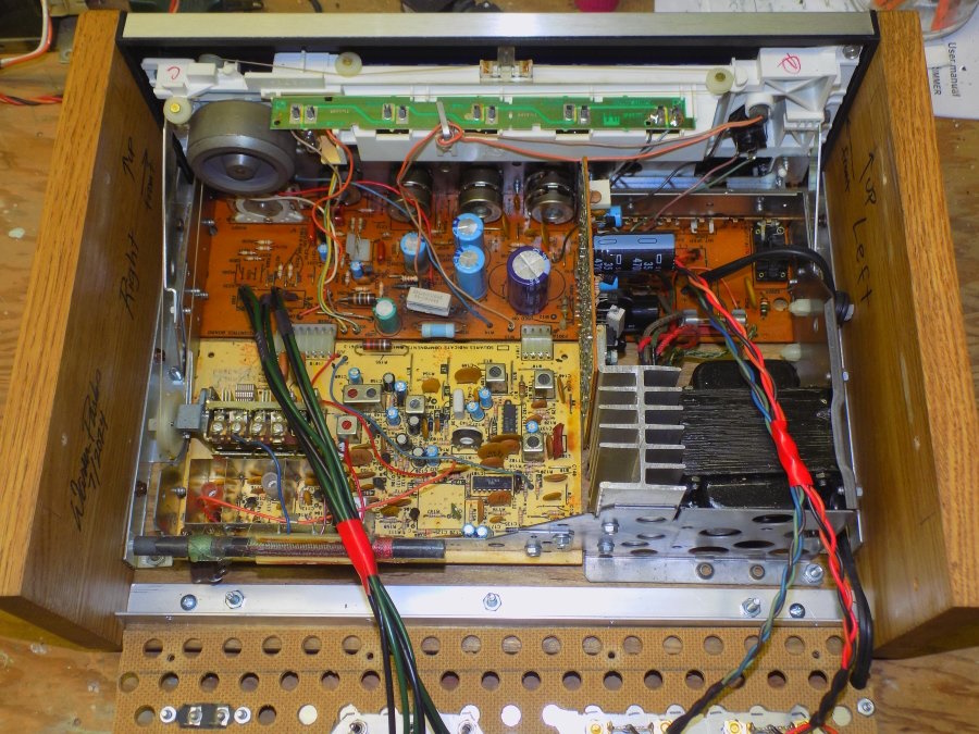

Lots of other little upgrades were necessary- The boards had many thin and broken solder joints from thermal expansion- particularly near hot resistors, places where shields or metal frame was soldered to the ground, and around the board to board connectors. I wire bridged across the two connectors to the radio board rather than remove them, and opted to just clean the connector to the vertical amp board so I can continue to remove it for servicing. I removed the source input and speaker output plug-in connectors and soldered leads directly to the board. I replaced a dozen or so ceramic capacitors that were in the audio path through the volume and tone controls with poly type capacitors. The larger brown ones matched the wider lead spacing and are visible on top, and smaller flat green chiclets are connected pad to pad laying flat on the bottom as their lead spacing was much smaller. This too made a good improvement in the sound quality- better low bass from some increased values in signal coupling, and less distortion from the improved linearity of poly over ceramic in all of the filtering roles. I removed the simplified RIAA filter used for the ceramic cartridge phono input and converted it to be a third "aux" input. I had quite a chuckle when I discovered that the headphone jack was wired L-R backwards. (I doubt anybody noticed.)

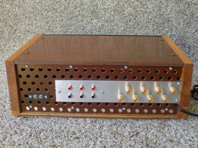

I built the cabinet from scraps I had around my garage. 3/8" plywood for the bottom with ventilation holes under key hot areas. The oak sides were cut from an old cabinet door from the local Habitat for Humanity- best $3 ever. The Mahogany top panel, perforated waffle-board back and brown screws came from a 1961 console- back when they used hardwood veneer on the sliding top panels. The big and only expense after the photofact was the set of Chinese RCA input and speaker binding posts, and machine screws from Walmart. The stain on the oak sides is Dark Walnut Watco Danish Oil - I love that stuff- nothing like a silky smooth rubbed oil finish on hardwood. Slather it on a couple of times to soak in, wipe off the excess, and it air dries hard inside the wood. Ever get a stain or scratch, lightly sand the area, re-coat with the Watco, and bam! like new- never shows. It definitely gives the oak that 70's dark brown look I was trying for. It badly needs labels on the back for all of the inputs and outputs. If anybody could suggest a reasonably easy way to do that I'm all ears.
Anyway, give it a looksie. It sounds great, it has a beautiful lit-up blue display, and a warm funk-a-lishous chocolate velvet vibe (Ron Burgundy approved! ) It's a lot of fun for a component receiver I have less than $50 invested in, and a great piece of Magnificent Magnavox history. What it lacks in pedigree or quality, it sure makes up for in soul. I have to say it again- It is fun! Really takes me back. I can see this taking an honored place in my den, driving mellow tunes through some large, equally vintage 3-way speakers. Maybe I'll don a smoking jacket, and sip some fine brandy . . .
