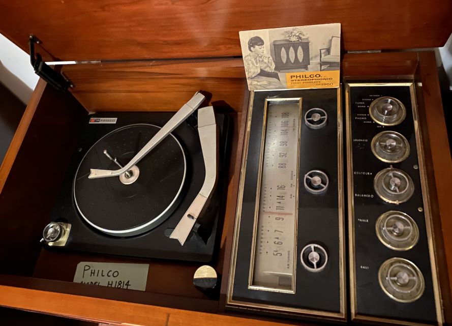

From Hudson Valley above NYC, came this Christmas present from my two best customers of restorations, electronic that is!
I know that someone on this forum has one.
I can now sell this one 1960 H1814, as its so compact a home is easier to find!

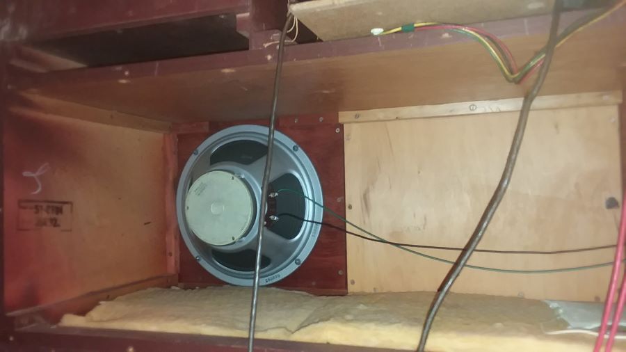

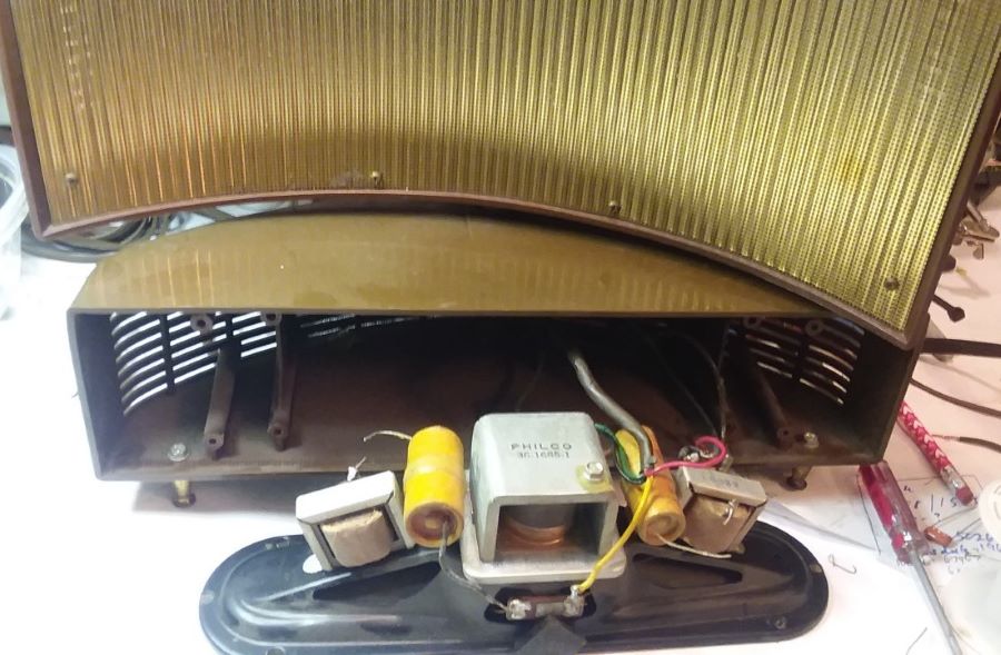

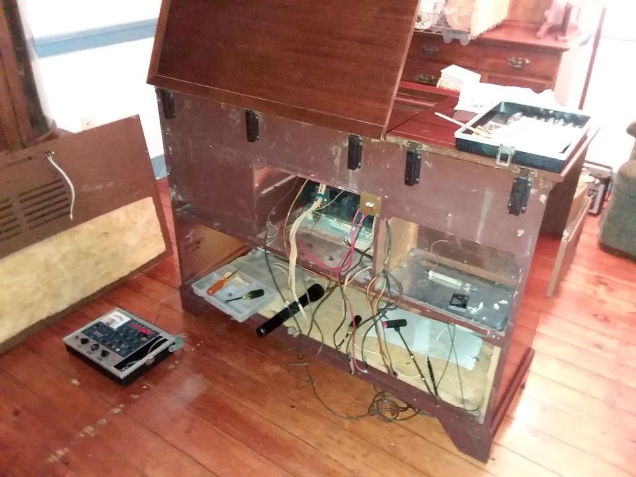

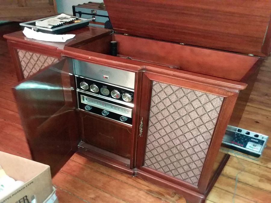

This Philco is currently in my living room, both doors to rest of house are closed as this is a parlor-type setup. I move consoles in and out of this room, largely unnoticed until I play them.
I have recapped the tuner, one-tube preamp and the three channel amplifier. Also replaced were NP capacitors in the two satellite speakers. As you can see from the pictures, it is a very involved affair to work on.
I am ready to put it all back together and hoping the first power-up doesn't require repeated disassembly. Unlike most other amps I work on, this one was not "jiggable", that is to say: Jig means to lay it out on my bench using test speakers, it was too much to imagine.
I have been reading posts on AK about this model and wondered how this one might turn out. Other than the elusive 1961 Philco model J1930, my G1906 two-piece and this H1916, I know of no other Philco top-of-line models. The better solid state models having the pushbutton selector (not rotary) are seen on Etsy and other sites featuring MCM knockouts.

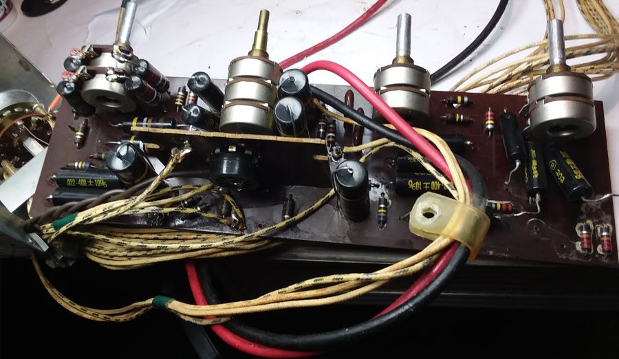

The preamp has a standing pcb behind the volume control for the 7025's tube socket, solder joints were awful and look at all those suspected bad paper caps
No wonder I never, ever try to power anything up for evaluation that has these awful caps. If I did and it played nice, I would still change all those caps. But, if it sounded not much better after all that work, I would be very discouraged. These speakers are not suitable for use on any amp but this one, yet I see posts about folks trying to use these on something else!

Yes, I see those bumblebee caps down in there, too.Motorola minion wrote: ↑Fri Dec 06, 2024 3:53 pm The preamp has a standing pcb behind the volume control for the 7025's tube socket, solder joints were awful and look at all those suspected bad paper caps![]()
They are off to the dentist for pulling, I'm sure.

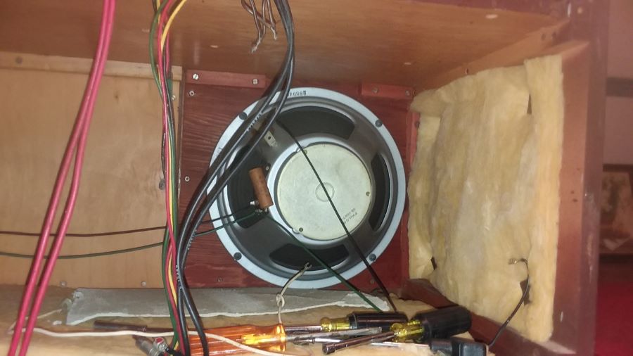

I was able to get some time to place all the chassis into the cabinet, minus all the screws. The wiring between the OPT's and the woofers alone has me buffaloed, not to mention the contour control which is part of the bass channel's elaborate feedback circuit.
The first power up was very interesting - I heard crackles and snaps as the 6AL5 warmed up, supplying about 600 volts to the electrostatic tweeters I plugged into the cabinet receptacles. Th long satellite cords are coiled up and waiting for remote deployment once issues are dealt with. I noted an inspection tag signed, advising customer to contact them at Philco regarding service.
The lighting alone with those metal knobs and indicators was stunning! The amp and preamp sound equally good on both channels, using the tuner which I had tested on the bench. One of the satellite speakers has a buzz or rattle, though I did not get to try my other satellites or just swap them. Also is needed a trial run of a CD via tape input, when the house is empty of course
Philco could not have made much profit on this model, considering the assembly required and such a robust, heavy cabinet. As expected, all the OEM capacitors used in this beast were just as crummy as what Philco assembled their TV sets with. This is why I never bother powering up until all are replaced. Resistors were not an issue, all within tolerance and somewhat matched on opposing channels

Yes, nice work Dave and that is a very impressive Philco. I wish you or Mark lived closer I would love to hear it. The woofers have very large magnets which is something you do not usually see on a console stereo.
