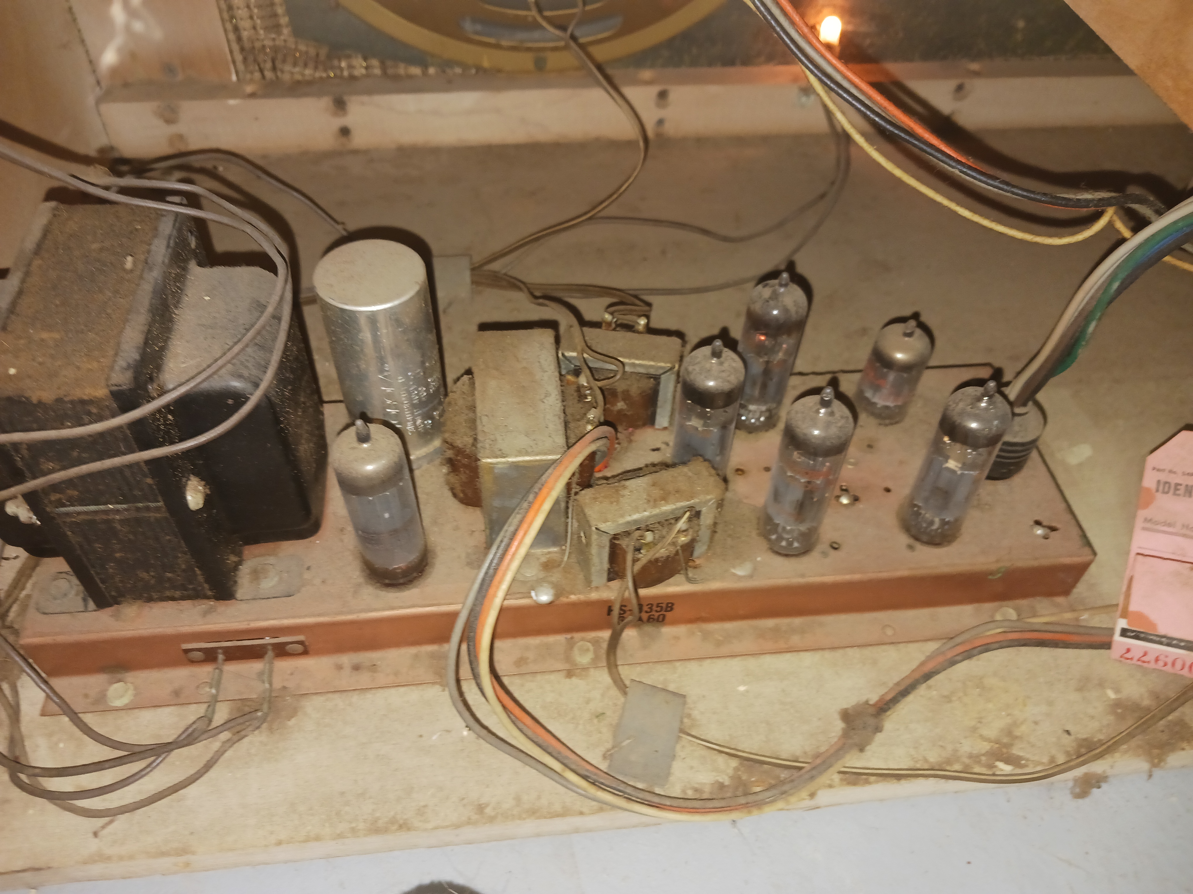

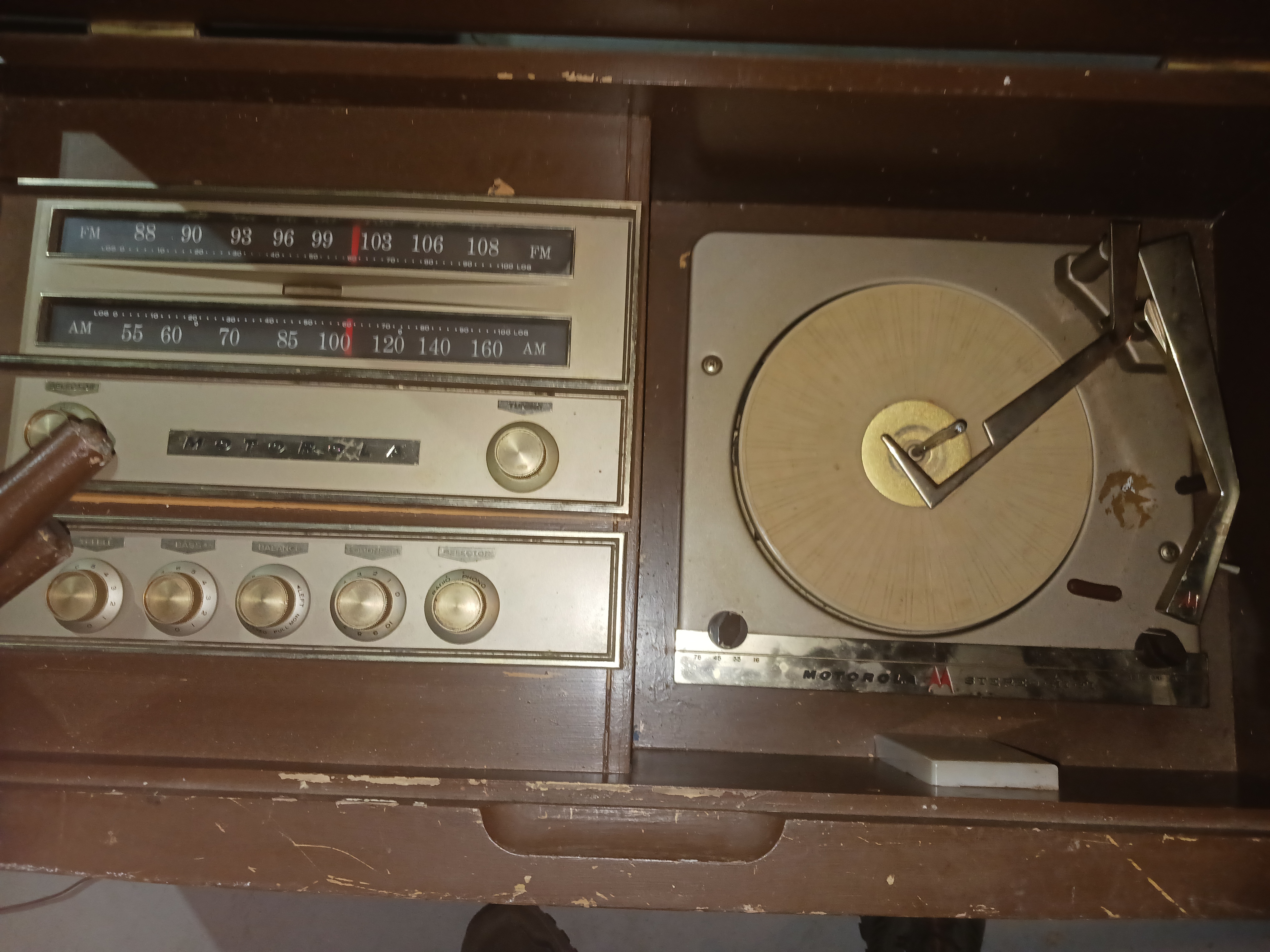

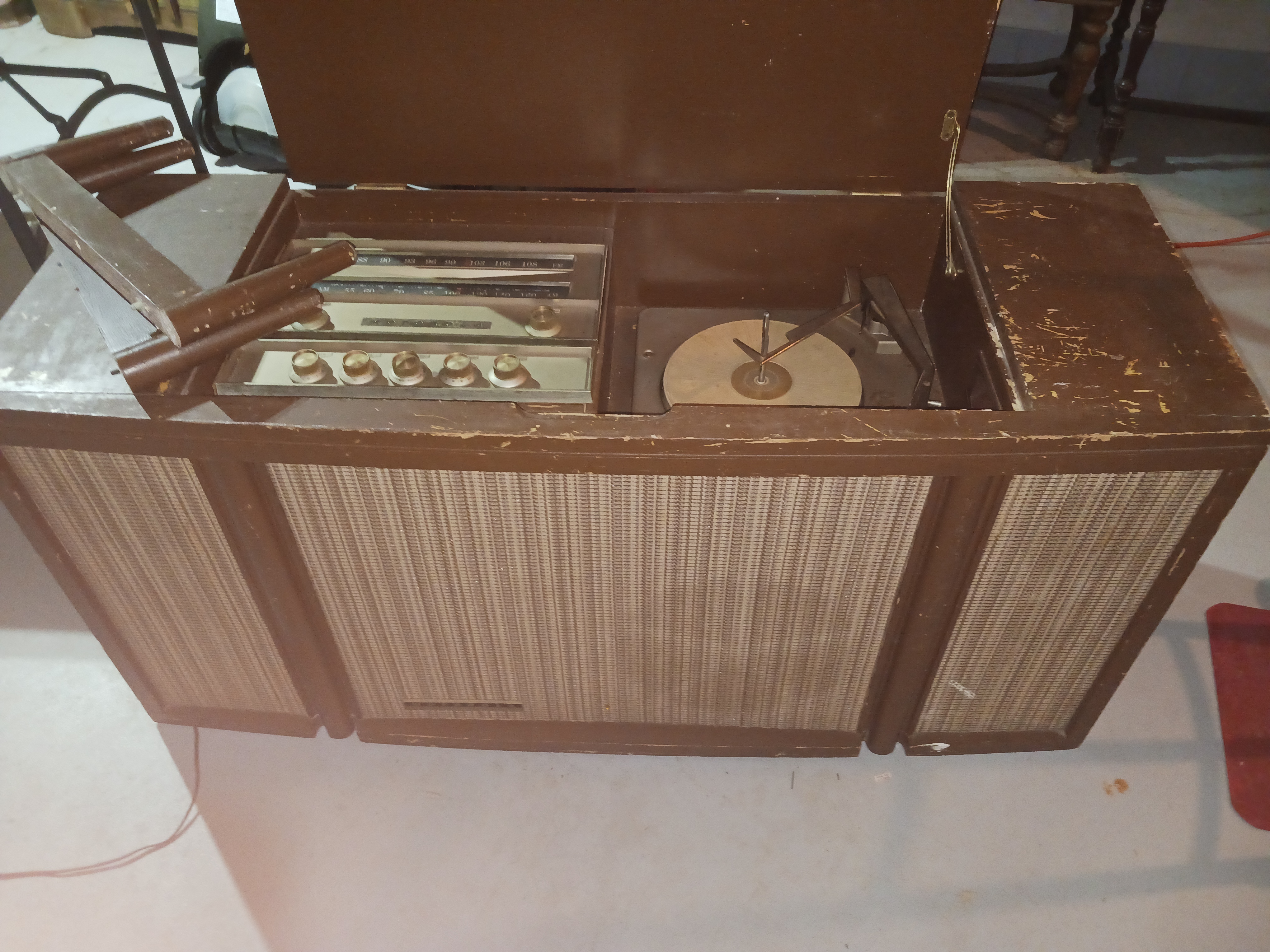

Post: # 22163Post hermitcrab »
she is rough , but I could not turn down the price of 20 bucks , no model number anywhere on the outside... may find something on the inside, it appears to be 6BQ5 outputs from what I can see through the holes , the legs are sitting on top... they are so spindly I didn't want to snap them off moving it...any one have a guess on a model? I'm sure it was on the lower end of the scale...

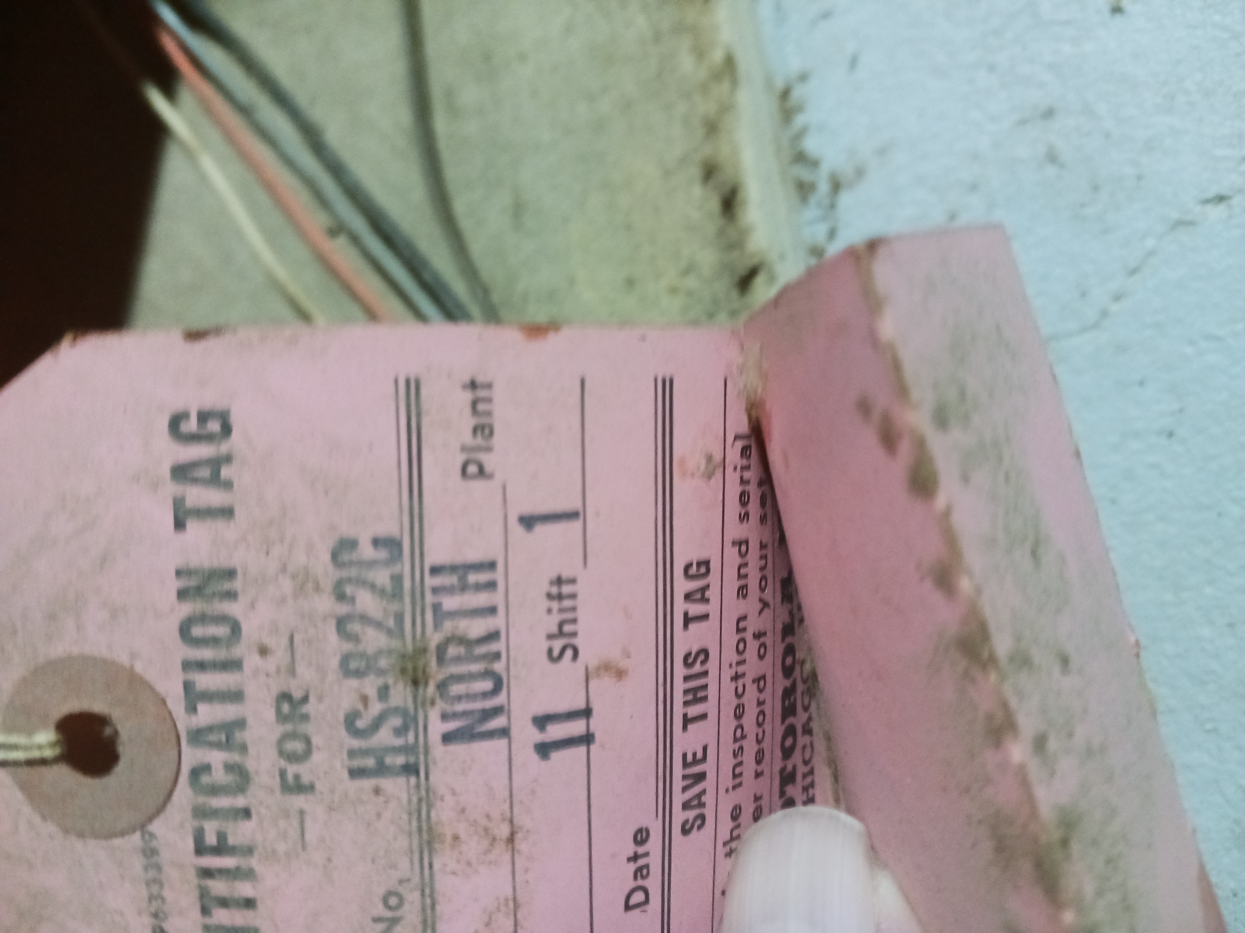

Post: # 22167Post hermitcrab »
once the back was off all questions were answered , it is a model HS822C, AM works, FM dead, Turntable froze solid , and the ugly look ?... it was painted!... this was a blonde cabinet , hopefully the paint will peel off easily...here are some snaps In the back...

Post: # 22168Post hermitcrab »
The HS-822C Sam's brings up a TV set and the wrong amplifier? I did find a Sam's just for the amplifier HS-835 ...the outputs are 6BM8 ... the picture on the Sam's looks just like the set and it says it is a SK 43....

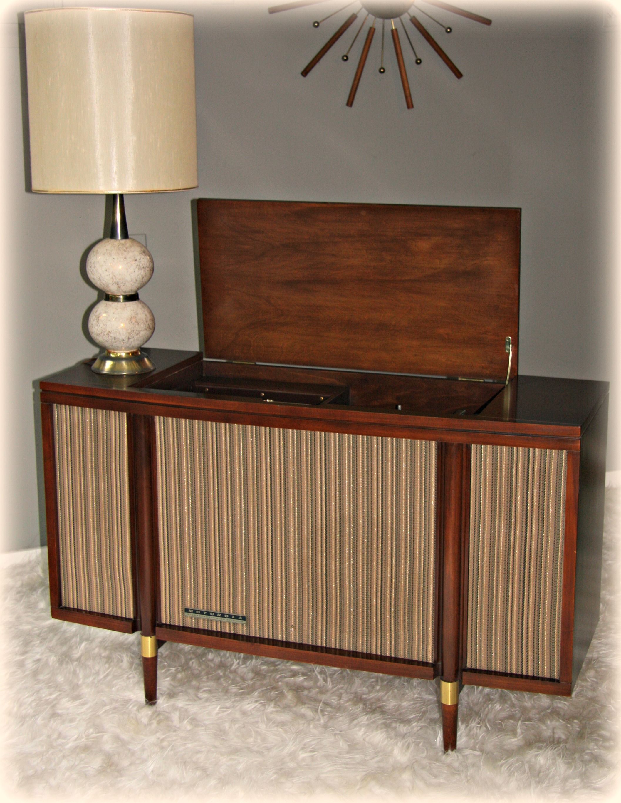

Post: # 22181Post hermitcrab »
She is now identified as a SK-43... I wish the one I have looked as good

Post: # 22183Post William »
Wow, that is a beautiful Motorola, Elton and it definitely does not have a painted finish. If you strip off the brown and discover blonde underneath you will have a unique Motorola. I bet there not a lot of those made. Congrats on your find.

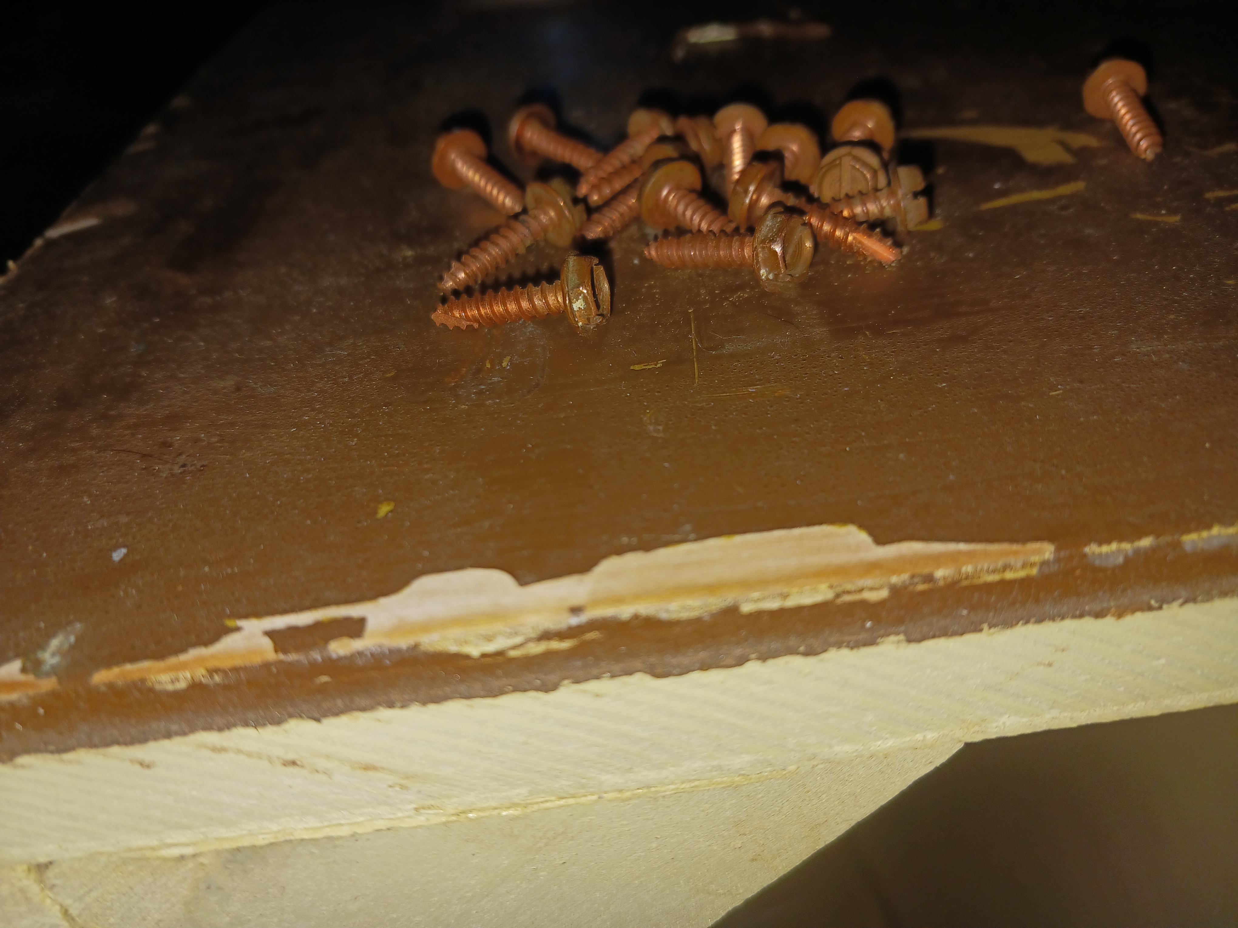

Post: # 22194Post hermitcrab »
The more I learn about this set , the more bummed I am at the paint job on it... one edge of the lid is missing paint , and it sure looks blonde , or could be just white birch that was painted from the factory ,but the brass finish on the legs were also painted .. guess I will experiment with some paint remover and see what happens

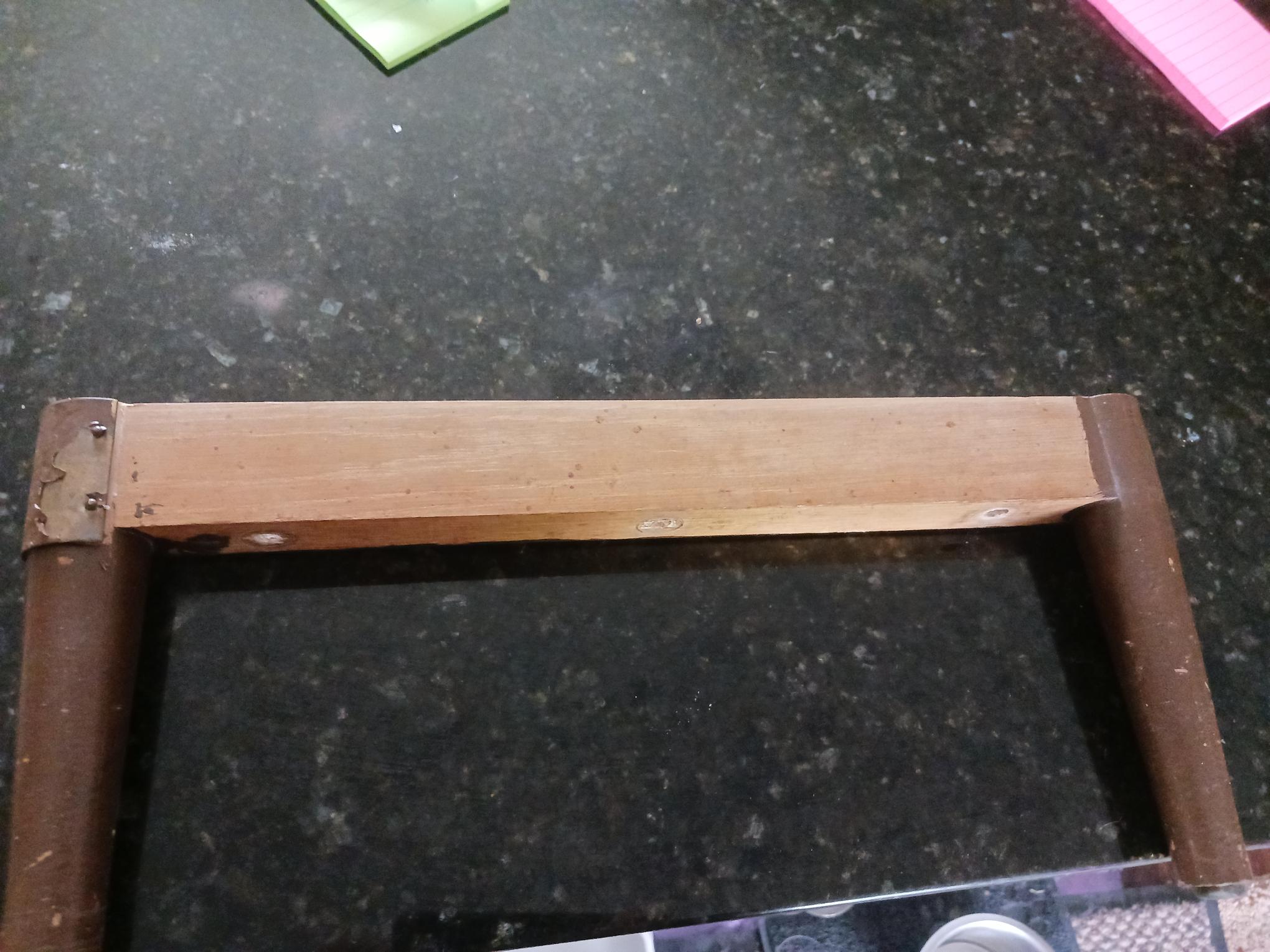

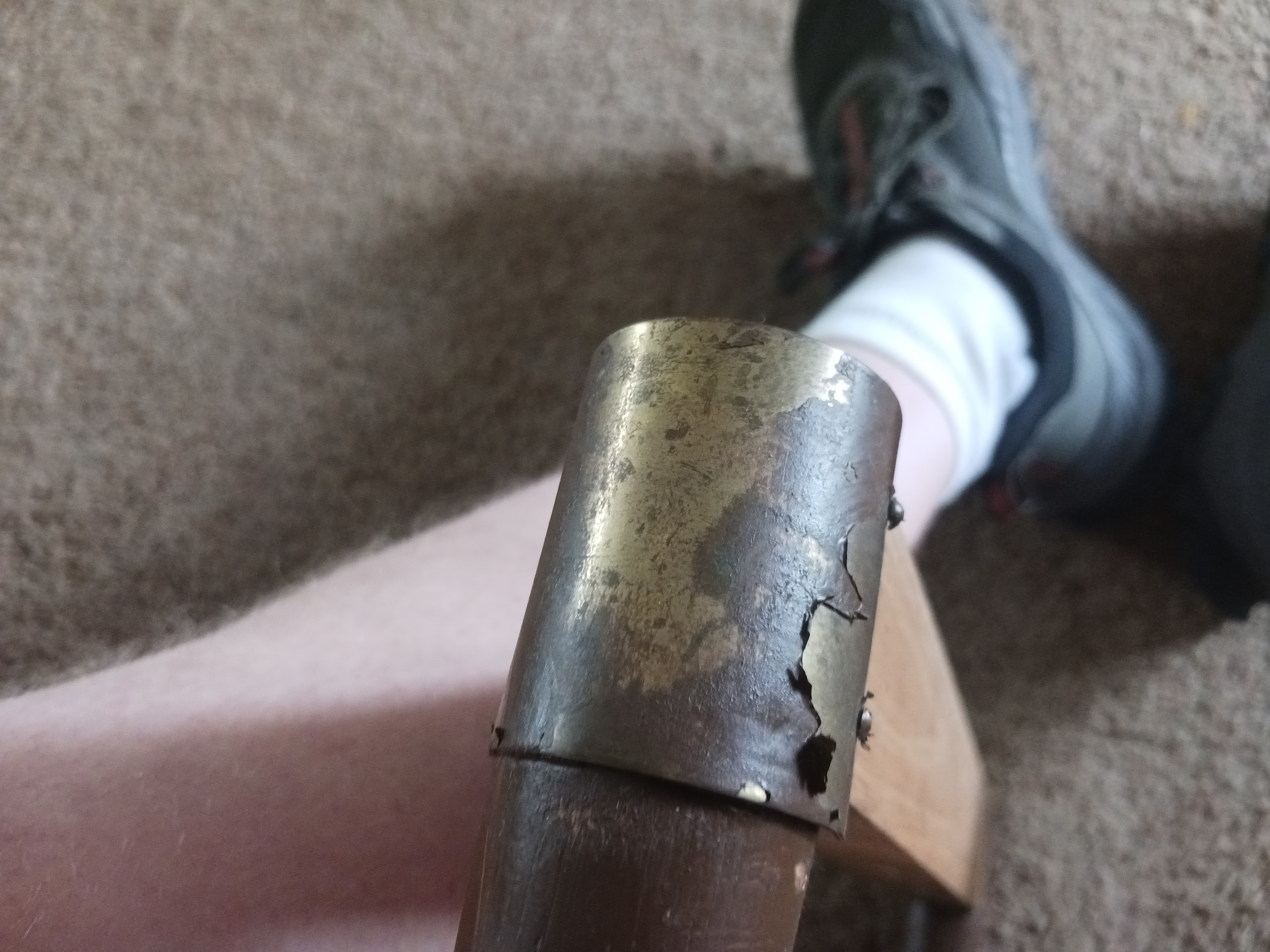

Post: # 22196Post hermitcrab »
Ok... I am going with a blonde painted cabinet, I didn't have any paint thinner , so I tried a few squirts of carb cleaner just to try it out ... this will be long and tedious ... here are some pics to show the brass under the paint and the original wood color on the back side of the legs ...any suggestions on how you would go about it are appreciated ...

Post: # 22197Post maxidyne »
I would go easy with the carb cleaner. That stuff has acetone in it. If I remember correctly that blonde finish is paint based. What kind of paint is on it? If it is latex, you might get by using waterless hand cleaner and 0000 steel wool. Good luck....

Post: # 22207Post electra225 »
The Sparton console in the Maxidyne avatar had pink paint on it when I got it. It was latex bathroom paint. I used GoJo waterless hand cleaner without pumice and 0000 steel wool. IF you get the paint started to lift on a corner, it will come right off of the original oil-based finish. I painted the end grains black since the pink paint stuck in it better.
There was a member on ARF who redid the blonde finish on an RCA record player and did a credible job.

Post: # 22211Post TC Chris »
Seems to me some of the "blonde" finishes used a white-paint wash, a thinned coat. You could experiment with various tones of "white" (there are many) and also with whatever your favored finish is, since some add a bit of yellow warmth. The experiments are probably best done on scrap wood.
