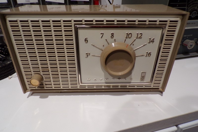

I have this little AA5, plastic cabinet, PCB chassis, very basic. It's a pretty hot performer for what it is. In nice condition, would be perfect but for a missing gold "bright" from the tuning knob. I play all my little radios on a regular basis. It came this radio's turn recently, but it wouldn't play. If I tapped on the cabinet, it would play then quit again. I pulled the chassis and speaker and cleaned all the connections, tube sockets, reflowed the solder on the antenna connections and on the tuner. My diagnosis is SMD. Since it has a PCB chassis, it's not worth fixing. More trouble than it would be worth. I can still listen to it, I just need to tap the cabinet occasionally when it quits. IT seems to get better as it gets warmer.

I would have to usolder the IF cans from the PCB chassis. I don't believe the chassis would survive that. It has a minor case of SMD, but it won't get better. I guess the time will come where I have no choice. I could also hardwire the chassis if the heat from soldering caused damage to the traces.

Isn't SMD usually identified by lots of static-y crashing noises? Yours sounds like some sort of bad connection, maybe even an intermittent voice coil or OPT?

It has some of that as well. When I do the old wiggle trick, I get positive voltage on the grid of the IF amp.
