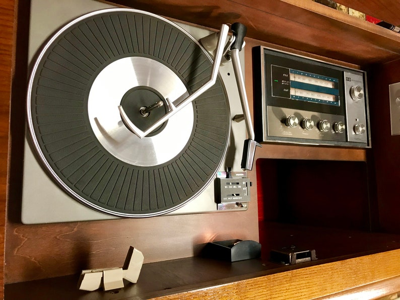

This is another quality piece acquired for $20 on CL, well-cared for in a clean home, bought new about a mile from the house.
It came to full life with only a control cleaning and replacement of two 1500 mf power supply capacitors. Plus and minus 17 volt supplies tells me this is 20 watts per channel maximum based.
Several years ago I found another one of these at the dump, missing its back cover and lid, with a worn/weathered finish. This is a full set of spare parts and I have needed none so far.

Correction! The VLT-51 is the Ann Arbor.
The big difference is the price level and rareness of the exaggerated Danish style of the Anholt, reported to be $880 new in 1967
I suspect that oval speakers have a wider frequency range, rather than a peak loudness at a certain frequency like tweeters and round speakers.

Post: # 2973Post Motorola minion »
William wrote: Fri Nov 05, 2021 11:46 pm Dave, are both of those Drexel cabinet Motorola's yours? If so, what amps do they have? You have some cool stuff.
Oh yes, an omission ! Those pics were copied from Etsy. I have a Motorola SK32 like the ones behind on that picture. The SK-32 has a 3-channel amp (I have two parts chassis) and this 4X6BQ5, 2 as push pull for center 15" bass woofer, the other 2 single ended for the 8", 5" and 3" drivers.
As for the RCA Ann Arbor, it is in similar condition and has been playing since last week when I replaced the 1500 uf 50 volt caps in the power supply. The controls are dirty and of course the player is not functioning, neither is the cartridge. Once you get a clear station, it sounds very good even with no real work done yet!
