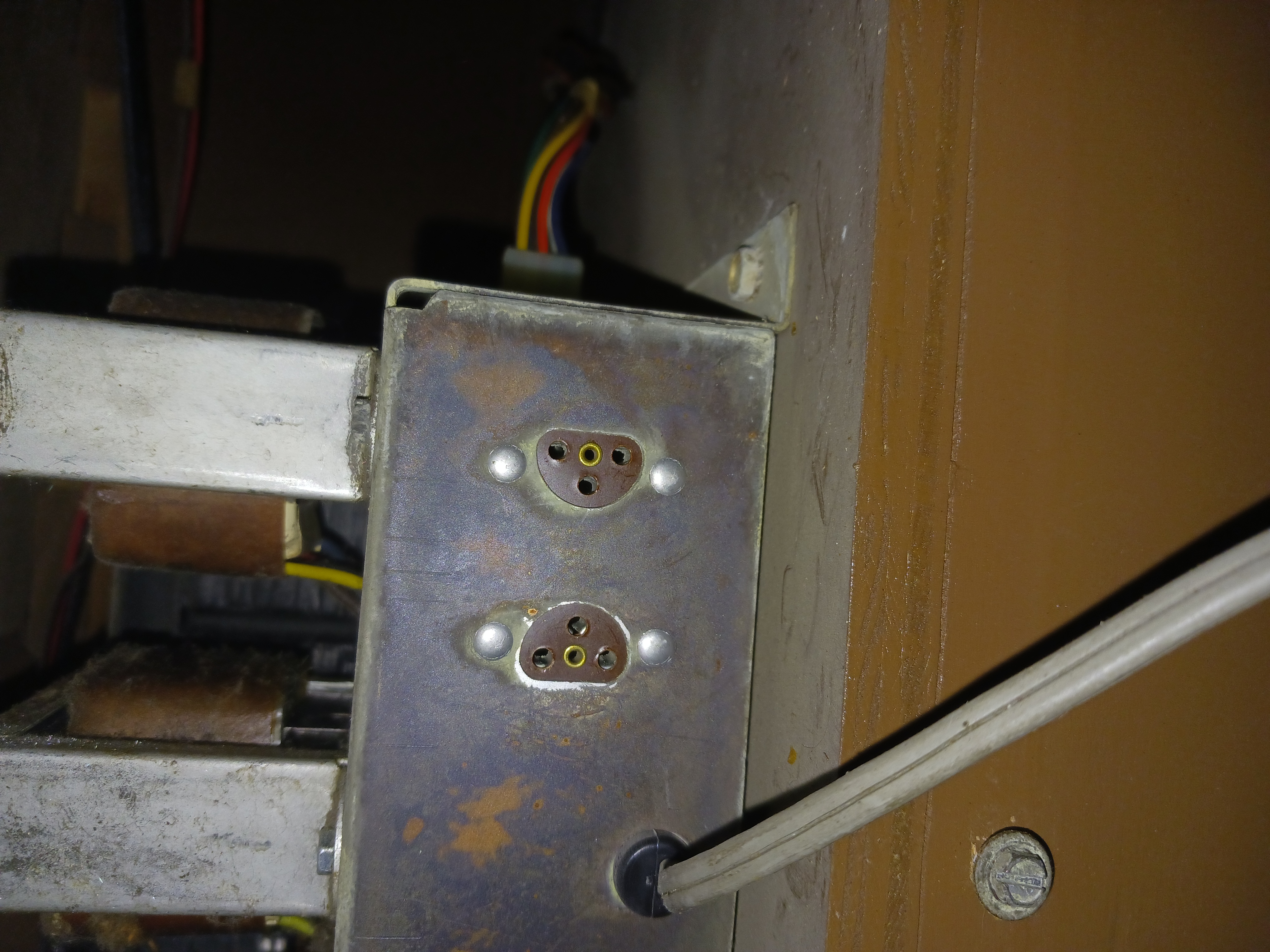

I need to find some bypass plugs for the RCA... there are 3 terminals , which ones do I jumper?... zero sound till I figure this out ...
Thanks

Trace 'em back?

hermitcrab wrote: Fri Dec 15, 2023 11:02 pm I need to find some bypass plugs for the RCA... there are 3 terminals , which ones do I jumper?... zero sound till I figure this out ...
Thanks
Schematic Please !

I found the answer on audio karma , 1 and 3 jumper for sound the center or 2 is ground ... rca did some weird stuff ....

I have those same plugs in mine also. I presume this is the unit you got north of you. I am anxious to watch your progress on this, as someday I need to do mine. :roll: :)
