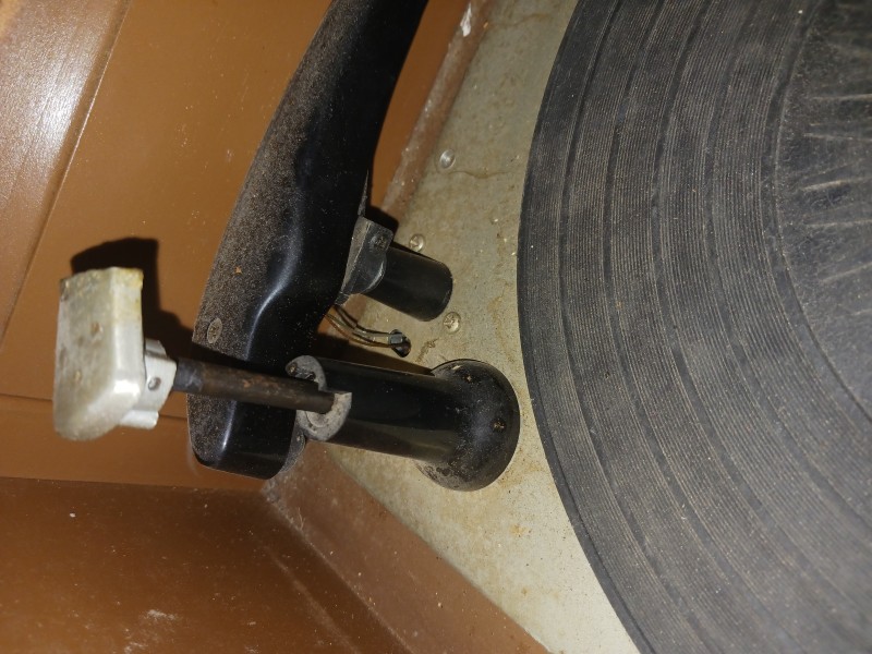

This Thanksgiving I hooked up with some family in southern Indiana at my niece's house. After dinner my niece says I have a surprise for you... down in her walk out basement sat a magnavox. Her neighbor was having a rummage sale and gave it to my niece , and this was 4 years ago!...This is a model 1RP659. Has all the original paperwork from the sale on 12/1/65... cost with tax $606.90. I cringed to myself because I really don't have room for another one, but after she went through all this trouble to hold and store it for me , what could I do? I graciously thanked her and quickly measured the depth , as the weather was rain/snow and I had over 400 miles to drive home. fortunately it fit under the tonneau cover... selling in december it might have been a new 66 model. I have not looked it up yet , this appears to be one of the 100 watt versions with the enclosed speaker baffles adding about 100 pounds to it. I did not look at it too closely , but the only thing I saw was the record arm holder is snapped in two. Right now it lays in the back of my pick up, on it's back because I don't have any idea where to put it hence no pictures of it yet... can't go in the basement because it weighs a ton ... until I make room somewhere I hope I don't need to haul anything in the truck anytime soon... :roll:

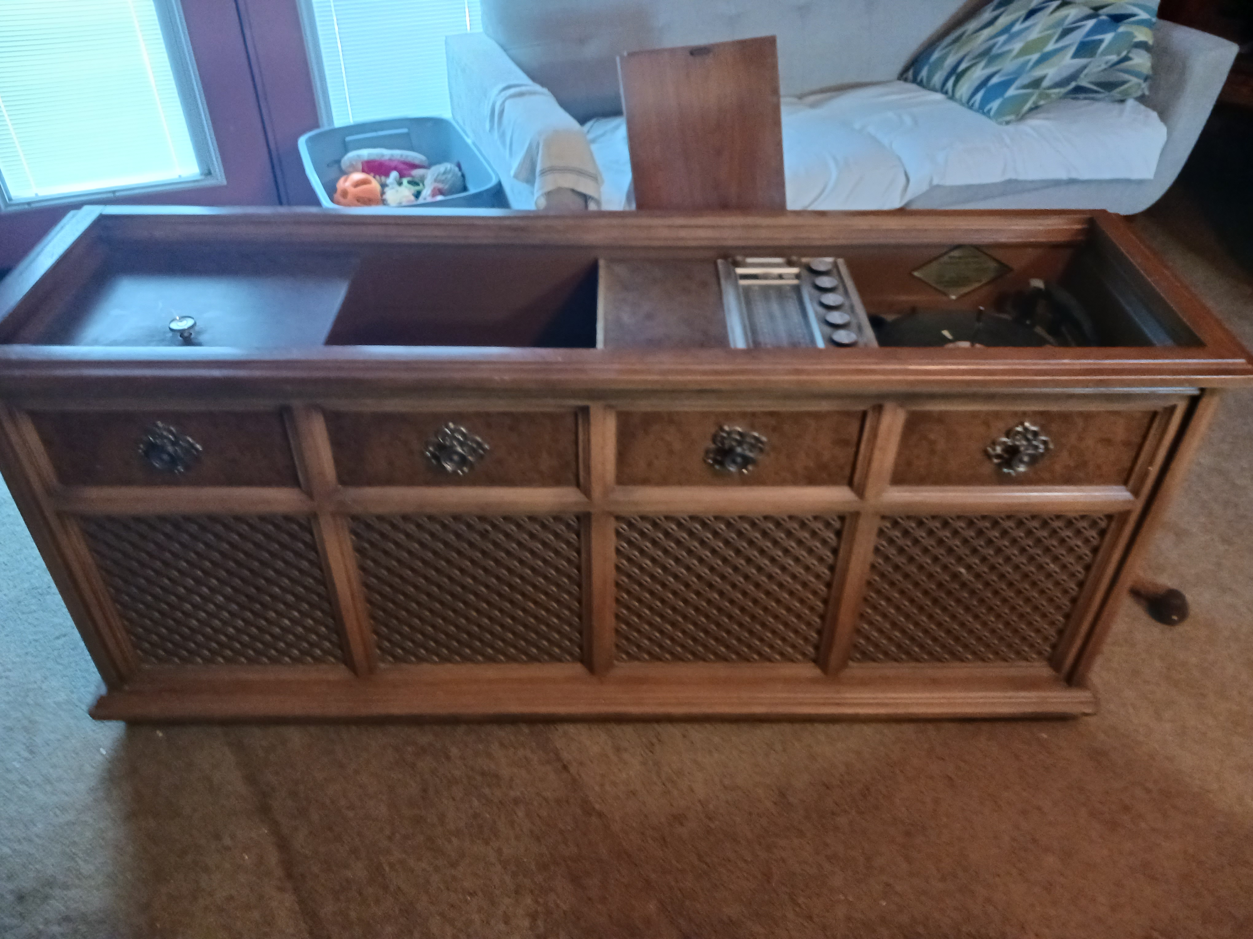

Post: # 18364Post hermitcrab »
Here it is out of the truck... unfortunately no tags on the back to confirm the model # except what the sales receipt says ... in good shape overall except the record arm being broken ... will try to braze it or put a request in the wanted to buy section .... also shows the paperwork for the new needle ordered in 72.

Post: # 18369Post hermitcrab »
well I believe the sales receipt is wrong on the paperwork....inside the speaker housing I found model 2ST690... which should be a 64 model , but since the download section is blocked to me , I can't tell for sure , that would align with why it has the early changer instead of the narrow grey tone arm changer...

If you can't find a replacement, a repair ought to be easy. Use an epoxy like JB Weld on the underside where it cannot be seen anyway. Rough up the plastic a bit; wave a propane torch flame lightly over the glue-up area, and then apply epoxy.

Are these held on with a roll pin, or a tiny allen head screw?....

Looks like you'll have to use a allen wrench set as a detector.

the pin requires a 3/32 punch to remove it...I hope the JB weld can handle me pounding the pin back in the arm

Can you push it back in with a small C-clamp?

On the same vein as Chris's suggestion, you could also use Vise-Grips or even a medium sized pair of water pump pliers to squeeze it back in, you wouldn't have to pound on it.

as predicted the JB did not hold , it came apart on its own just by gravity on the changer, and as suggested putting metal underneath as reinforcement just interferes with any 12 in record you put on it , if it comes down to it , my son's 3d printer can handle something that size ... but no rush now.... as I discovered the power transformer is kaput on this beast ...when I got it, the power cord was cut off, so I wired one on and tried it... nothing.... pulled the chassis and jumpered the primary and no output on the secondary... so now I need to look for one of those , fortunately it is a simple center tapped 48 volt secondary with a 6.3 for the pilot lights... should be an easy find as long as the current capabilities are there so as it stands this one is a beached whale for now...

If you want to try again.... If it's a metal arm, make sure the underside where you are applying the epoxy is brushed clean of paint. Gluing over paint gives a bond that is only as strong as the paint. If it's plastic, use the Gougeon Bros. recommendation about passing a propane torch briefly over your roughened plastic surface. From one of their manuals:

TC Chris wrote: ↑Mon Dec 11, 2023 11:41 pm If you want to try again.... If it's a metal arm, make sure the underside where you are applying the epoxy is brushed clean of paint. Gluing over paint gives a bond that is only as strong as the paint.
The arm is metal... pot metal I think, I used a mini grinder on the bottom to roughen it up, and used a 1in" thin strip of 22 ga to help reinforce the joint ... it held for about 4 days , The problem is the break is right at the post , so the weight of the arm is always pulling on the joint ... I think it has to be replaced with a donor , or as stated I will have my son 3D print one out ...it is only needed if you stack LP's... it is not needed on a micromatic for 45's
