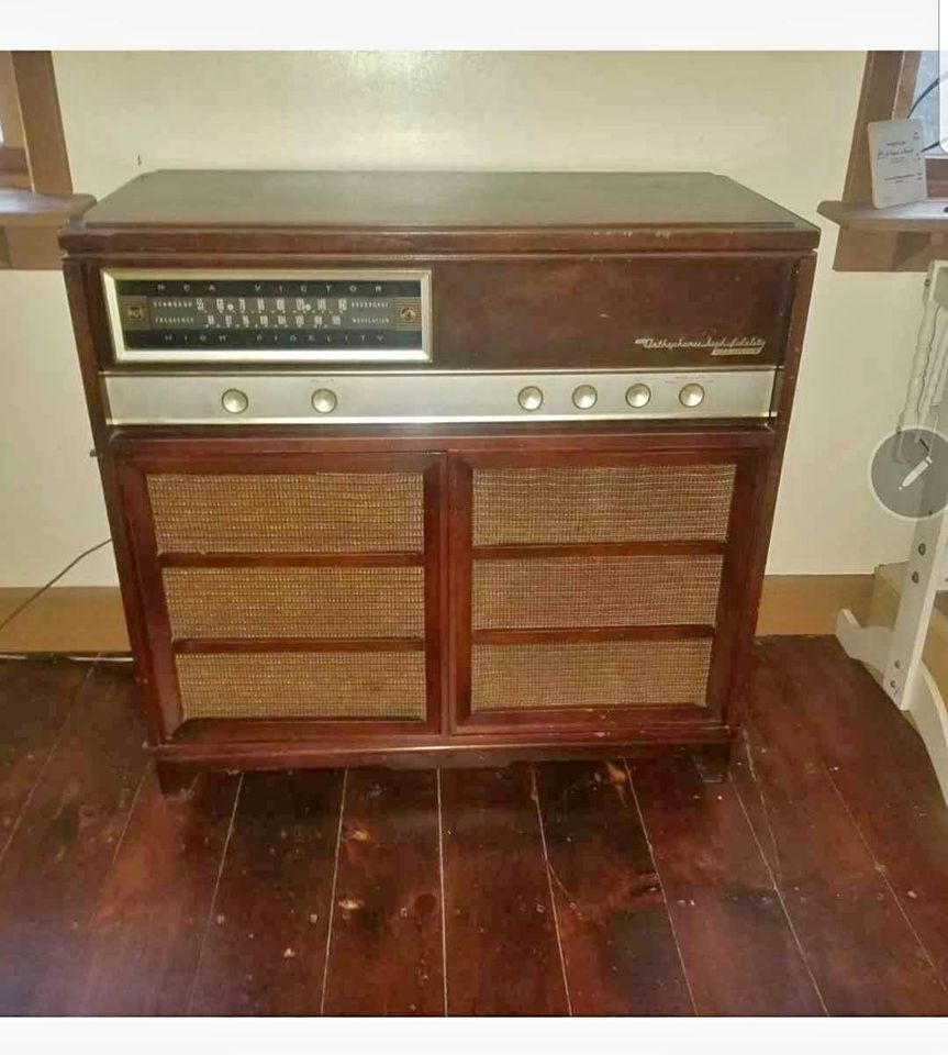

These are popping up so they must have been popular as can be for some reason, I paid 60 for one and the other was a traded for repairs to a portable VCR. The record changers are RP203s with 4 speeds and mono cart which cannot be used on stereo LPs, not that they would be a first choice on this console.
From 1956, this model was popular as it was the baby bear to the TOTL 6HF1 and smaller 6HF2. The unit is all mono but has a more equipped look to it

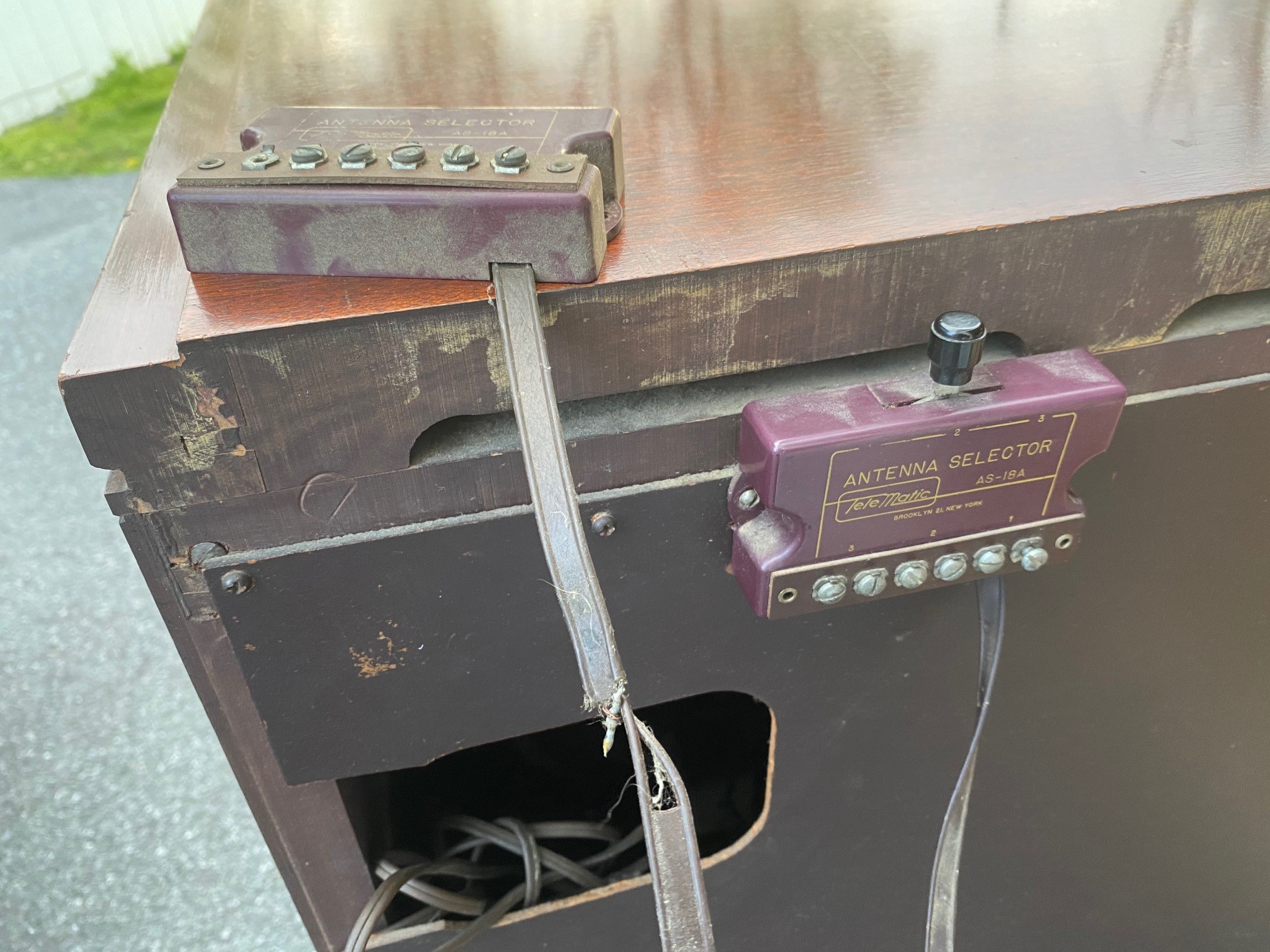

This particular console came from the original owners' grandson who lives about 2 hours north in the Pocono mountains of Monroe Co. Pa. The original owner was a steel working man from Leechburg, Pa north of Pittsburgh. This console was used with multiple antenna switches to maximize reception of far-away stations like 650 AM in Nashville with real country music, Canadian AM stations with big-band era music and some real bluegrass on Ohio valley FM stations from neighboring Ohio and West Virginia. If even half of what I was told is true, Grandfather Atwood's hilltop house was a party location for any reason. After he moved, the console was handed down to this grandson and the party house burned down in the 70s after being turned into apartments. A typical PA old-house story unfortunately.
It now has a new home at our family camp about 3 hours north of here, also up on a high elevation. A quick check of operation when I was up there over the weekend tells me it will be enjoyed for many years to come. I took the entire console there a few weeks ago, then pulled both chassis for bench time. The record player work is saved for later when I finish up the SHF1's player which is nearly identical.
Back here in the flatlands, I was able to recap the amplifier and align IF stages on the radio chassis. I did not perform any RF alignment as the AM loop board and FM screw terminal leads were still in the cabinet, and they figure into RF alignment in a big way. So far, built-in antennas seemed OK on the stations available up north but lead-in wires will be added to place antennas out doors.

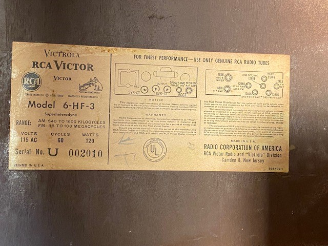

As far as I can tell, Orthophonics up to 1959 used an HF, SHC, SHF, etc
HF=mono high fidelity, 6 prefix number is year, lower numbers=more expensive, so a 3 is 3rd from top.
1960 to 1964 went to V numbers for victrola VF=victrola furniture? AND TPM, etc was also used no guess there. A model 3VF306a is pretty obvious
There is no RCA sales literature I have ever seen, just silly assumptions for now
