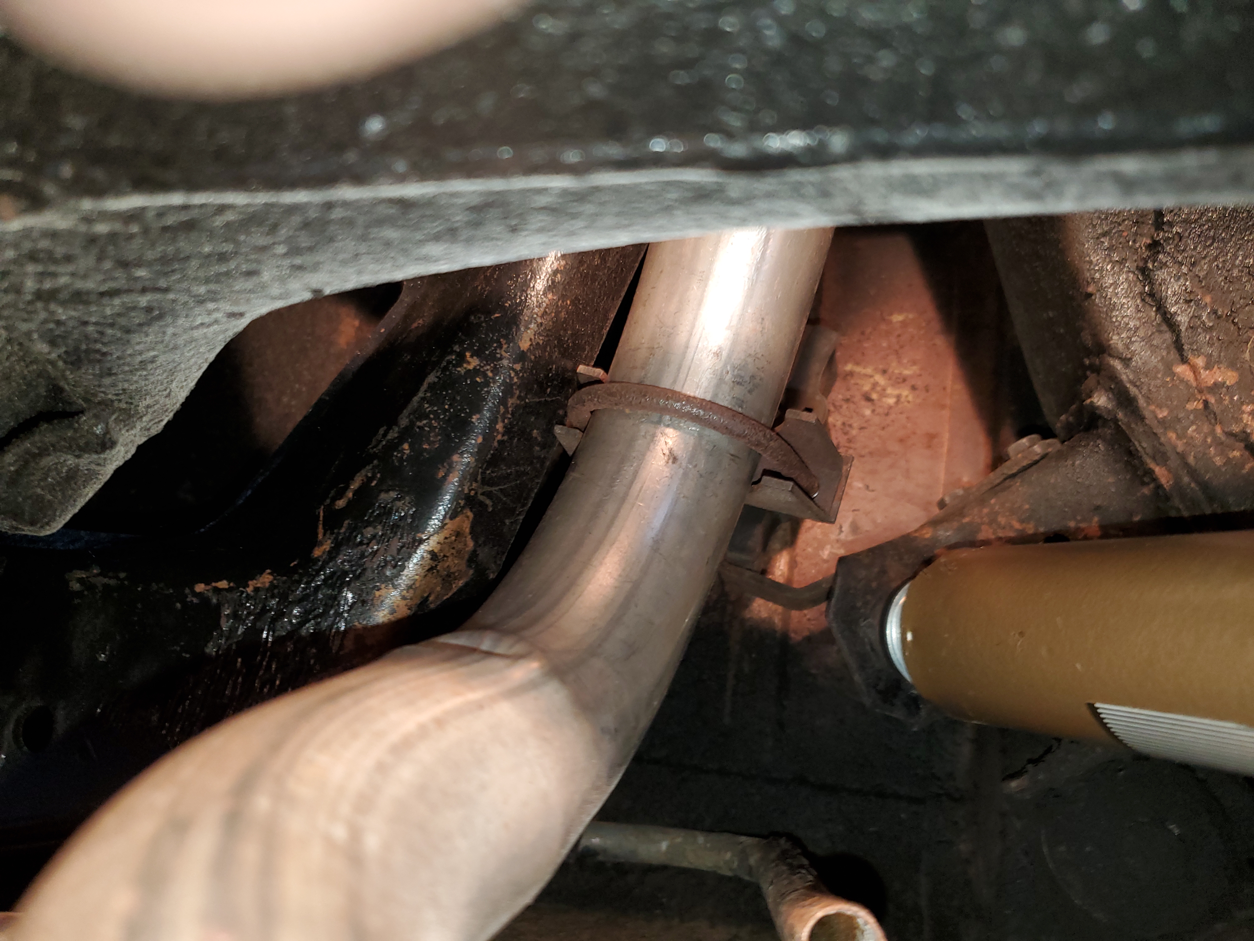

So, one of the last things I had to do again was realign the exhaust on the 62. Installing exhaust on yor back on the driveway is not optimal but it's what I had to do...

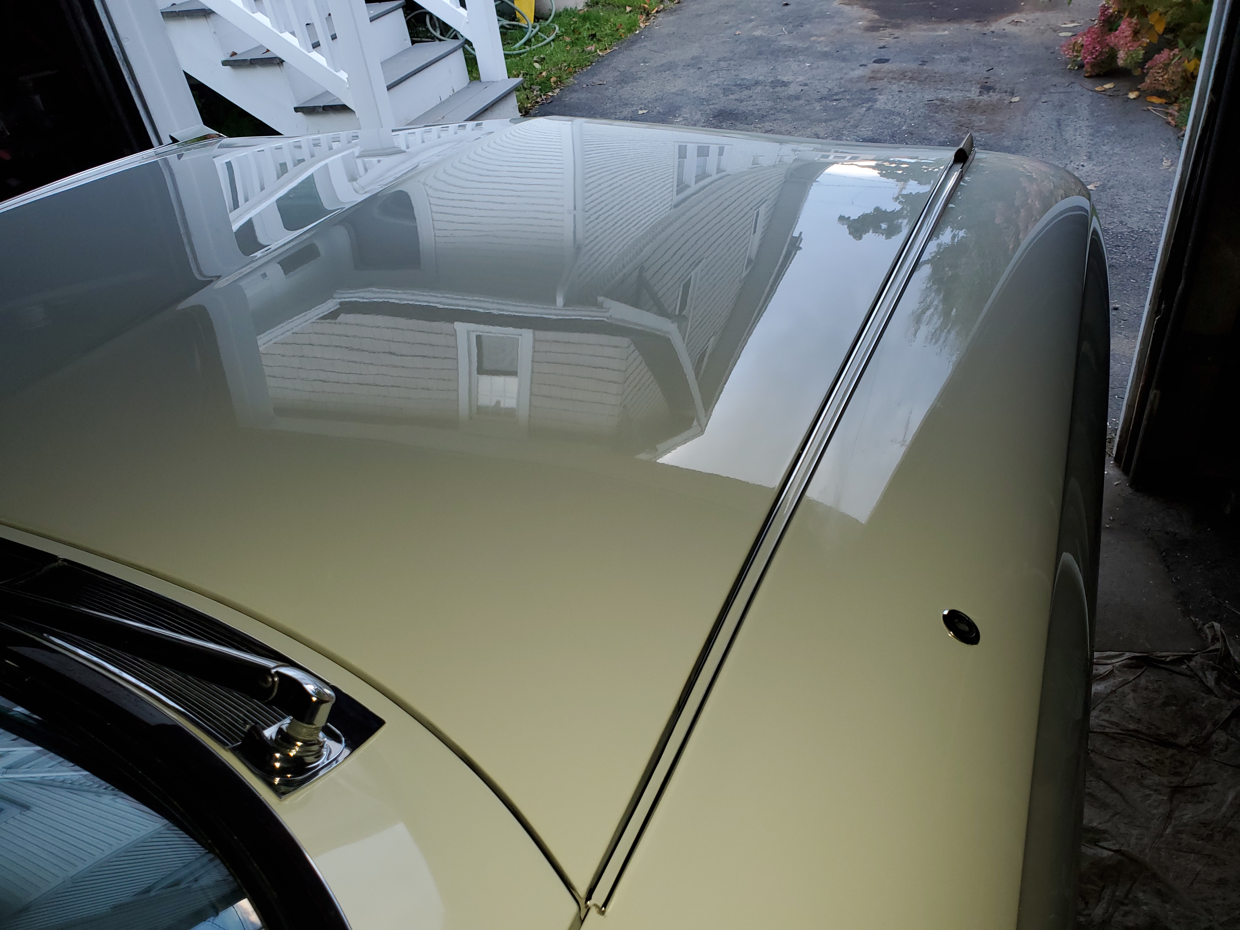

I got the car back from the body shop and spent the last few weeks detailing and polishing the original lacquer but, driving it home from the shop, I went over railroad tracks that'd rattle the teeth from a shark. Bang, bang bang... pipes hitting all over.
There's a hanger over the axle that you can't tighten unless the body is off the car. So I spent today repositioning pipes before they rust together...

I made a clamp from 2 brackets and bolts so I could tighten it from under the car.
As for the paint... I'm amazed by the shine I got from white. The car needs all the help it can get being white... at night, a white car can shimmer under street lamps.

You can get an aluminized exhaust system, then the clamps rust. Your Cadillac is really clean, metal wise, underneath for being in the part of the country you are. White is elegant on a big car. Nothing wore white better than Cadillac...

Threading those pipes aft back in the '60s, when lower was better, was quite a complicated art. Everything had to be bent just right, and then in the right position relative to the others (twist), and then the moon had to be in the right phase.

Your paint does look beautiful. I assume it's acrylic lacquer? The Chevy's original lacquer was my favorite finish when polished up. The hood, trunk, and maybe one door have original finish on them and one of these days I'll buff them up.

Magic Mirror acrylic lacquer. That's original paint. The trunk and one quarter needed to be done. Thankfully I found a shop that would spray lacquer. Factory paint with scratches and orange peel is impossible to replicate.
Car went to Columbus, Ohio late 61. It's a September 61 build. Dealer undercoating and cautious prior owners saved it. All I can do is preserve it now.
There's paint chips everywhere but I'm letting them go. Dabbing them will lead to sanding then more polish and then possible burn through. Enough is enough. I look at it as a nice 37k mile trade on a new 64 or 65...

Your Cadillac looks fantastic for having mostly original paint. The original lacquer on the Buick looked like chicken tracks, it was so broken up. Nobody out here will spray lacquer. I'm not sure you can even buy lacquer paint here. I have DuPont Cintari "99A" on the Buick and only one shop I know of will still work with it, and that is my friend Don. Art always told me that 99A was the blackest black paint they made.
