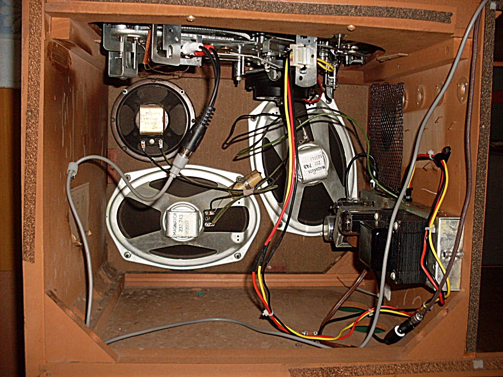

I am happy to say that after a long, but rewarding journey,
I believe the 1958 New Horizon small console is ready.
The signal input RCA cable going from the VOL control to
the amplifier input was bad.
I found some old fashioned RCA plugs at one of our last electronics
supply stores last week.
Today, I prepared the signal and braided shield and soldered
them into/onto the new RCA plug.
With various RCA male/female adapters, I connected the
stereo Micromatic changer to the controls' input,
and the controls' output to the amp.
The sound is VERY nice, and I found that attenuating the Bass
control while maxing out the Treble control
allows for a full-range sound.
I'll post some final photos a bit later.
I have to secure all the new cables, and then that's it !

It's all complete now. I had to take out the cartridge again
and really clean the pins and wire clips so both channels
were working.
The lawyer guy backed out of buying it, due to spousal
intervention, ha ha !!! (Too many toys from me, I guess)
I'll find someone who'll really enjoy it. She sounds really good.
The substitute Micromatic S600 fits right in place of that H400,
that I could never get to function.
The stereo cart bridged with cables to make a mono input
on the control section.
