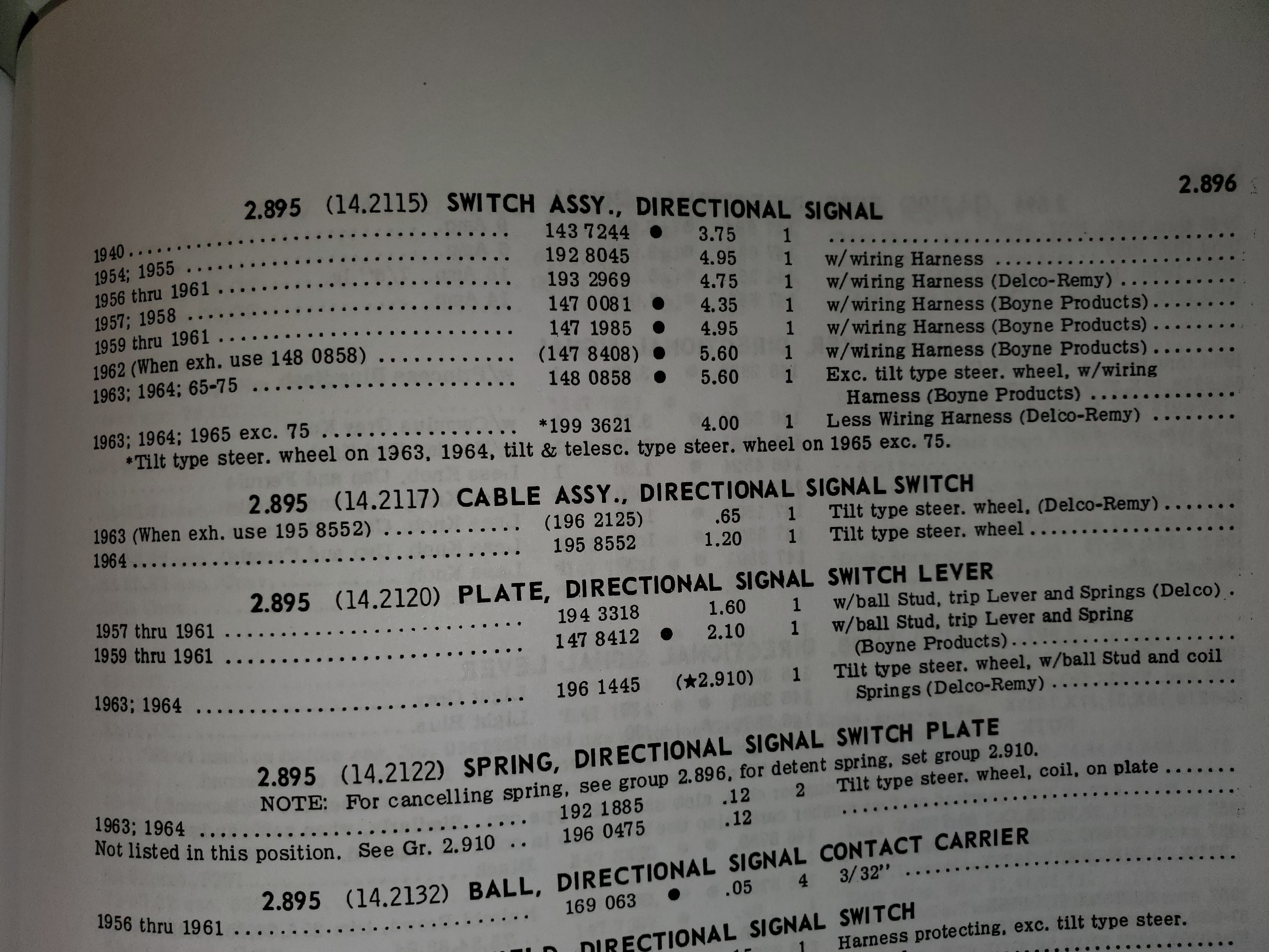

Well, I have good news and I have bad news. The good news is that the turn signal control cable in my Buick is not bad. The bad news is the part I got is 3" too long. The bolt under the steering wheel that retains the cable fell out and let the cable flop around like it was broken. The bad news is that the turn signal switch appears to be the problem. When the car went into the shop, the RH brake light wouldn't work. When it left the shop, the LH stop light won't work. Sometimes. Sometimes they both work. He got the switch adjusted better than what it was so I can manage while we hunt for a turn signal switch.
The guy who worked on the Buick bought the guy out who bought out my shop. He worked with Art, so, if he worked with Art he had to know his business. He says used switches or even new ones may not work. Here is where we get sideways. I kinda feel like if I have a '63 Buick that has a bad turn signal switch and I get another '63 Buick turn signal switch it oughta work. This is a production car that they made more than one of. I'll have to look into that one. He also told me this turn signal/stop light/control cable issue was unique to 1962 to 1964 Cadillacs with tilt column and '63 and '64 Buicks so equipped. The parts guy says all the turn signal switches for these cars are the same. The guy working on the car says he has to custom-built the switches and wants $1200 to do that. I don't think I'll do that. It is better than it was, and I can get by until I come up with an answer I can live with.

What do you think about the comment that a '63 Buick/Cadillac turn signal switch may not work in a '63 Buick/Cadillac? I have a hard time with that comment. I am not going to call the guy wrong, he has more current experience than I do. I find it hard to believe that one has to custom-build common parts for a production automobile, particularly a GM car.
Did the '63 Oldsmobiles have cornering lights?
The problem I am having is a matter of trust. I have worked on these steering columns myself in the past. What I am being told about replacement switches not working is totally foreign to my experience. I don't know what to believe. My diagnosis of the control cable not being right was right. Just for a different reason, to be sure. I'd never heard of the bolt falling out of the cable retainer, never saw one of these cables that was giving trouble that wasn't broken. I do have pictures of mine and it looks okay. I was told it might be "stretched" whatever that means. I have the 1963 big Buick shop manual and it says that tilt columns take a different switch from stationary columns, and that cornering light jobs take a different switch. That would make a total of four switches for a '63 big Buick. Riviera take she same series of switches. Possibly Cadillac as well. I have a couple conditions in my car that may be complicating matters. MY Electra has a blank, tilt column. No shifter. So, do the blank column Buicks possibly use a Chevy/Pontiac steering column? Was tilt column an option in Chevy/Pontiac? If the cable the parts place sent is indeed out of a Wildcat, why is it so long? My car was obviously "modified" off-line. They pulled it off the line and made the floor shift modifications. Floor shift was not an option in regular production Electras. The guy also told me the wiring harness for the cornering lights was not attached to the turn signal switch and he couldn't find it. That is a factory installed option. Where did the wire go? It has to be there someplace. I'm going to get to the bottom of this. At least, now I have a place to start.
Re: '63 full-size Buick turn signal control cable
Not sure it'll help but here's from the MPL
Thanks, Walter, that does help. #1993621 is the part number for the turn signal switch for the Buick, also fits series 4700, Riviera. I see it fits Cadillac as well. There are only two part numbers for Buick instead of four. One for tilt wheel which all have the cornering light connections, and one for non-tilt. These don't have cornering light connections. According to the Buick shop manual, all jobs with cornering lights use the same switch, whether they have tilt columns or not.
Now to figure out why Scott told me that replacement switches, NOS or used, will not work.
