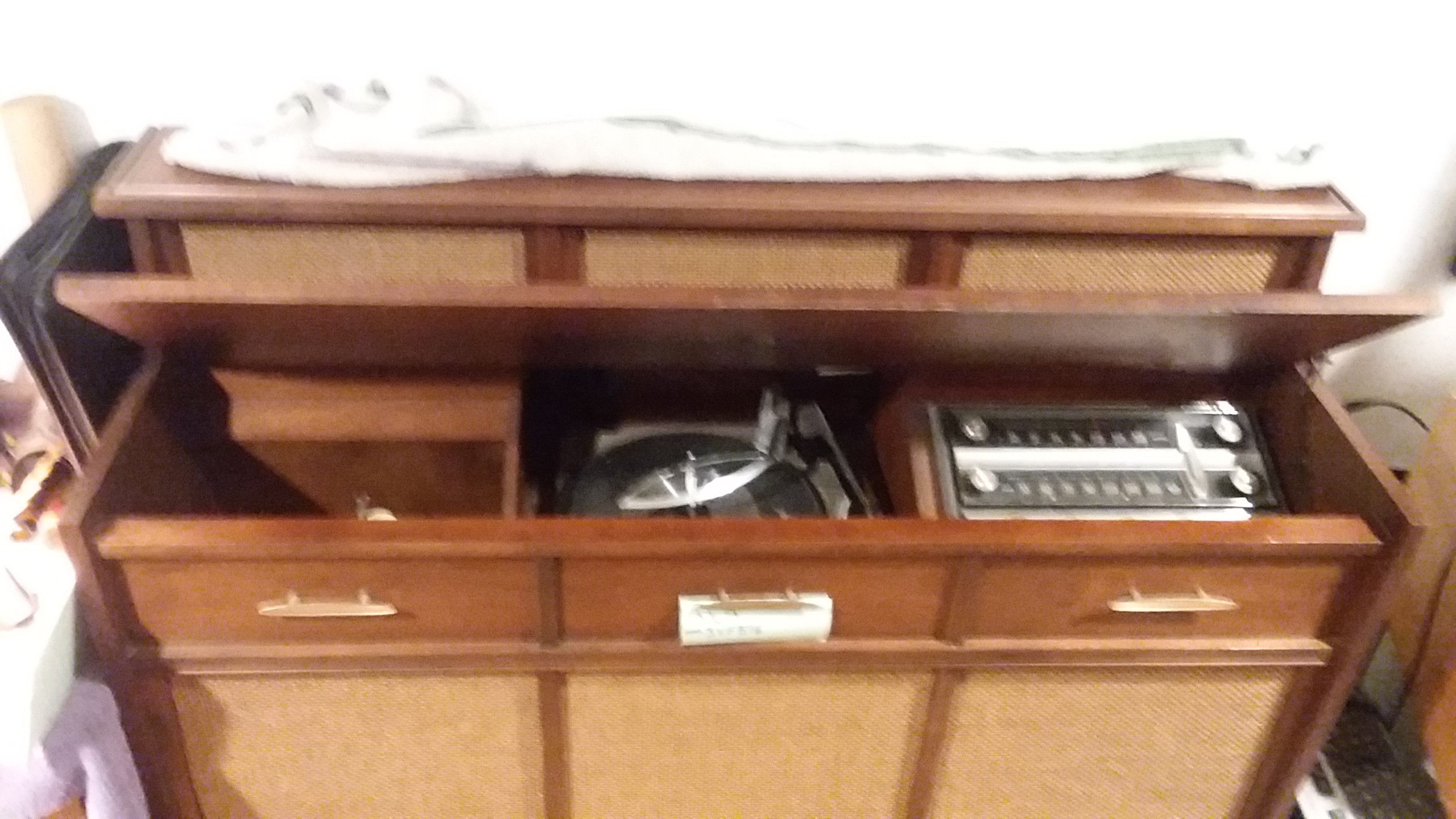

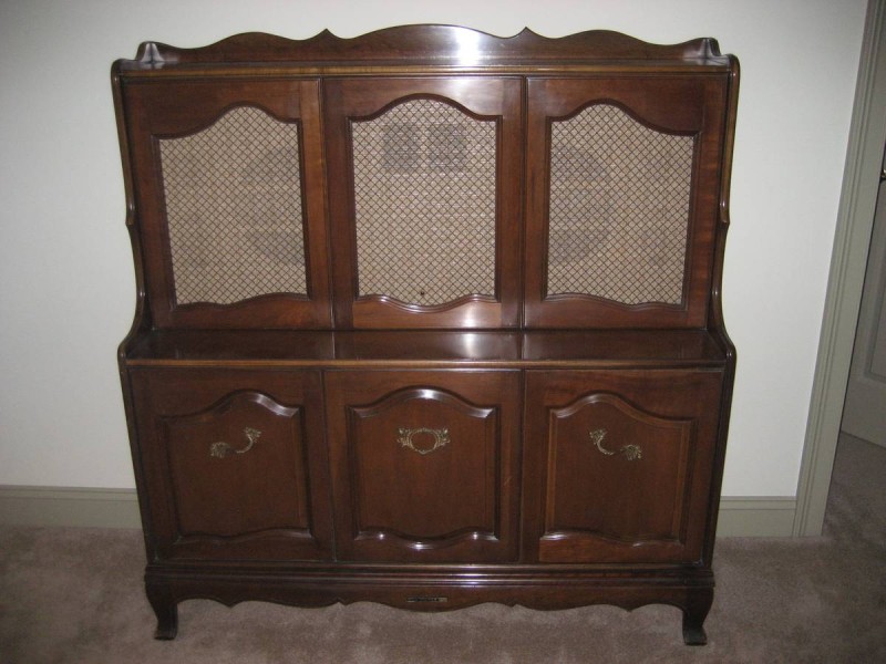

I saw this on CL in Doylestown, north of PHL. Tempting price but not anywhere I can "swing by" on my work travels.
This is a similar model 4VF480

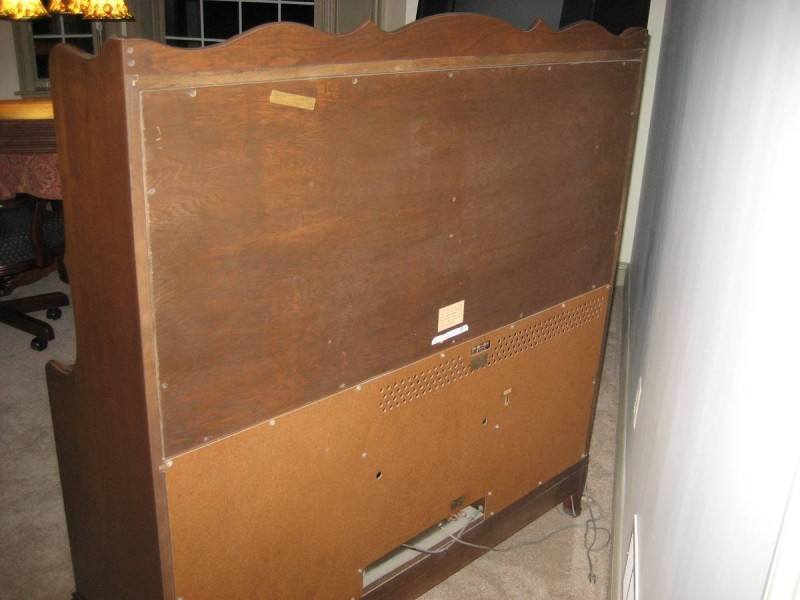

Speakers mounted up high, bass would not suffer TOO much if the cabinet is sufficiently reinforced.

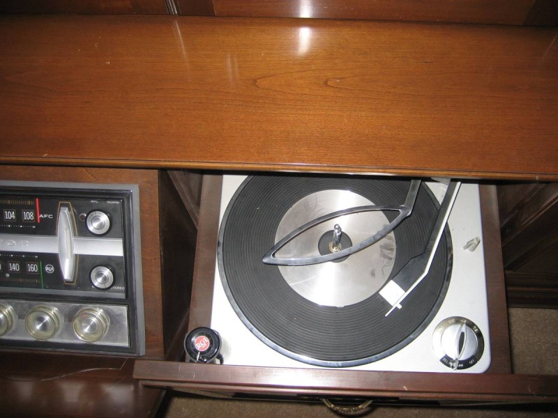

2-RP218 record changer, a great unit but always needs a cartridge fitted because originals dried/shrunk excessively

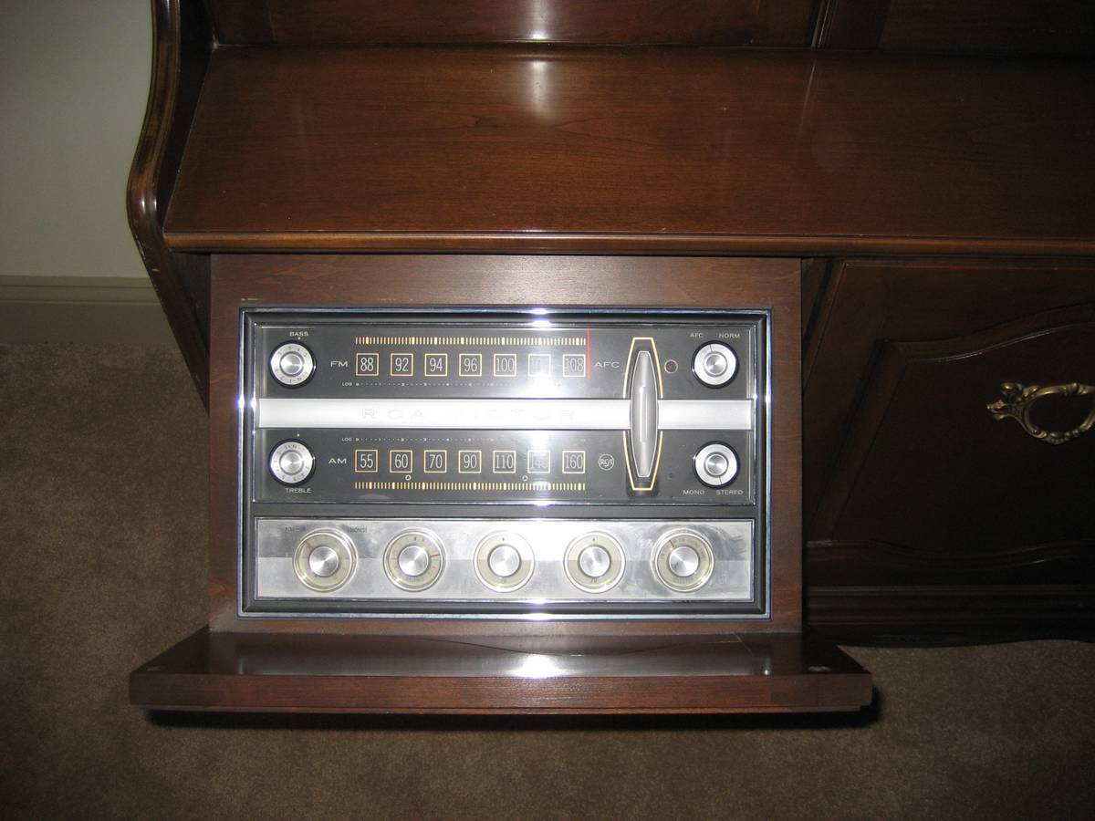

3-RC1205C tuner uses a 6FG6 eye tube and has on-board mpx decoder, improved (German-made) tuner using a 6C9

Had one once, liked the cool "tilt-out" receiver. The 2 ch PP 6bq5 amp and record player were fine, the tuner, OK, but the biggest weakness was the speakers. They're mounted in the top section in 1 big open rectangular compartment, not sealed, just Masonite on the back, the drivers were also pretty ordinary, iirc 10" woofer and a couple run-of-the-mill cone-type smaller units. The sound was spectacularly unimpressive so I moved it on (intact - the cab was very nice) quickly and cheaply. Also imagine this furniture style and hutch configuration would be a tough sell now. You mighta dodged a bullet on this one. That free one out in Elmira I mentioned a few months back near Dushore was the same thing but in a normal (low style, not hutch) console.
