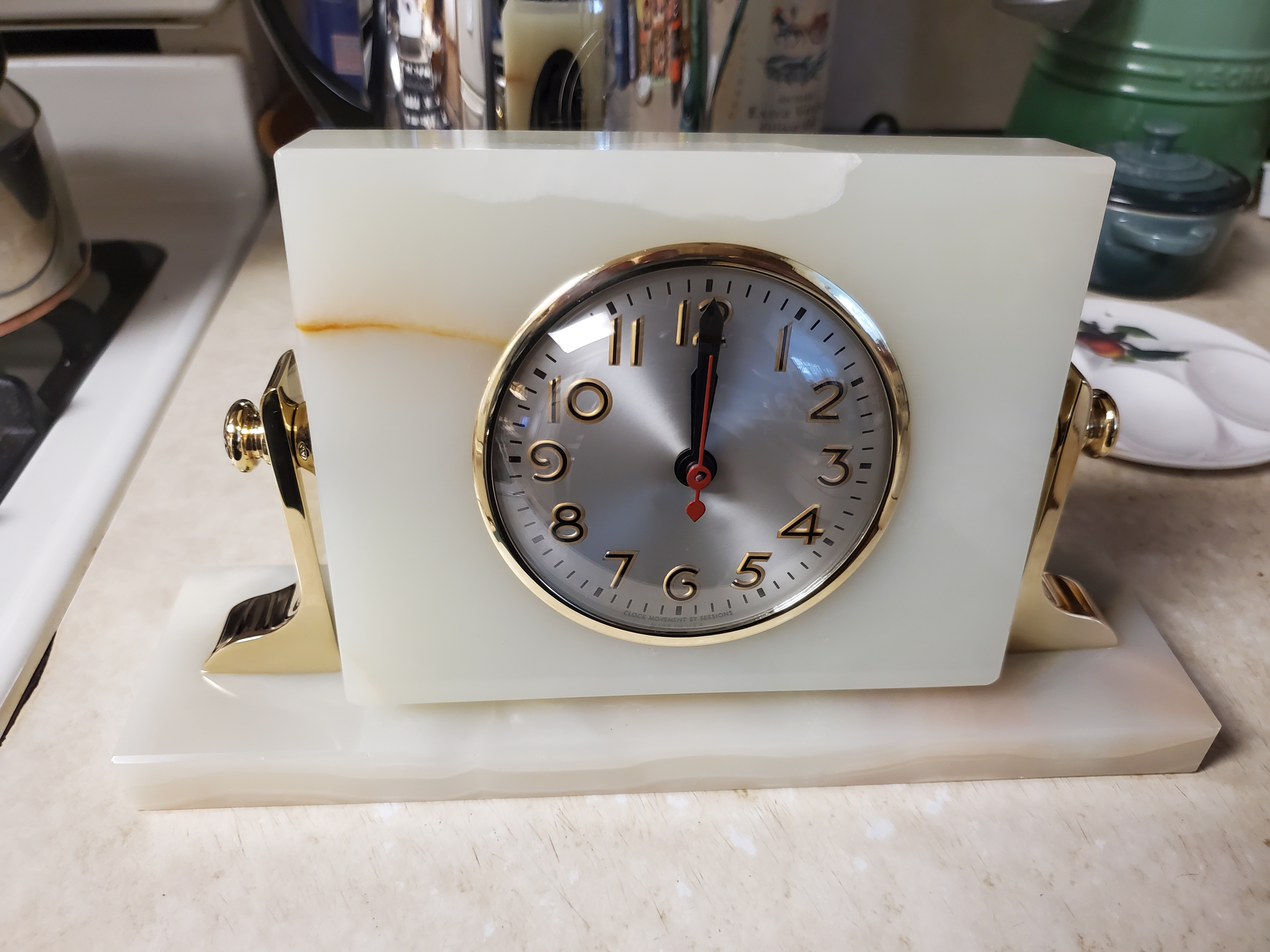

I added this onyx number for $13. More than I wanted to spend there but I couldn't look away from that deco face. Well, the rotor is shot. I cleaned it up and it's too nice to not run. I snagged another rotor on the 'bay with a different part number so I hope it works.

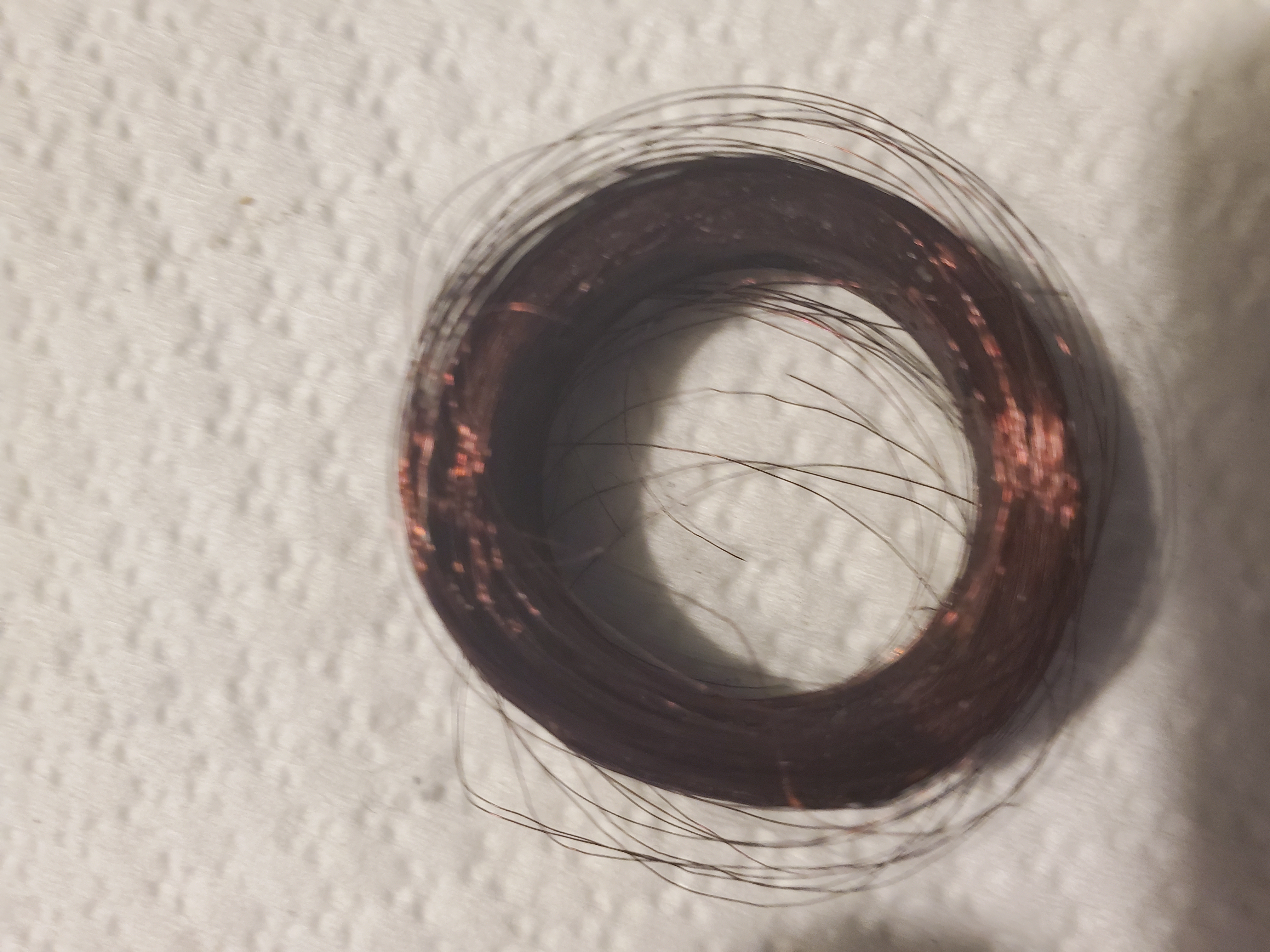

That's the coil I took out of the robot so...

Wow! I referenced your site when I restored my Warren Telechron. This sessions rotor has no guts, just that big coil. I did get this one working with a replacement rotor but I had to oil it about 10 times to quiet it down.
The bearing has a chamber that's filled with grease (probably whale blubber) and there's a tiny hole to the shaft. When the rotor heats up, the grease melts and lubes the shaft. I didn't want to take this one apart so I used the ZOOM oiler and let it seep in. So far, so good.
