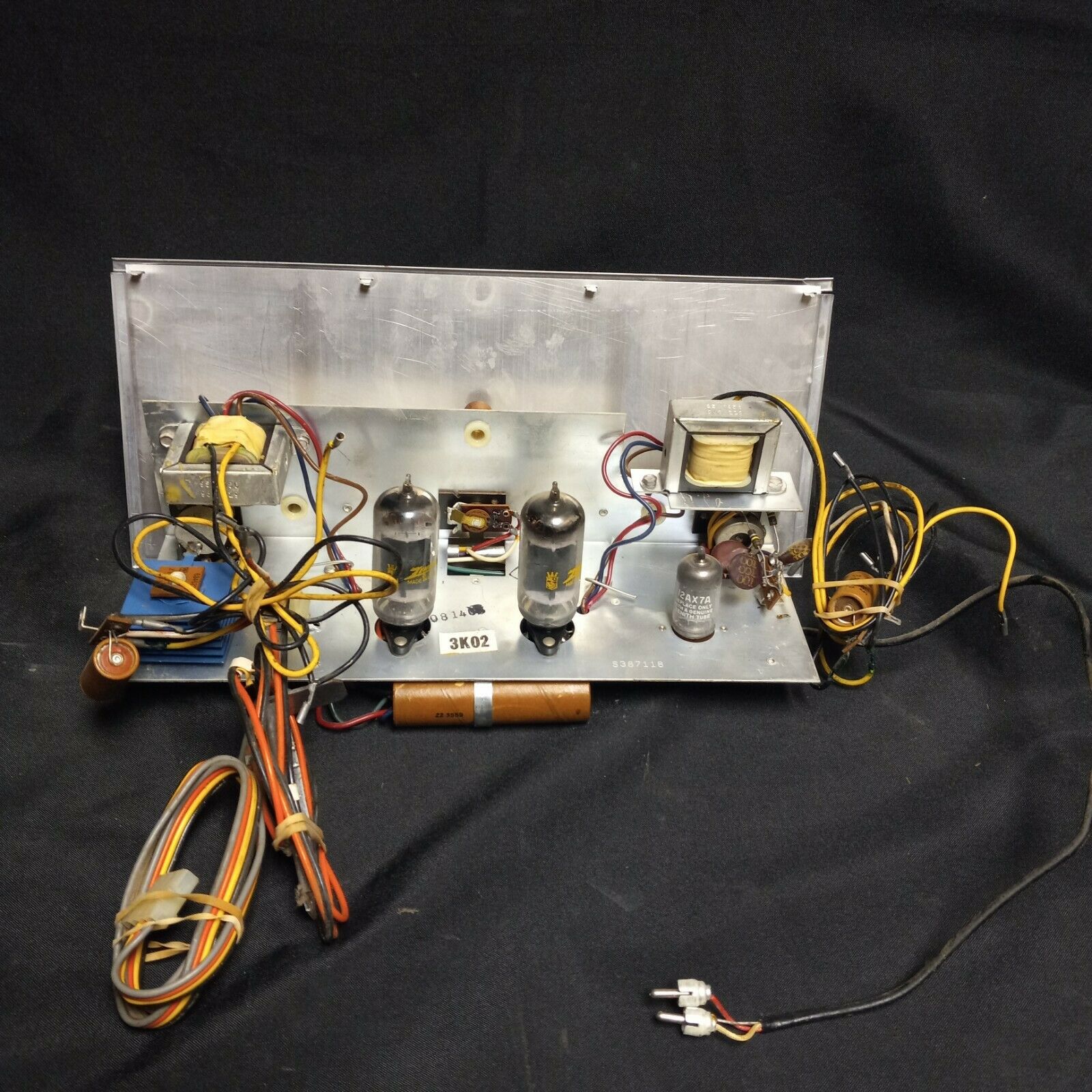

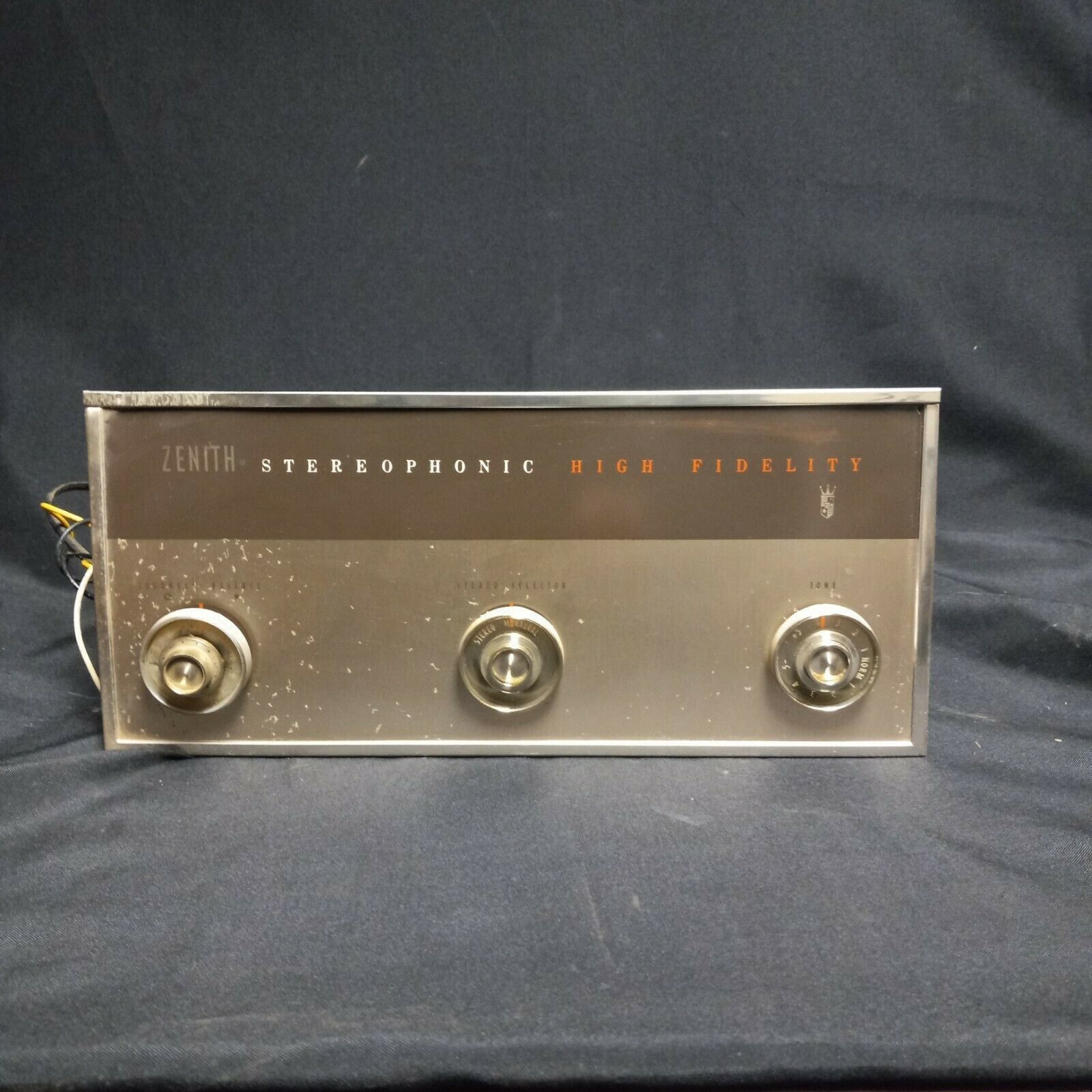

I've had just 1 Zenith console, that looked more like a glorified phonograph on legs, light enough that I could pick it up by myself. The cabinet was modern-ish styled, and it had just a Zenith labeled record player (a VM 1200?) and a plain 3-knob amp control panel, very minimal. It had a SE amp, I forget what tubes, those here look too short to be 6BQ5, 6AQ5 or 7695 maybe? with a hot-chassis, very small xfmrs, and a selenium stack rectifier, again, a real bean-counter special. Don't have a pic of the cabinet, but the amp was a lot like this one, an audio equivalent of a '62 Falcon with 3 spd column shift, R & H...cheap!!
Let us know about your experience with Zenith consoles, past & present! Hopefully better than this cheesy thing!

I wouldn't hazard a guess on those output tubes. My first guess would be 35/50EH5, but those are too short/fat. Looks like the socket holes in the chassis are bigger than the tube sockets. 3KO2 is the chassis number. Do you have the Sams?

Post: # 7414Post hermitcrab »
Schematic puts them as 7695 beam amplifiers producing 4.5 watts

Post: # 7423Post Firedome »
I checked radiomuseum, yes it's the 7695 alright, an audio output tube that I've never seen before on paper or in practice! Used in portable record player and TV audio output stages?

Post: # 8057Post hermitcrab »
It is about the simplest amplifier I ever saw , I would replace the selenium rectifier if anything...

Post: # 8258Post Motorola minion »
Firedome wrote: ↑Fri May 06, 2022 8:50 pm I checked radiomuseum, yes it's the 7695 alright, an audio output tube that I've never seen before on paper or in practice! Used in portable record player and TV audio output stages?
The Westinghouse console I have, larger than the mini your uncle had, uses 7695s. The bass is surprisingly good too.

hermitcrab wrote: ↑Sun Jun 05, 2022 3:45 pm It is about the simplest amplifier I ever saw , I would replace the selenium rectifier if anything...
...and that "firecracker" electrolytic underneath. Even Zenith used lousy parts on :oops: occasion

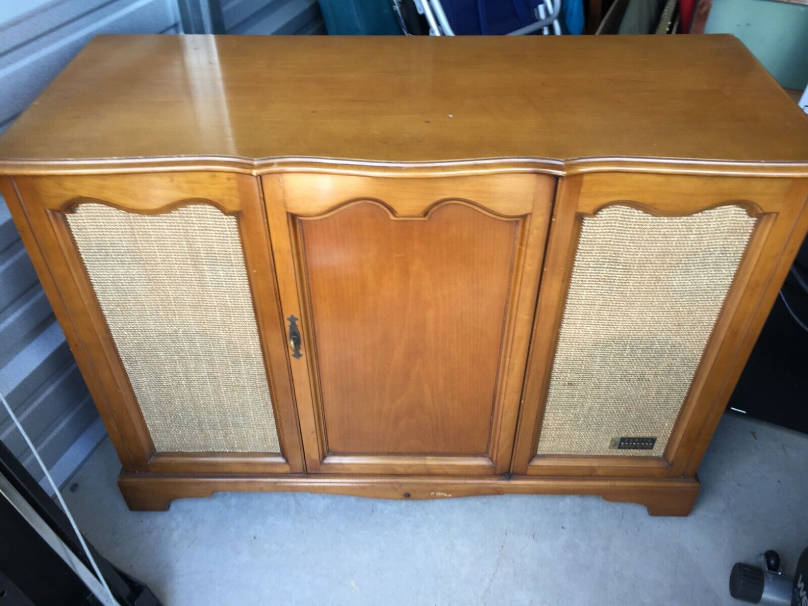

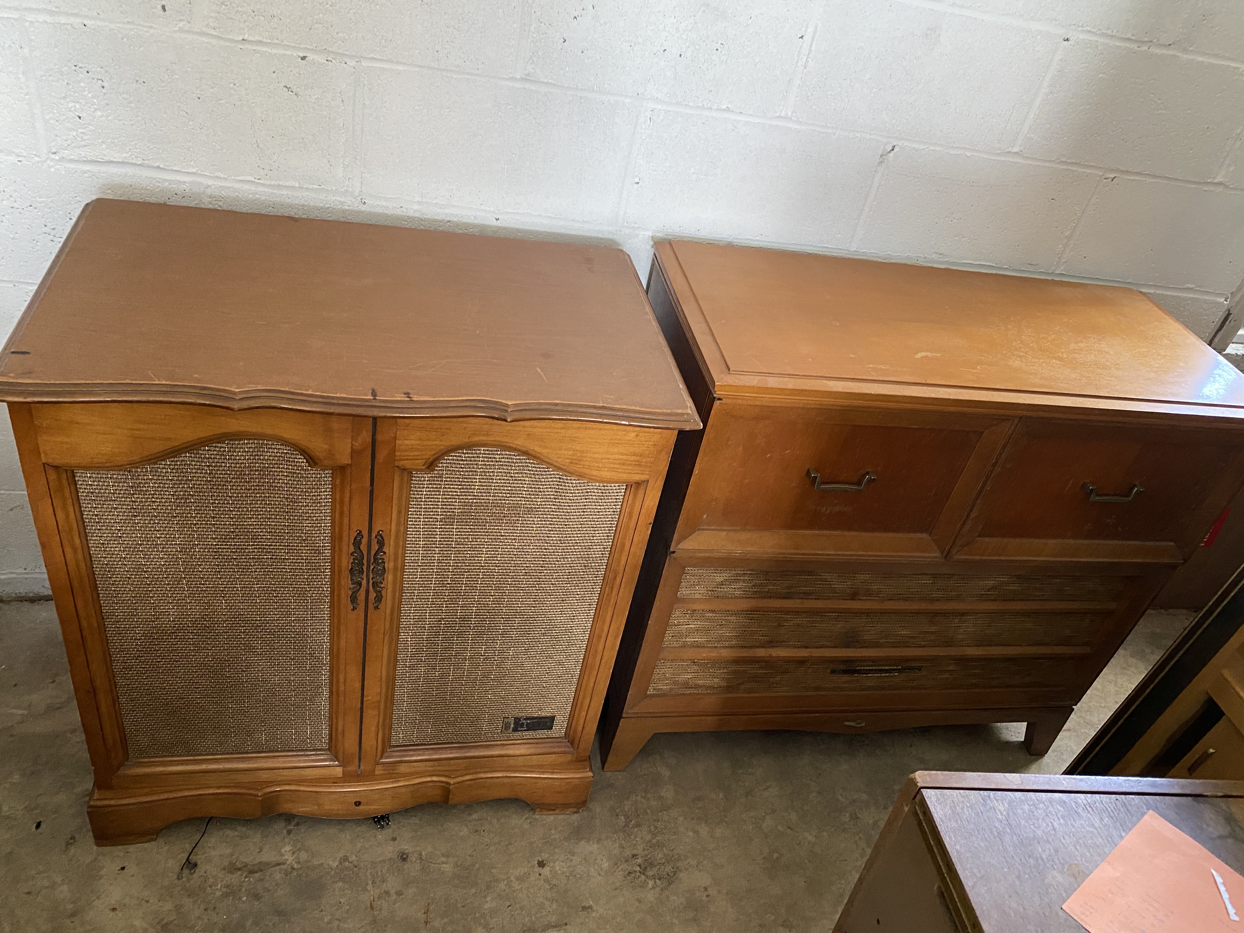

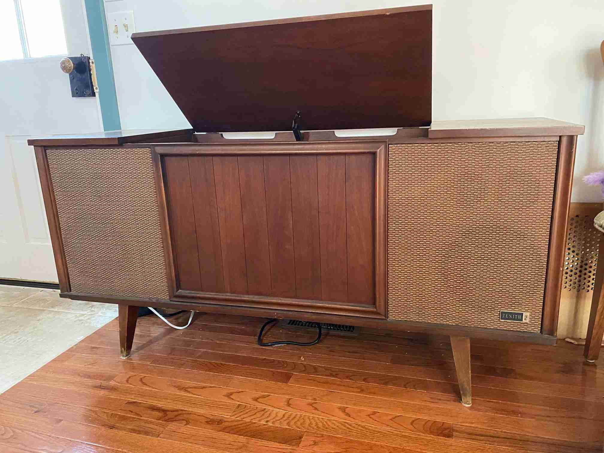

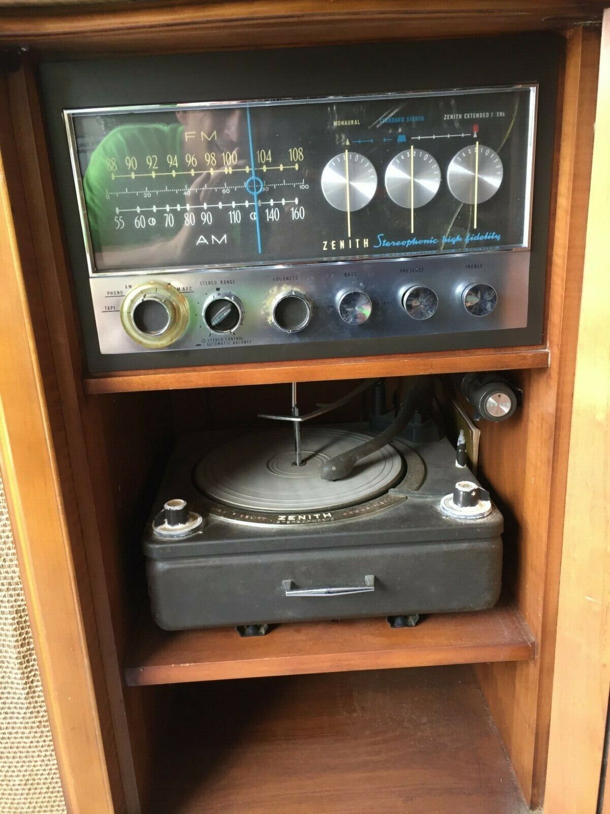

Post: # 10618Post Motorola minion »
Here are some more of those very familiar looking models, attached on this post is a 1960 SFD2565 console I just picked up for $100 on Ebay, fortunately just 2 hours north, so I picked it up on Friday on the way home from a jobsite ;) The pictures are from the seller. I opened it up and found replacement tubes on the 6BQ5 PP stereo amp chassis, so there are hours on it. The extended stereo should be interesting next to the Motorola 3-channel. :)
Next post will be pictures are of a 1963 MH2635 which is the version of the single-ended 6BQ5 amp with slightly more power, FM stereo tuner reverb tank/3-tube chassis with a silly control location in the record compartment , not on the front panel like RCA or Motorola. It has the Zenith-made cobra tonearm changer.
