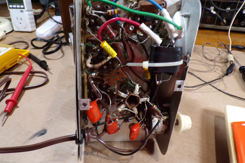

This is my next project. I bought this little 4-tube set at an auction in the rain. It needs paint and TLC. It is also kicking my butt. After you all stop laughing, here is the situation. This thing will not say a word. No reception at all. Everything I have checked, checks good. It acts to me like the oscillator is not running. It's been a couple years since I messed with it, but memory recalls that the oscillator showed to be working with negative voltage on the grid of the oscillator. There is an approximately 20 foot hank antenna on it. I can get a signal at IF from the antenna coil to the speaker. All element voltages were good. I need to start over and make every measurement again. I was in a weak signal area in Missouri, so that may have had an effect on it. Out here with a good signal, who knows? I am going to go thru everything again and will take pictures and share results, so stand by.

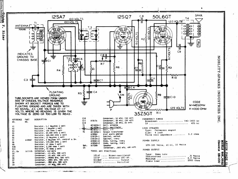

I found the print for this radio. I have the print for every radio I owned at one point. I have my VTVM warming up. I want to find what I have been overlooking. This is a four-tube radio, for the love of Mike. It has maybe a half dozen parts. I took a Stereo Theater apart to the last board and put it back together so it works. Come on, Greg......

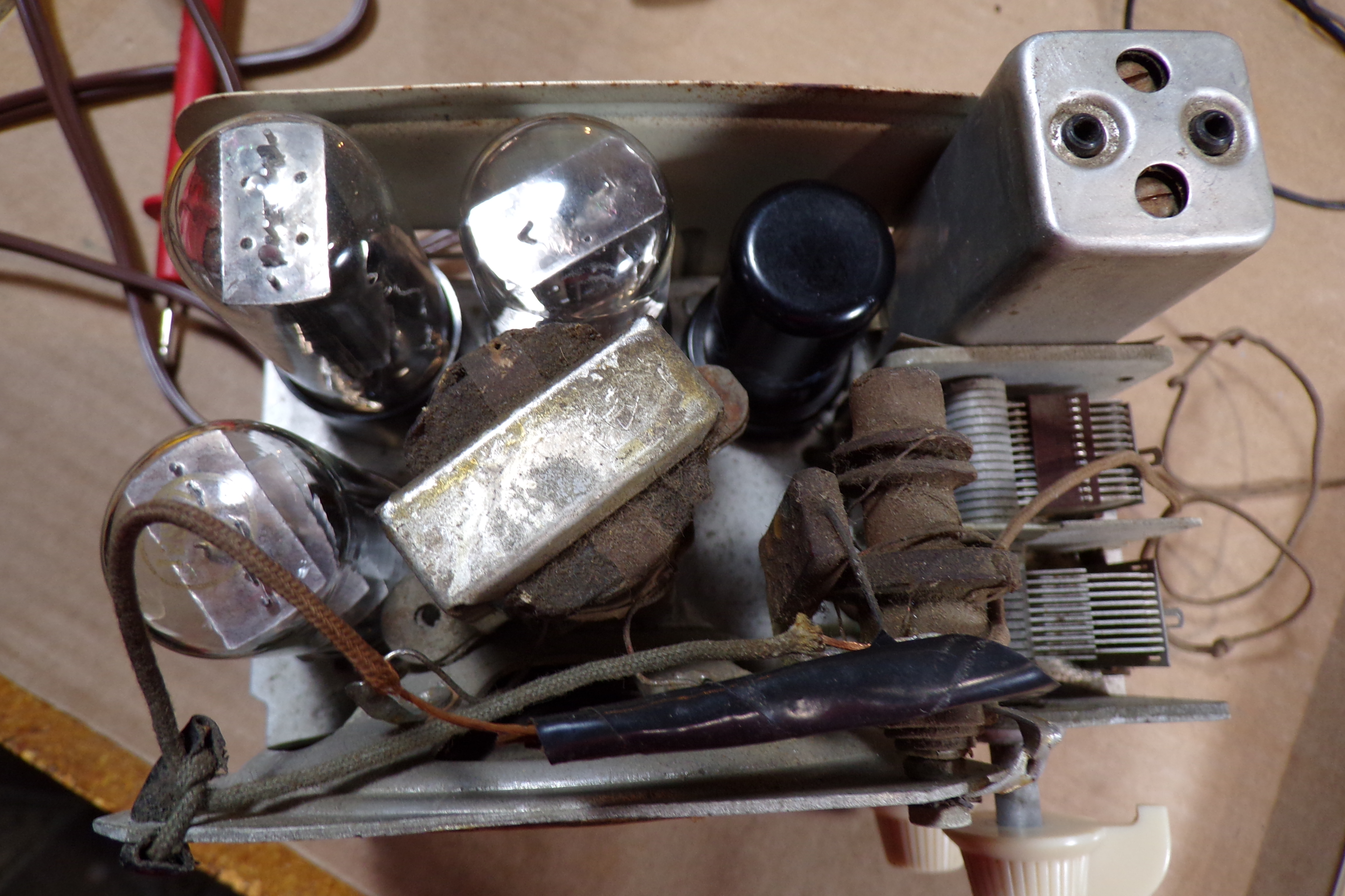

The primary of the oscillator coil appears to be intermittently open. There was a mica cap connected between the coil and pin 5 the oscillator grid of the 12SA7 tube. I changed that mica caps just to be sure it was not the trouble. I am suspecting green crud in the oscillator coil, since this set came from the midwest and I bought it in the rain. That coil may have been wet at some point. Sometimes I get negative voltage on the oscillator grid, sometimes not. There is another trouble in addition to that, however. If the oscillator running intermittently was the only trouble, I should have an intermittent radio reception. R10, a 2200 ohm 1-watt resistor must have drifted high, since I only have 70 volts on the screen of the 50L6 instead of the specified 100 volts. This is not the reason for the inoperative set, however, since I have noise in the speaker. I have good B+ otherwise and all the other element voltages are really close. I was powering the chassis on my Variac at 117 volts. I need to do some digging. I believe I have an oscillator coil on a junker chassis around here somewhere.

I found a good oscillator coil in a junker chassis and put it in this chassis. That made no difference. I have three volts negative on the grid of the 12SA7, a bit low, but better than zero. I'd expect to see five volts negative or more negative on the grid. It does not get more negative as I move the dial to higher frequencies. I have 80 volts on the cathode of the 12SA7. That doesn't sound right to me. It is possible the original oscillator coil was bad, but whatever is putting 80 volts on the cathode took the oscillator coil out. It appears the oscillator is somewhat running, although I can't hear it in another radio. How hard can a four-tube radio be?

I struggle mightily when trying to troubleshoot oscillator coils and band switches. Following a schematic drawing of these items is my biggest problem. I would appreciate some hands-on technical advice when it comes to these items. The main problem I see with this chassis is that I have 60 volts on the cathode, pin 6, of the 12SA7 oscillator tube. At this point, I have determined that the oscillator coil itself may not be the issue. Something is killing the oscillator. The speaker on this set is in horrible condition, so audio is weak, but that is not my concern at the moment. I can get noise thru the set from pin 6 of the oscillator on to the speaker. This leads me to believe the oscillator coil itself if good and I have subbed it (I THINK I WIRED IT RIGHT
) with no improvement. How and why can I get 60 volts on pin 6? How is that even possible? R8 and C7 are the only paths I see for B+ to get to pin 6 of the oscillator tube. I'm overlooking something. Maybe a component by component value check is in order? Other than pin 6, the element voltages I have checked are okay. I need to fire up the signal generator then see where I can get a signal thru to the speaker. I really need to figure out what ails this simple little radio....

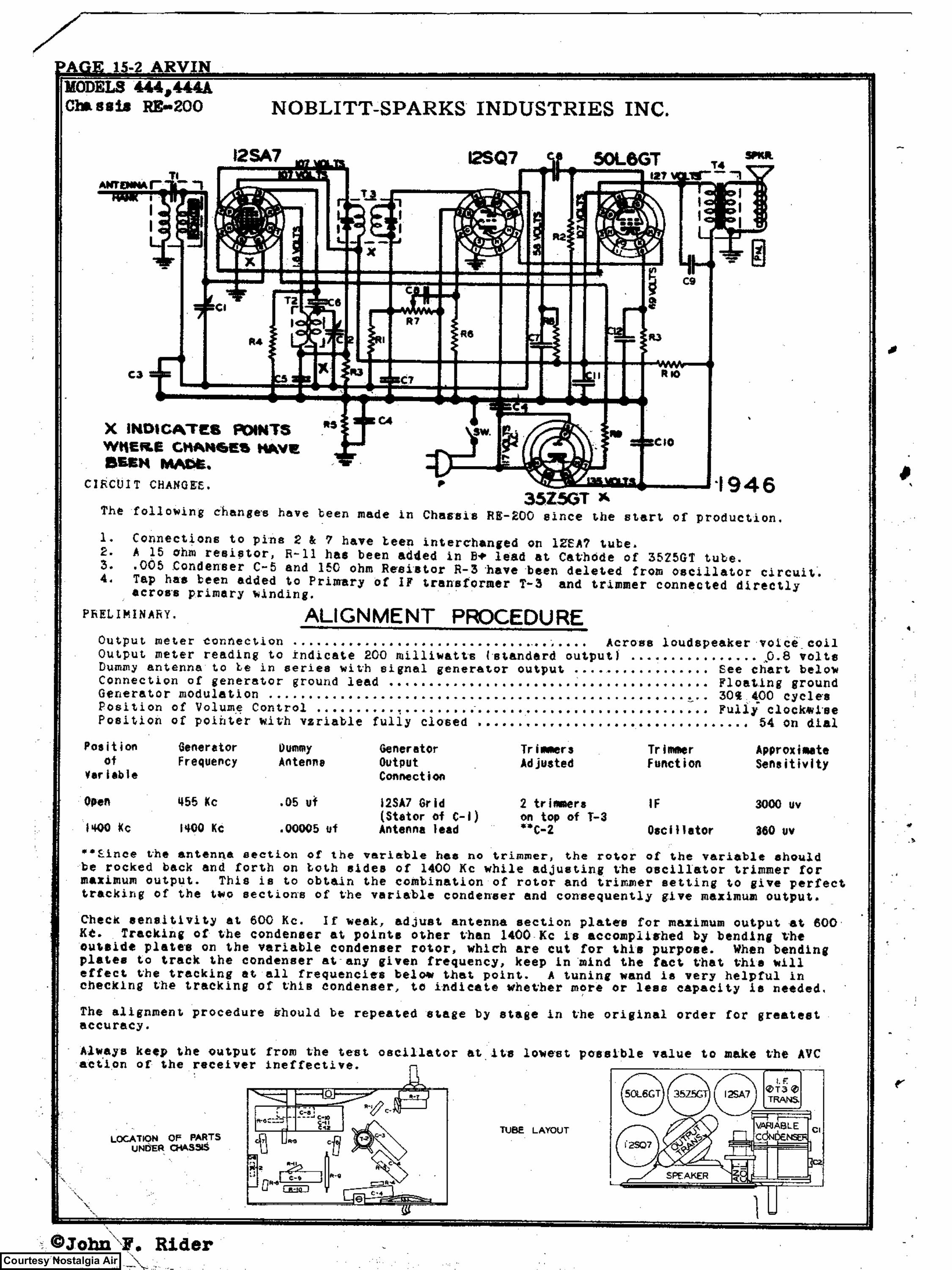

Schematic from Nostalgia Air (also added to downloads): http://www.nostalgiaair.org/Resources/d ... 012518.pdf

You are saying you get 60V on pin 6 (Cathode) of 12SA7, which connects to "floating ground" through the primary of T2? Something is wonky.
Are you using the floating ground as reference? Have you swapped out the 12SA7 (maybe it's shorted?) I assume primary of T2 has continuity?

I am saying exactly that. I have 60 volts DC on the cathode measured from common negative, floating ground, from one terminal of the power switch, where the filter caps negatives are connected, whatever they want to call it. Measuring continuity on T2 is where I am having an issue. I can't find continuity FROM anywhere TO anywhere on T2. Hence my frustration.....
I got the same readings when I subbed in another oscillator coil....
I have the drawing you posted. Not only was this a cheap radio when it was built, but the drawing is equally cheap. Not much help, when you get to looking at it.

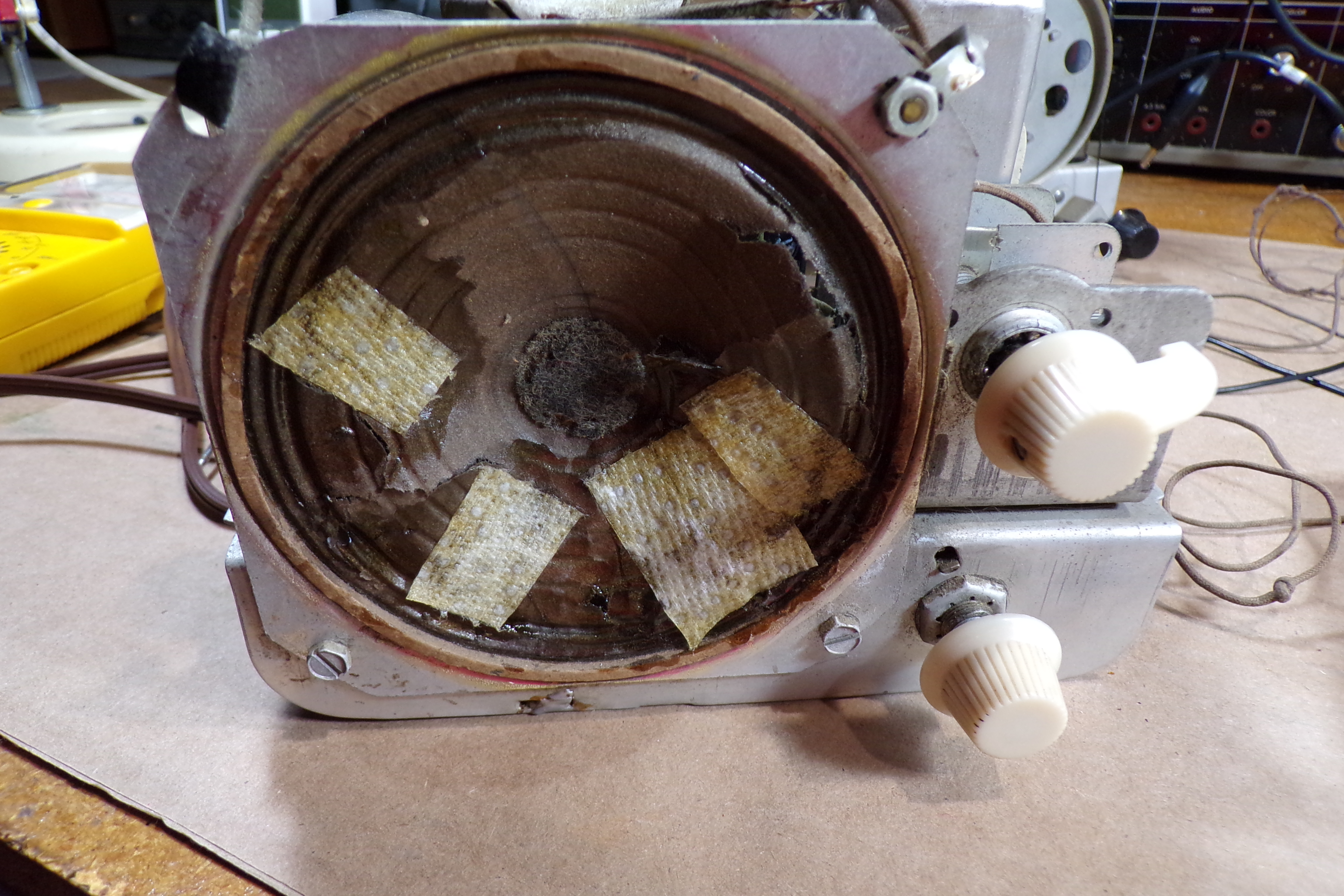

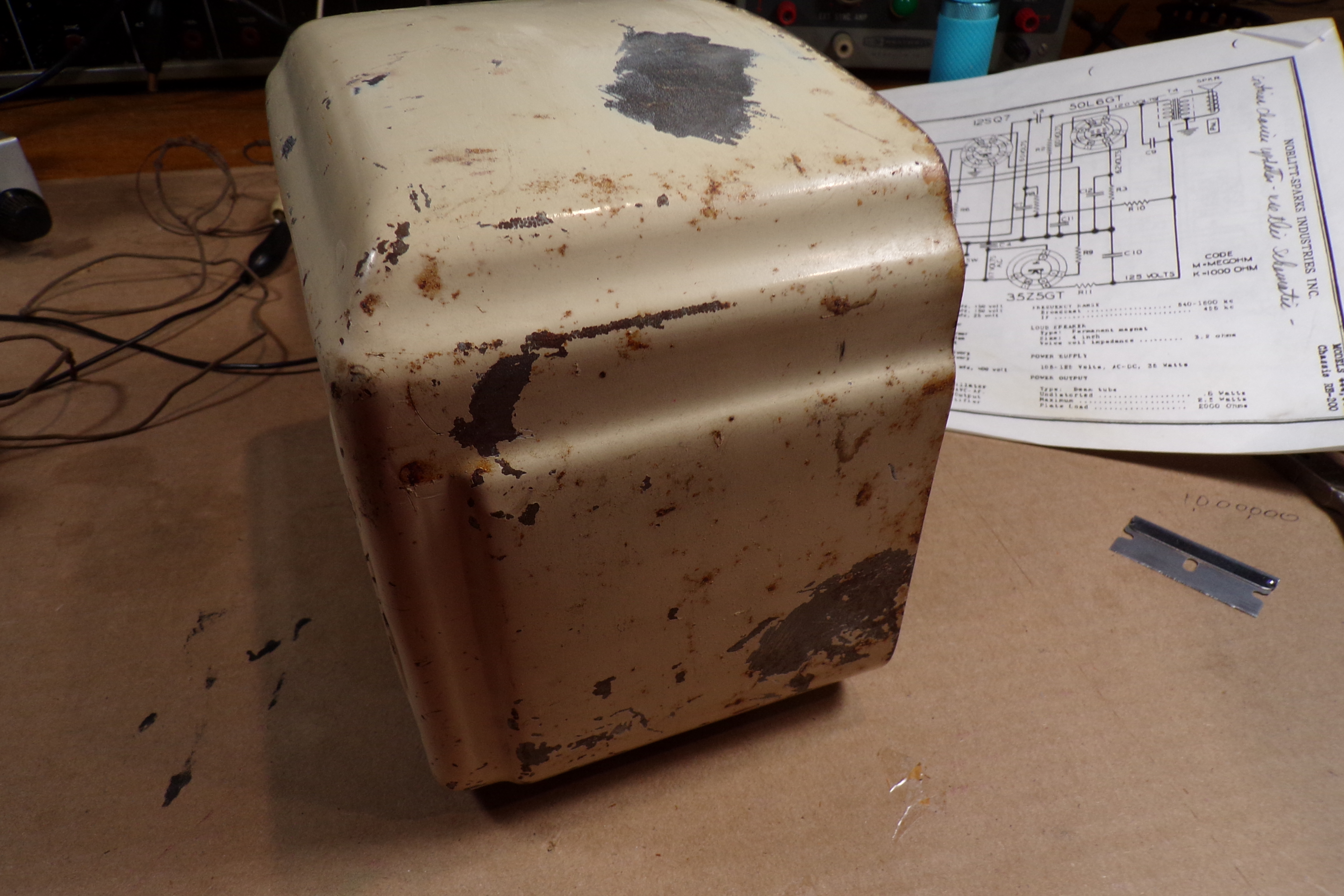

- Posts: 9026
Re: Arvin 444-A

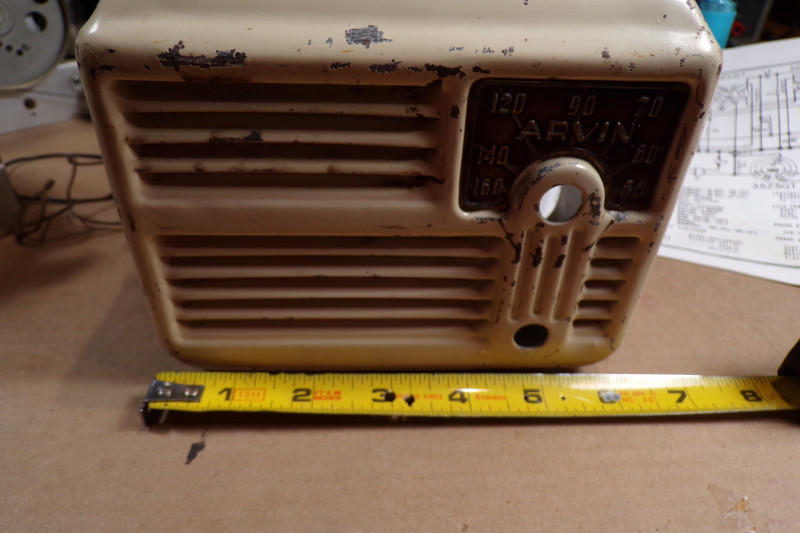

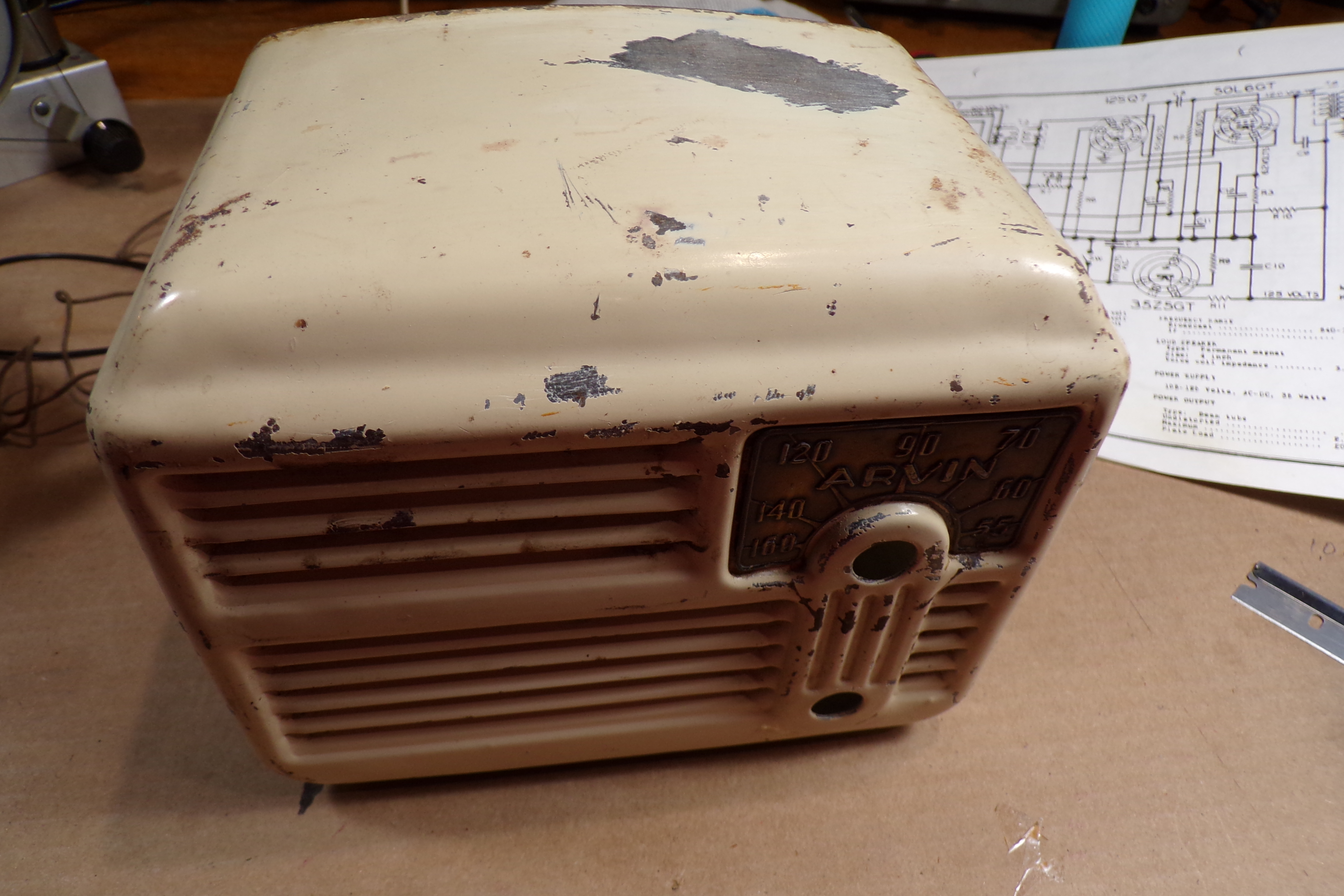

This thing is really rough when you see it in pictures.
It needs a lot of help, but it's a midget radio and I don't have one. Every resistor in this set except one is more than 20% drifted out of value. The AVC resistor is out more than 20%, but will that kill the oscillator? Best I can tell, the oscillator coil is not open. The voltages on the 12SA7 are not right, but I haven't found a cause yet. Jeez, there isn't much that can go wrong. More than one thing, maybe? I found a speaker I can make work. Something is killing the oscillator.....
On the bright side, there is a man on ARF wanting knobs and a back for one of these. This POS has all its original ones, probably worth more than the whole radio is....
