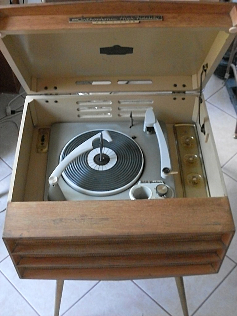

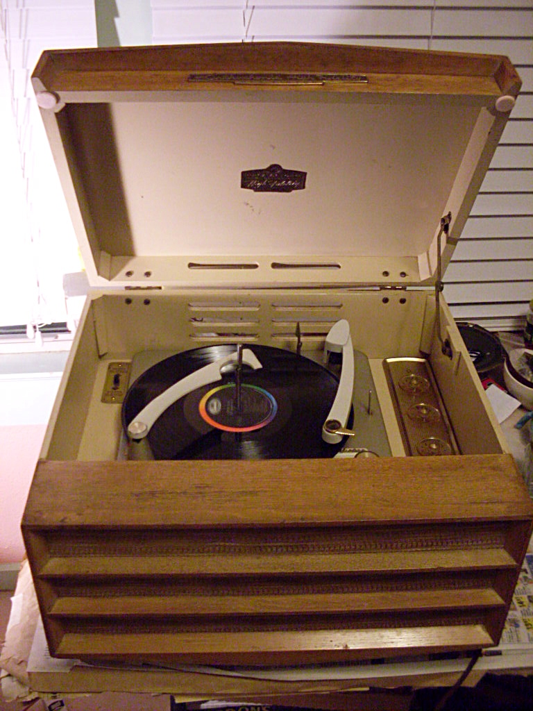

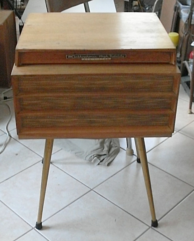

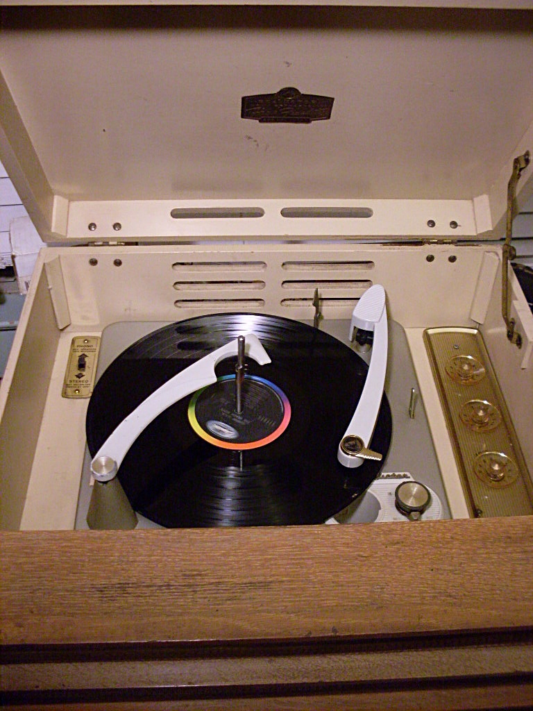

Hello all,
In between painful dental work, I've got
this 1956/7 RCA back together.
She sounds very nice with a 50C5 PP amp.
Much,much grime everywhere at the start,
but she's clean now.
I worked with the finish carefully, and
that's also as good as it will be.
The lid hinge's little locking ball bearing
was worn, and the hinge would not stay
locked.
I could not find any hinges I had
saved from other junked players.
When I took off the hinge, I thought it might
work if I reversed its position.
That did the trick, and now the lid will stay up.
I also have the tapered metal legs for her.
So, now to find her a good home.
locked.

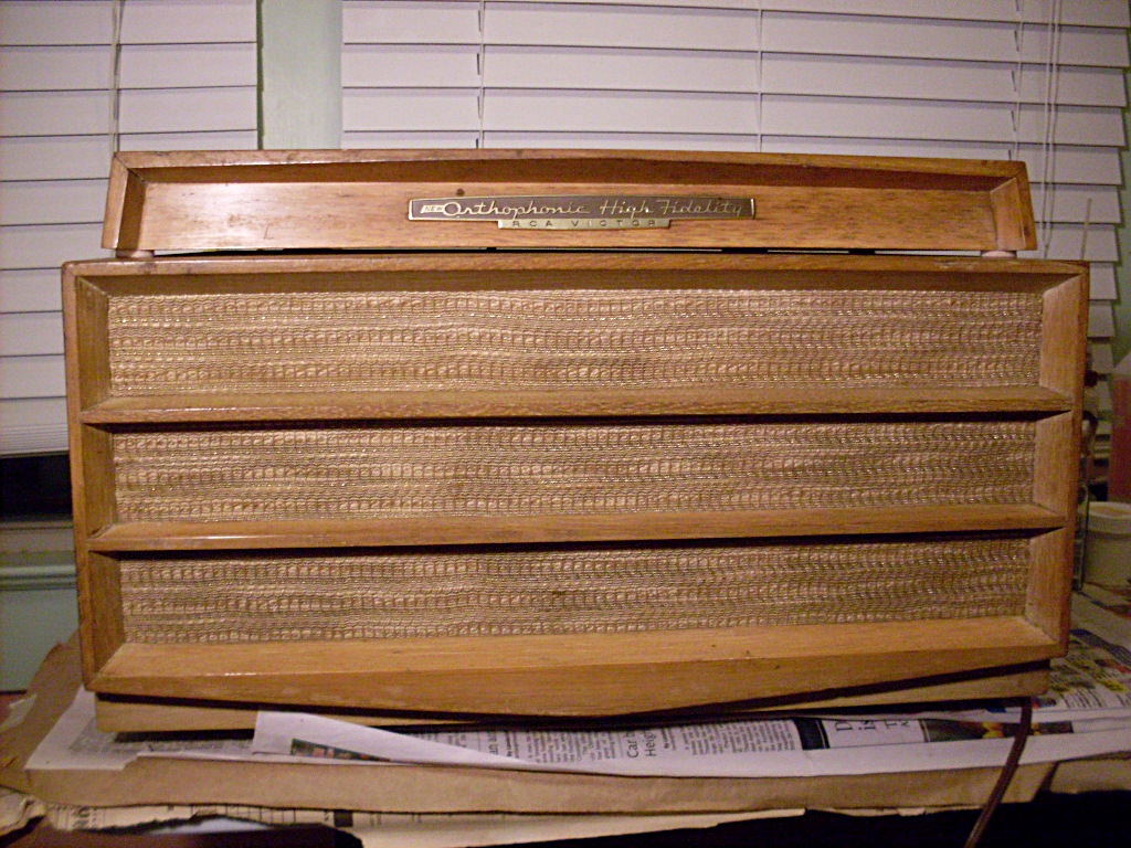

Re: RCA 7-HF-5 Consolette completed
This is not limed oak, but some kind of over coverhermitcrab wrote: ↑Sat Jun 18, 2022 3:07 pm Looks good the blond finish was the big thing in the 50's ,
not sure how you replicate it ... is it just linseed oil or varnish on bare wood?
above a dark veneer.
I don't think this is a photo-finish, but I've no
experience to know for sure.
I noticed this as I was cleaning with 0000 steel wool
and Howards, and I had to be
cautious not to remove that "blonde" finish.
- Posts: 5462
To me, the coloring looks like what RCA called their maple finish. It has the honey tone of maple which could be achieved on any wood.
Agree, it doesn't look like true limed oak, not sure what the wood actually is but the color in the pic is closer to a light maple.
