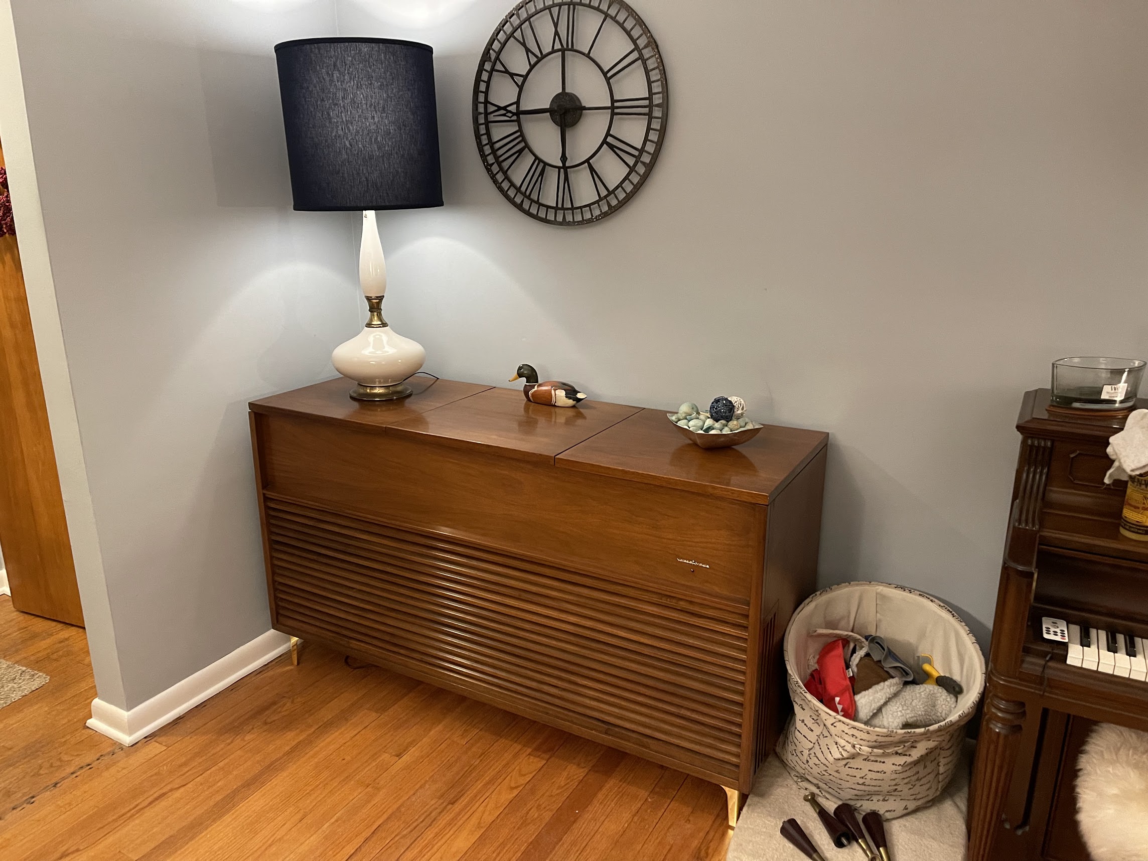

I'm trying to remember if the old site was running when I picked up my VM-1000 this past spring. It has been a little (and I use the word little pretty loosely, she weighs in at 216 pounds) labor of love since I got it. It came out of a little run down home in south Detroit, I doubt it was its original home, it was not the type of home one would expect to find a top-of-the-line stereo console, but I could be wrong.
The cabinet was pretty disgusting, it had a broken leg, and wasn't really working. One of the first things that I did to it was get some new legs, I just got some gold furniture legs off of Amazon, and they look similar enough to the originals that no will notice. I then went through, rebuilt both amps, the tuner, and the tape deck (my first reel-to-reel). The record changer just needed a new cartridge, the removable cartridge sled on these makes it super simple to do!
A couple months ago, I found a set of spare amps, clock, tuner, and control panel as a lot on eBay, I got everything as my clock is dead, and my tuner has issues on AM in the middle of the band. I had also received a pair of speakers from a friend that are from a VM-580 that are in the same finish as the 1000. I replaced the crappy woofers with a pair of Jensen P12-RL woofers, the same as what's in the 1000. When I put the VM in front of the picture window, I hook them up and it looks pretty awesome, and sounds great! I am debating putting the spare 1000 amps in the extension speakers and using them for other purposes.
2 weeks ago I replaced the Pfanstiehl P-226 Cartridge that I had bought for the replacement and put in a NOS EV-26, I found a seller selling them on ebay and needed a couple for my Magnavox changers that originally had them. It sounds really good with that EV-26 cartridge, and it is era correct.
The lid over the tape deck had issues with the front veneer strip, almost like there was water damage, but the rest of the lid was fine and there were no water spots on the lid. I hate doing woodworking and refinish work, but I made the veneer look better and less noticeable.
There's always something going on with the VM. I tell people its for sale, but my asking price is $2,000 due to not only the time, effort, and money that I have into it, but I also don't need to sell it either.

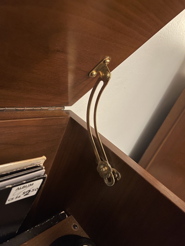

I forgot to mention that in my never ending story with the 1000 is that I am looking for better hinge supports. When I got it, it was missing one, one was broken, and the third was fine. I bought 3 new ones at lowes so that they would match, but I have them tightened as much as possible and they will not hold the lids up. They did at first, but they wore out very quickly.
If anyone has any ideas for replacements that will last, I am listening!

These are similar to what Zenith uses
https://www.bing.com/images/search?view ... ajaxserp=0
These are what RCA uses, but you would need to take a section out of those piano hinges https://www.bing.com/images/search?view ... ajaxserp=0
