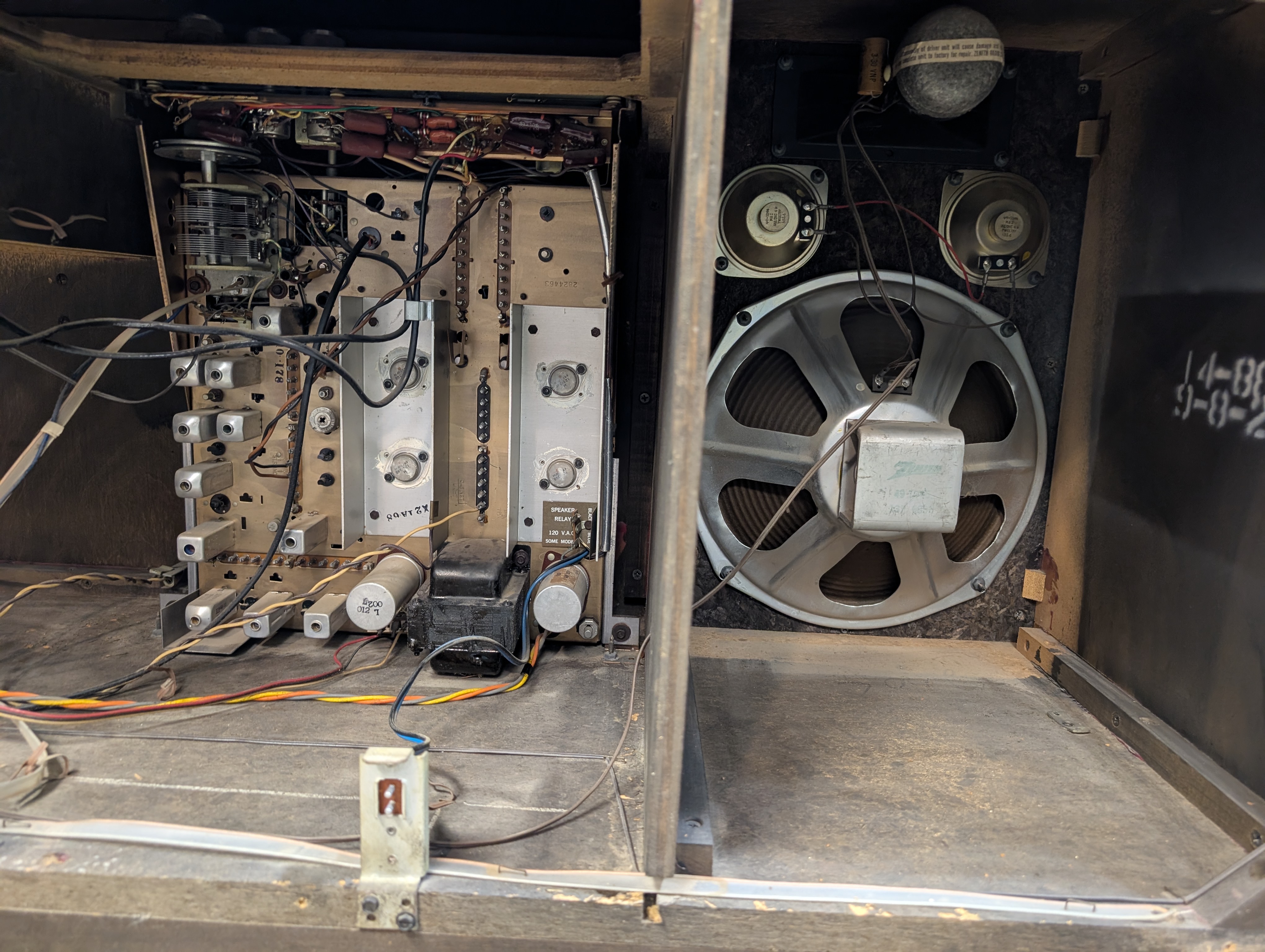

Fixing it up for my daughter and son-in-law. I've got two projects going, this one and the Motorola SK29! Garage is too hot for cabinet work right now, so I'm working on the electronics and chargers in my upstairs shop.
12"woofer, two tweeters and a midrange(?) horn per channel, 25ZT120 chassis. It's got the VM 1297 Microtouch 2G changer. Pretty much finished refurbing the changer, and it had some interesting issues which I'll describe later below.

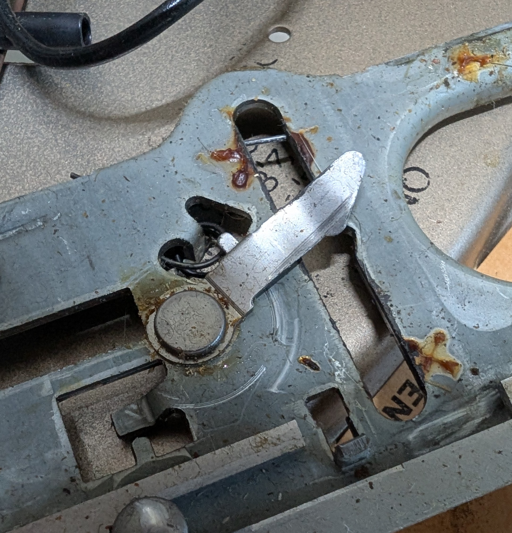

When I began disassembling the changer, I found that the little flipper doohickey (the older service manual for the 1200 series that I have does not actually show that part) was bent over and rotated around and the spring was also deformed. I was able to straighten everything out and reform the spring, now after cleaning, it appears that it's going to work okay. Fingers crossed. Can't figure out how somebody managed to accomplish that destruction! I was interested to see that this version of the changer has several improvements to lower the tracking force requirement. One major difference is the little ball bearing slider that is under the trip link, unlike the two other 1200s that I have serviced. You can really feel the difference in the way the trip link friction is reduced! As soon as I have a decent idler wheel, I'll see how well this thing works!

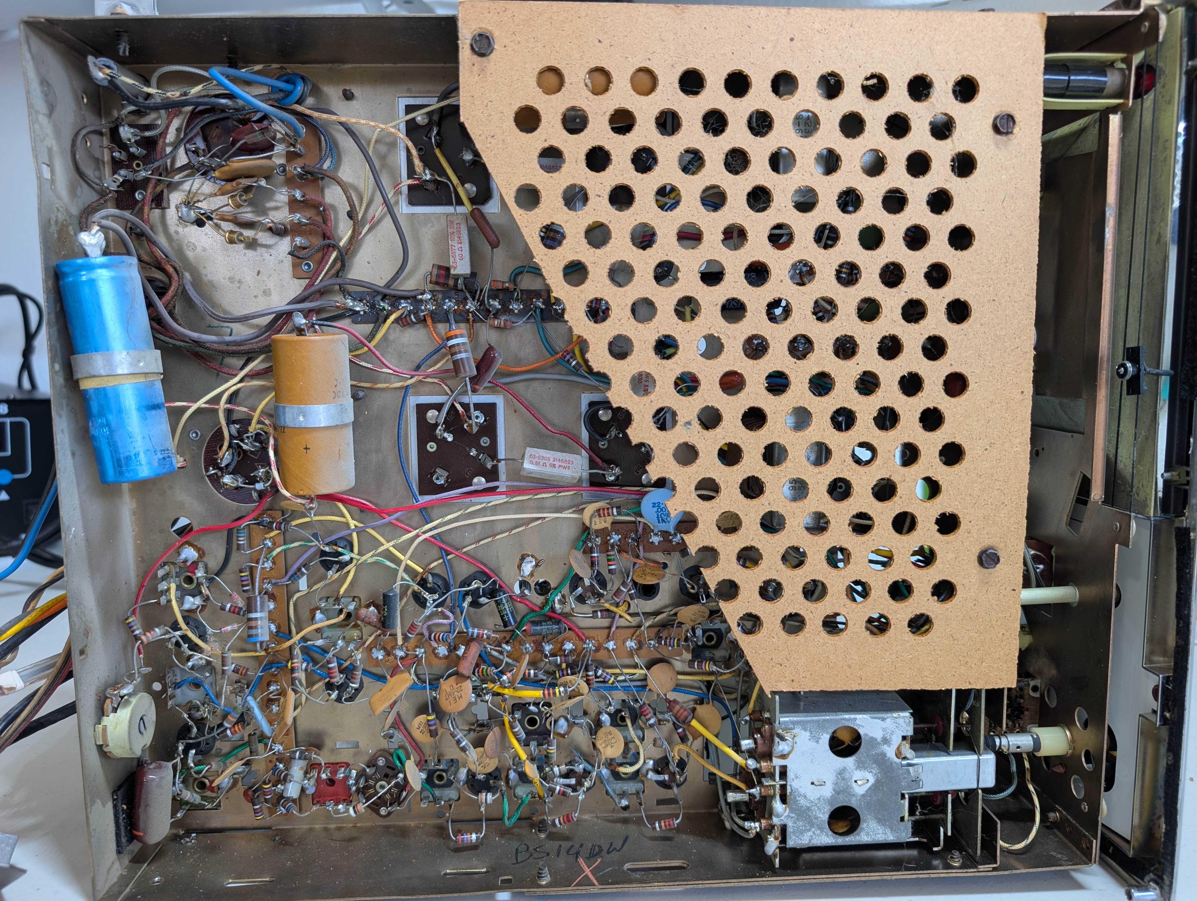

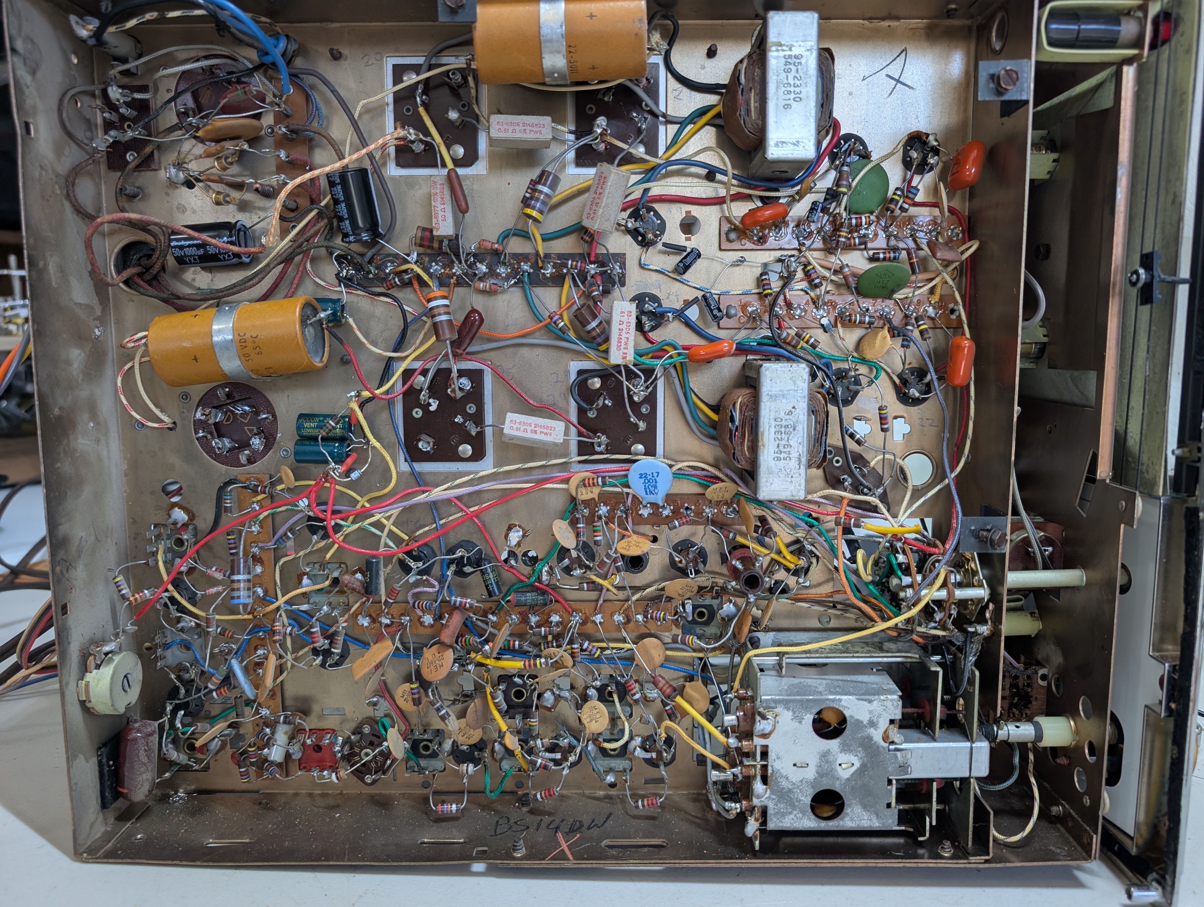

Finished recapping the chassis this afternoon. Looks like the power supply cap cans had been replaced sometime ago, and one separate 1000uf/50v was replaced with 1500uf/75v connected with lamp cord (the blue one on the left).
I didn't trust any of those, so I replaced them, and several other 'lytics in the amp section, except the output coupling caps tested fine, so I left those in for now (the tan ones).
Amazingly, it works, and nothing is overheating! FM and AM need alignment, and I think perhaps one amp channel is weak, but it's hard to tell because this strange volume/balance control. I had tested the output transistors, and one looks like it may be bad, I'll look into that. It's all germanium, so that will further complicate replacement parts.

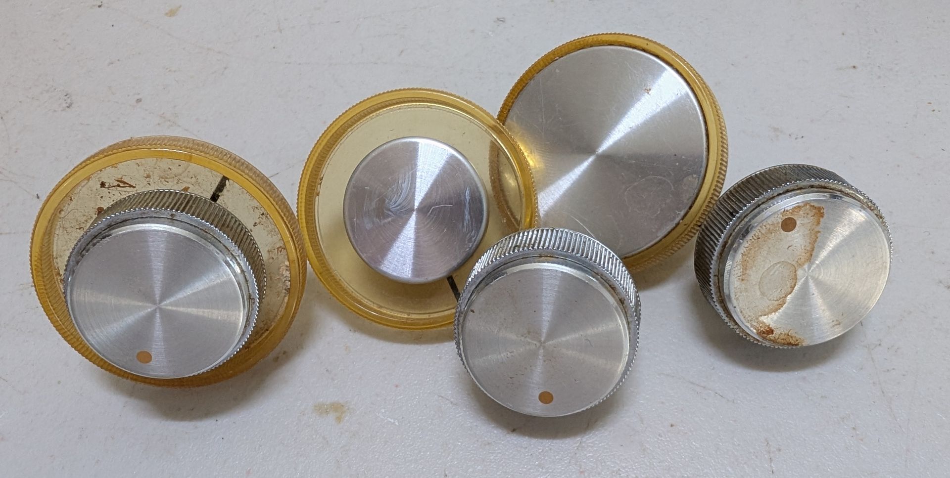

Re: Zenith X940 restoration project,, yellowed knobs fix
Anybody been successful in clearing the yellow in these plastic knobs? I've tried soaking in oxiclean, but no luck.

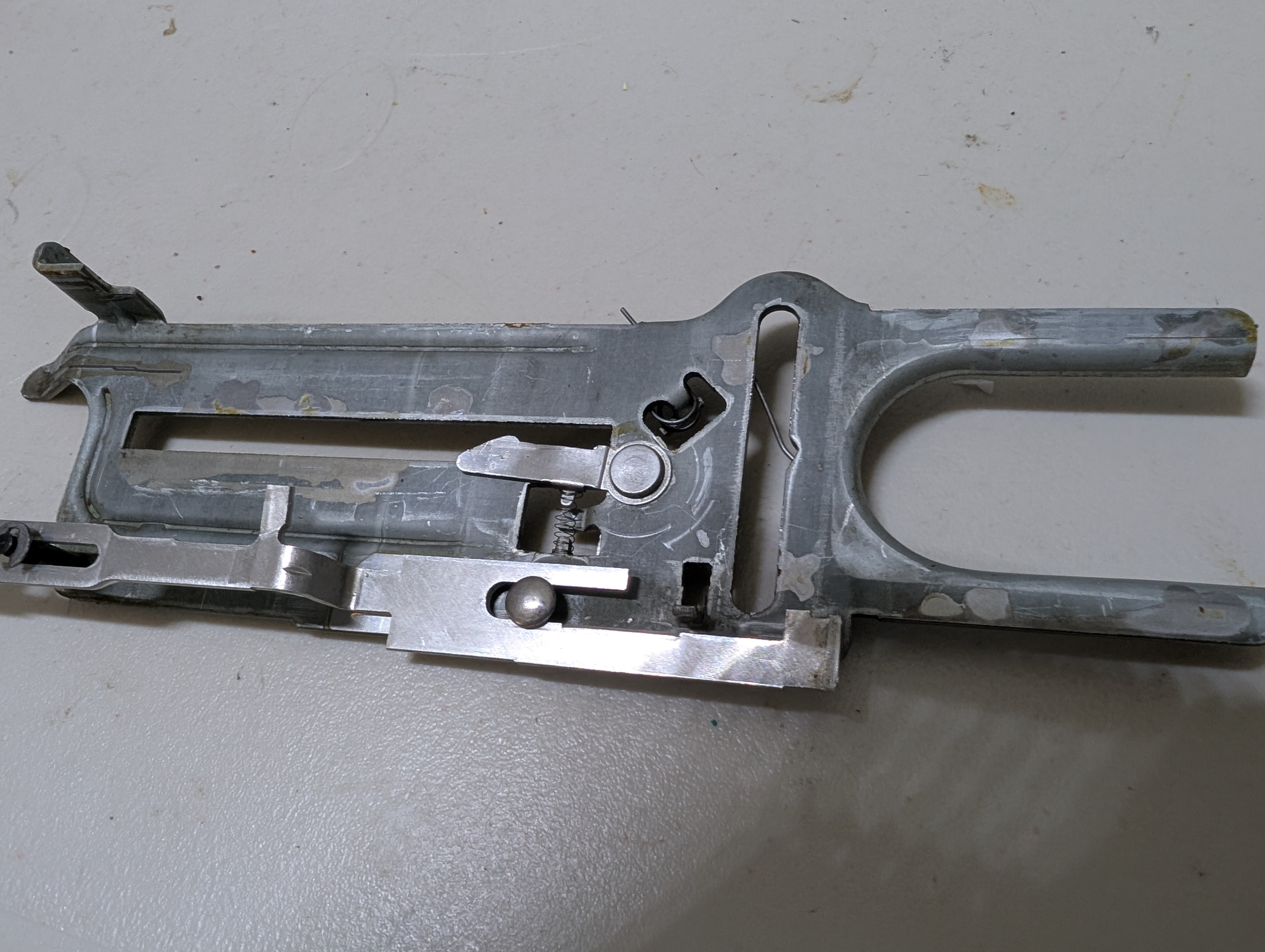

Re: Zenith X940 restoration project, Microtouch end-of-play mistracking
FM stereo and amp still working, after many hours of play!

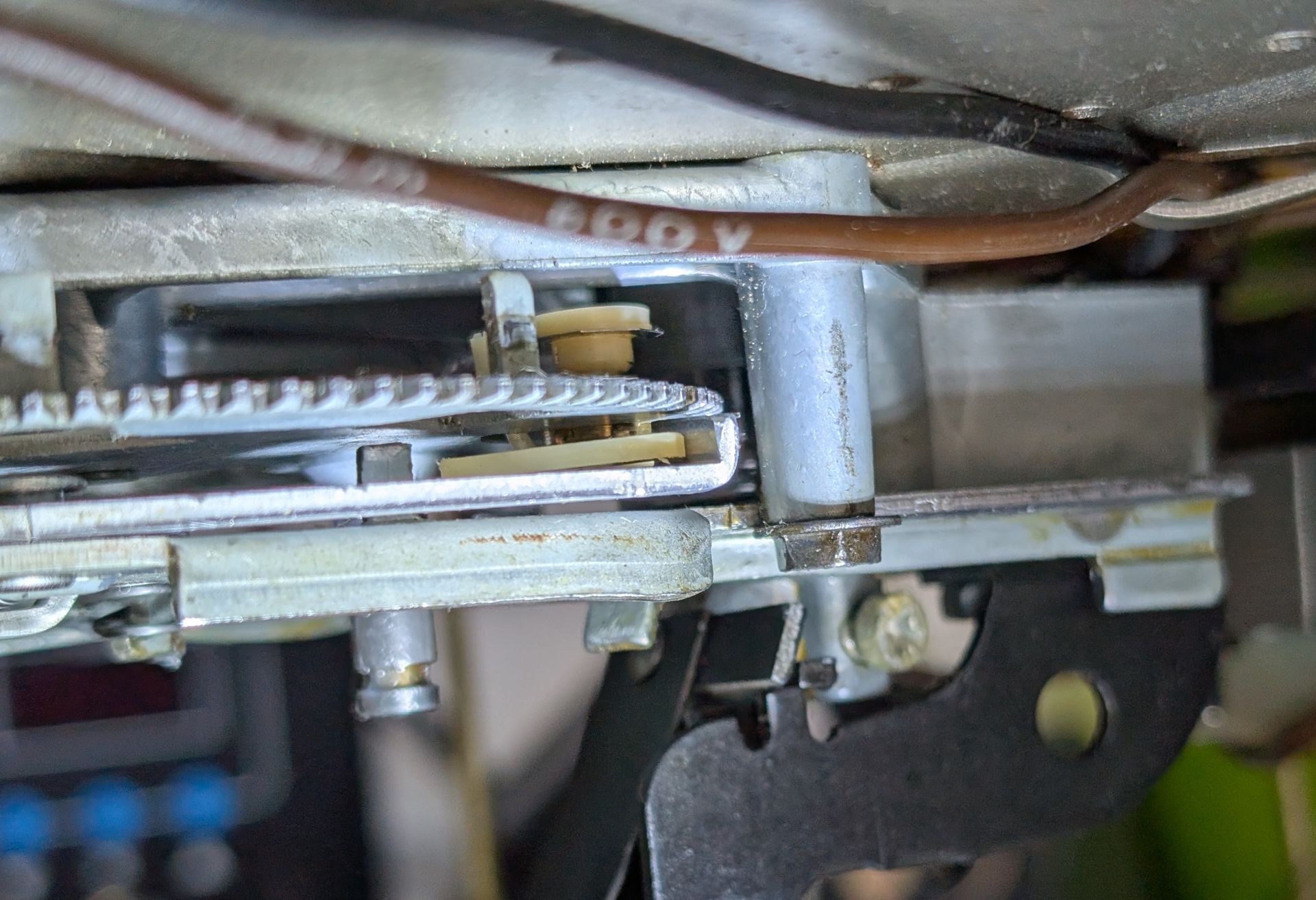

New stylus and idler arrived yesterday, got those installed, and everything sounds great! But the changer has an end-of-play issue, stylus jumps a groove near the end of the record, like the trip link is binding, even at 3.8 grams tracking. So I took everything apart again to see if I had missed something. Cleaned the trip lever on the main gear, again, but all appeared well, reassembled and had the same issue.
So I started watching the trip link in action, and noticed that the upper surface of the tab on its end, where it pushes on the trip lever, appeared to be rubbing on the surface of the main gear. That was apparently creating enough additional friction to impede the tone arm. I managed to slightly bend the trip link to bring that end down a little, and that corrected the problem. I had made sure the trip link was straight while cleaning the first time, but it turns out that it is critical that its shape is just right to prevent this issue. The half of the trip link that moves along the surface of the slide assembly needs to be exactly parallel to that surface. Here's what it looks like if it's not parallel, while record is playing: I'm posting this because this issue is not mentioned in any of the troubleshooting information I have for the VM 1200 series, perhaps it will be helpful to someone along the way!
Now it will track and trip at 2.4 grams, but the Stereo Review test record revealed bad low frequency mistracking, so I bumped it up to about 3.2 grams to correct that. This is the original cartridge, so I guess that's pretty good for an almost 60-year-old ceramic!

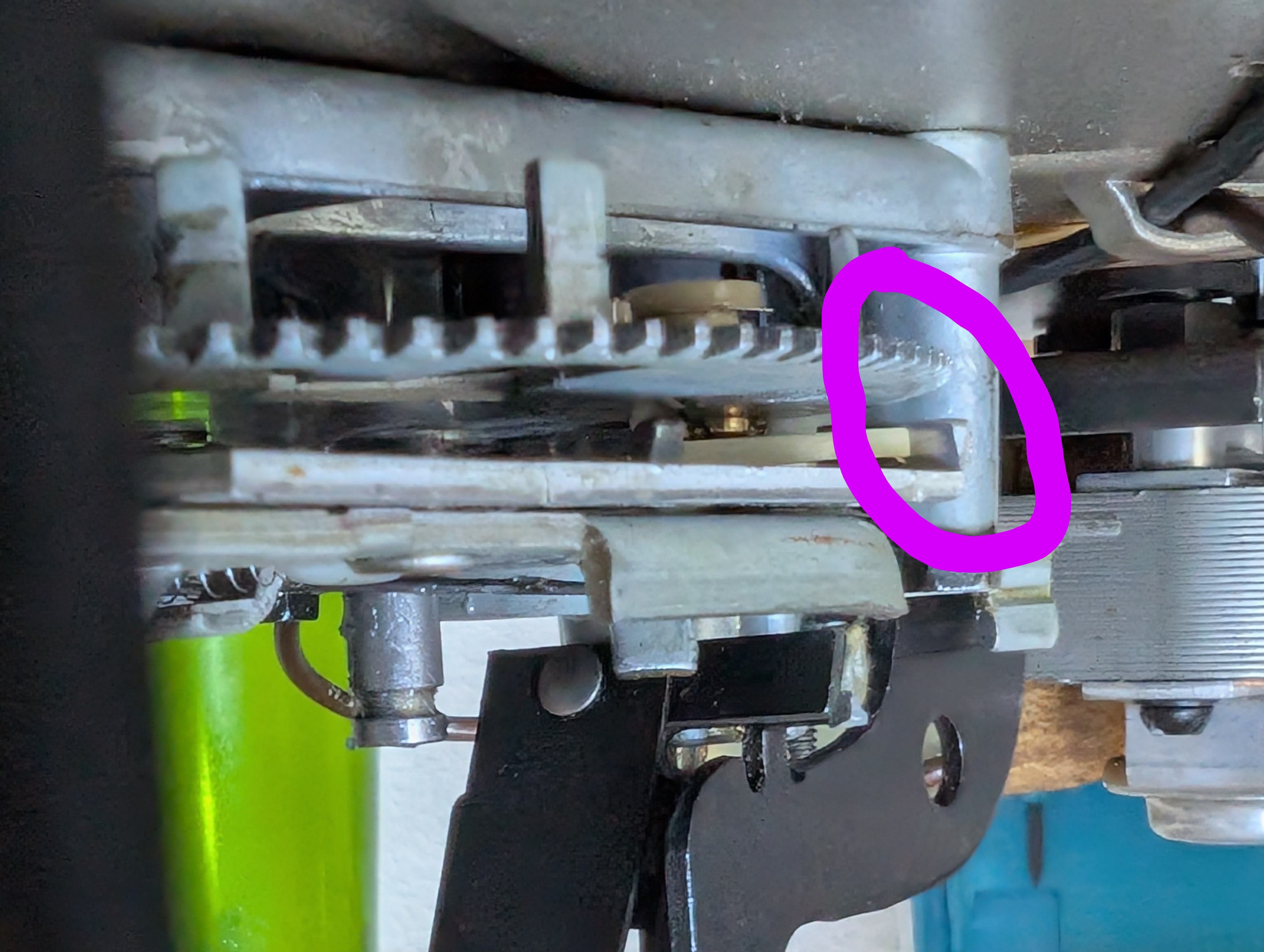

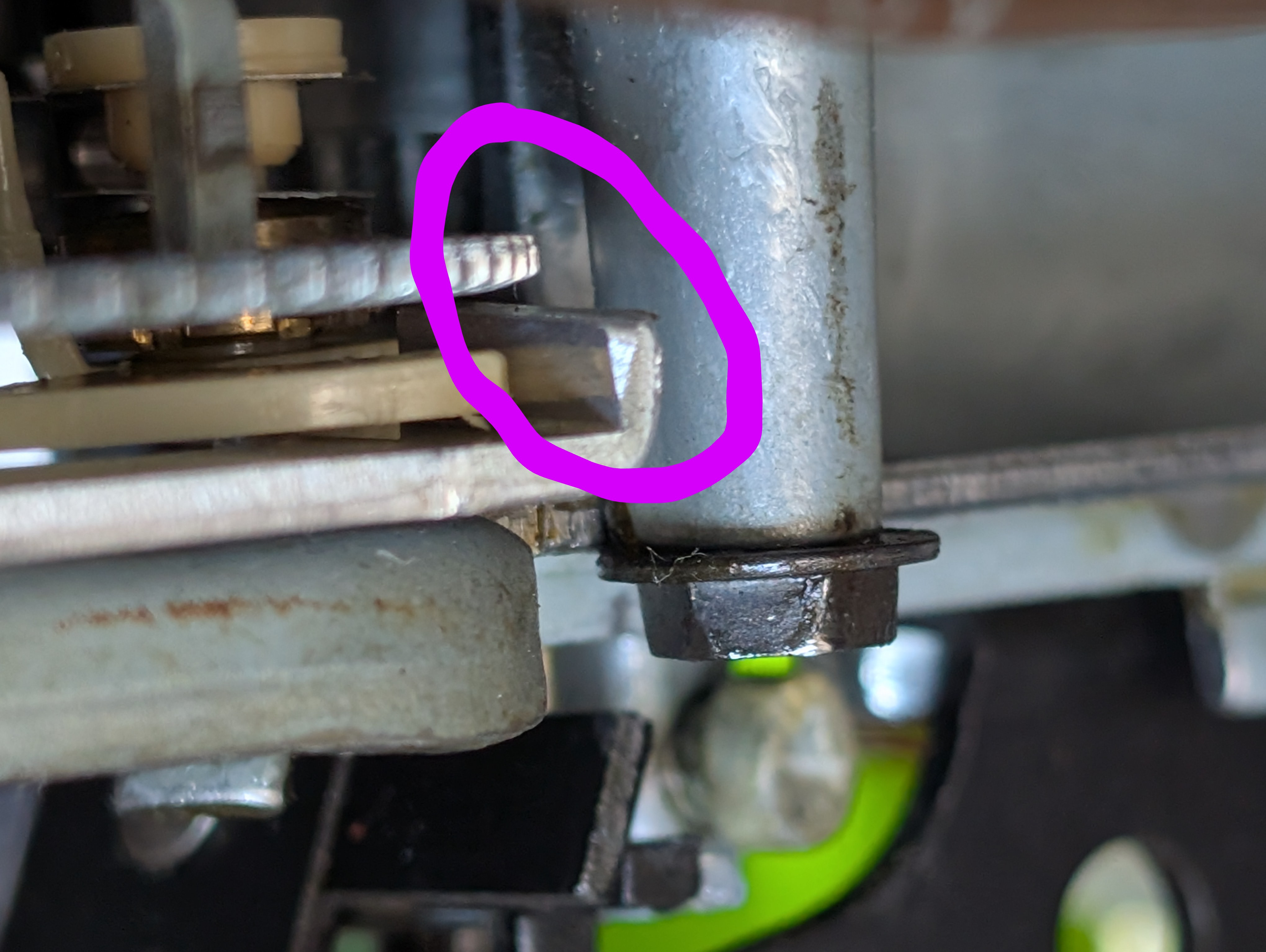

Re: Zenith X940 restoration project, no full shutoff after last record

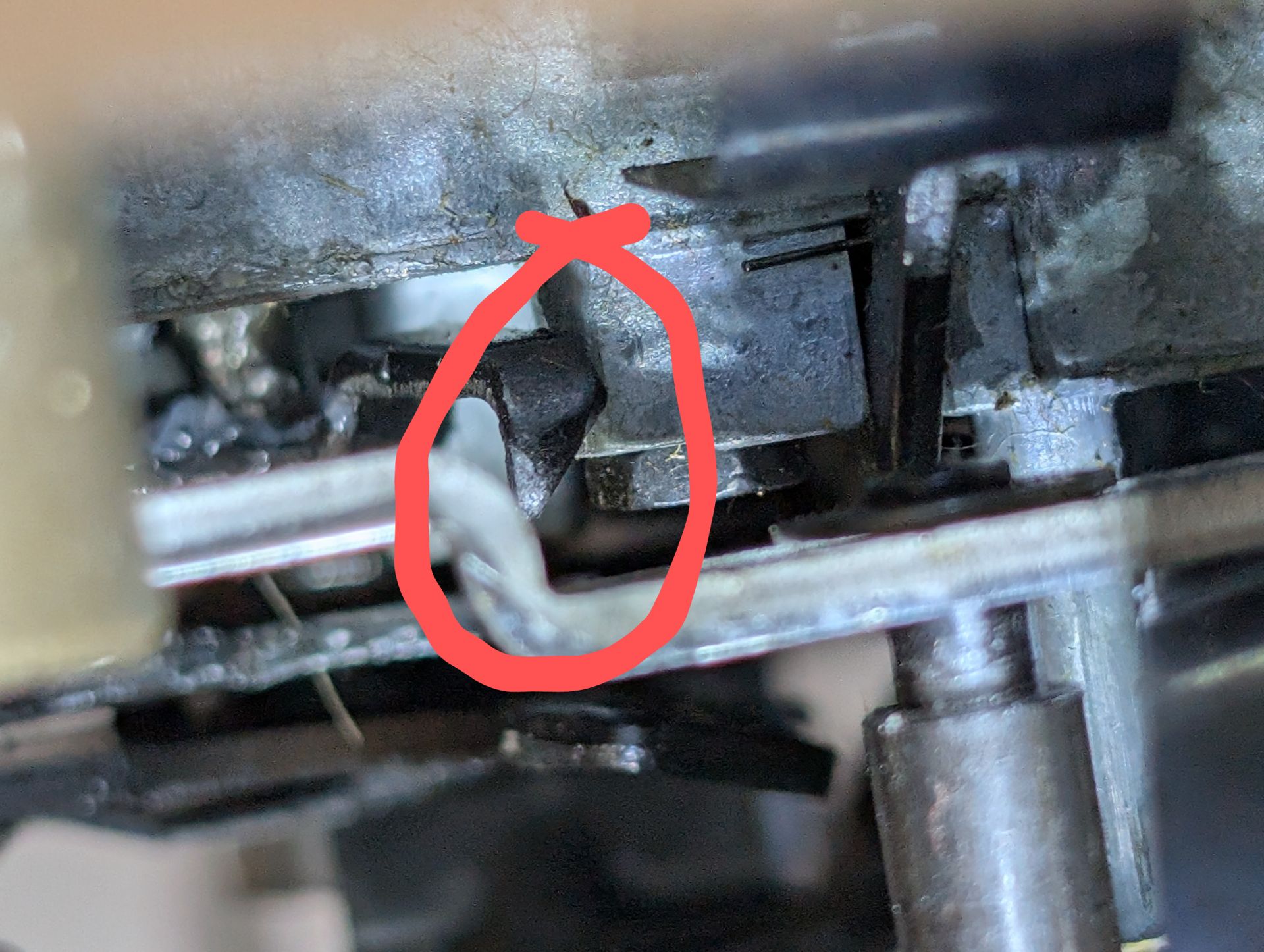

Well, plays records great, but I realized it was not shutting off after the last record , it "almost" would, the tonearm would return and set down, the control knob would only partially turn, but would not completely turn off. After observing things in action, manually running through the cycle, I was still stumped. And, it would actually completely turn off when I had it sitting on its side, but not when level! So Google to the rescue, one link to this ARF thread https://antiqueradios.com/forums/viewtopic.php?t=279935
pointed me in the right direction. I think when I adjusted the trip link to fix the above problem, I created this one. The opposite end of the trip link that I was concerned about above is the area causing this. Very hard to see, with the naked eye, but the pointed black part is one end of the "control lever" which is attached to the on-off-reject control knob via the "reject rod". So it turns out that that small 90° turn in the trip link is very critical: that is where the end of the control lever is pushed to turn off the power switch and rotate the control knob to the off position.
In my case, the end of the control lever was pushed only slightly before it rode up on top of the trip link, never fully engaged, so it did not turn off completely. I fixed this by slightly bending the end of the trip link upward, and slightly bending the end of the control lever downward. Everything works now, hopefully! Achilles heel indeed!

Re: Zenith X940 restoration project, the VM trip link
You are welcome, Bill.
I couldn't find either of the above specific solutions in the literature or my Google searches, so I thought it was important to document for posterity! This trip link is just a piece of aluminum, easy to bend, so it seems like you should be able to correct most deformity issues with it, if you had its exact dimensional specifications. Reading some of the old Phono threads in ARF, it appears that you used to be able to order a new one from Gary Stork, but they aren't currently listed on his website. I'm sure that this one is not to spec, but at least it works!

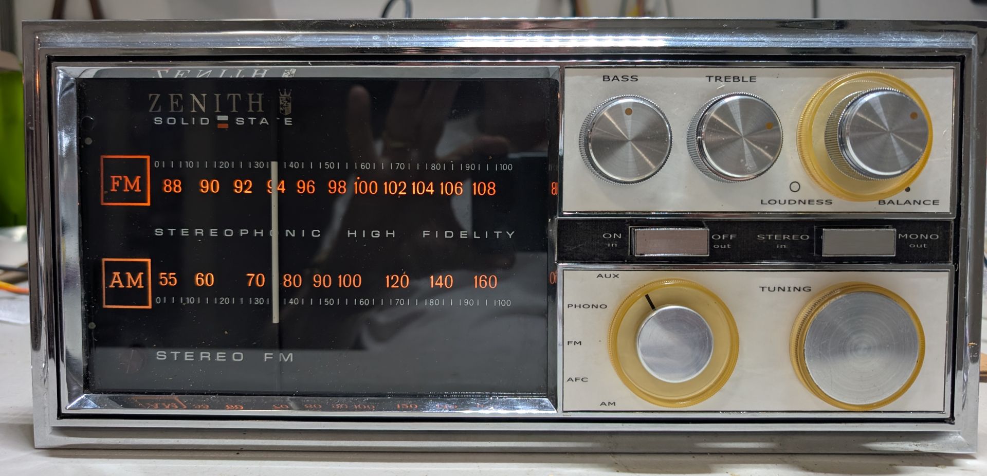

Re: Zenith X940 restoration project, front panel refurbished
Finally finished reworking the front panel. Check out how it looked when I got it in the photo a few posts above. The foil with cutout, back lit letters is completely missing from the topmost portion, damaged/missing on middle and lower portions. Here's what it's supposed to look like:
No way I could reasonably reproduce that foil/backlighting technique, so I went with opaque laser printing onto cardstock, and removed the pilot lamp behind that portion of the panel. I reproduced the text in Photoshop with a similar font. I experimented with white and cream, settled on a slightly yellowed white cardstock that I've had lying around for several decades.
I made the center portion black to match the radio dial background. I covered the printed cardstock with self adhesive laminating sheet to protect it. Final results:
- Posts: 5451
Wow, that is beautiful. I would not have the patience to do that, you are quite the craftsman.
- Posts: 3742
Looks like a restoration triumph to me! Maybe you should do a YouTube class on the printing program.
