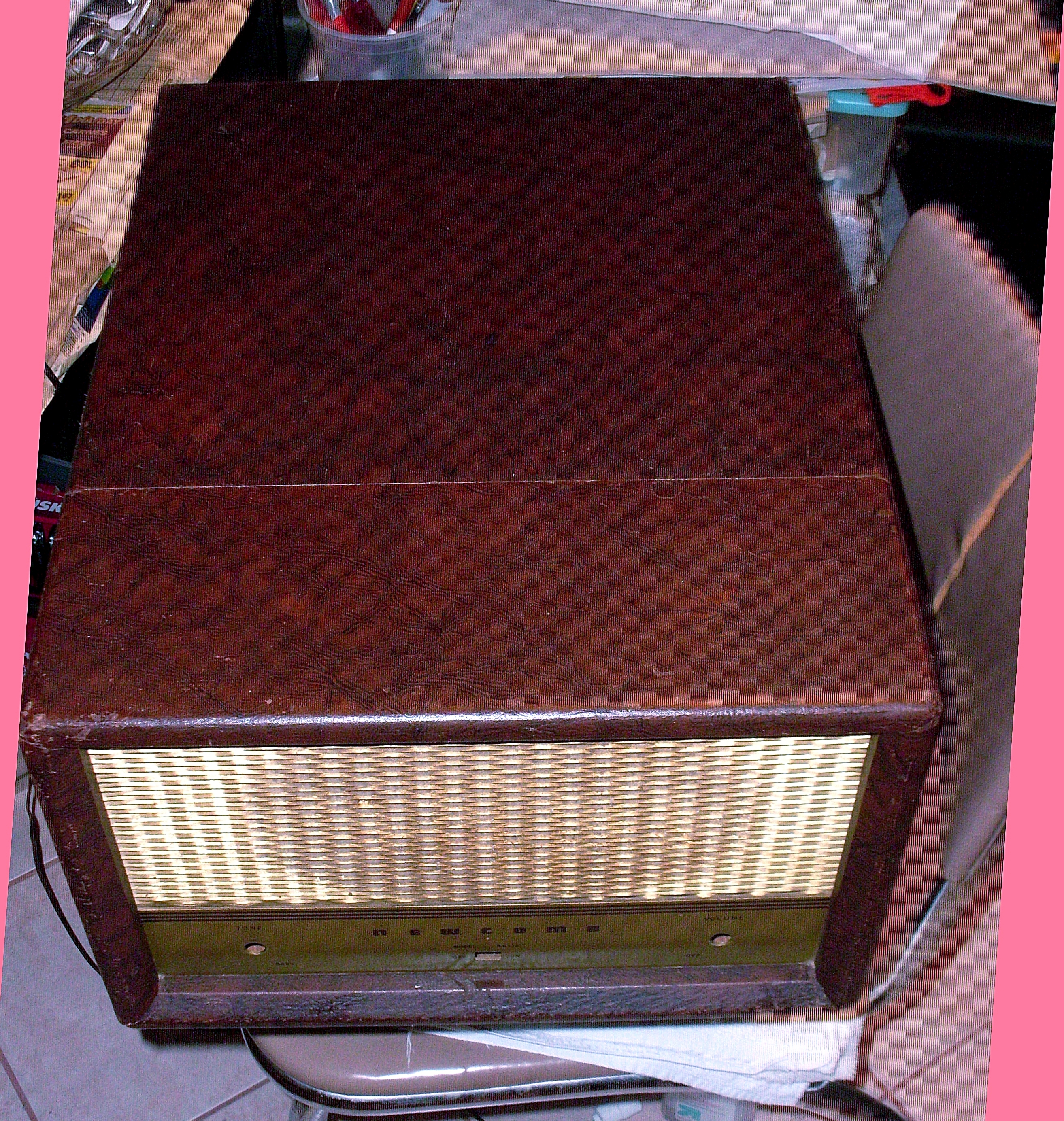

Another of the many Hi-Fi gals almost completed.
This is an uncommonly found 1952 Newcomb RC-12 with a
V-M 950 record changer.
Power transformer model using 6X4, 6V6, and 6SQ7 tubes.
The 6SQ7 triode is the only section of that tube used.
AC line fuse.
Speaker: 6 x 9 inches.
The cabinet covering needed gluing down in some
spots.
To treat the flea-bites, I tried a little Howards Restor-a-Finish
mahogany on the bottom to test the results.
It looked good after curing a few days outside, so I went
over the entire cabinet, and it is much better in appearance.

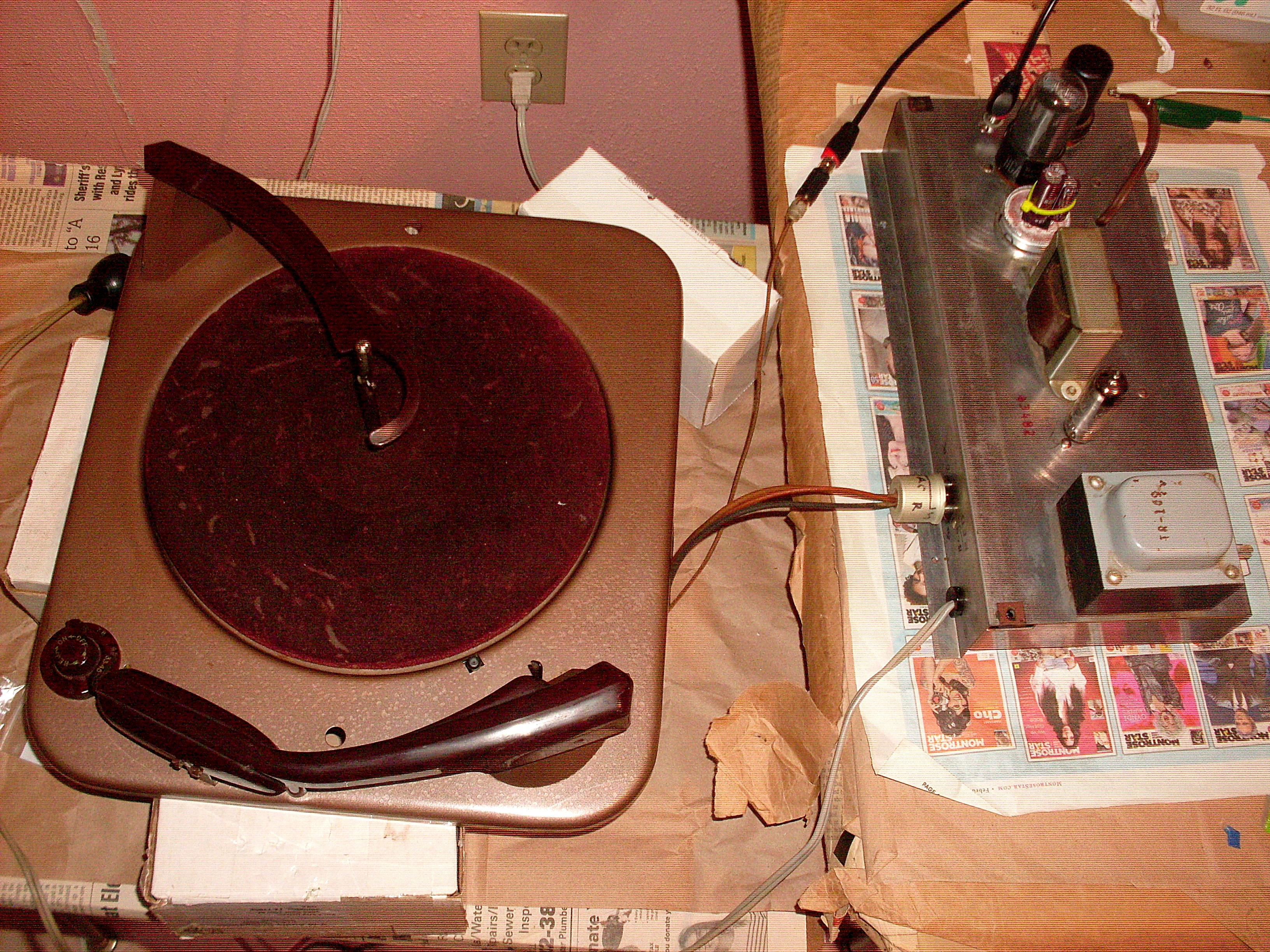

The V-M 950 changer dates from Sept 8, 1952.
Per Gary at V-M, it has the earlier RMA stamp code vs. the later
V-M factory code.
After cleaning/lubing the motor, I used a square O-ring replacing the
old rubber on the idler wheel.
For the 33.3 rpm speed turret, I used a cut-down rubber
grommet to replace the old rubber.

The 6SQ7 had a bad diode section, and I
thought it best to find a tube with all sections good.
Did an audio bench test today, and the amp is quiet,
and the changer is almost there.
I need to tweak the record support arm, as
it is not dropping easily, though its been
cleaned and lubed.
And the AC cord needs a new plug.

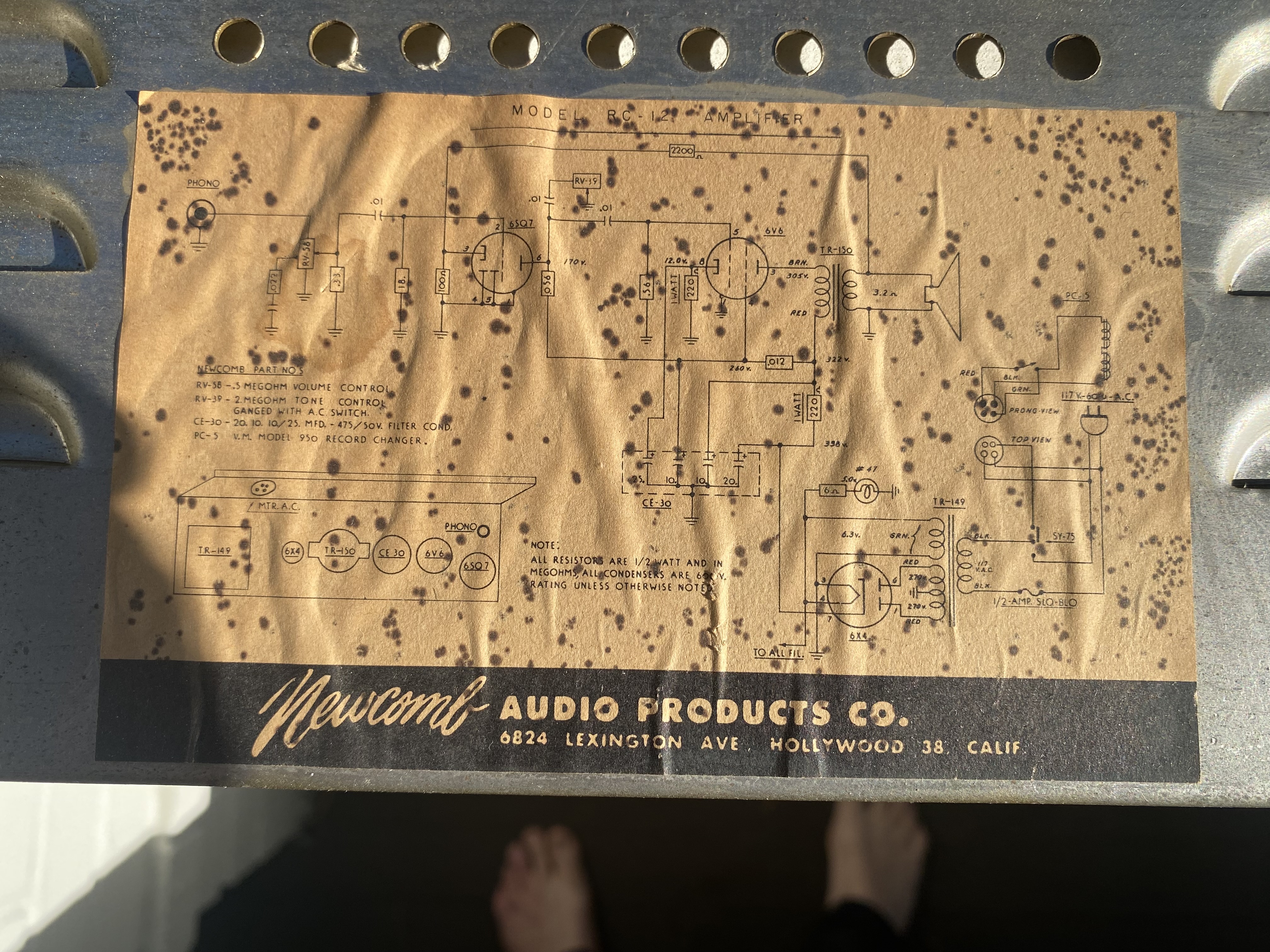

Nice job, Mr. Mogul, I really like the way Newcomb did their in cabinet schematic. Very easy to read and lots of information there. How does it sound?

1. Greg, the Newcomb speaker has no EIA markings
I can see.
2. I have found the 6X4 rectifier plate voltages to be high.
Schematic values in the photo I posted
are 270 VAC for Pins 1 and 6, and I read 328 VAC.

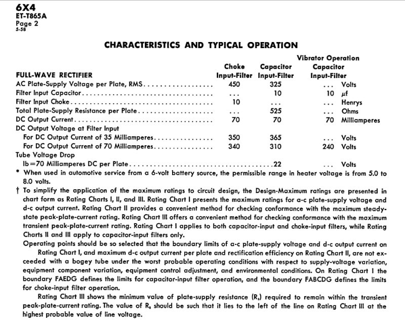

The 20% tolerance value Greg noted aligns with 6X4 tube data
sheets that indicate 325 VAC max application value on the plates.
The cathode voltage read off the 6X4 is 347 VDC; schematic value 338 VDC.
I took off the record support arm of the changer, and the small
amount of old grease/dirt I found had really kept the arm from
dropping easily down.
Now it's smooth as silk and working well.

That is, measured plate voltage today of 327VAC on the 6X4
is close to the 325 VAC of a "capacitor input filter" application
per the data sheet design limits.

Ms. Newcomb is back in her cabinet.
The 70+ year old speaker sounds fine.
There is not as much bass as I would enjoy,
but the Pfanstiehl P-228 stereo cart and this
amp are a good match.
I used a 22 mF cathode bypass cap for the
original 25 mF value, and that may/may not
have made some difference.
Though both R/L channels go into mono, I
can really hear them distinctly melded.
Gosh, she's heavy now all back togther !
