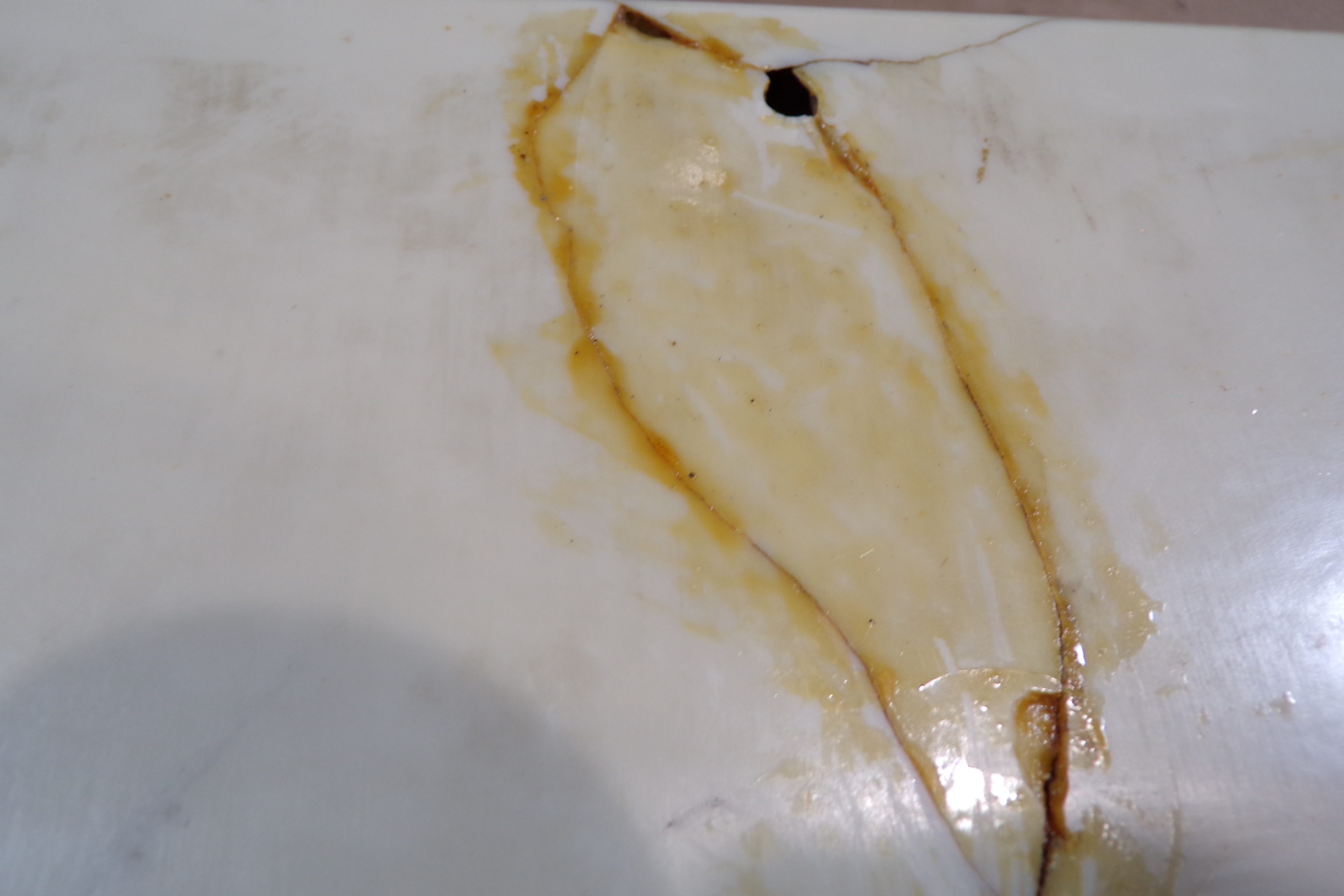

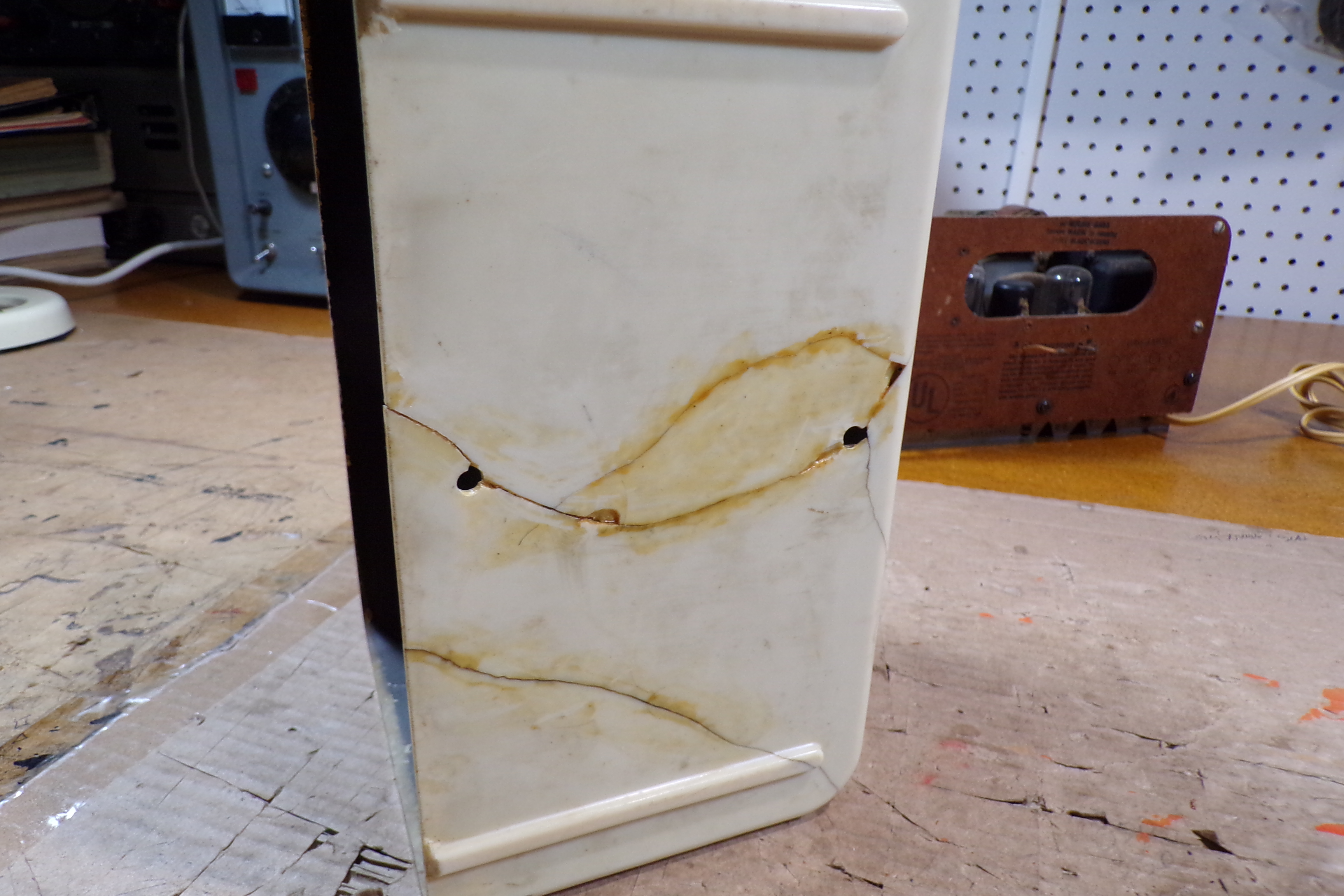

I have pictures, so please stand by for those. I have two of these small PB radios, one with a power transformer, one with series filaments. The model with the PT has a fairly heavy chassis, particularly on the end with the PT. The cabinet on the PT model was cracked. Just a simple crack, running from the screw that holds the chassis in to the front of the cabinet. No big deal, right? Well, not for me it wasn't. I glued the original crack, then reinforced it with epoxy on the inside. All was well until I used a furniture clamp to hold it together like I wanted. When I tightened the clamp, a huge chunk broke out of the middle and fell out. So, now, instead of having a cracked cabinet, I had a busted cabinet. This time, I glued and reinforced the second repair, then omitted the clamp. So far, so good. I need to use some body putty and glazing putty so my repairs won't show, then I'll repaint the entire cabinet. It is tan now, the wife likes a light green, so we'll shoot it with that. The cabinet with the series string chassis is really nice, dark brown bakelite. The chassis with the PT is a better performer than the other one. One of them has the wrong dial pointer, so I reckon I should see if I can find the correct pointer at some point.

I worked on this stupid cabinet all afternoon, but am not further along than when I started....
I have no idea what material the cabinet is made of, but Elmer's Construction glue won't stick to it. Nor will epoxy. I had the cabinet all fixed, looking pretty good. I started spreading Bondo on the cracks when the cabinet split in three pieces again. I can just peel the glue off in strips, the epoxy comes off in chunks prodded by a screwdriver bit. It must be some kind of plastic. It's not bakelite. It doesn't scratch easily. I plan to try model car cement to see what that does. Lacquer thinner doesn't hurt it, nor does acetone, nor does alcohol. I've never had this trouble before. Elmer's is what I have always used.

The main issue with using super-glue on a radio cabinet is that it expands in the joint, which makes the cabinet set up with large gaps that have to be worked out. It can make the parts set up crooked as the glue dries. I have some speaker repair glue I am going to try first. It smells just like model car glue, so maybe it will work. The chassis is such a tight fit in the cabinet with the PT that I need to keep filling to a minimum, and eliminate any humps or increase in height in the bottom of the cabinet. This should be a cute little radio if and when I get it done. Somebody had tried fixing it before I got it, I discovered today. I thought they just did a crappy job, but they may have run into the same problem I have. Me knocking that big chunk out of the bottom sure didn't help any.......

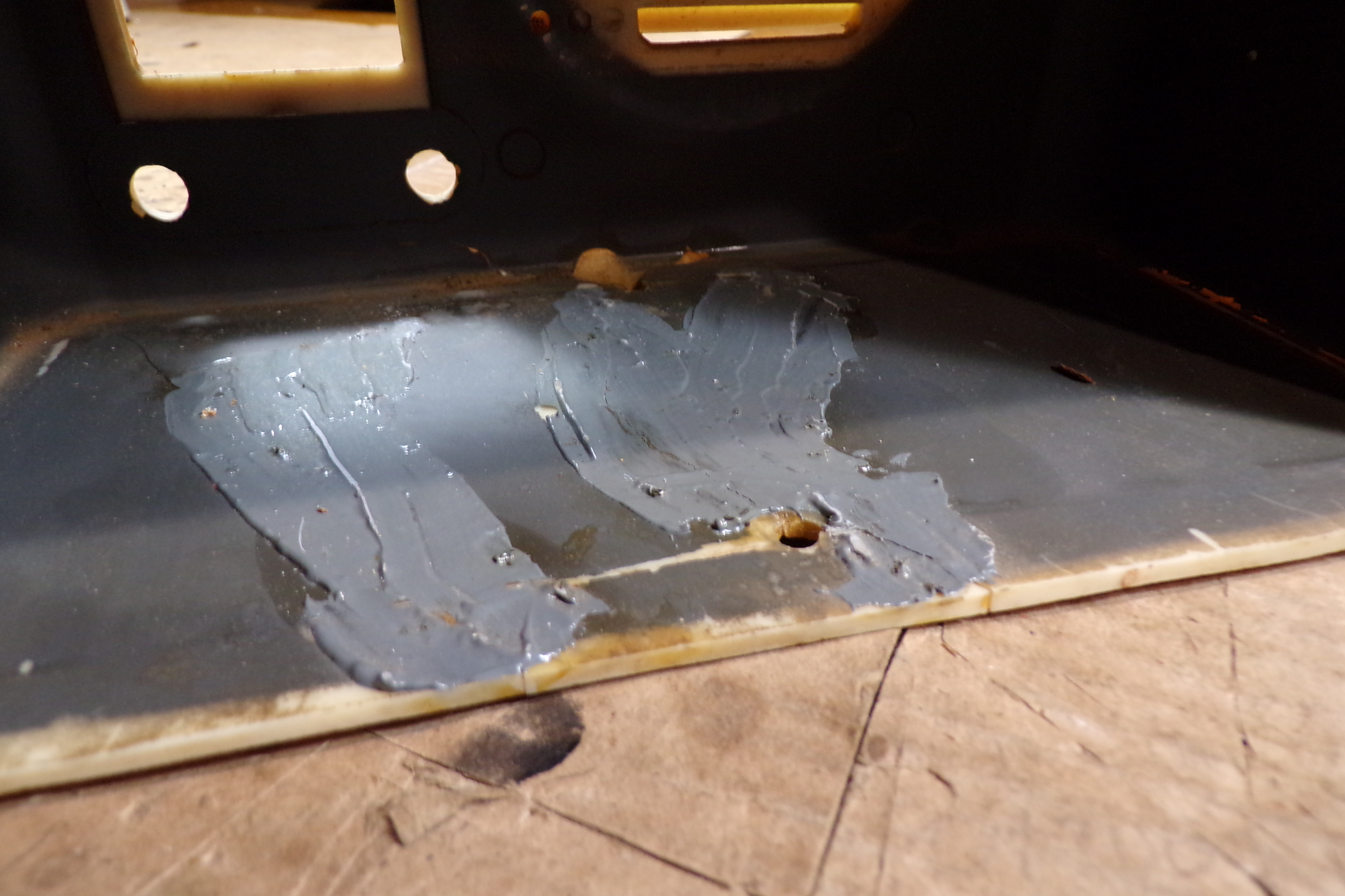

The cabinet has remained intact for the last couple of days. I used GC Service Cement to repair the cracks. I will try the Bondo procedure next, then figure out something to reinforce the bottom.

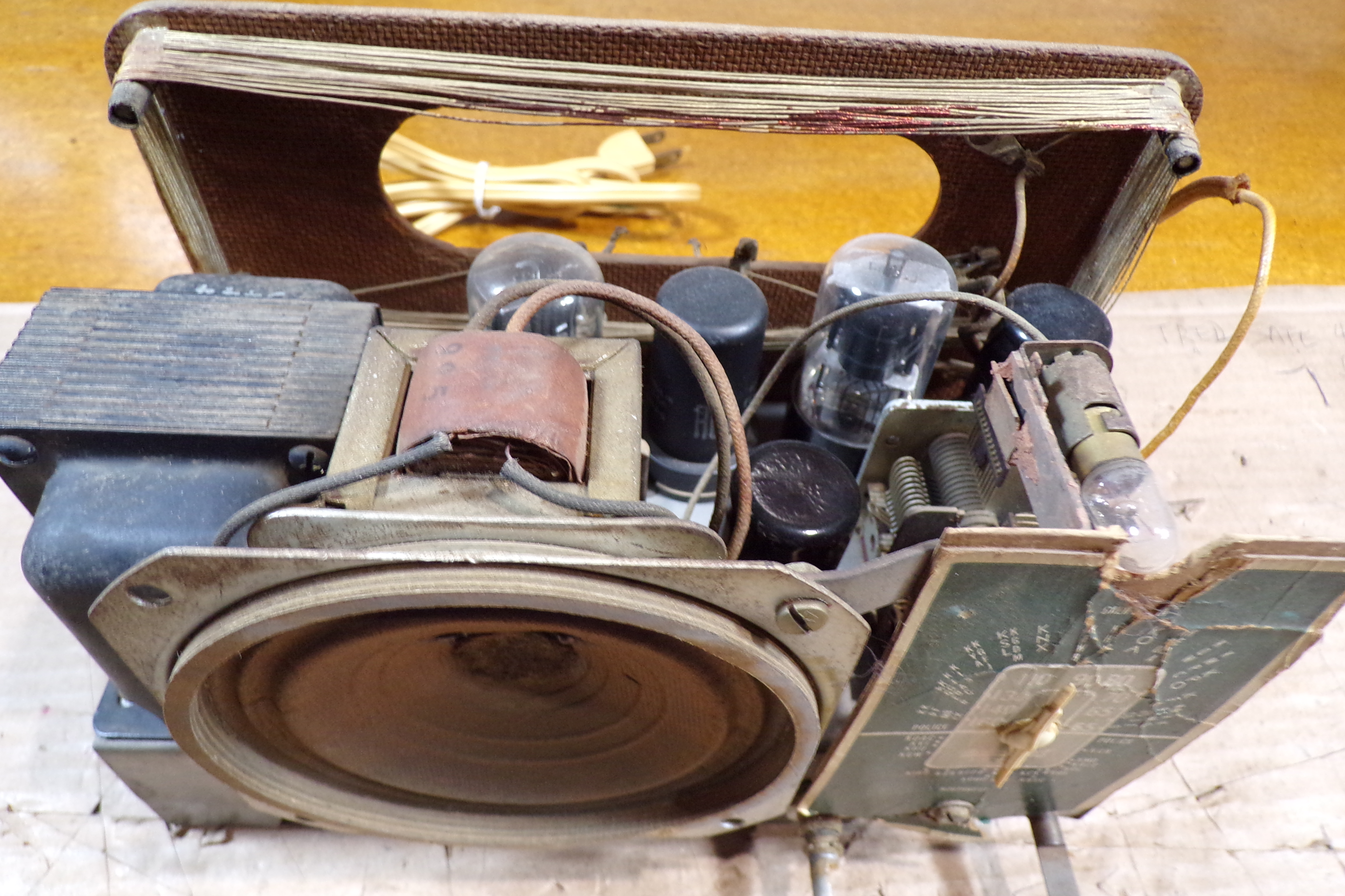

And for clarification, the tube complement is 6X5GT rectifier, 6SA7 converter, 6SK7 IF amp, 6SQ7 detector, first audio and 6V6GT audio output. Originally, a 6K6GT was specified, but this chassis had a 6V6 when I got it, so I just left it in there. Three tubes are RCA, one is Ken-Rad, one is Sylvania.

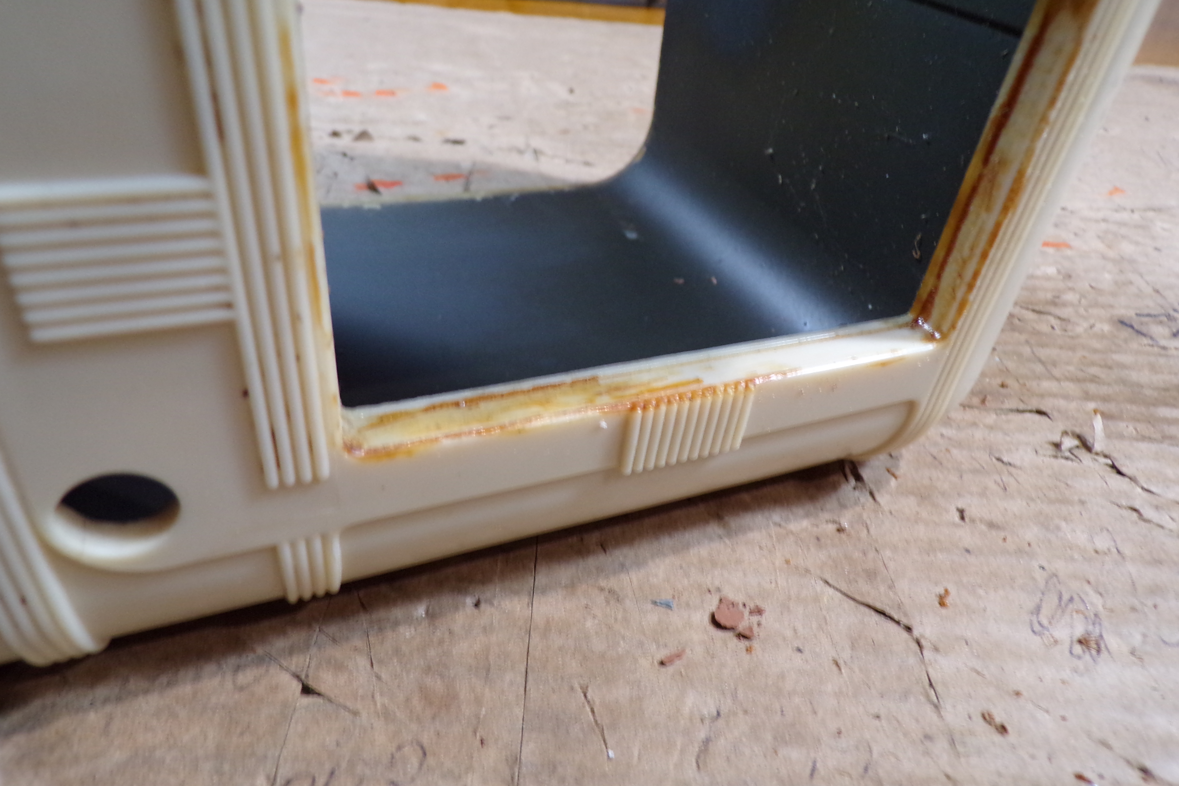

The last picture I posted shows the glue somebody liberally spread everywhere. I reckon it was to glue a kluged dial cover in place. There is no dial cover for this set. I'm going to try to make one, failing that, I'll have to see if Radio Daze has one and if I can get it in a reasonable amount of time. I scraped all the glue off with the edge of a single-edged razor blade.

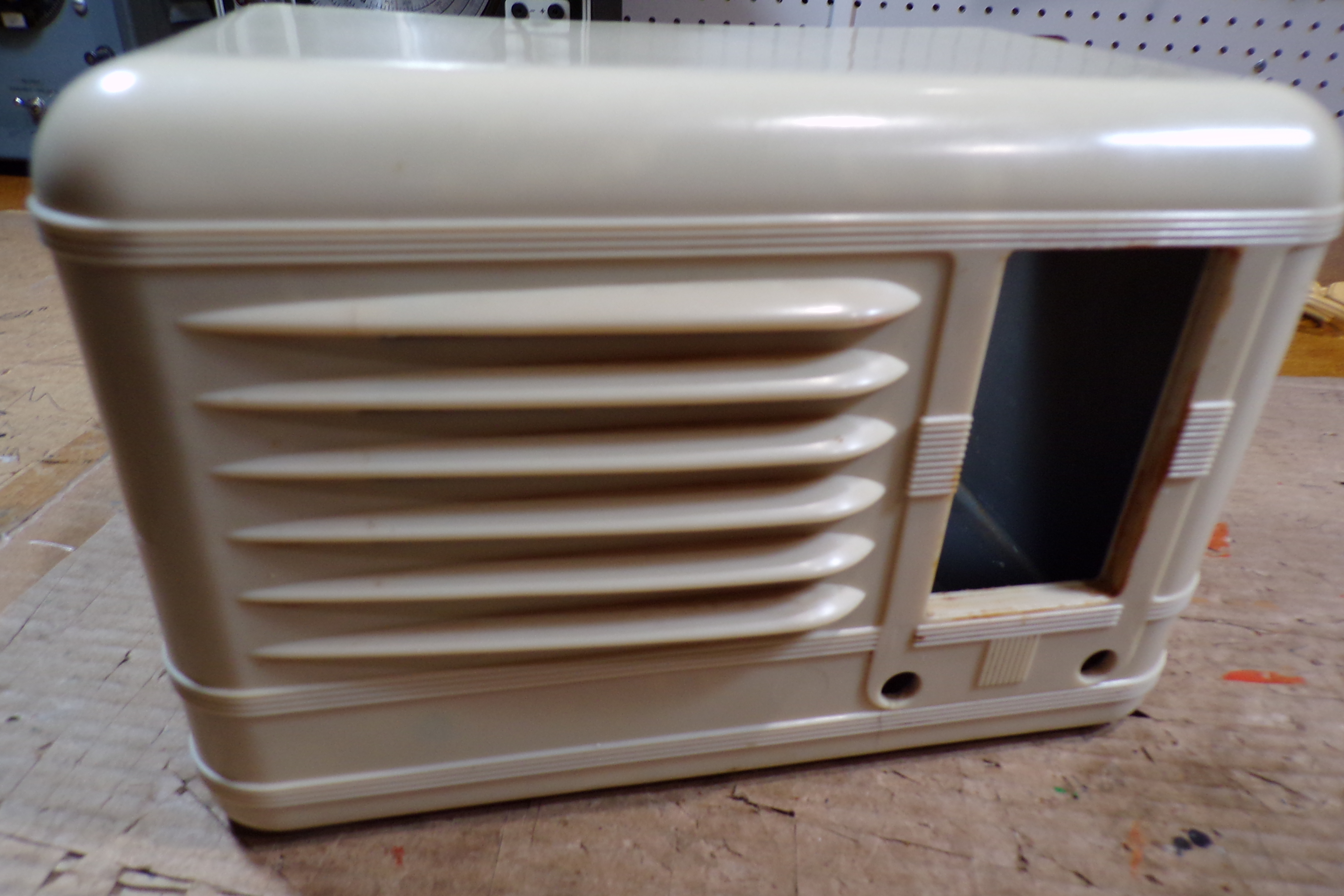

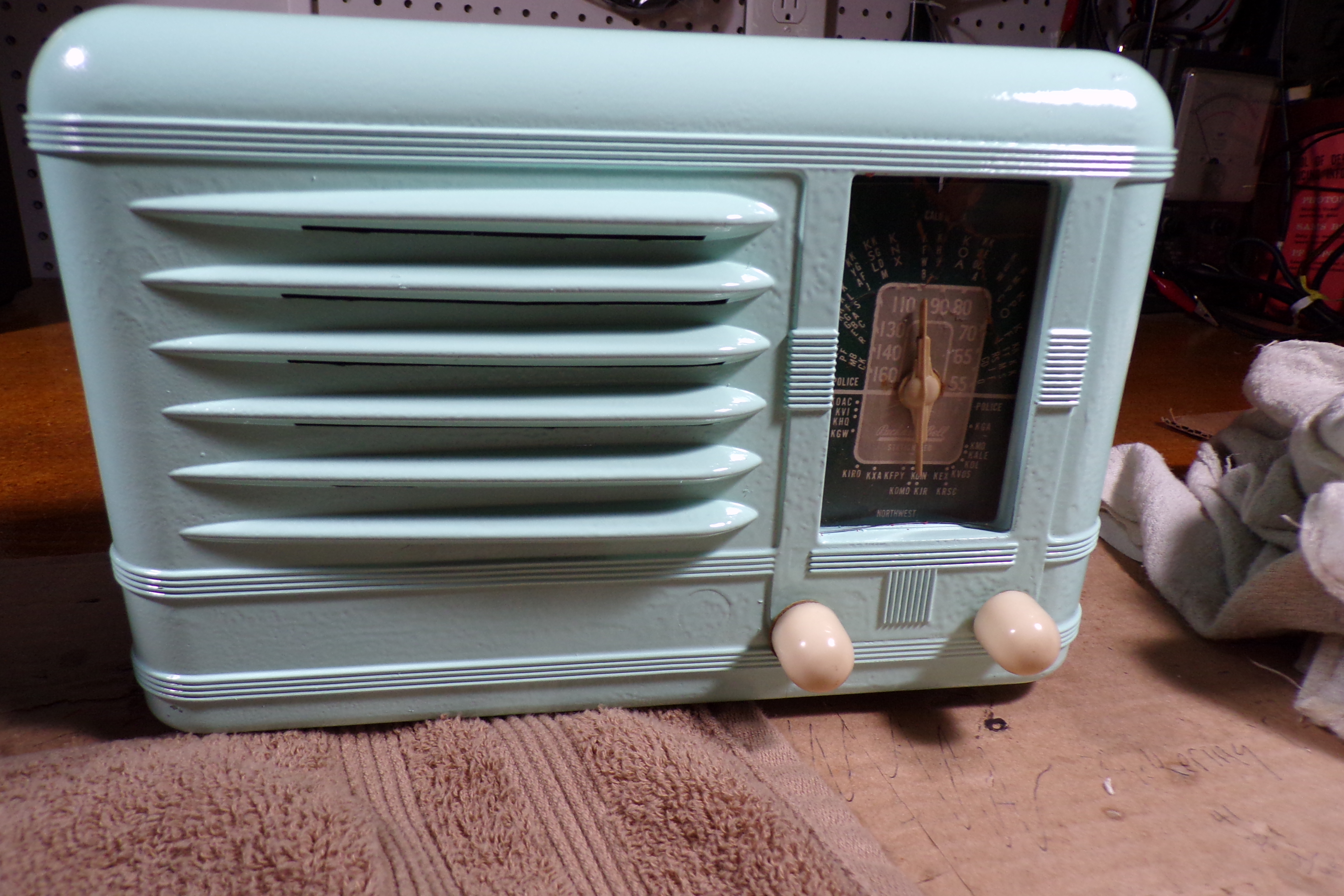

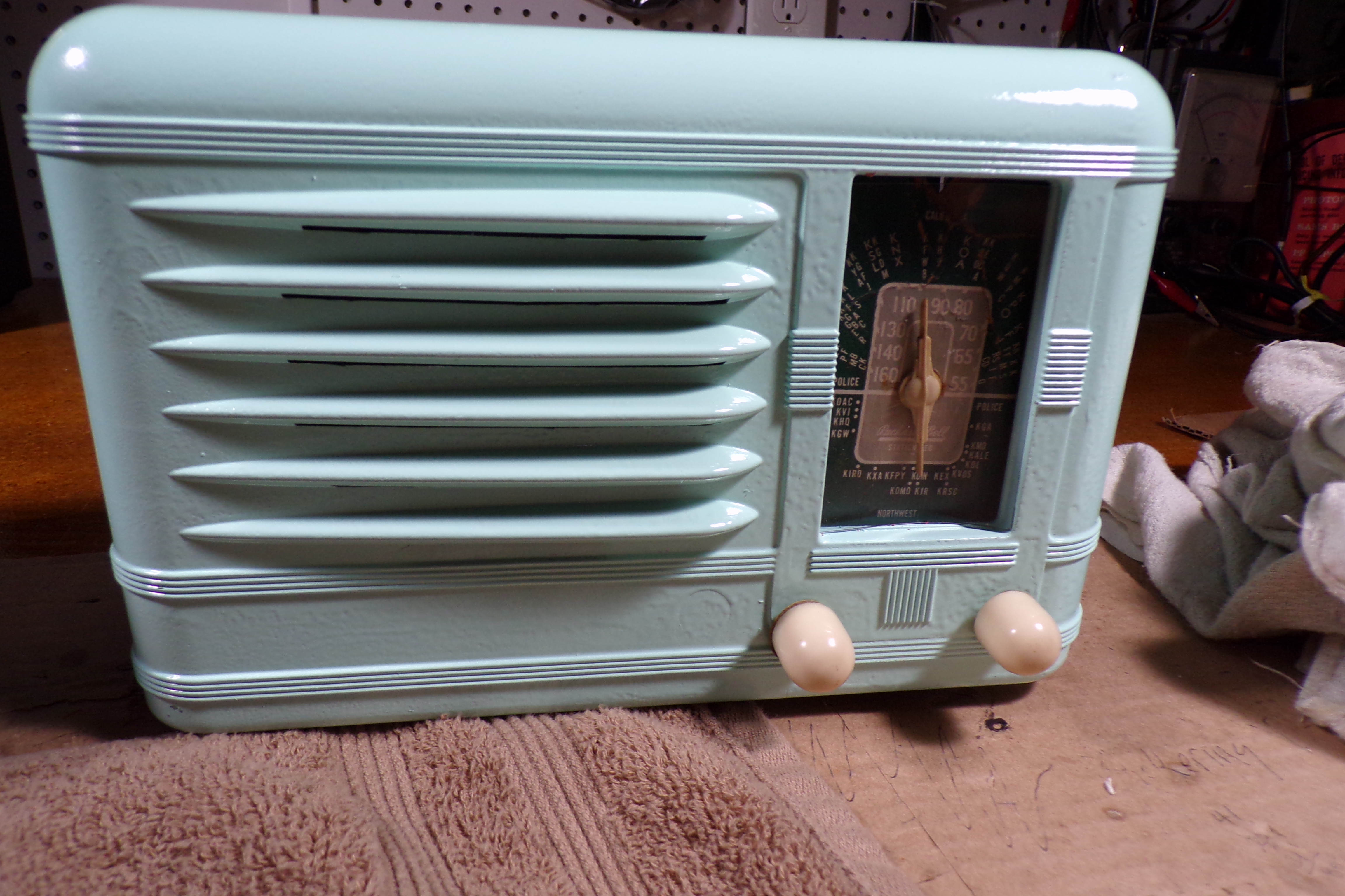

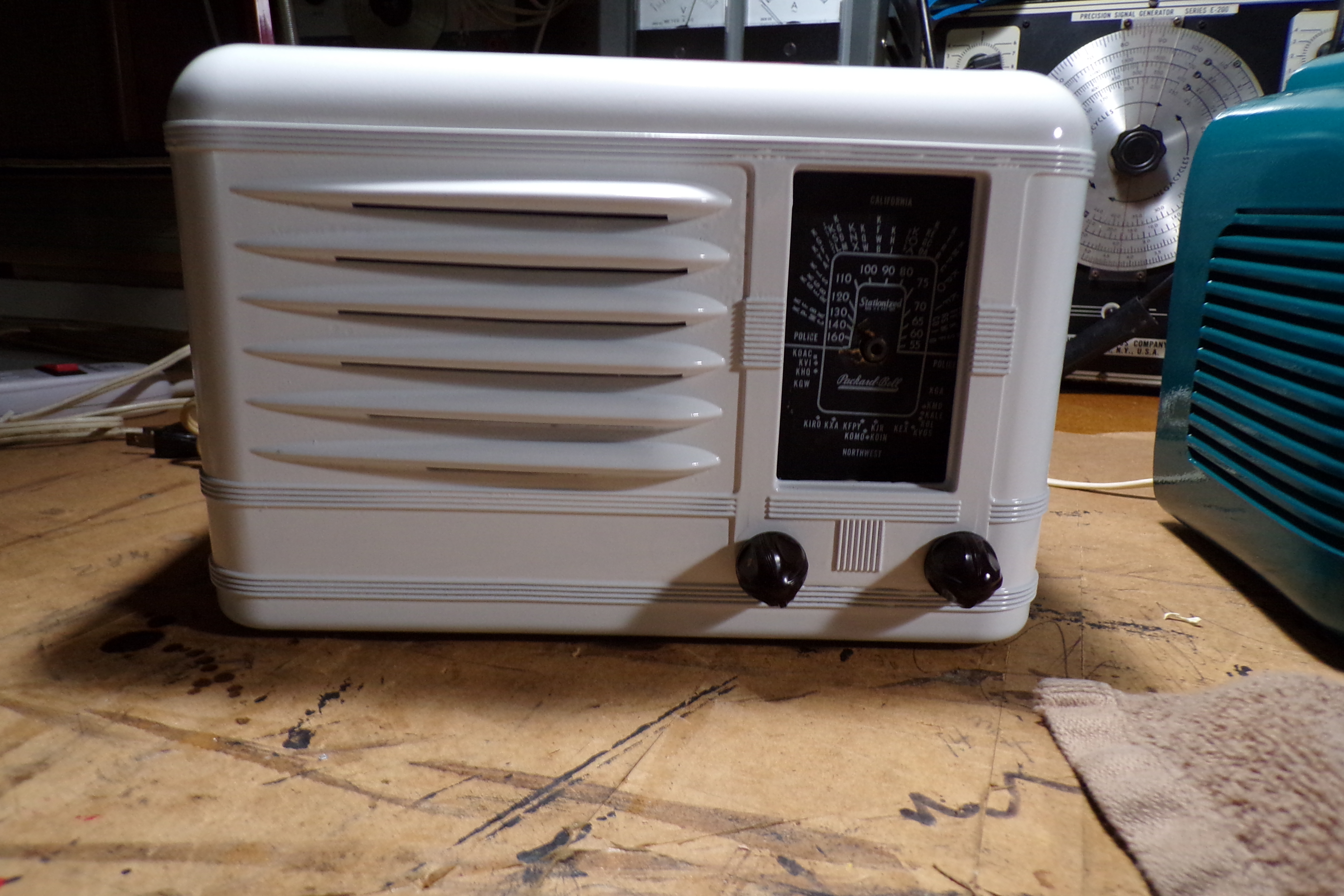

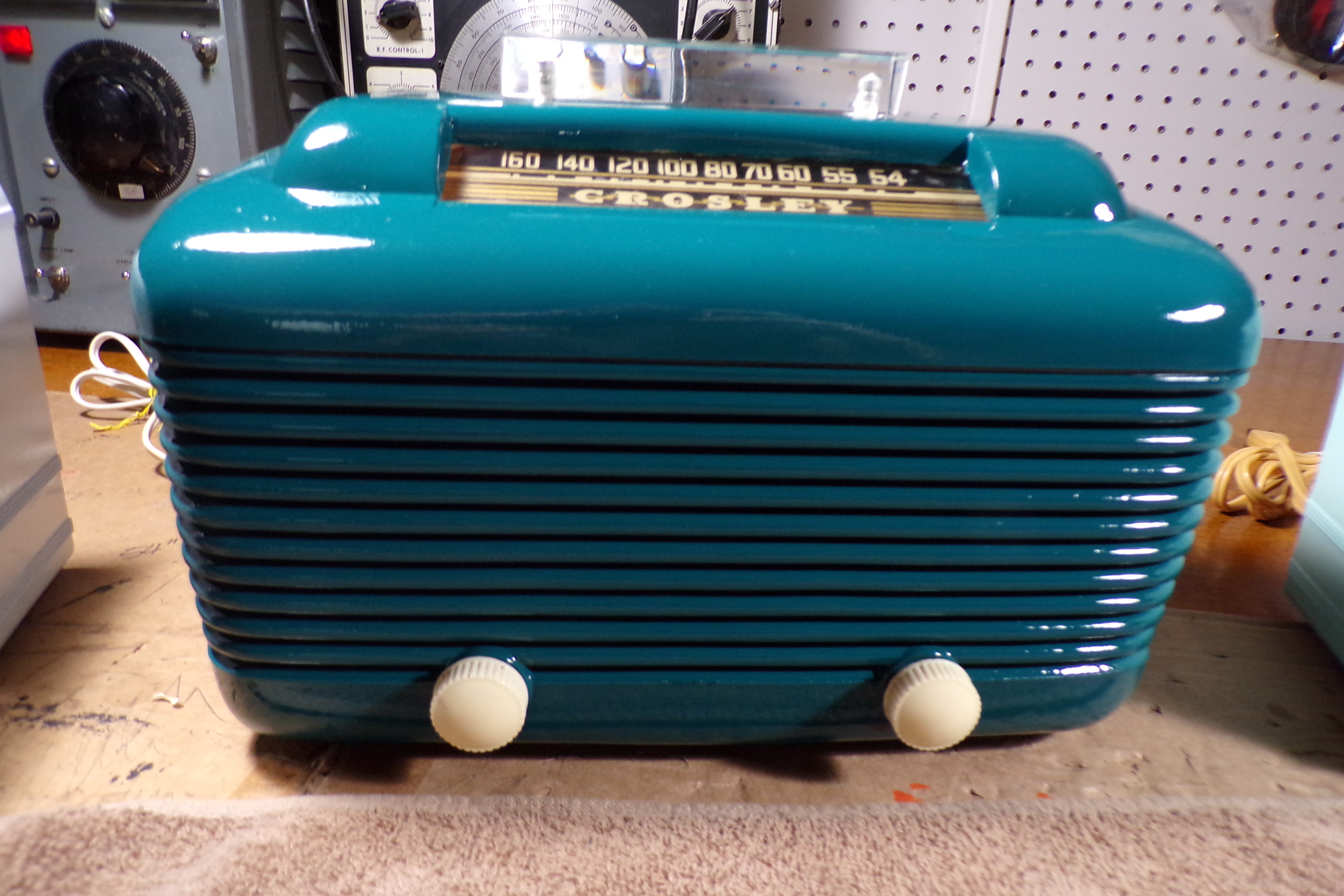

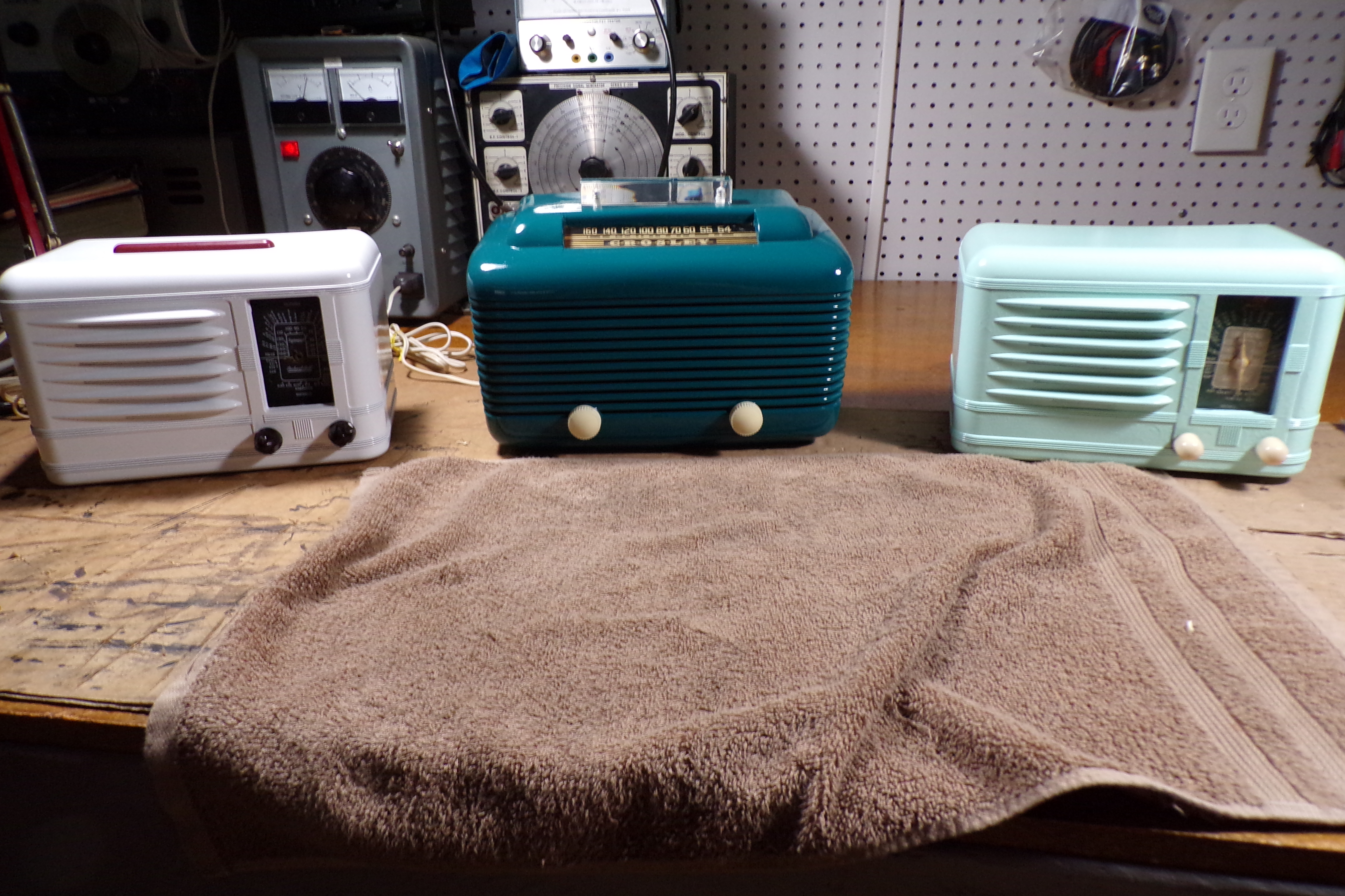

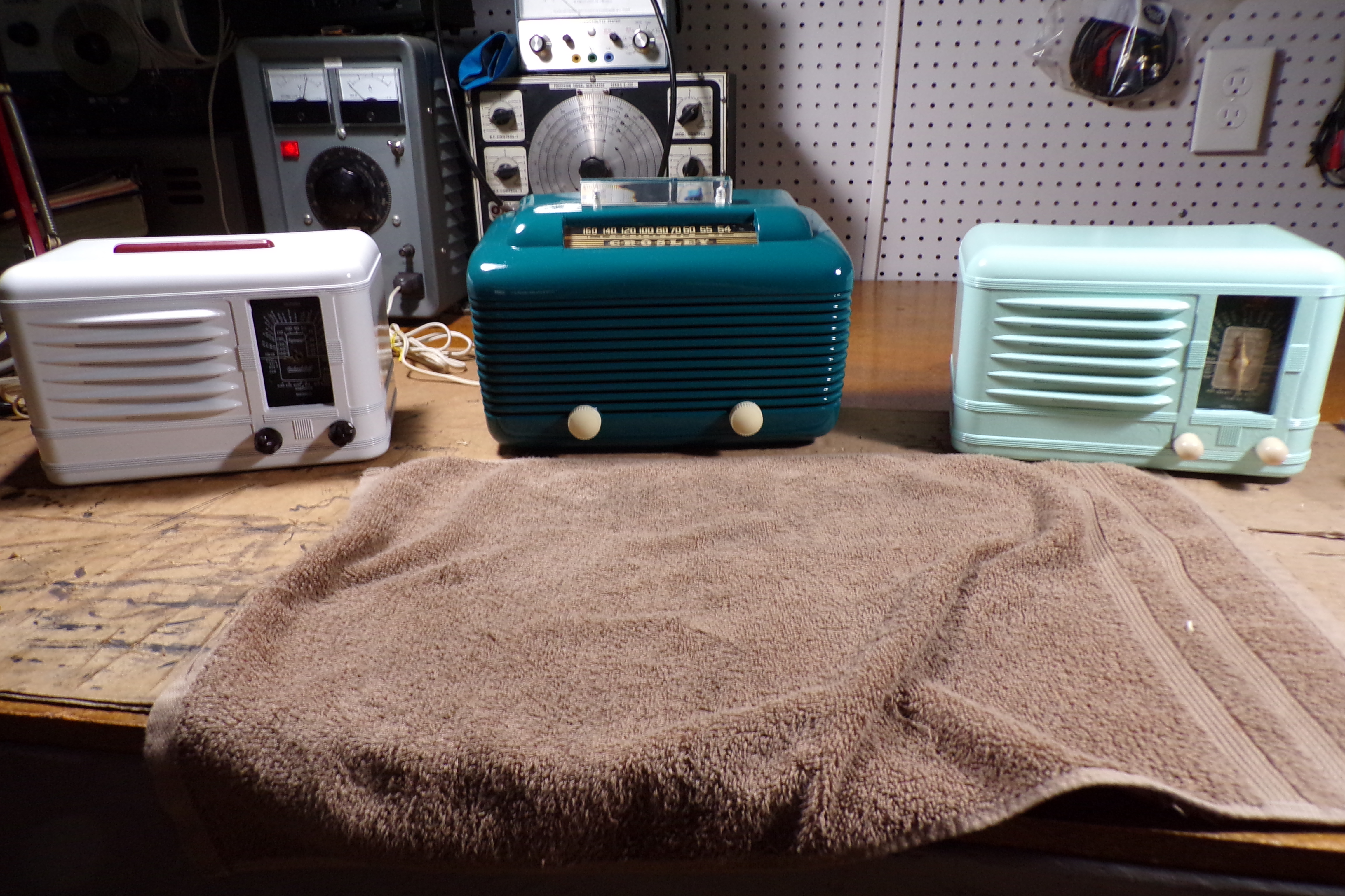

Pictures, finally.....
The white radio is a Packard Bell 5D. The light green radio is a Packard Bell 5F. The dark turquoise radio is a Crosley 56 THO. The Crosley's main claim to fame is that it is one of the few AA5 radios I have seen with a guillotine tuner. This style of tuner is fairly common with FM. The little Packard Bell radios look quite similar, but really are very different. The model 5D needs a dial pointer.

Do you mean permeability or variable inductance tuning? Zenith used it for FM, and as the young folks my not know, most car radios, at least in the 50s and 60s used it for AM. My guess was that it was less subject to shock & vibration than varable caps.

Re: Packard Bell model 5F busted radio cabinet....
Nice job, Greg, you should be proud, and you saved three radios from the landfill.
