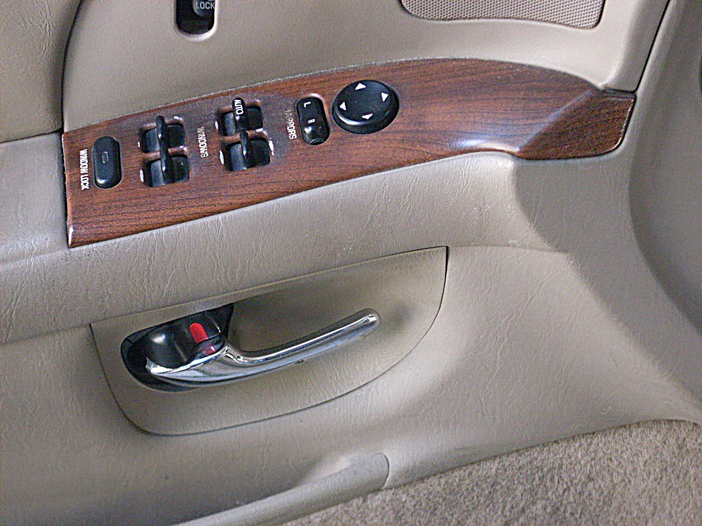

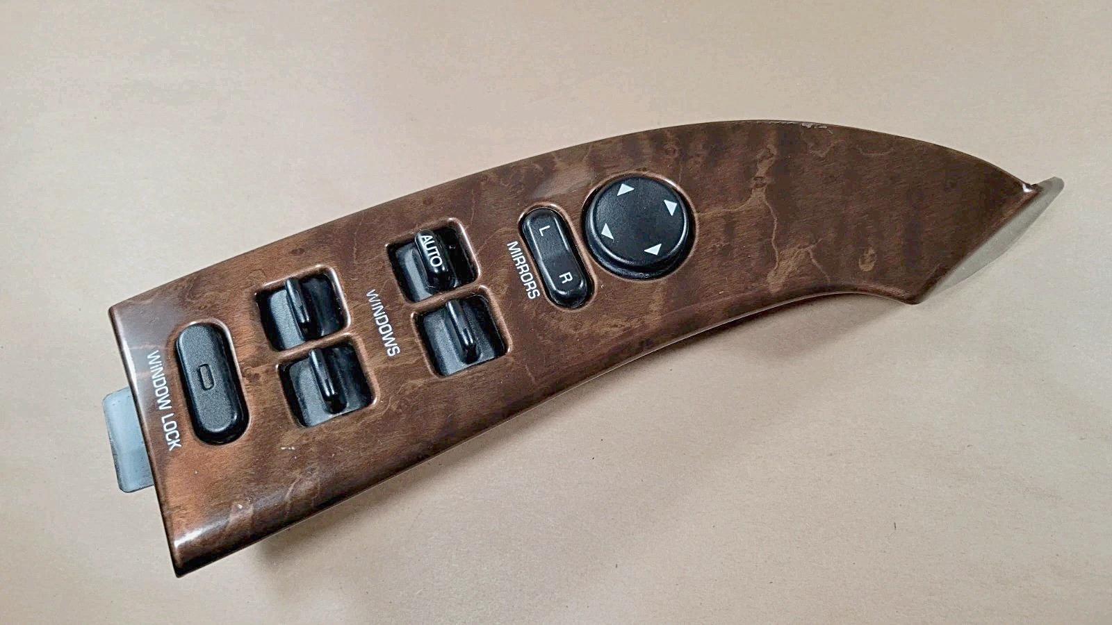

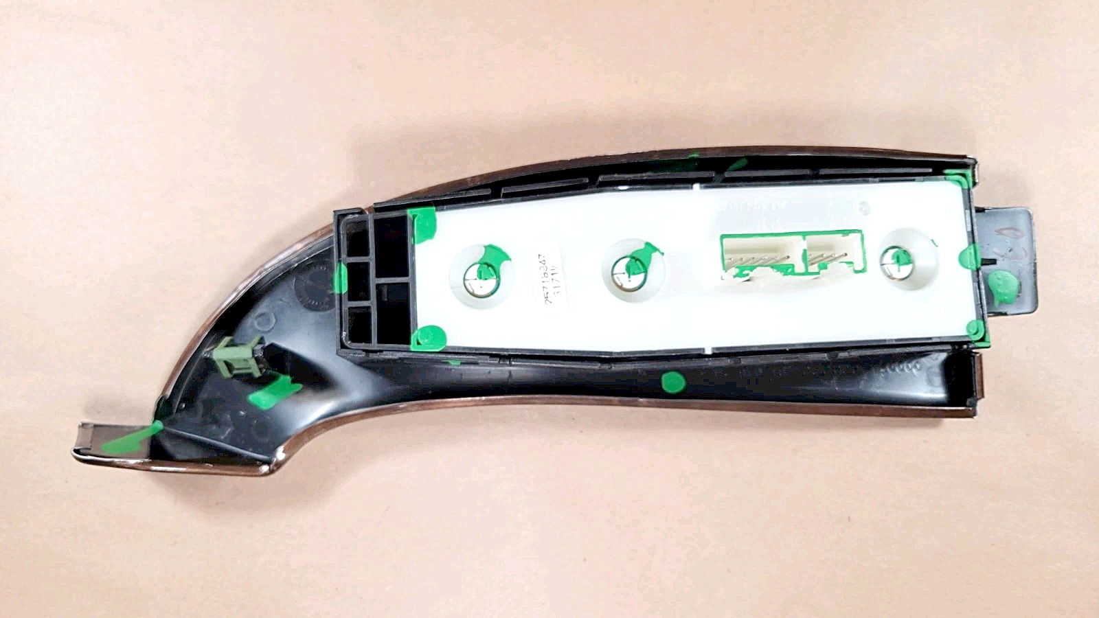

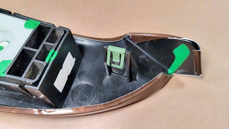

Re: 2001 Buick Power Windows Fail
Here is what I have.
I found photos of a used driver door switch assembly which are helpful.
QUESTION : Where will be the safest area to pry this module out ?
It has that angled front on it that has a clip (photo).
The rear tab precludes prying from the back.
