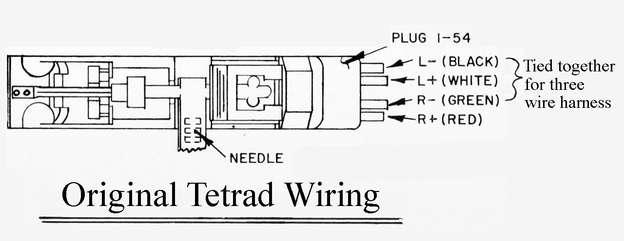

I picked up the VM 1296 mentioned on a earlier post... the cartridge was broken so working with Gary Stork , he supplied the correct replacement... also one wire was off the cart plug , so when I went to re-solder it on, I noticed the grounds were out of phase on the plug. one ground on the lower pin and one on the upper ... I asked Gary because it sure looked factory to me ... and to my surprise he claims that is the way tetrad carts are suppose to be to due internal configuration... I never knew that before... a few months ago I got one of Gary's tetrad replacement kits for my Magnavox along with the wiring and plug ... it was not wired like that, it was wired normally... so is my new cart on the magnavox 180 out of phase?... waiting on a response from Gary on that ....Gary sent me a diagram as it is suppose to be...

I found out that same thing recently on a low-end Philco I sold, Tetrad is the only cart small enough to fit the tonearm on this particular VM-made player. I used my test record to confirm the phase was correct and giving all the bass it can.
For this reason, I would not ever use a three-wire plug if given the choice. That way, you can switch the wires at the RCA plug side. Who wants to solder anything to a cartridge plug that tiny?
