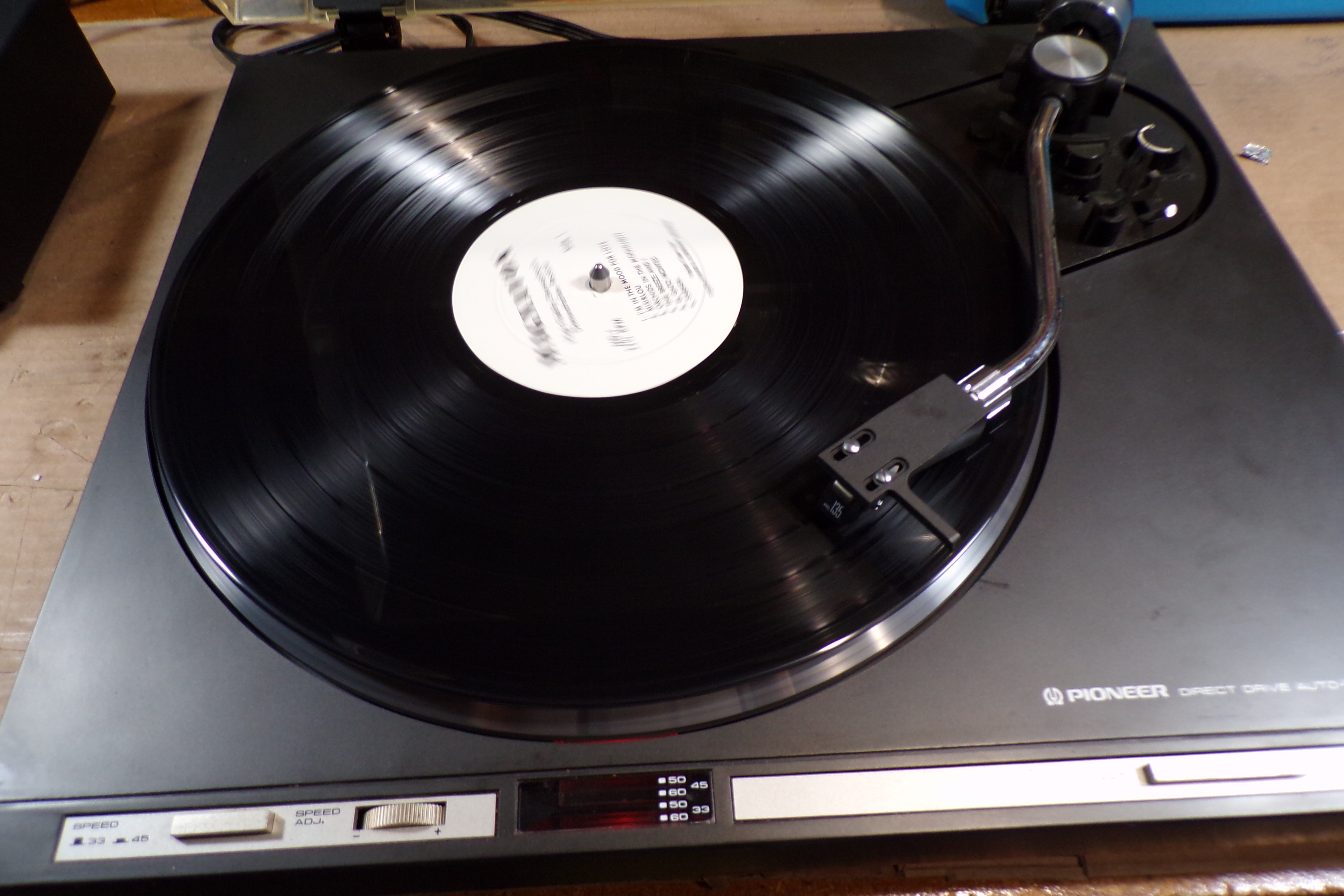

Post: # 26400Post electra225 »
The speed control pot on this turntable was pretty dirty. I believe I have it clean enough the speed will be accurate. It has a stobe light, so that makes it easy to check. I set the tone arm weight to 1 1/2 ounces, anti-skate control to the same. I'll connect this table to an amp and see how it sounds. My turntable is charcoal color rather than the silver like in the link.

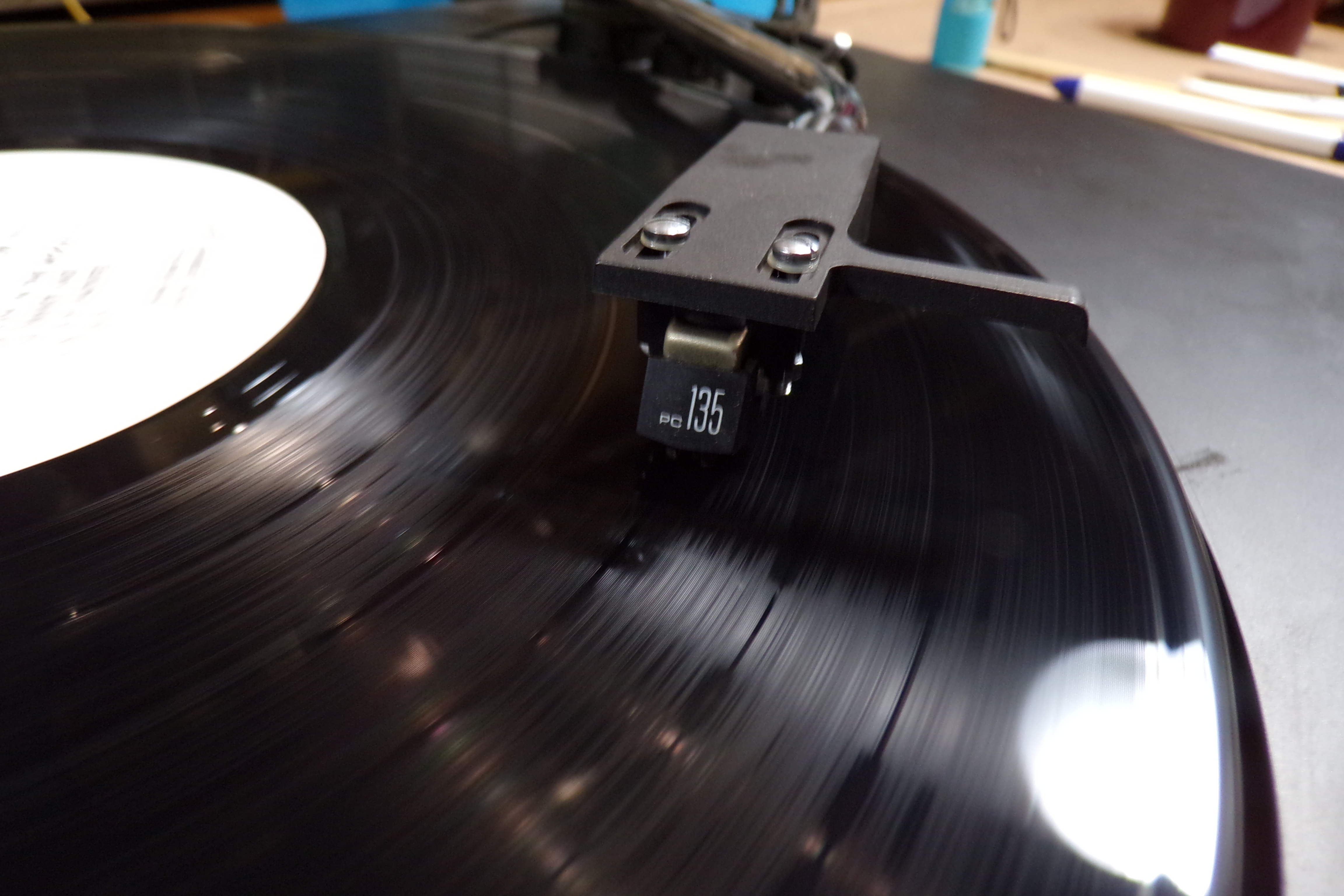

Re: Pioneer PL-200 turntable
Post: # 26408Post electra225 »
This is the PL-200 playing a Magnavox demonstration record. The cartridge in this turntable is garbage. I hate to think I agree with anything I read on AudioKarma, but they hit this one square on the nose. It makes sound, and it tracks light, 1 1/2 grams, but that is about all good I can find to say. I don't consider myself an audiophile by any means, but even I can hear the difference between the PC-135 cartridge in this table and the Stanton 500. Night and day difference. Kiddie player versus Concert Grand difference. I think I'll get some cheap headshells on ebay and put this cartridge and the AT-10 in the Technics table in them and use them to play 45's and more worn records when I transfer them to digital. I like the turntable itself. It has a stobe light, accurate speed adjustment after I cleaned it. Easy to set tone arm pressure and anti-skate. It is certainly worthy of a better cartridge.
