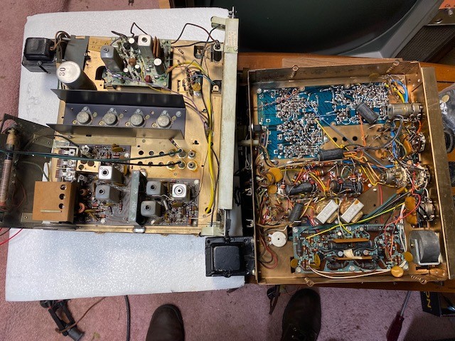

Here is a great eye-opener for anyone considering buying a solid state Magnavox Astrosonic. Every single black nichicon-branded capacitor tests bad on my PEAK 70 ESR tester, yet both chassis somewhat play. I do not believe these solid state equipment caps reform like some higher-voltage electrolytics do.
I restored a TOTL tuner/preamp and amplifier chassis for a 1966 Imperial, using even fewer caps than lower priced sets, with good results. The best part was, it was for my cousin as a present so, I did not need to sell it to compensate the efforts.
Having done "a few" early 60s Astros in all price ranges, it is a sure bet to have a working like new receiver BUT only after you replace ALL of those black (or light blue) electrolytics, 1 to 1000 mfd, and all 50 volts. Usually it is best to test the multi-section can out-of-circuit.
This begs an existential question: " Is a little unit like this worth the same or more effort as an expensive model ?"
No doubt a large TOTL unit is worth some effort, but isn't it harder to re-home due to size and weight?
I prefer tube models for low-power small consoles but early to mid-60s solid state, while overestimated in most power ratings, have a cool factor tag along as part of that dubious power rating upsell.

Yes... those black caps are always bad , but on the bright side, those chassis are some of the easiest to work on...components not squished together, makes for easy replacement. it is nice to be able to pull the chassis out and work on it out of the cabinet and still power it up to test it...

The easy access is very helpful yes. These are really not much worse than a Zenith or RCA solid state, except the fact these have many more caps you must change before you're done.

Your caps may not be as bad as the early astrosonics. R222 and R231 are such chassis, an improvement in parts selection must have occurred at some point. The later W800 series changers were an improvement as well.
Later Mags don't need much recap but cabinets began to use plastic like Zenith did with TV cabinets in the 70s.
I only needed a few caps to make a 1967 Magnavox R214 (20w) keep plugging away as my shop console, though the volume control is shot, its receiver is dependable.
