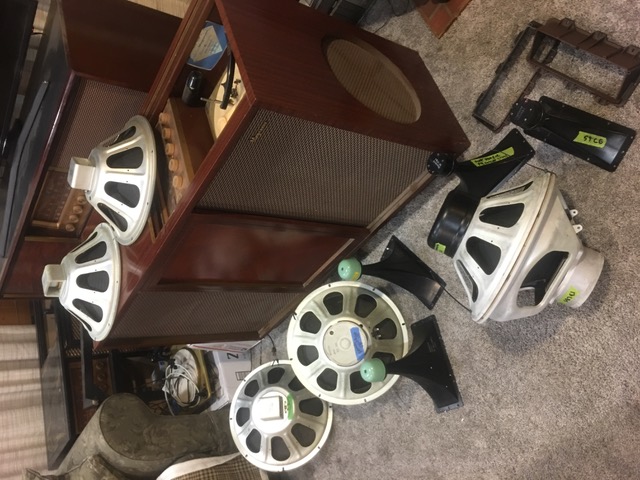

Hello all, Wondering how much of this i am encountering three of the consoles i have are the smaller AMP 175 units with the 57 series preamps. In theory since all three have been recapped they should sound similar. This is not the case the 1 st207/8 has great mid range sounds clear but just is weak on base and treble. The 2st208 had weak base until i put in the concert grand woofers it a lot better but is no ground pounder like you would think. The 1st203 however is a creampuff and literally was owned by a school teacher. It was actually running when i got it i was told but i had it recapped immediately. It's running now and it has the best sound (overall and bass) of all of them including the continental.
Messing around with the speakers, I have come to realize its all about speaker condition. I now press on the cones to make sure they work freely. One i have is stuck/frozen but i noticed that some move more freely than others by hand. I also have a mid range set where the paper has gone soft from what looks like high humidity? (they rattle) I wonder also if the magnets can lose power? Anyway at some point i would like to purchase new equivalent speakers and see how much of a difference that makes. But for now (everything else being equal) it seems it is all about the speakers, how well they have survived the last 60 years and this determines how good the console sounds. Is this what you guys find also ? Hydro
- IMG_6085.jpeg (104.85 KiB) Viewed 5302 times
Re: E-V speaker isse?
Most consoles of that period didn't employ acoustic suspension or correctly sealed and ported designs, so even large and sometimes multiple large woofers will not respond to frequencies much below 70-80 Hz in "ground pounding" fashion.
In general this had to be true to in order to prevent major acoustic feedback to the record players housed within the same cabinet.
