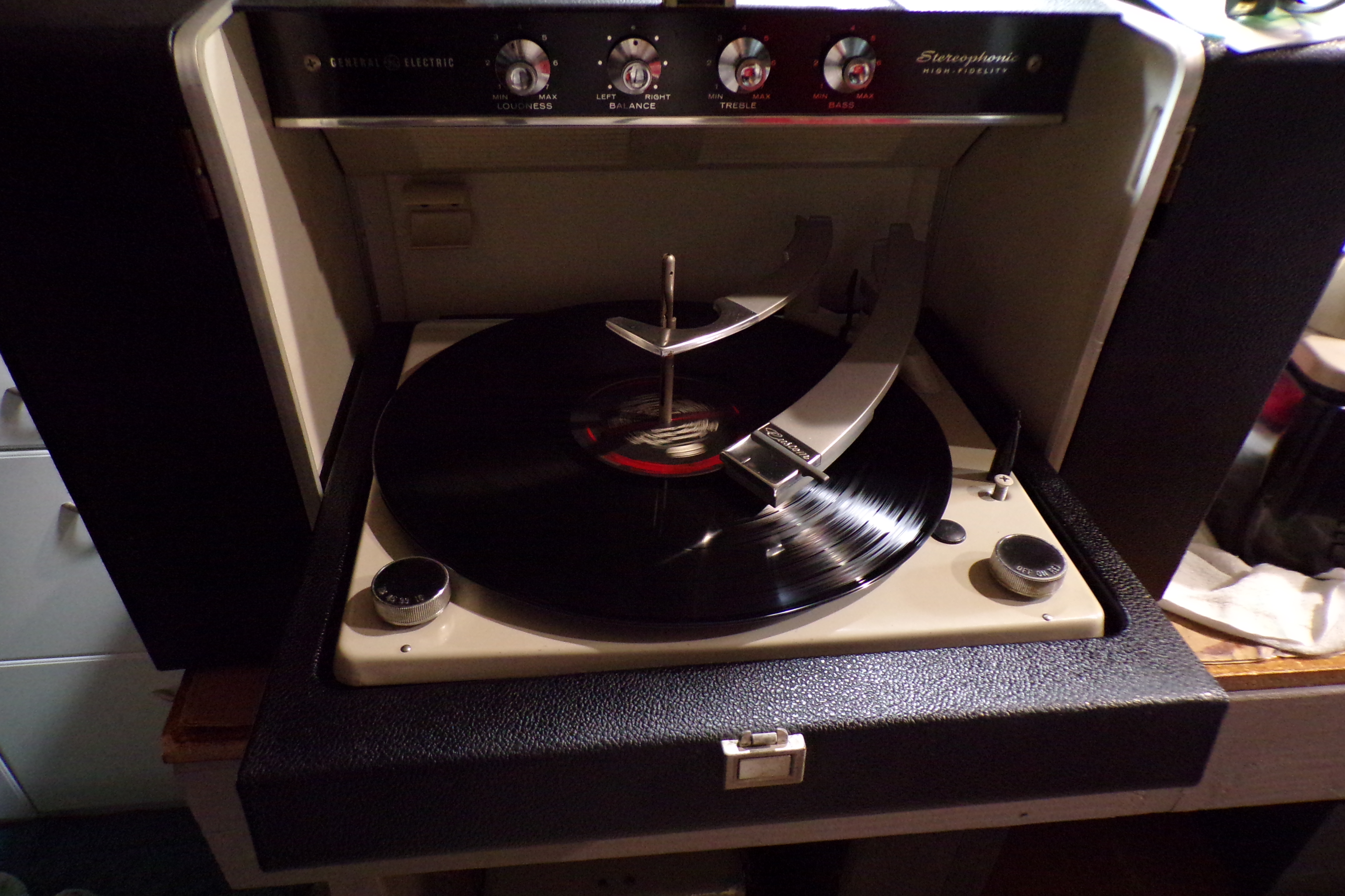

A forum member contacted me about a power cord for his GE Trimline stereo. These stereos have a power cord interlock like is more commonly used in TV sets. The originals go bad, and replacements are unobtanium. I have found that the power cord used on those cheap boombox radios and cassette tape players will work in these little stereos. I've got a couple pictures of such a cord used on my RP-2060A Trimline stereo. I hope this will answer his question.
This is my little Trimline stereo. This is the better one of the three I have. Playing my new Lawrence Welk record.
