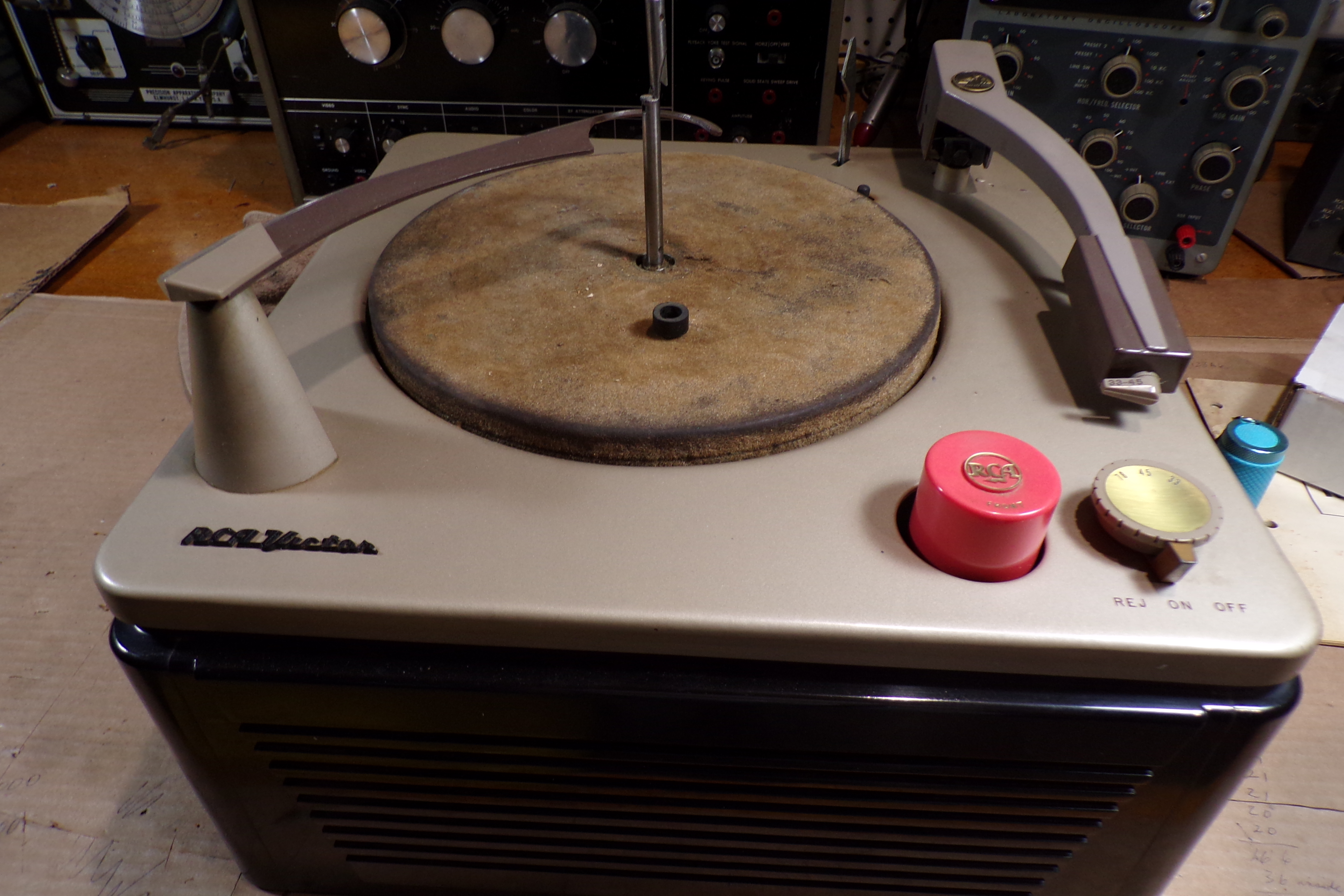

I have this cute little 3-speed record player. It has the RP-197 changer, if I read correctly. I need a needle for my CG changer before I go much further on it and don't want to pay shipping on just one needle, so I think I'll get a baseline and a parts list made for this thing and order what parts I need to make a order for Gary. I know it needs a spindle, probably needs a drive tire, motor mounts and a cartridge. It's in nice shape, so it should build out nice. It has a three-tube amp with a 35W4 rectifier, 12SQ7 audio amp and a 50L6GT output tube. Pictures coming....

*It's in nice shape. I'd say a 9 out of 10 easily.
*I think we can call this a 1954 model. The two RCA tubes are dated 1954.
*It is not an RCA record player exclusively. It is also a Hummer......

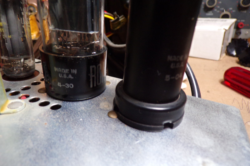

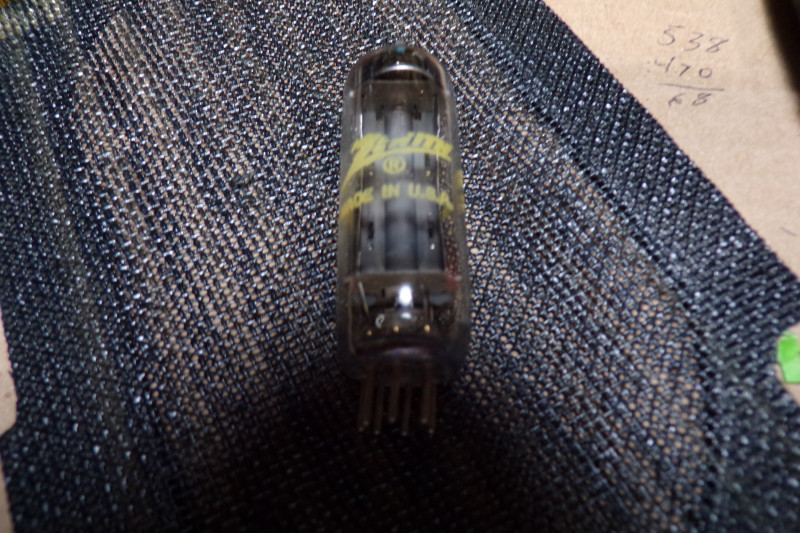

*The 35W4 rectifier is a GE-sourced, Zenith branded tube dated the 30th week of 1964.

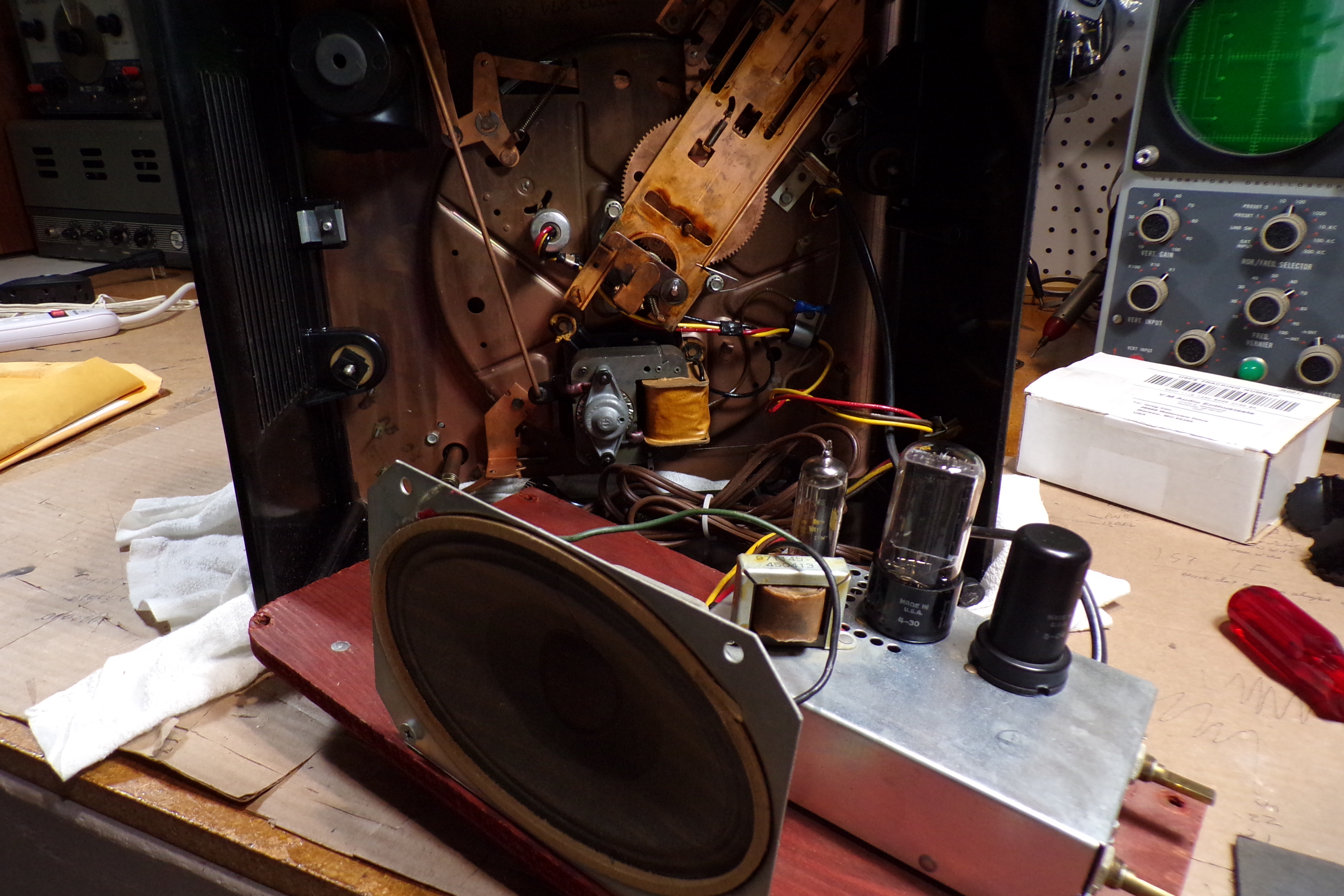

There is a real "what were they thinking?" setup on the speaker connections. Due to the configuration of the speaker and the 45 adapter well, the speaker connections run out the side. There is a phenolic terminal strip that holds the speaker connections. The speaker connections were very happy like they were. I broke that terminal strip trying to get the connections apart. Now I get to fix that.....
The bakelite base is essentially perfect. I cover it every time I work on something. I'm sure to let a tool slip and put a big goober in it. Have you ever seen a used cartridge as clean as that one? I swear I haven't even dusted anything on this player. You are seeing it like it is. It's amazing......
I need to figure out how to manage the changer so I can tinker with it. I don't see any plugs between it and the amp chassis.

A lot of RCA player of this vintage are all hard wired, I guess they figured they would never need service, except for tubes, or you would just through it away if something serious broke and buy a new one. I kind of figured you could not resist puttering with it, I know I would.

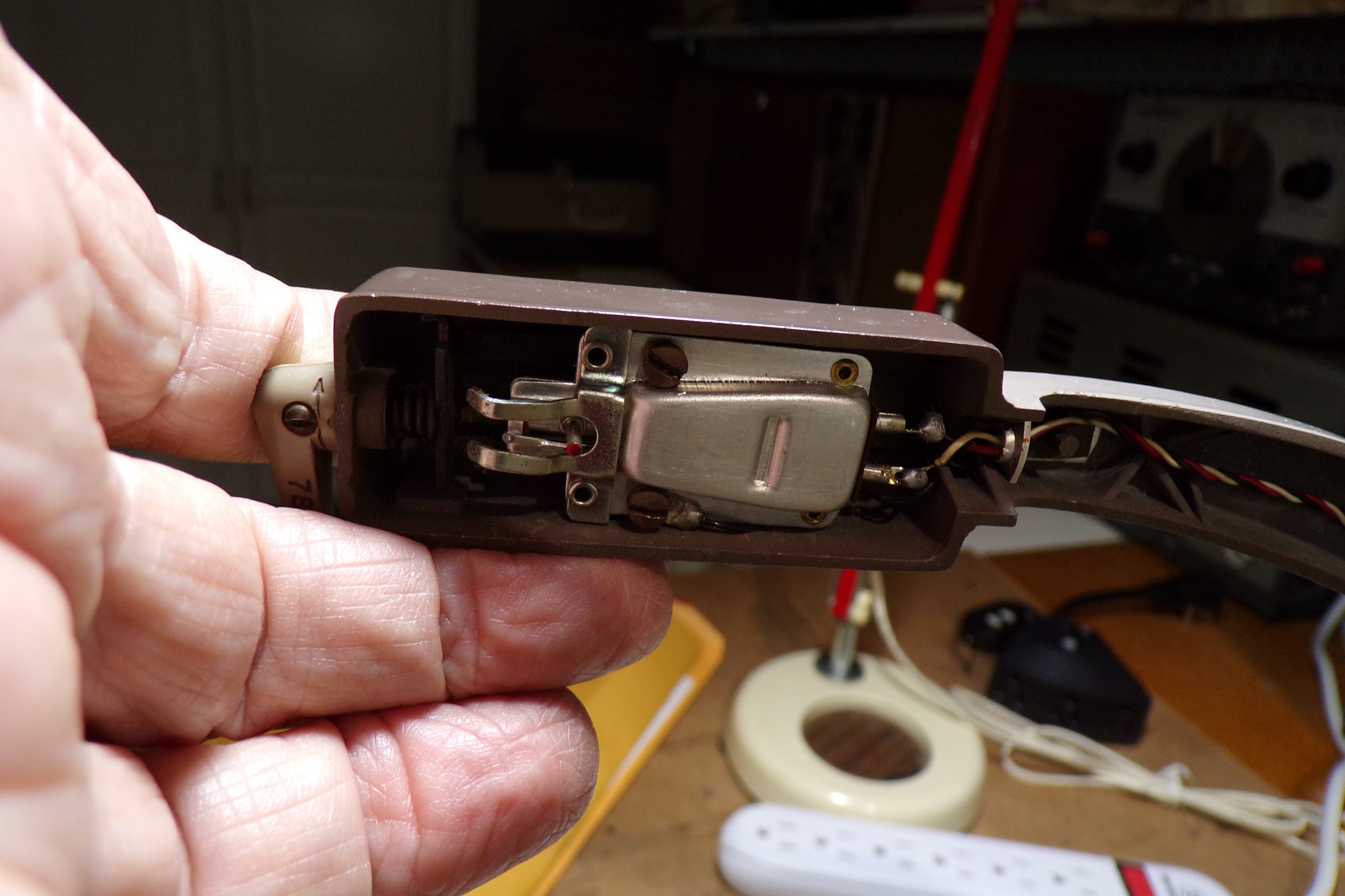

The cartridge appears to be a 1/2" mount. I recapped the chassis. I also found the cartridge is stone dead. Whatever I did to the changer didn't help the "always in reject mode" situation. It will have to come apart so it can be serviced properly. I've never done one, of course, so I'll have to muddle thru. Since there is an amp stage (12SQ7 tube), I'm guessing it has a ceramic cartridge of some kind. This one is a flip cartridge, but I'm not concerned about that. I'll contact Gary to see what he may have in the way of a replacement cartridge.

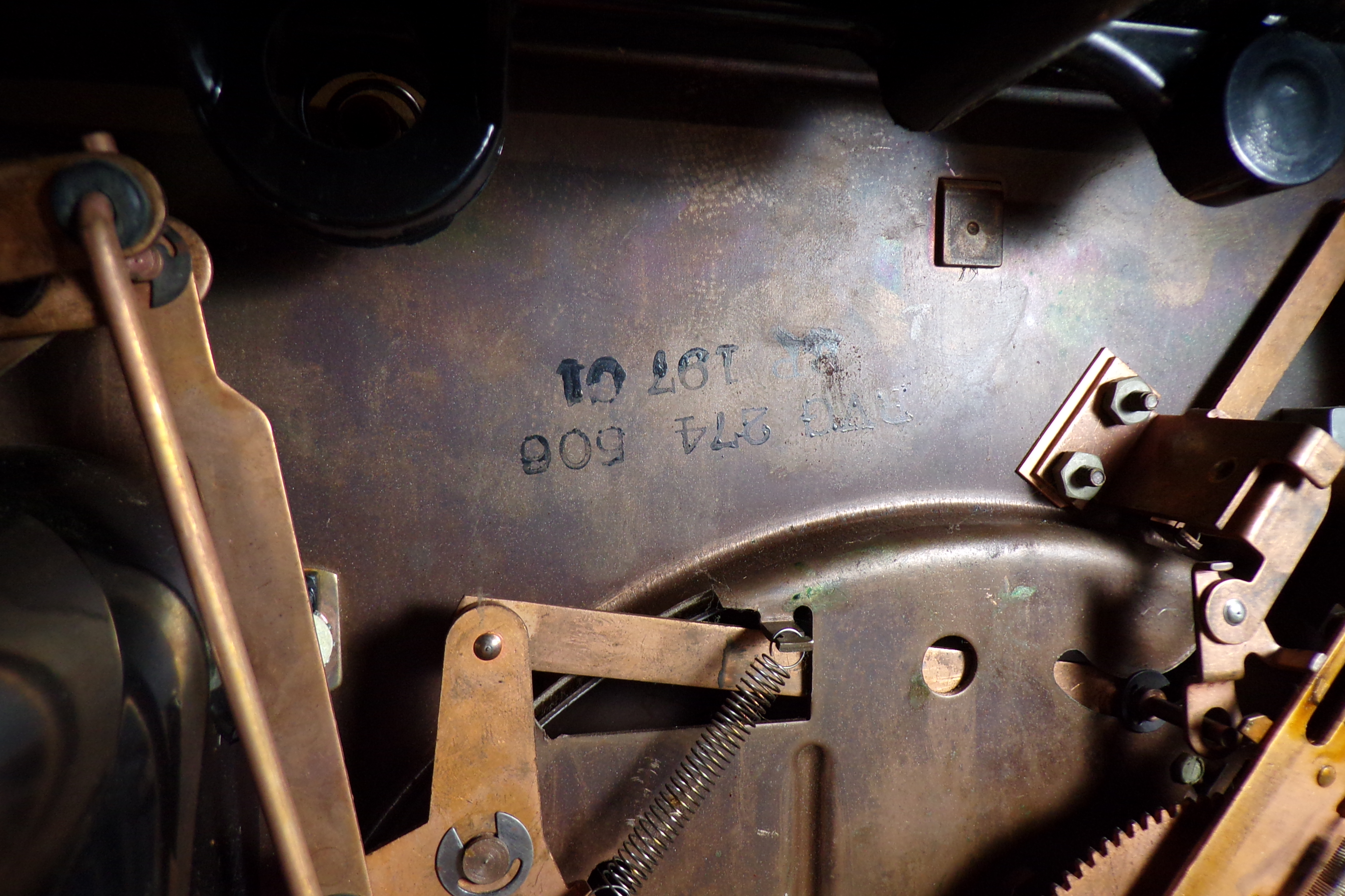

Thanks, Mr. Mogul! Good information to know. I found a Chris Cuff video on the RP-205 that told me what I needed to know to get the thing apart. The 205 is a later, 4-speed changer, where this one is only a three-speed. It looks like mine on the bottom. This changer may not be all that tough to service. Would you have any input you'd care to share on the hold down thingies I posted pictures of?. I think two of these are missing on the changer I have.
Edit later......I may have come up with a plan on the attachment bolts or whatever you call them. I'll tinker a bit and report back on that. I also think I'll try turning this player upside down on the styrofoam base I use to repair changers. Leave the amp and that in the cabinet rather than trying to wrestle all that out and not break something.

I may have some RCA changer retainer/shipping bolts/clips.
If you still need them, let me know.
- Posts: 8910
Re: RCA Victor model 6-ES-3 record player
I was going to use studs and locking nuts. IF I could get the right parts, that would be better. I don't want to risk breaking the bakelite on this thing by not having the changer secured properly. Thanks for your kind offer. I'll take you up on it, if you have some you can spare.

The tone arm does not have 1/2" mount. It is a flip cartridge. It will probably require using a glue-in kit from Gary. I used one of those on the little 45 player I did and it worked out well. Getting the tone arm off will be the worst part of the job. I have trouble with that process....
if your taking the tone arm off so the glue wont run just remove the turntable and position it so the tone arm lays flat
