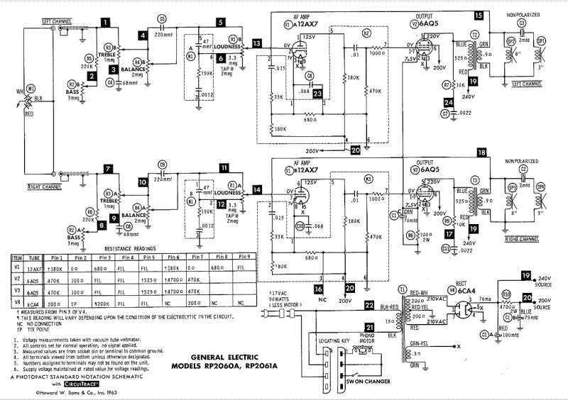

Some advice, please. I have a GE RP-2060A that I have been working on. The Sam’s is in the downloads, under changers, and is on page 3 all the way to the bottom of that page. This is one of General Electrics Trimline units.
First off, the filter capacitor was one of those junk paper ones and it was bulging at each end and fat in the middle, so I did not fire this unit up until I changed that out. Remembering Electra 225’s comments about a Trimline he had worked on, I followed his advice and increased the values of each of the three parts to this filter capacitor. With that done I fired it up to see what I had. The unit did play but definitely needs work.
Next, I checked all the resistors and only found one out of tolerance. The rest were surprisingly all very close to rated values. I changed the resistor that was bad and then began voltage tests. Again, I was surprised to find things very close to the recommended voltages found in the Sam’s schematic. I cleaned the tube sockets and checked the tubes. No shorts, no emissions, and the only tube that was on the weak side was the 12AX7. I also cleaned all the controls twice. Time for another sound test and it actually sounds good, good bass and treble and plenty of volume, but the volume control needs another cleaning, and I have a buzz. No hum, just a buzz, and the buzz will go away if I put my finger on any metal part on the chassis. Also, the buzz will get louder if I hover my hand over the 12AX7 tube or touch the volume control which is kind of odd as the shaft of the volume control is plastic. Again, hand hovering, if I touch the chassis the buzz is gone. The buzz does not interfere with performance while a record is playing, but it is kind of annoying between tracks and can be faintly heard during soft passages.
Thinking this is a ground problem, I used my meter to trace all circuits in the PC boards especially the ones that pertain to grounding and all check good. I swapped out the 12AX7 with no change, the buzz was still there. I pulled the output tubes one at a time, buzz still there. I tested the tubes again leaving them in the tube tester for a long time to see if getting good and hot made a difference with results. NOPE! I did clean the volume control again, but I still have the buzz. At this point I am stumped and was hoping maybe one of you might have a suggestion on where to look next. I suppose it is possible that it is just the nature of the beast, but I am thinking GE would not sell something like this.

I don't see that type of cap in the schematic.
Maybe because there is a power transformer.

Are you using a Variac and/or an isolation transformer with this stereo? If you are, disconnect it, connect directly to the wall. If you aren't using a Variac and/or an isolation transformer, connect the stereo to one. See if either connection helps the buzz. The schematic doesn't show the metal shield. Ground it and see if that helps.
