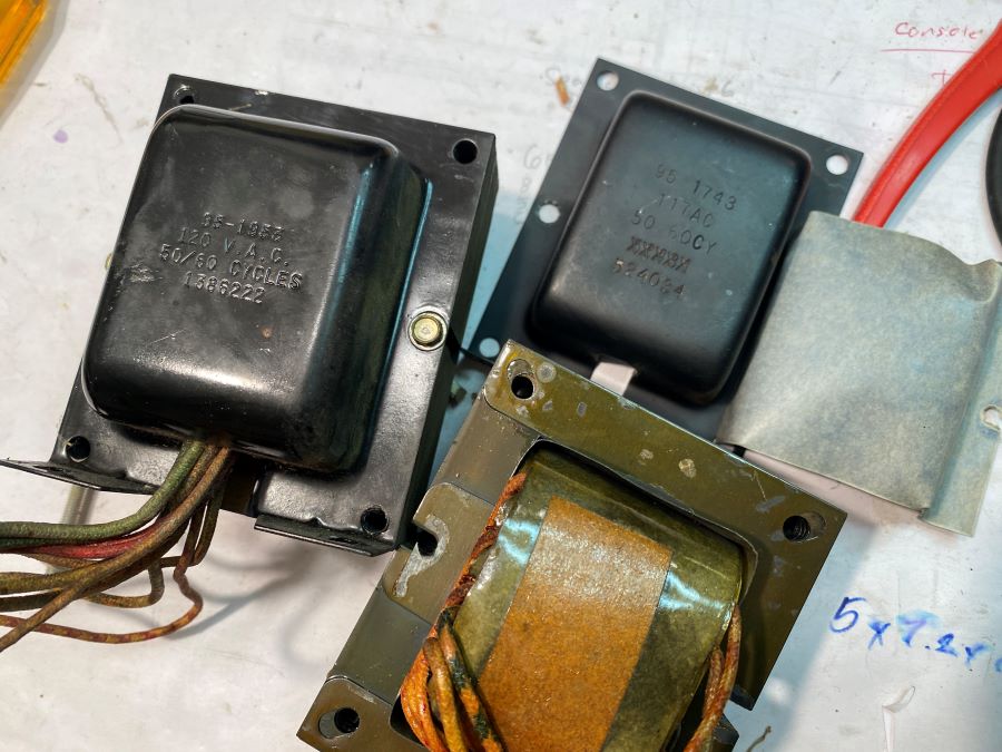

Pictured at right is a clean-looking transformer that once AC input hits 53 volts (on the way to 120, in theory), the HV center tapped secondary winding begins to arc internally @300VAC and a very acrid odor is silently and invisibly emitted, with absolutely no load on any of the other windings :(
The current meter on my variable power supply rises erratically past 1.2 amps as I advance past 55 volts input. That 2 Amp fuse did not save this transformer, failing under normal service as its dielectric strength via varnish on windings and paper separating case broke down. This overall rating is normally 1000 volts AC.
As Bill has observed based on his own unit's amp, the 524-prefix transformer (Triwex) fails again, so I have a more standard (for Zenith) 138-code OEM Stancor :D transformer* that is an exact match. I put it in last night and tried it this morning, all works as intended even thru my bench speakers. Just need to hook up the cobramatic with its new cart and see how extended stereo affects a stereo source, not just the mono radio source.

The official replacement transformer is a near match, I would trust this
100% enough to guarantee a repair but my customer is OK with used at half the price.
