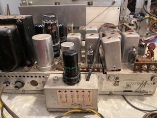

A few years back, a Zenith HF1284 from 1957 was in the shop, small chassis added with a 6J5 for use with a Radionic Cart.
12Z20 chassis a.jpg (30.69 KiB) Viewed 33551 times
I did not try to restore the cobra matic, it needed too much work and customer wanted radio and amplifier mostly.
