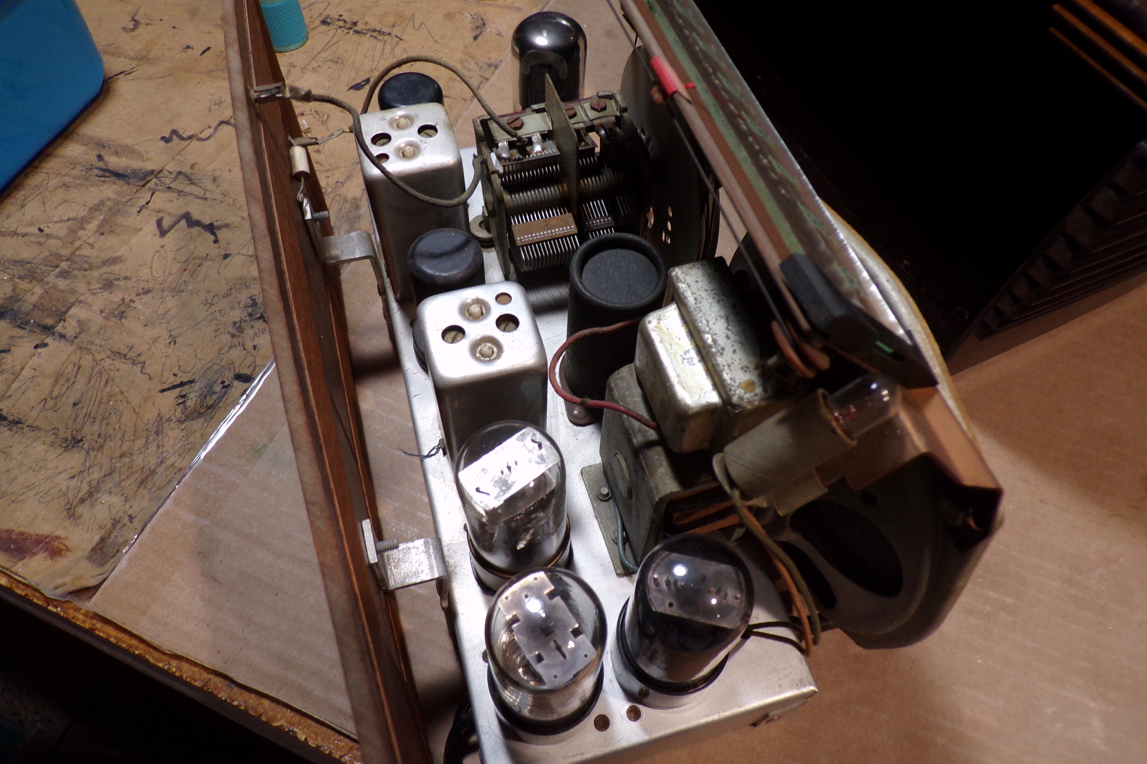

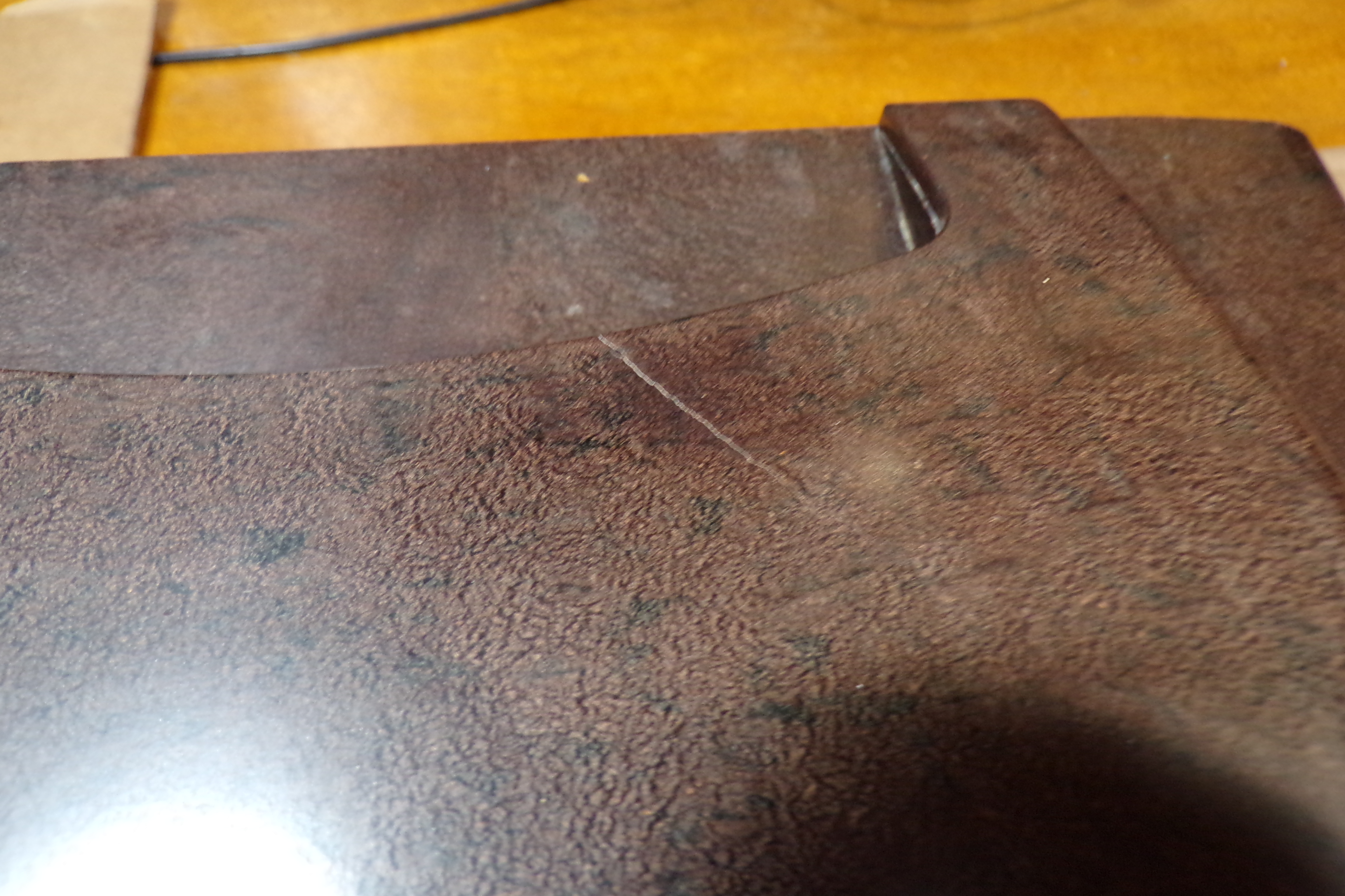

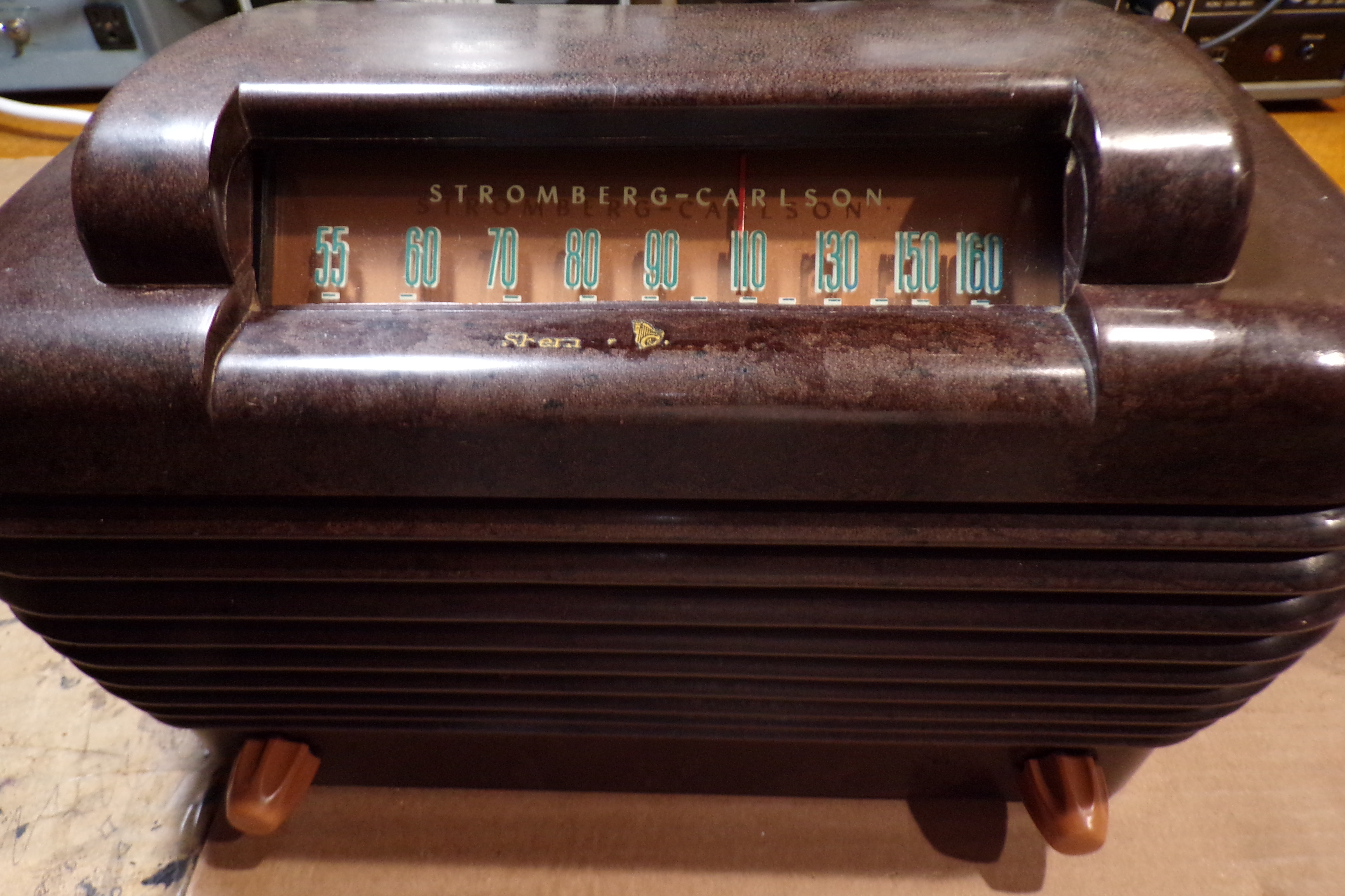

This was one of the first radios my wife ever got me. I've had it well over 50 years. I had it probably 20 years before I got it to work right. My stepdad said it was a "squealer" not worth messing with. The specs for this set lists all glass tubes. I found that if I used a metal 12SA7 and a metal 12 SK7 IF amp, the squealing ceased. The cabinet on this radio has always been cloudy. In the last 20 years, it has gotten right down ugly. There is a crack in the upper part of the cabinet. That part comes off so I can fix it. The paint scheme on this set will be lavendar and black. The grille area and the top part will be black, the rest will be lavendar, as close to Evening Orchid/Lido Lavendar/Laurel Mist/Lavendar Mist Metallic as I can find in a spray bomb. The knobs are dirty tan, those will be sprayed with "Cranberry" to give them a bit of contrast. The dial bulb is out and the volume control is dirty. Otherwise, it is okay electronically.

And it has a five-inch speaker, which doesn't hurt performance any. S-C sold lots of these sets. They are not rare, but are as good as there was in a small table radio. I never did figure out why the metal tubes killed the oscillation. I'm assuming that some kind of shielding was provided by the metal tubes, but I don't know that. I know a guy who has one of these with the all-glass tubes and his works just fine. This set has always tuned a bit broadly. Perhaps a good alignment would affect the oscillation, but it works so well I am not going to fool with that.

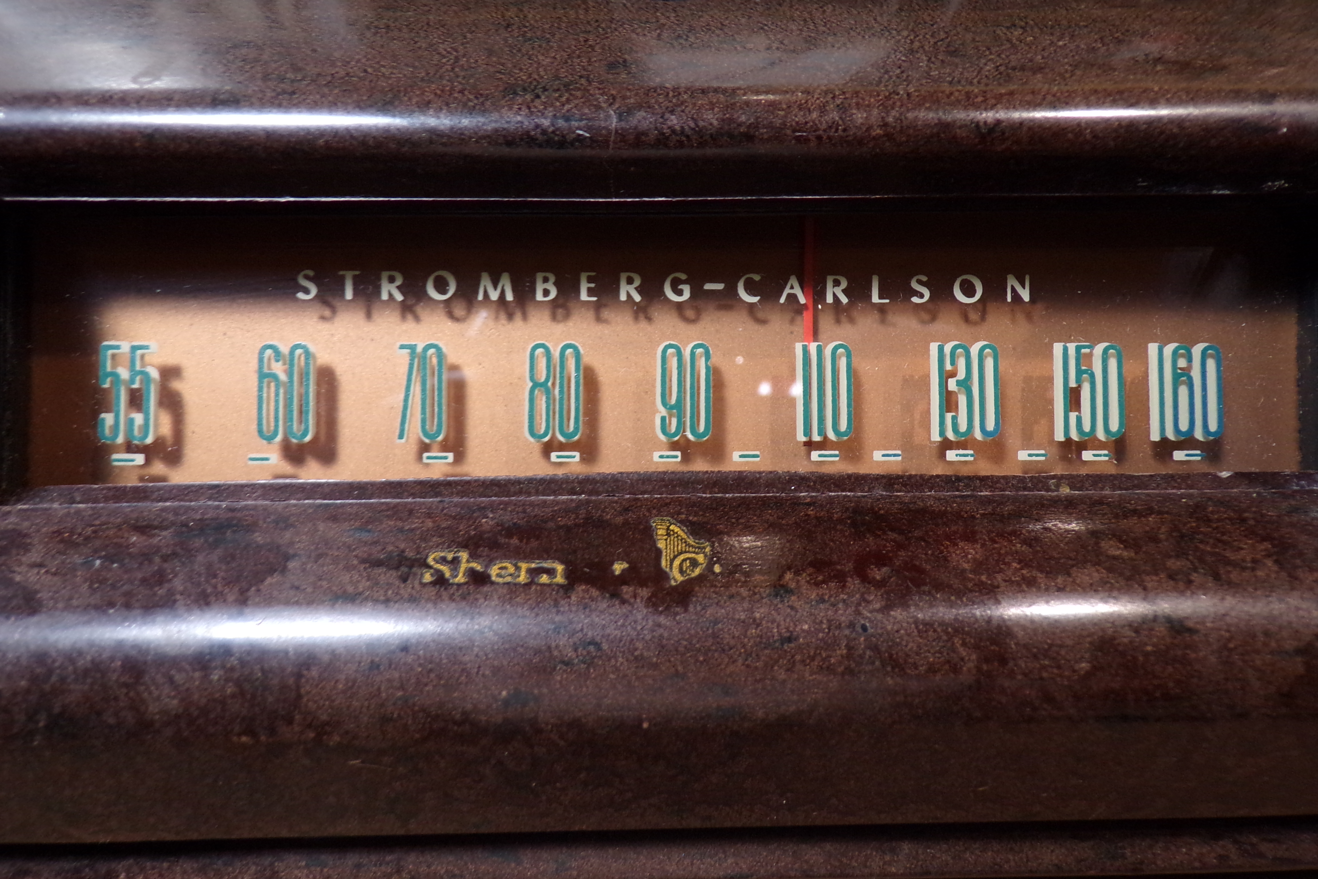

Does anybody know what the decal under the dial was supposed to say? It has always been partially gone since I've had it and I sanded it off so I can paint.

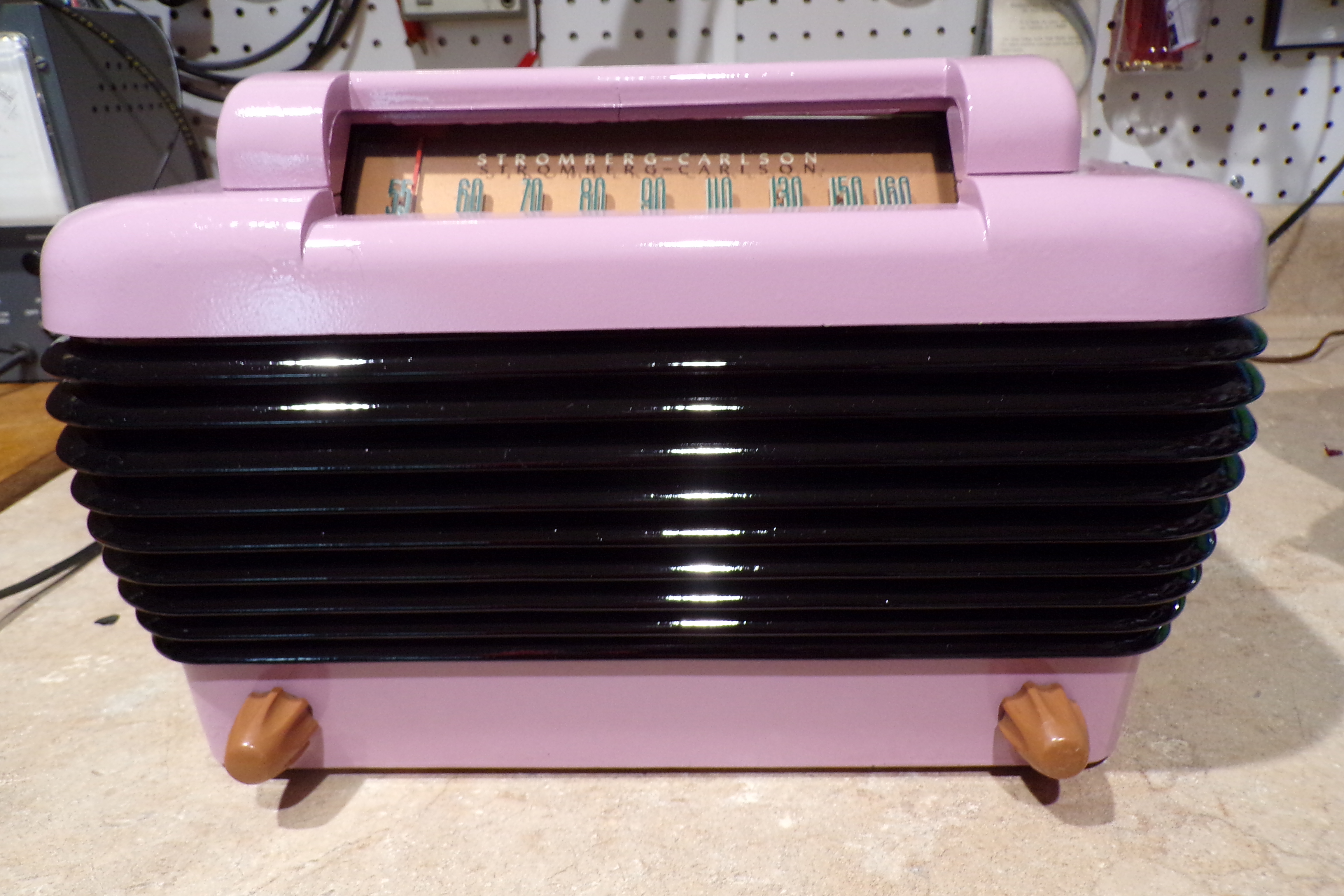

The paint is not as pink as it looks here. The lighting in my shop is not optimal for photographing certain colors. It is really close to Lido Lavendar, just not metallic. Every radio of this model I have seen, regardless of color, has had those tan knobs. I may paint them black if they don't grow on me.

Greg,
I actually like the knobs, as they match
the tuning band background color well.

Yup, leave the knobs where they are.

Okay. Got it! Thanks for your input. I hadn't considered the color of the dial background. When I look at a project for as long as I did this one, I tend to lose prospective, and can miss pertinent details.....
