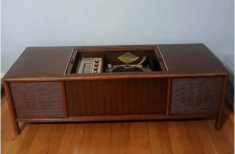

Does anyone have a photo from a brochure, or advertisment of this 1961 or 1962 Magnavox Micromatic coffee table model? I'd like to know if it had an actual name.

Thanks for both replies Bill!~ I was off by a year on the date. For some reason , I thought they stopped making tube amps in 1962, same with the Civil Defense markings on the dials.. I have the original paperwork for this somewhere, but I can't find it at the moment. It was in a house my uncle purchased in NY in 1970. I always thought this sounded great when I was younger.

I always called them window seat models ... I cant tell the dimensions from the picture , but it looks taller than a coffee table , some Mfg did make coffee table sized sets , they were roughly about 18" tall... welcome to the forum!

I just wanted to get it up and running again, as it hasn't been used in about 20 years. It does turn on and run, ( haven't tested the record player yet ) but the volume knob has a lot of static. Are you saying I should be doing something with the tubes before I just start listening to it?

You don't need to do anything with the tubes, per se, but you should do what I refer to as a basic tune-up before you run your stereo for a long time. The volume control is in the tuner. If you get a scratching sound when you move the volume control, it is exhibiting a condition we refer to as "dirty". The internal parts of the volume control collect contamination that causes that scratching noise when you move the control. You can spray contact cleaner into the control to clean it, but that requires removing the tuner from the cabinet. I don't know what series amp your stereo has, but it is separate from the tuner. It has a number of paper capacitors that should be changed for long-term reliability and safety. Then you might also consider installing a fuse in the primary of the power transformer to provide a margin of added safety. You can test the tubes to be sure they are okay. Then, if you want to get into it a bit deeper, you can run bias tests on the output then match the output tubes, and so forth. We will be happy to talk you thru repair procedures as they progress if you would like. You should also service the changer, and we have guys on here who are well-versed in the servicing of the Collaro changer in your stereo. Good luck!

I'll follow up on what the others have said. With old electronics, some really cheap parts can fail and cause damage to really expensive parts. You've already had yours on, because you said the volume control is scratchy. It didn't self-destruct, so the cheap, failure-prone parts in yours have not given up. Yet.... The problem is that for longer-term durability you're better off replacing the items that can fail. True confession: I've collected old radios etc. since I was a kid many years ago. My practice was to pug them in and see if they worked. I never had a major disaster. Now I now better, but sometimes I still plug 'em in while observing very carefully. Do as I say and not as I do.
The items that can fail are mostly capacitors, devices that do not age well. They are readily available and quite cheap. The parts they can damage if they fail are tubes (if yours is tubed) or the power transformer, a crucial and pricey part. For a device that you'd like to use regularly, it would be wise to replace the original capacitors. Replacing them often makes the device sound better because even if they do not fail spectacularly, they can degrade and lead to sub-original performance.
The other common issue is the mechanical function of the record changer--its ability to move the tone arm and drop records properly. These usually don't break unless they are abused, but the lubricants that reduce friction in the mechanism eventually oxidize and turn into glue or cement. They often require cleaning with solvents and re-lubrication with grease and oil. That requires disassembly in varying degrees. If yours is working well, that's one problem you can put off until it doesn't.
None of this is rocket science but advice is always good to get. You need to get parts with the right specs. You need to know how to solder properly. You need to know that some capacitors are polarized and must be replaced with correct polarity. It's helpful to be able to read a schematic diagram, the graphic using symbols for electronic parts that shows how they are all connected and related. I can do it, and I was a history major who flunked his calculus final exam.

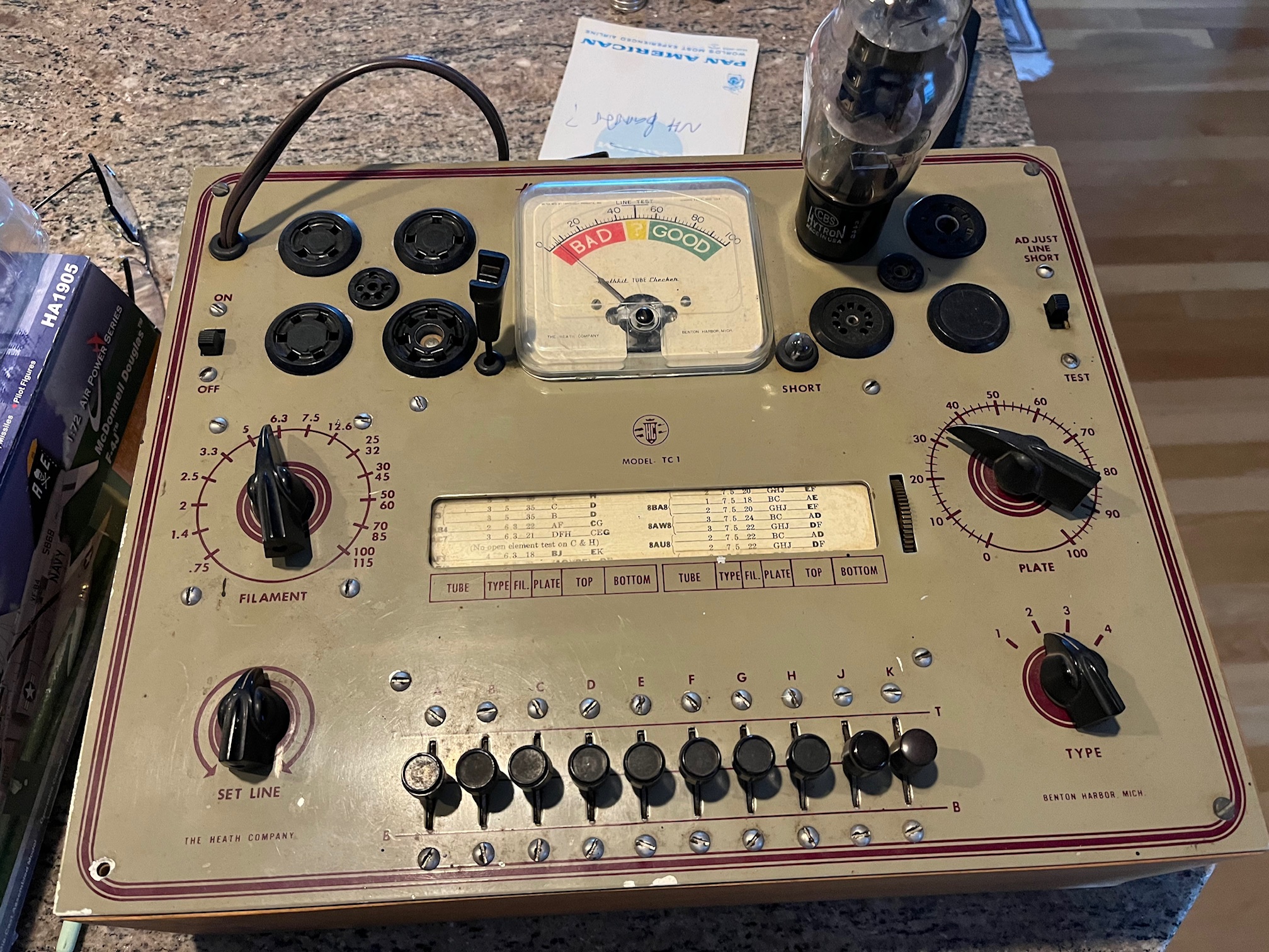

Thanks for all the info.. So are the tubes in this magnavox something I can test with this tester? I was just about to list this on Ebay.. Works perfectly.
- Posts: 3743
Re: Help identifying Magnavox console stereo
Yes, that would identify clearly-bad tubes. But usually, the problems in there older devices are not the tubes. They are aged capacitors and resistors.
