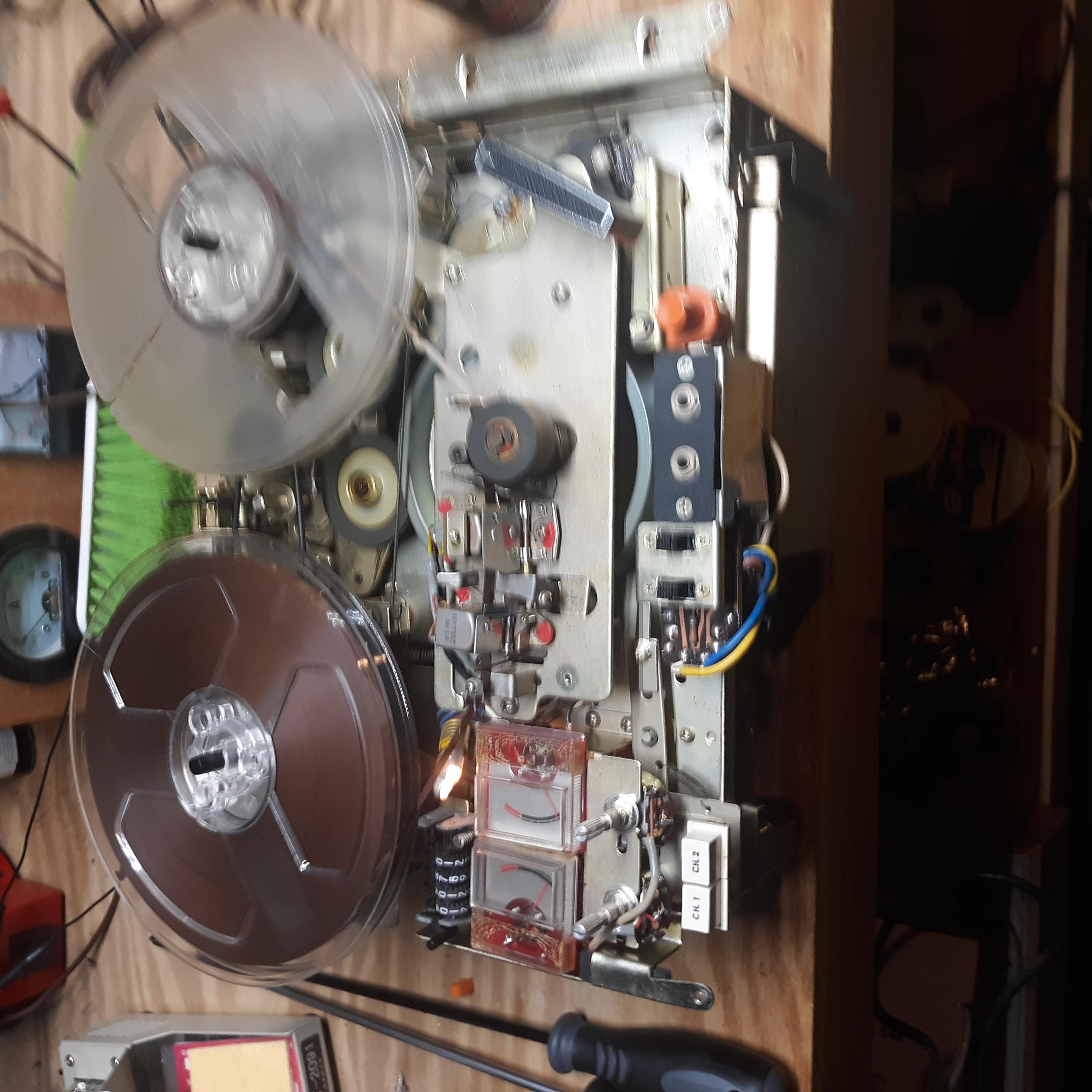

this is the machine I mounted a small variac in the cabinet of the Imperial to keep the speed somewhat close ... only problem with that plan was the motor would stall in FF or REW under a 5 or 10 volt drop that it was running at...so since I had a day off , I tore it out and replaced the motor run cap... which is rated at .7uf ... when I measured the ESR is was reading just under 4 ohms!.... I did not have a .7 so I used one of my 1uf fan motor caps that measured .2 ohms... much better ... the new cap installed and the machine now plays at the correct speed without help of a variac ... didn't know a bad motor cap would speed up the motor... they usually slow down as the motor heats up... learn something new every day..
