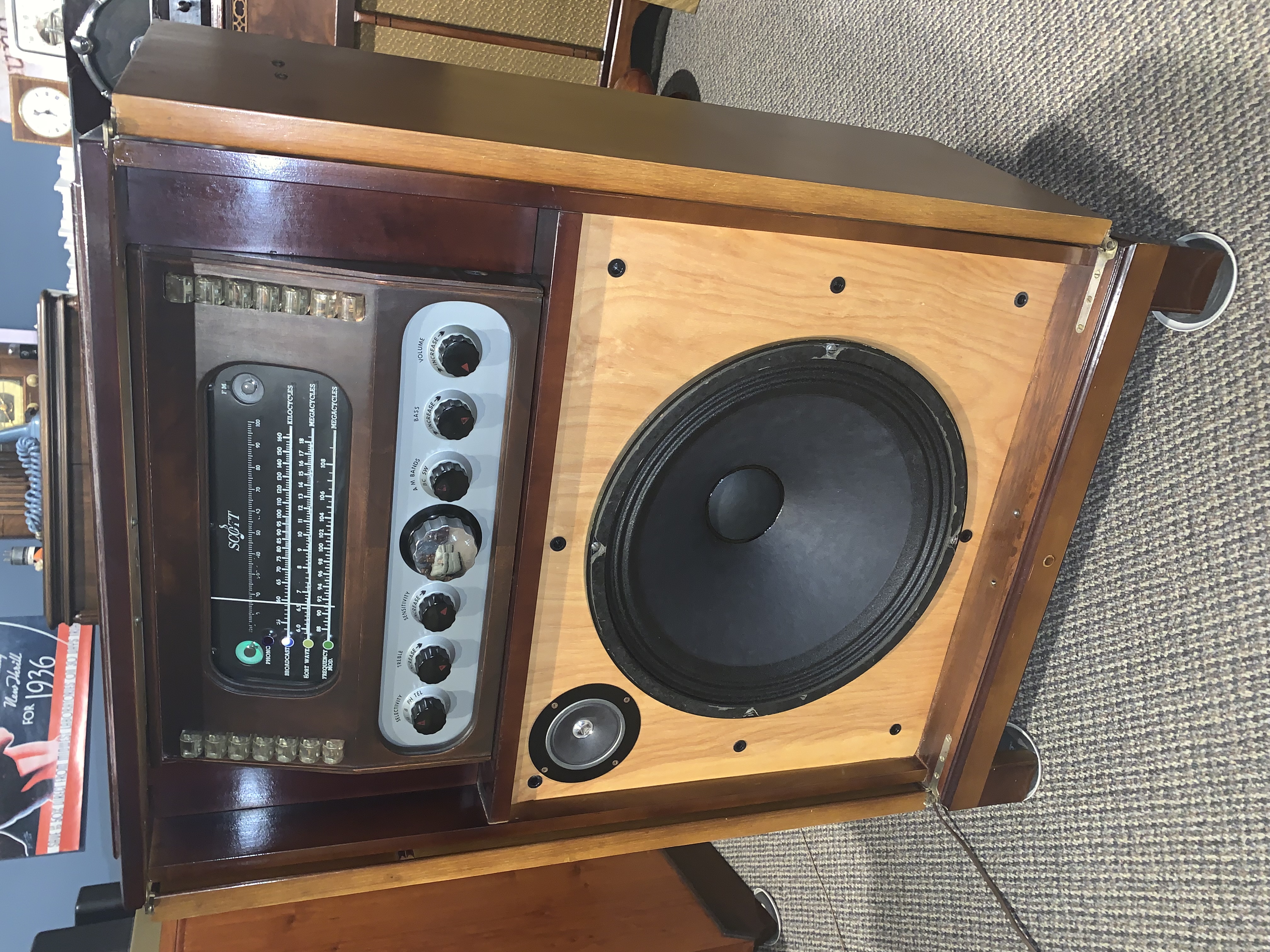

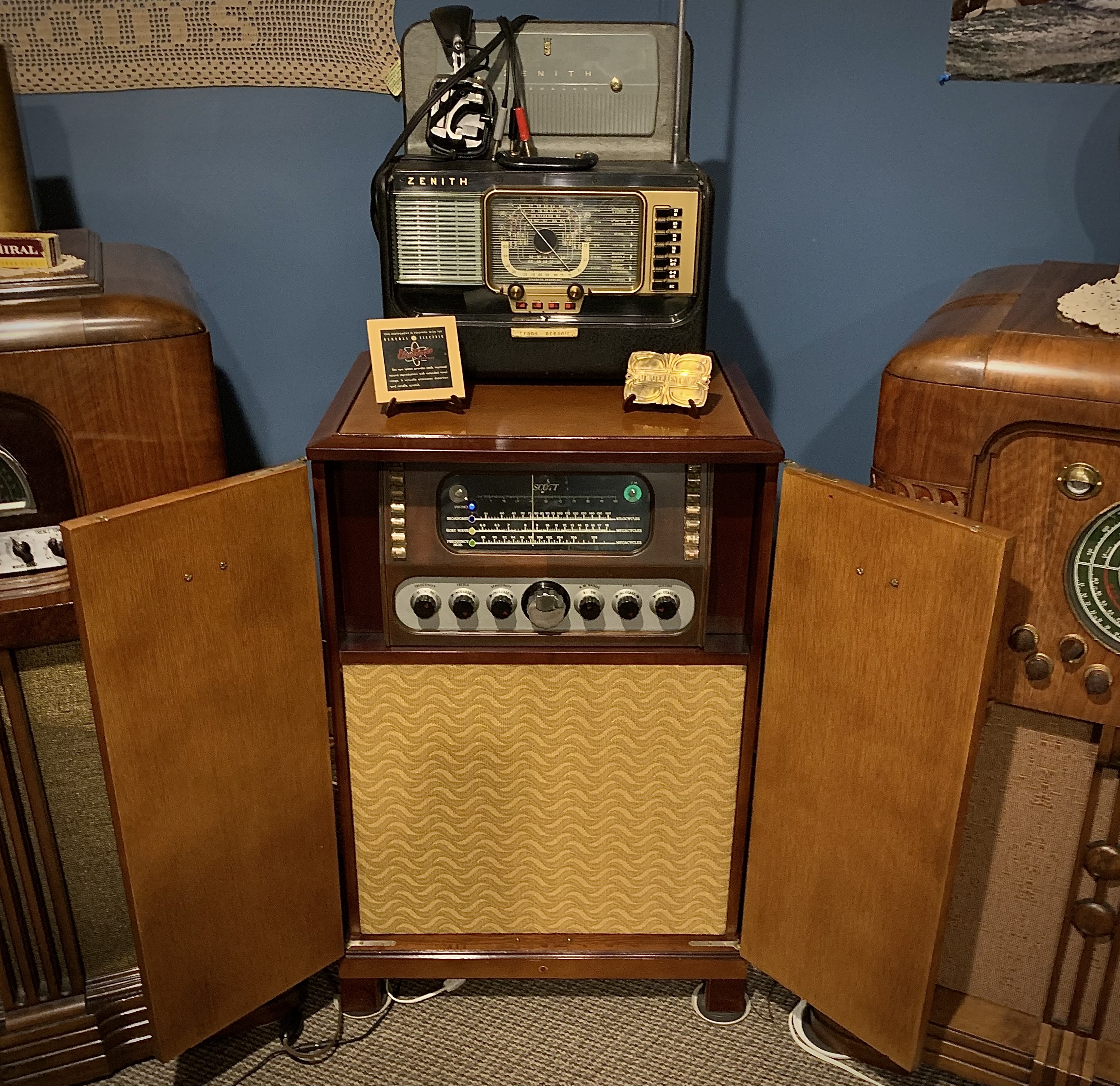

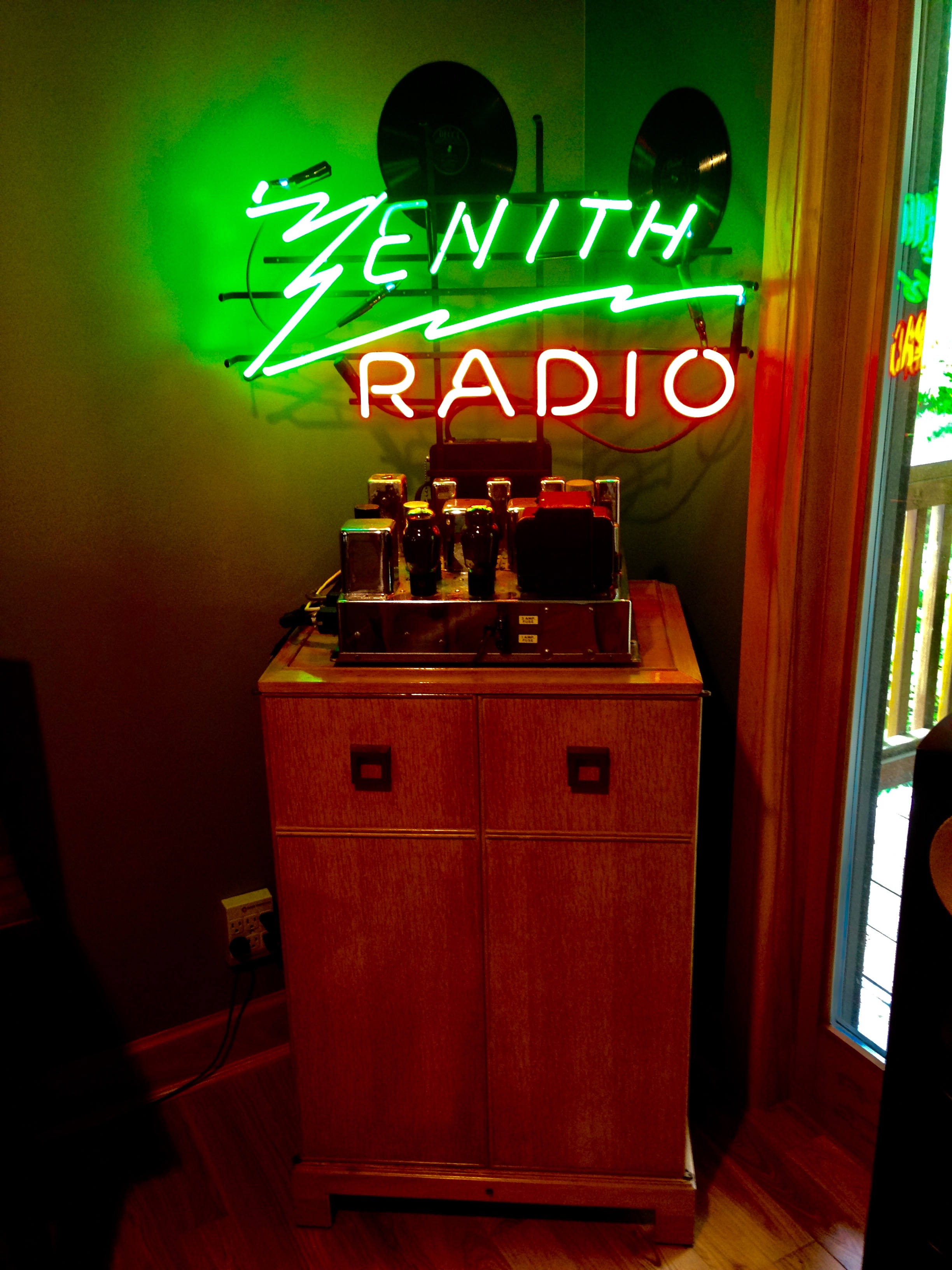

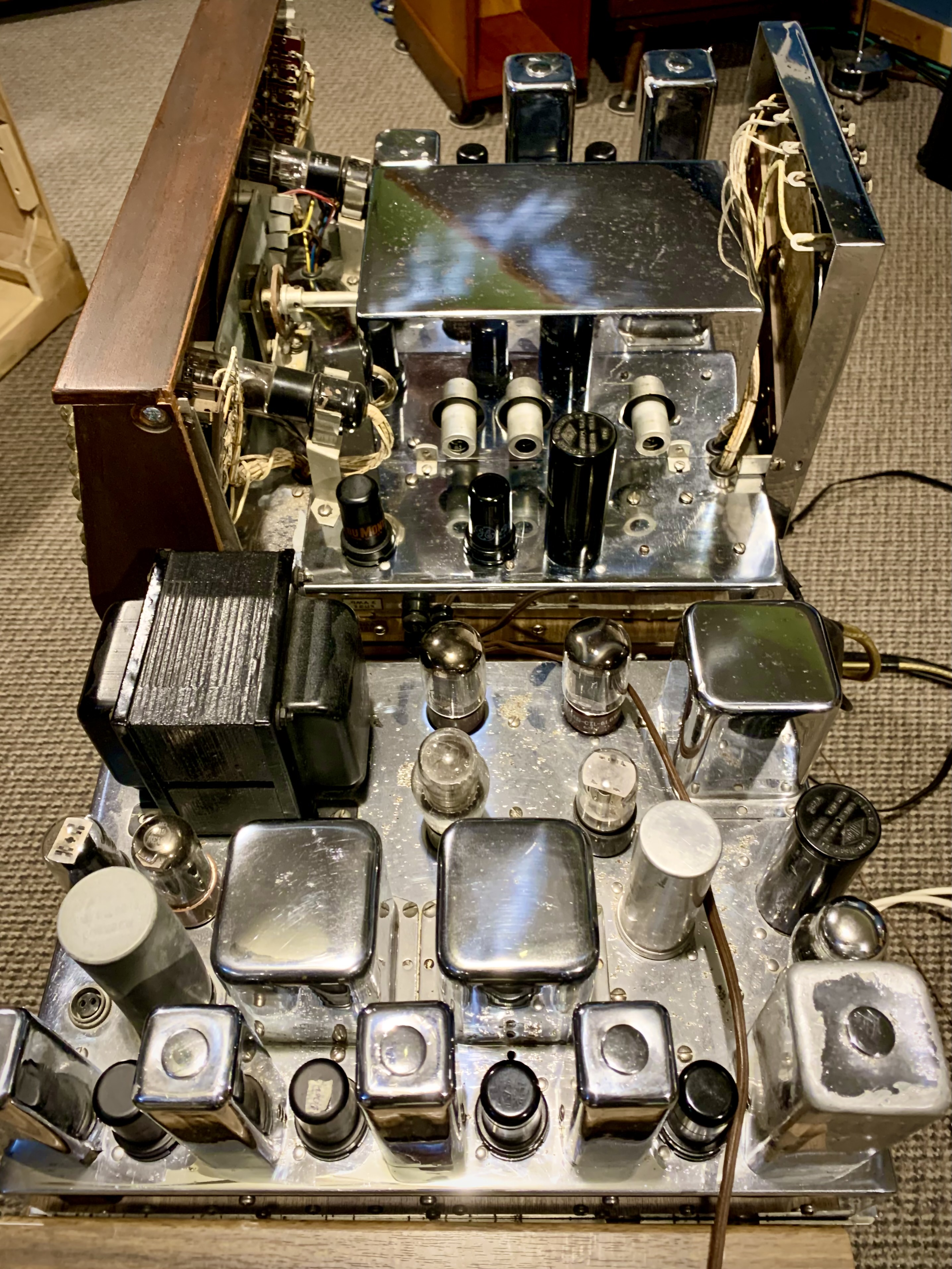

After the TV failed and the new family was pressed for space, the big box had to go. Dad grabbed a 47 GE TV cabinet from the family shop, and produced this. If you look, the power supply is topside, dad liked the look and frankly did not want to cut into the cabinet floor to accommodate. Over my stewardship years, I've rebuilt this set and of course the pickled oak look had to go. Today, I pulled everything for a good cleaning. Guys over at the "big shot" forum and even Scott fans have dissed this set ad nauseam. "Boat anchor", my rear ended. There were some circuit hiccups such as to the tone stack, it this is an electromechanical wonder with tuning motor drive and presets. Did I mention FM. I was always told the 800b was the very first manufactured radio sporting FM. I can't verify, let's call it rumor.Over the years I've made Improvements to the tone stack and replaced the paltry original coax driver with a 15" EV workhorse and tweeter. Most important was dropping the cabinet floor so all resides within. As pre 50 radios go, and as equipped, the family 800 rivals or bests any set I've had ! Unusual is the chassis layout arrangement. A stout PP6L6 PS sharing the FM IF section. I I've the engineers a pass as the original cabinet bay forced 2 more narrow chassis. Anyway all cleaned and back together outdoing the noise of Lake Michigan today !!

Thanks for sharing, Dave. Wow, that is a lot of chrome to keep polished and as a family heirloom I presume it is a keeper. The closest thing to your Scott that I have seen in person and heard was an EH Scott that belonged to a person I had as a client. We talked one day about hobbies, and he told me he was into vintage radios and invited me over to see his collection. Of course, I went and that is when I discovered his Scott and got to hear it along with all the rest of his collection.

Very impressive, Dave! Thanks for sharing....

It's always best to ignore those who waste their time disparaging others' finds. Yeah, it's helpful to know what a unit's deficiencies are, or what the typical problems are, but devices don't have to be perfect to be fun.
If it makes you feel better, my only E. H. Scott is a model 510, a bit later and after sale of the company, and the bloviators really diss that one. Mine was a house sale find in a vast custom cabinet that I simply had no room for. It had a Lincoln disc-flipping changer with lots of hard, irreplaceable rubber parts for its vacuum system so I donated that to a local museum (Music House). I extracted the speaker and electronics--the latter of which have a fried power resistor, hinting at shorted filter caps (and I hope NOT a burned power xfrmr).
Your custom Scott is a really good looking unit, and completely in line with the Scott tradition of custom installations.

Now that cabinet has been repurposed to a better place! Those chassis are good looking, but they deserve a home too.
