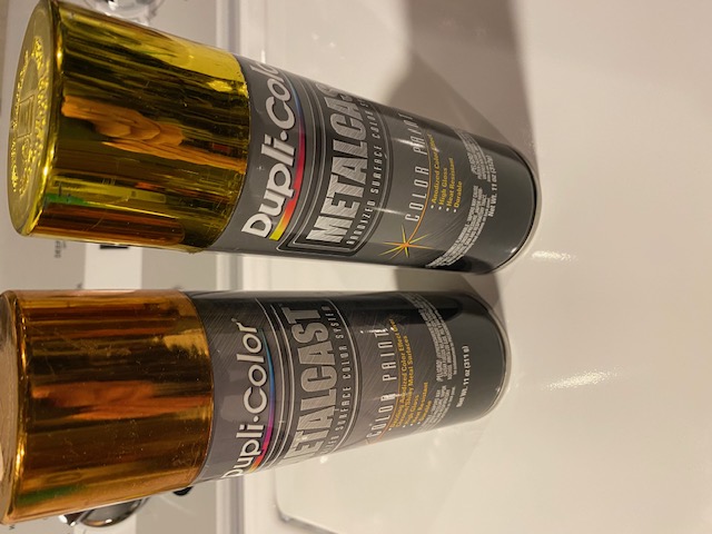

In 2010 I took a gamble and bought some spray cans of what was relatively new (at that time) for the Duplicolor product line.
I put the cans on the shelf and forgot about them for quite some time. Other projects took priority. I finally got around to messing with them again and I wanted to share the results that look quite promising. I don't know how well it would hold up on a frequently handled control panel, but it seems the beat the crap out of regular "spray paint".
