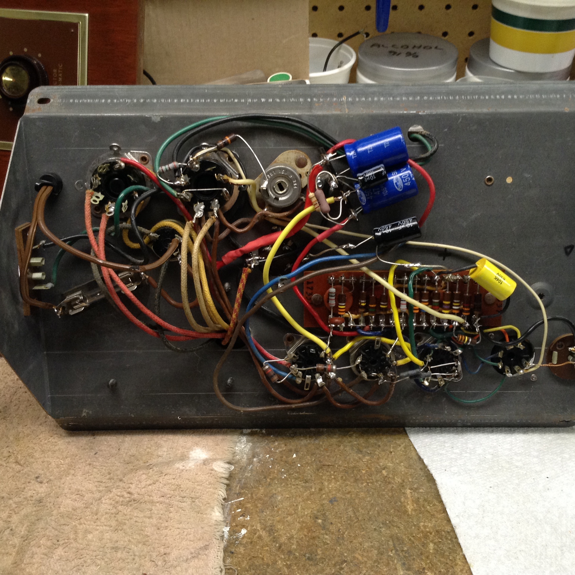

I finally got around to a rebuild on my VM-570 record player. I have gone through everything, replaced the caps and the resistor that had drifted. By the way, this unit has the least number of drifted resistors of any previous unit. Tubes checked, all good. Everything cleaned that could be cleaned and it actually plays quite well with no smoke, smell, no red plating, and I can put my hand on the PT after 2 hours of playing and it's just warm. My question, or problem is in the final voltage tests for the 6AU6 and 12AX7 tubes. They are off or turned around. They are listed below.

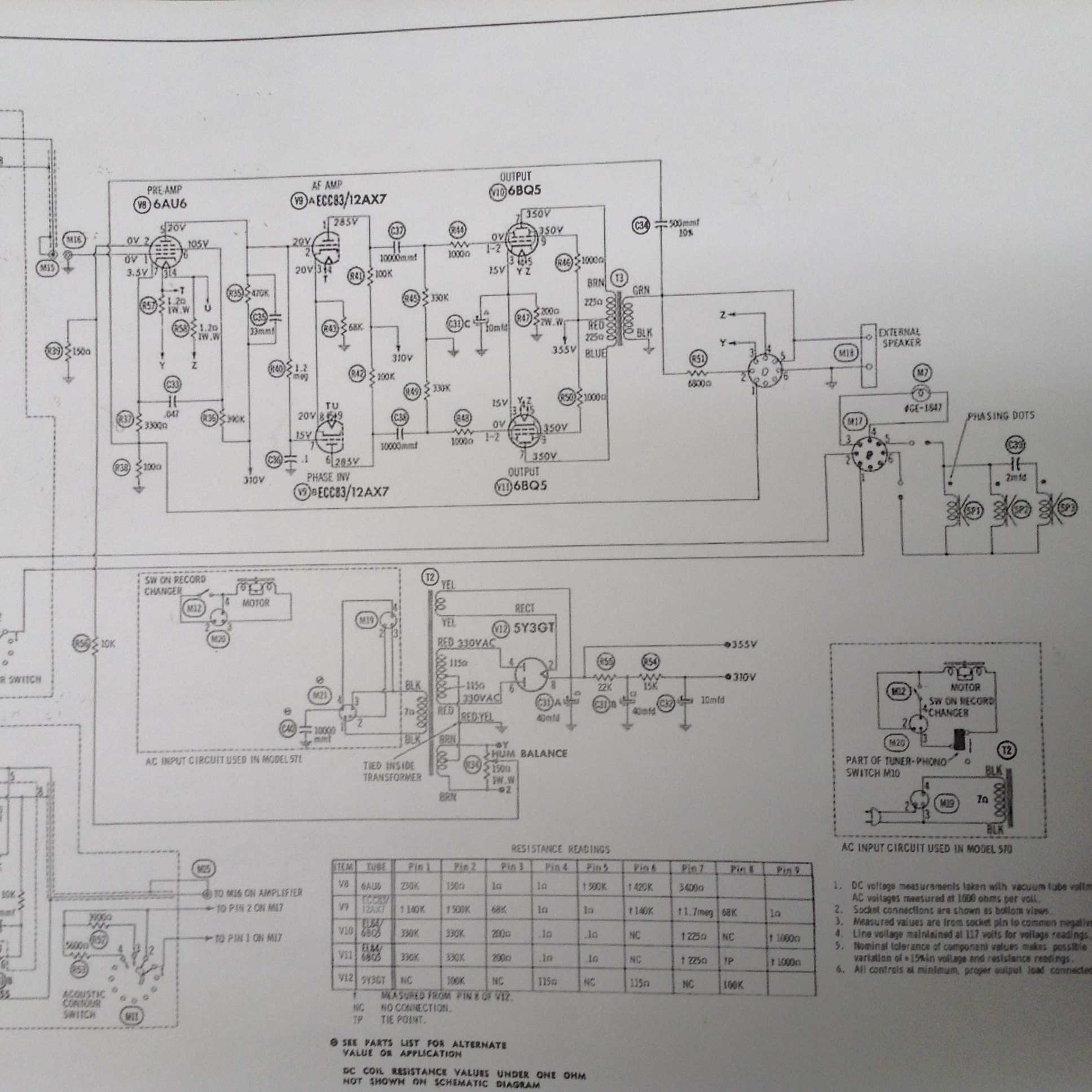

6AU6, pin 1, 2, 6, zero volts. Pin 5, 77 volts, pin 7, 2 volts.
12AX7, pin 1, 213 volts, pin 6, 209 volts. Pin 3 and 8, 87 volts. Pin 2, 77 volts, pin 7, 69 volts.

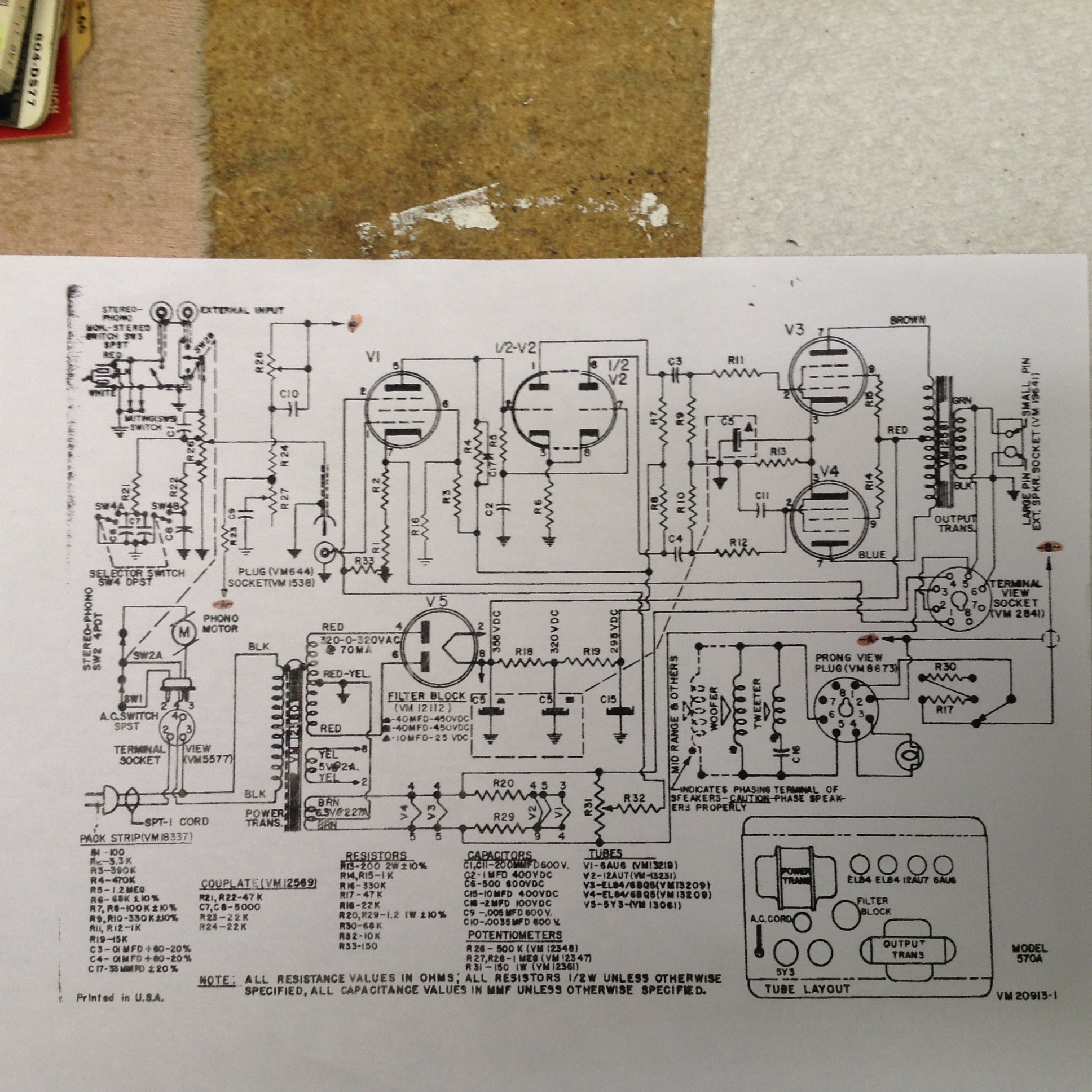

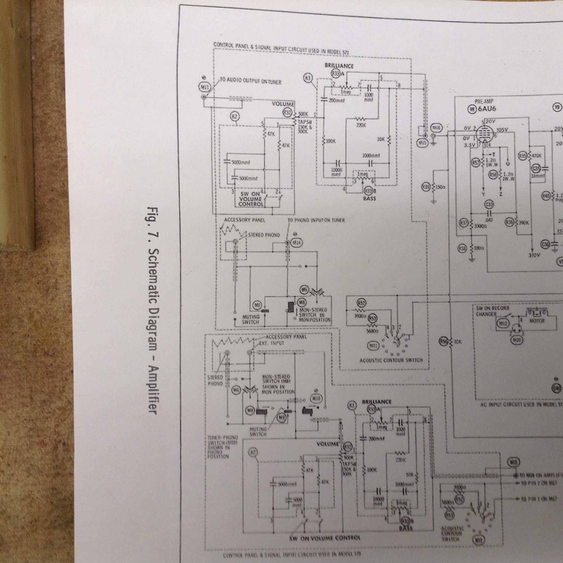

For schematics, I have an original from Gary and I have a Sam's. For some reason, VM does not provide voltage readings for each tube-like Sam's does, so I went by the Sam's schematic to compare to my readings. Here's where I'm thinking things are turned around, I think the Sam's has things misprinted. Please take a look and tell me what you all think.

I'd say typo on Sams but check R35 and 36.

I'm leaning toward a typo myself. You are probably okay. ;) ;)

With the suggestions given, I did double check several resistors including the ones mentioned by Chris. All were within tolerance, which in the case of this amp they were almost dead on with the rated value. It plays and sounds too good to have any issues, so typo is what I think too.
