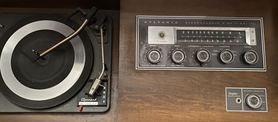

Once again, I jumped and made an offer before researching this one. Assuming it was all tube, nowhere does it say solid state. Picked it up yesterday and also noticed an empty spot for a reel-to-reel tape deck (R2R). I tested it at the sellers before paying up, prepared to walk way if it sounded lousy. It was in nice shape and had been moved from Buffalo.
The pull-on power switch is a plus on any unit. AC power switch piggy-backed on function switches and treble controls was a bad idea that most manufacturers used for some reason. The knobs are all metal and control panel looks very much like the TOTL model of 3 years before, the SC617 which uses PP7868s :o like a Fisher 400.

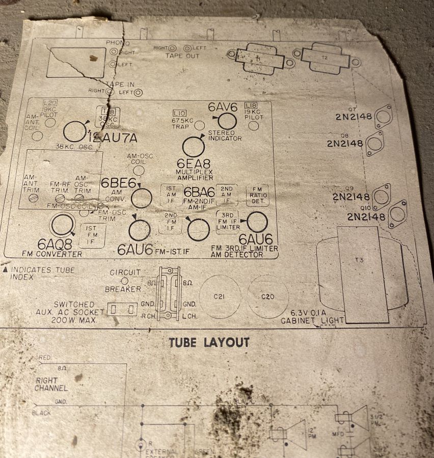

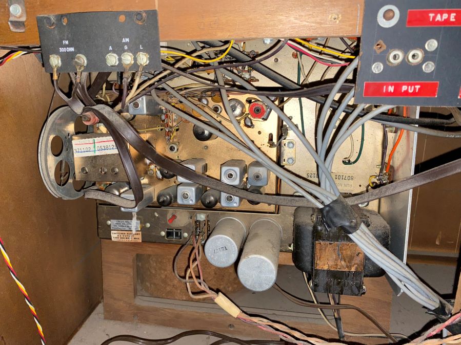

The chassis is all hand-wired, tubes are used for RF-IF-MPX but its all transistors for the preamp and output stages.

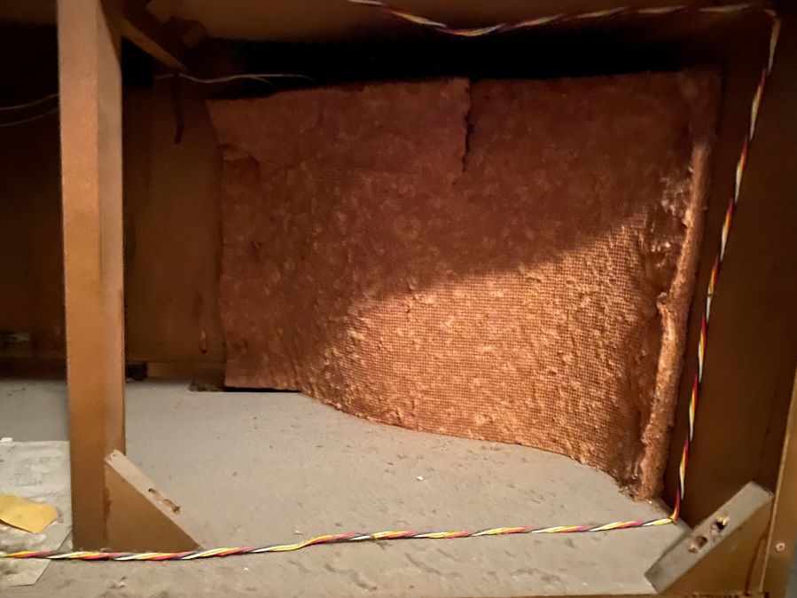

As can be seen from pictures, the speakers are baffled with jute? so adding some cabinet reinforcement may even improve and tighten bass by improving enclosure rigidity.
The two cone tweeters with a cap between them, means the jute needs pulled back, hope it doesnt disintegrate
